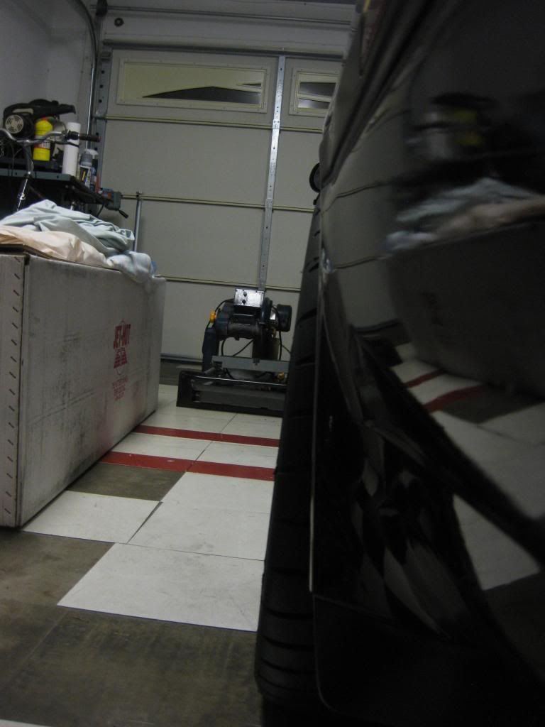

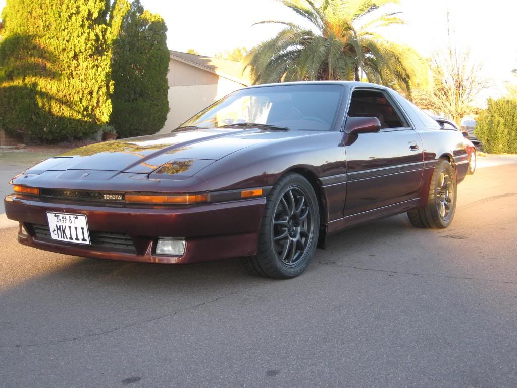

19x10 in rear 19x9 front. 275/35/19 rear 235/40/19 in front if i remember correctly too cold to go outside and see actually tire size lol. i had to lift up supra cuz it was rubbing pretty nasty, once i get all four corners rolled and pulled ima slammed the supra, not to much though :p then ill take better pics. btw im thinking of repainting the wheels... they cost me 200 dollars and they need sum work to them looking good again. im thinking of going with the gold lip and center gloss black on it... what you guys think?
hvyman
Dang Dude! No Way Man.
Apr 17, 2007
12,568
Fullerton,CA
Fronts are going to need some stretched tires for sure.
Also depends on how low you will be.
Better off with some 9.5 for fronts.
