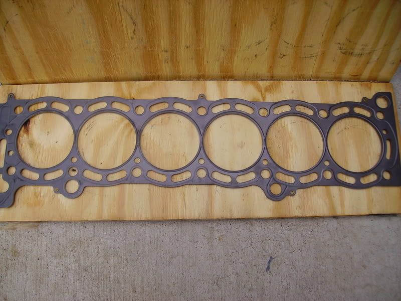

Brand new stock Koyo radiator, new ARP bolts with lube, and a brand new Titan Motorsports MLS headgasket. He also had some small hoses and gaskets he threw in. I don't know if I'll be able to use that hg since my block and head have yet to be machined, but hey, for $200 for all it I won't complain. The guy doing my rebuild said if I can't use it he'll buy it from me. I know nothing about MHG so is Titan Motorsports a good brand??

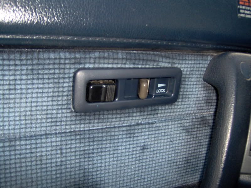

UPDATE: I got my new door lock bezels today and they snap right in! WHOOOOOO! I see used ones going on ebay for a shitload of money and brand new from Elmhurst Toyota they were $16 and some change shipped. Guess I better go take a picture.
Edit, here's a picture of my spectacular accomplishment today.

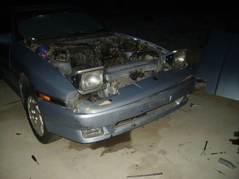

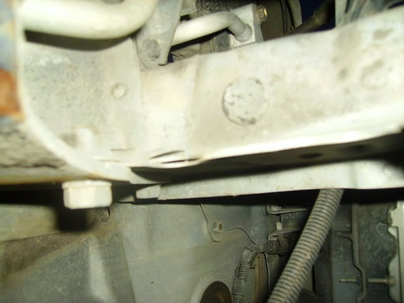

Well while I wait on the possibility of a finding a new block or having mine sleeved, I decided to start tearing my car apart even further. When I was underneath the front end trying to undo some bolts to remove the header panel I notice the brace things that hold the bumper on are bent over a little. I knew that the car had been bumped in the front but didn't know how bad. I tried to take a good photo of it. Anyway, I know some of you have had the same issue and was wondering how yall fixed it. Brute force with a sledge hammer to bend them back or what?
Can you see the crease?
I'm pretty sure I can salvage the bumper but I think I'm going to replace the drivers side fender too. From the beginning I have been weary of its shape.
So does anyone have a good straight drivers side fender?
So far the title of my build thread is holding up. What have I gotten myself into????

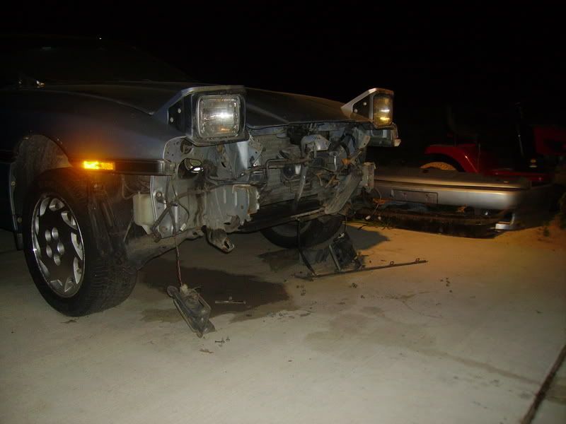

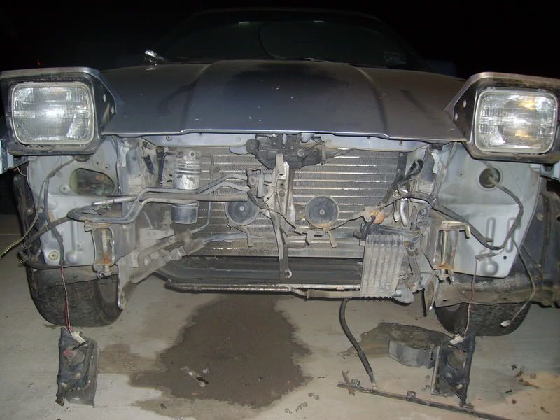

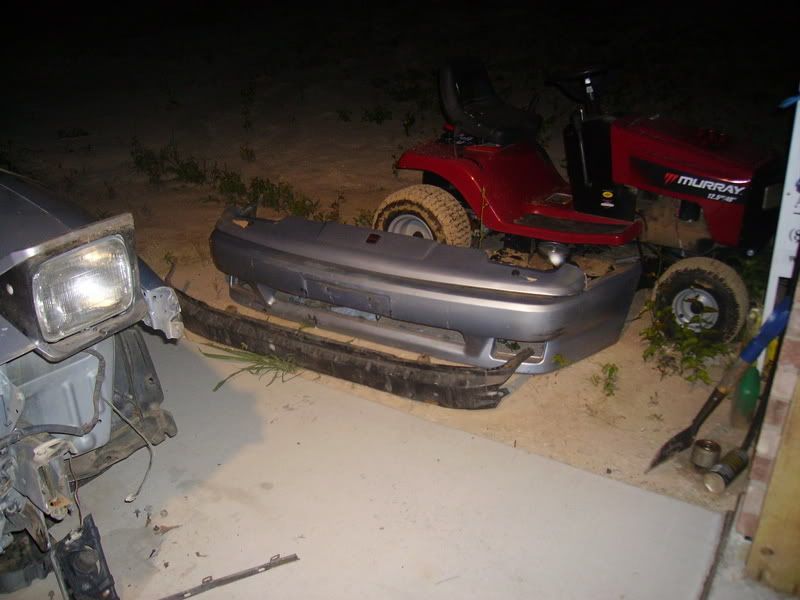

Well I'm tearing shit up some more.
My drivers side fender is f-up a little but I think I can straighten that out. It's thoses things sticking out that the bumper attaches too that I'm worried about. Those are bent just a little towards the passenger side.
Any suggestion on how to straighten those out.
