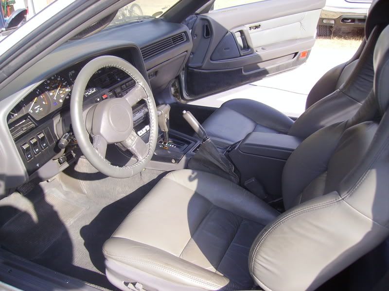

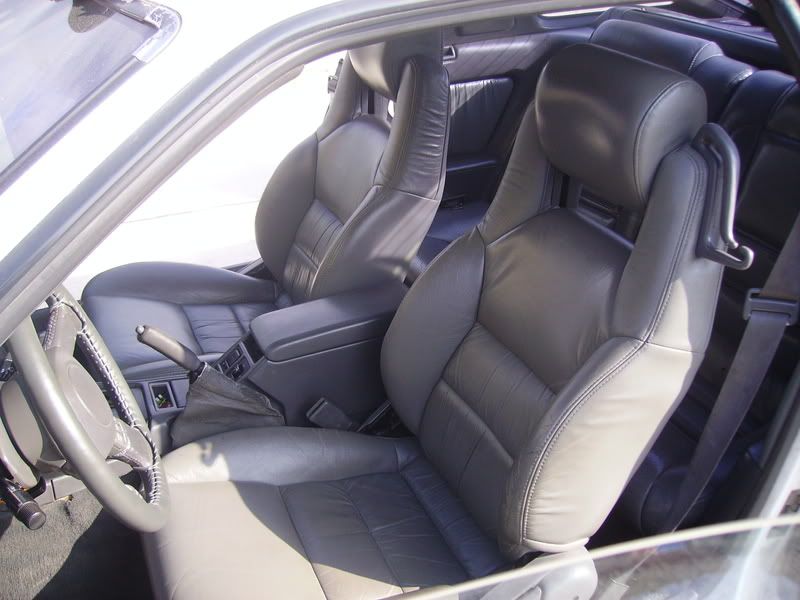

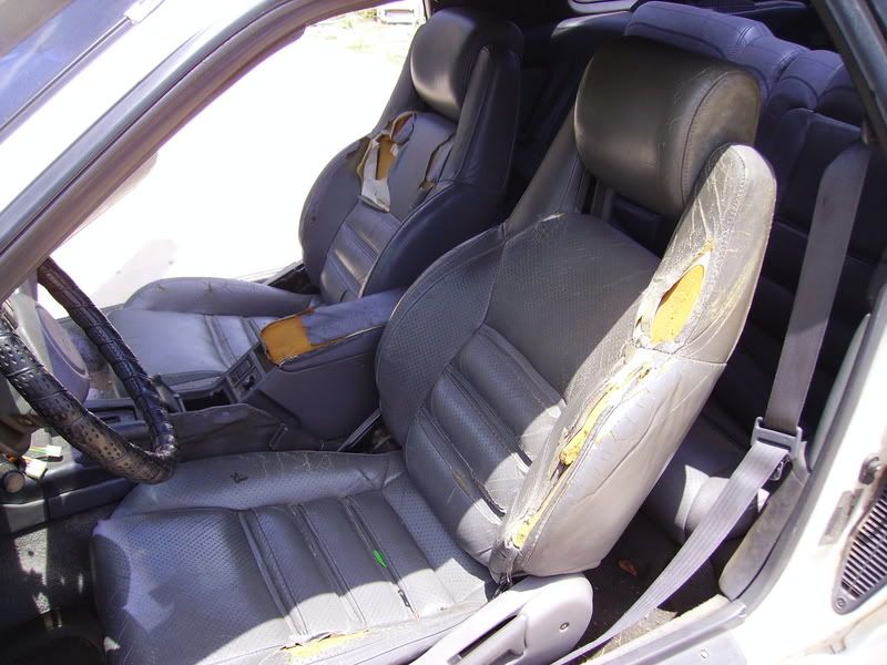

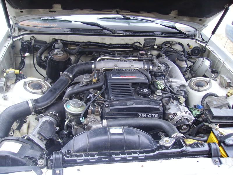

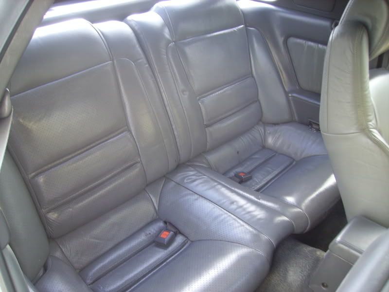

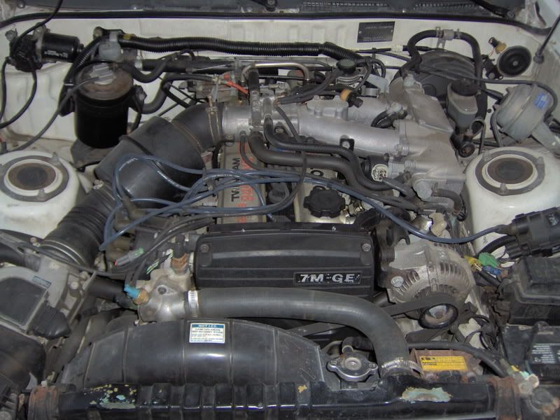

So in the meantime, I decided to put the interior back together and clean it up. I needed to see it together inside and clean so I'd fall in love with it again and not want to set it on fire. Took some pics too...
First let's go back in time a little
GE
GTE ::w00t::
Old leather seats
New leather seats
and some more interior..
So I like my car again. A big cold front is blowing through tonight and I have to fly to Denver tomorrow so it'll be a few days before I can attempt that wiring project.

BTW the interrior looks great! How much did it all run you and where did you get it all(looks new)? This will be something i need to do soon too.
Kckazdude
Mar 16, 2007
1,239
Memphis, TN
Those interior shots are drool worthy.
