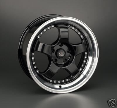

How about these rims?
Probably the gayest rims I've ever seen... :nono:
I was thinkin about gettin these, I think with 8.5" F 9.5" R would look rilla dope.. Honestly, mad props if you beat me to it lol..

They only have 7.5 and 8.5, which I can find plenty of tire for the street that size, I will change to D/R's for that track anyhow with 15 or 16".

Hmmm...just checked tire rack and the price aint bad either + I can probably get a deal through work. I only saw in 7.5 though.
The real SSR's were the one's I was lookin at.. You can get damn near any size you want according to their website.. I think they'd look wicked :icon_evil
