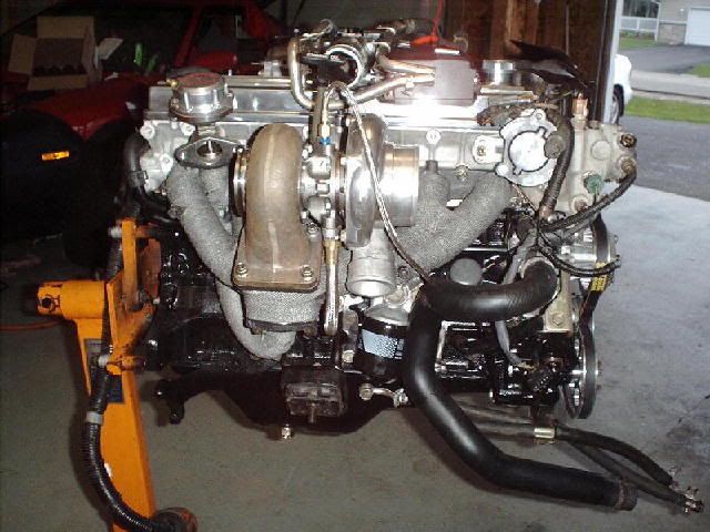

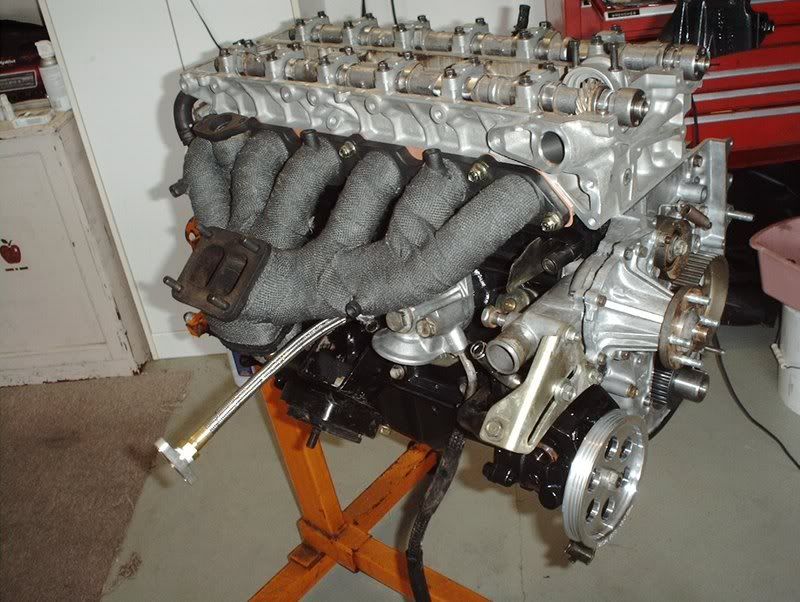

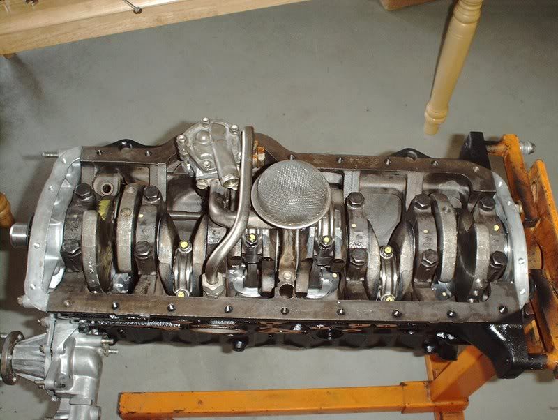

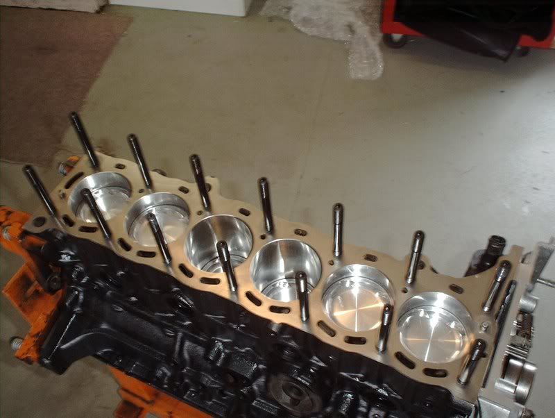

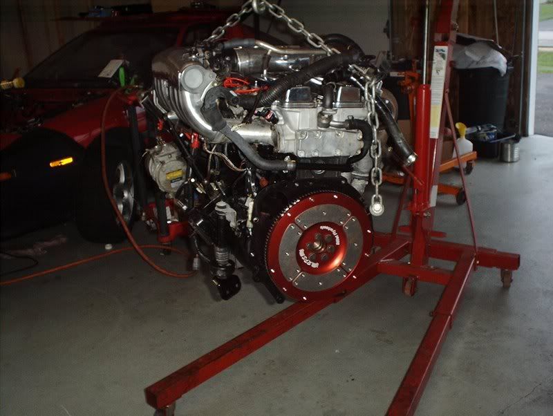

Some old pics when motor went in....my backwards build thread, found these from my old computer. The RPS flywheel didnt last long.

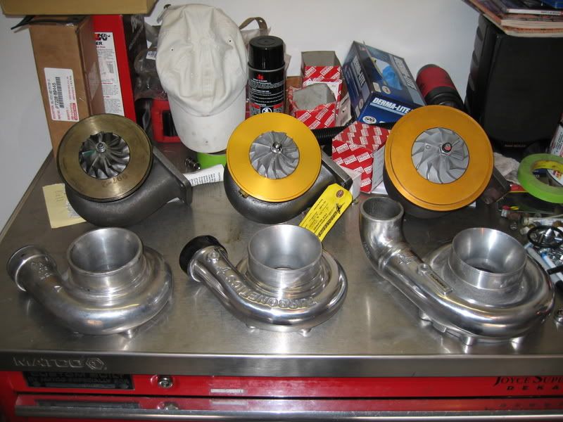

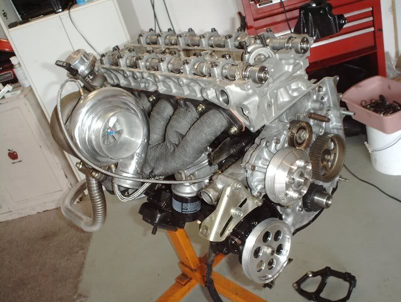

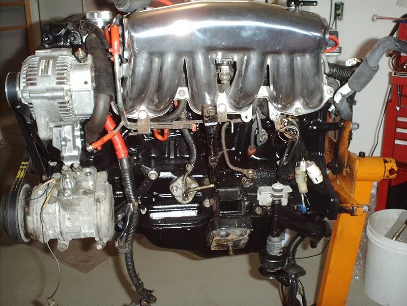

The old t4 60-1 garrett
SHINY STUFF
HKS LONG RUNNER...LOVE IT!

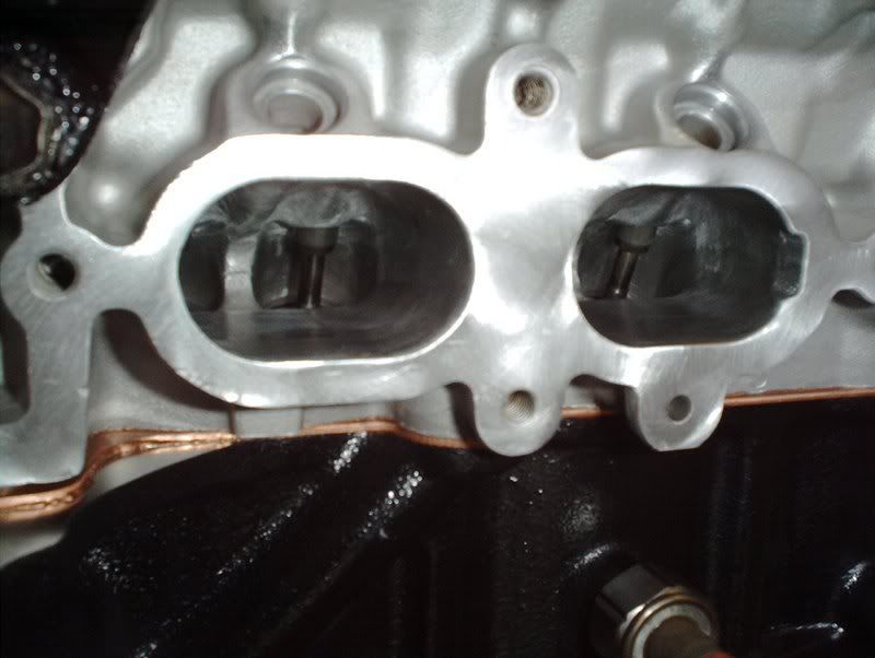

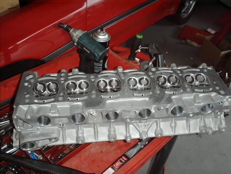

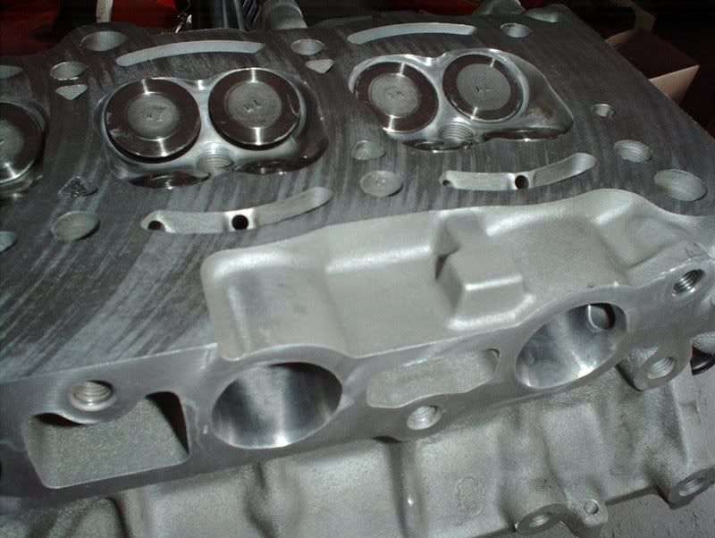

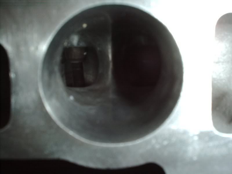

HEAD WORK, HAS O/S VALVES DONE AFTER THESE PICS AND ALL NEW VALVE SEATS, PORT AND POLISH WORK IS AWESOME, WISH I HAD BETTER PICS, YOU CAN SEE HOW BIG THE EXHAUST PORTS ARE....WOO HOO!
YES SURFACE LOOKS LIKE CRAPOLA IN THESE PICS

It was a shop in Virginia, I think, I looked around for his card but cant find it. Must be buried in th e Supra graveyard in my basement. I will find out about dyno. Its Eurotech on Burden Rd. in Machesney Park.

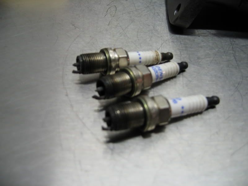

Never been on a dyno ever. I ran 13.2 with the same setup in your sig basically, with A340e. ~20 psi. It was sputtering toward the end for some reason (detonation). drove down return road ok, idled with a miss. I opened the hood and found the boost ref hose to AFPR blown off.
Then I found this........
Screwd up valves on the head you see above, thats when I went to O/S stainless, figured hell, now's a good time. First Run out with new valves 2 seats popped out....dont know WTF there...pulled head AGAIN and had all new seats staked in.
Ian ....you can see why I know about reusing HG w/ copper spray.....lol
Here is that old 60-1, the t-netics 62-1 I ran after that, and the new T-61 I have now for comparison, wish I had old ct for the pic.

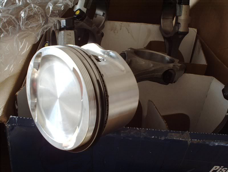

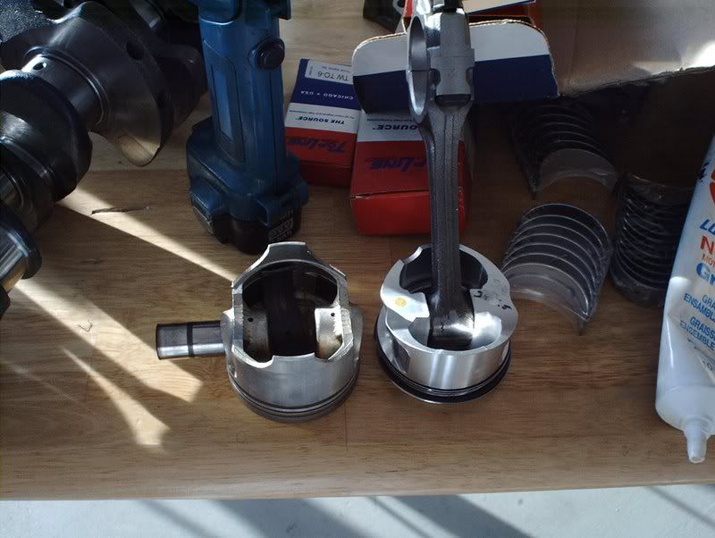

Ian ....you're lucky, the porcelain is the killer, I had valve damage, dinged pistons(thank god they were forged) , luckily the cylinder wall scratches were light, I took it apart, didnt see any damage on the rings, replaced them anyway and honed it.
