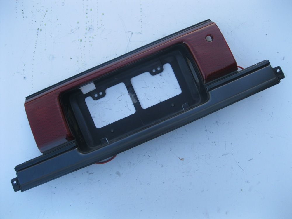

Why is it that every middle tail piece I see still has the molding attached to the bottom? Does anyone know if it's possible to remove just the molding from the car without having to remove the whole piece?
-edit- Nevermind, took the piece off and figured it out. I though the side moldings were a more durable plastic or hard rubber, but I guess their the same plastic as the license plate surround, as it's all one piece back there. I guess on the '89+ moldings, they expect the little insert on the bottom of the moldings to do all the protecting lol.
