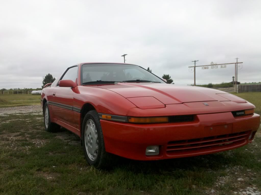

So the story is this. I originally never wanted a Supra. I actually wanted an Integra as my first car.. Then I smartened up and wanted a rear wheel drive Japanese car. I saw a 300zx and loved it.. Until I first laid eyes on a MK3. I went through Craigslist nearly every day.. Every Supra in the area was overpriced for what they were.. High mileage, original engine, BHG, rust buckets. Then I found one that was reasonably priced, and the best condition one I could find. It was a 1990 N/A with a little bit of rust, a rebuilt engine with 60k on it, and 215k on the clock. It may have a lot of miles, but it's actually in very good condition for how old it is.
Heres a few pictures from when I got the car..
See.. I wasn't lying when I said it was in really good condition for the amount of miles and 21 years of wear and tear.
Heres a few after a good wax job..
My personal favorite:
