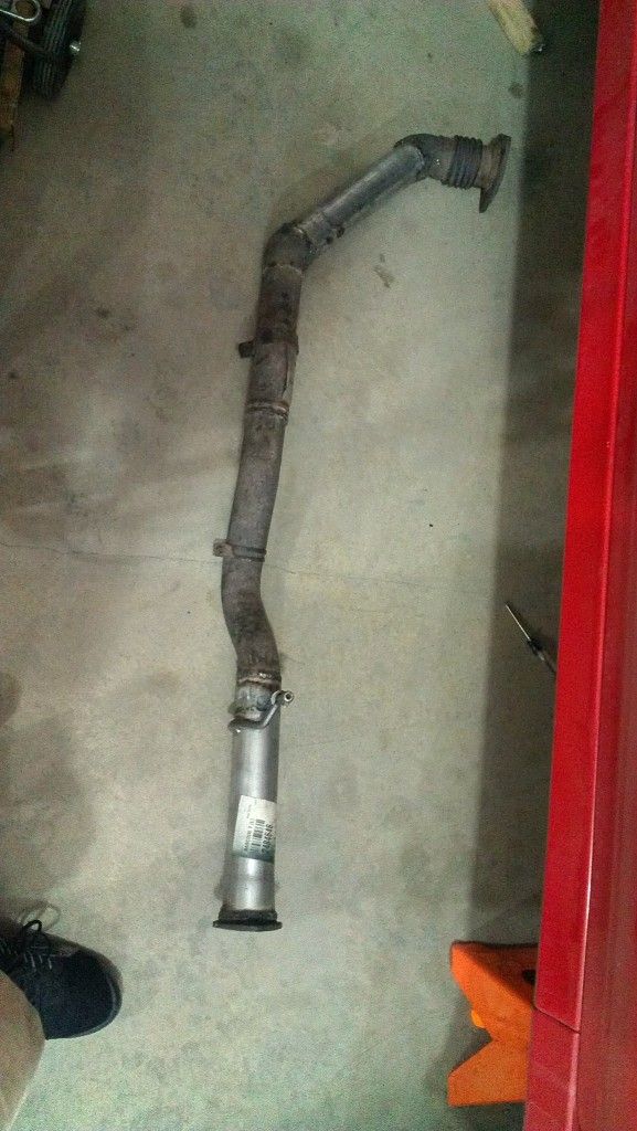

So I may have gotten a little side tracked while waiting for the sealer in the tank to cure....
Factory downpipe with the cat cut out and a pipe welded in place, and then extended and re welded to bolt up to the factory cat back. Not a lot of work and only ~$15 worth of materials.

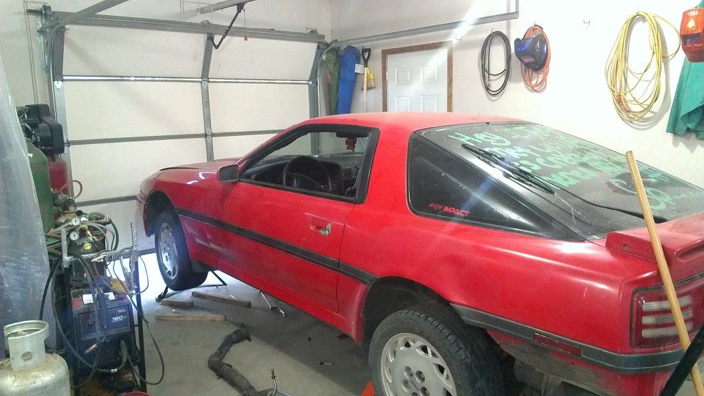

And hover mode is initiated... I really need to wash that crap off the back window. Thats the SECOND time somebody has used my back window to write me a paragraph... lol
