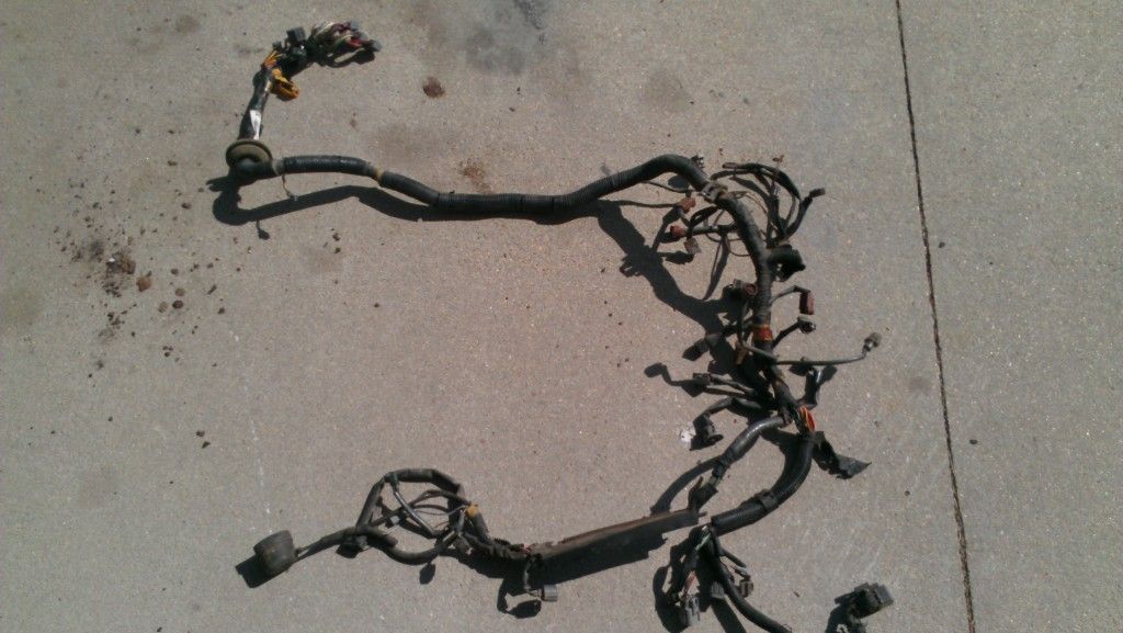

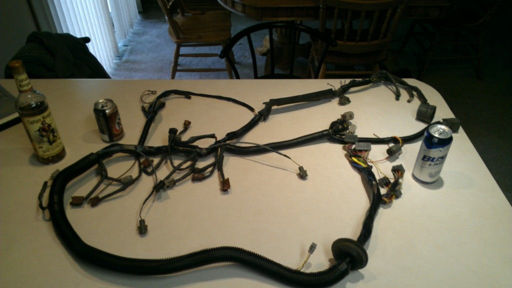

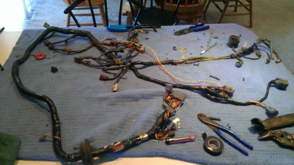

So I got a little bit done today. Finished up the harness, and I gotta say.. It looks fantastic! I'm really impressed with how well this harness cleaned up with 2 days work..
Before
During
After!

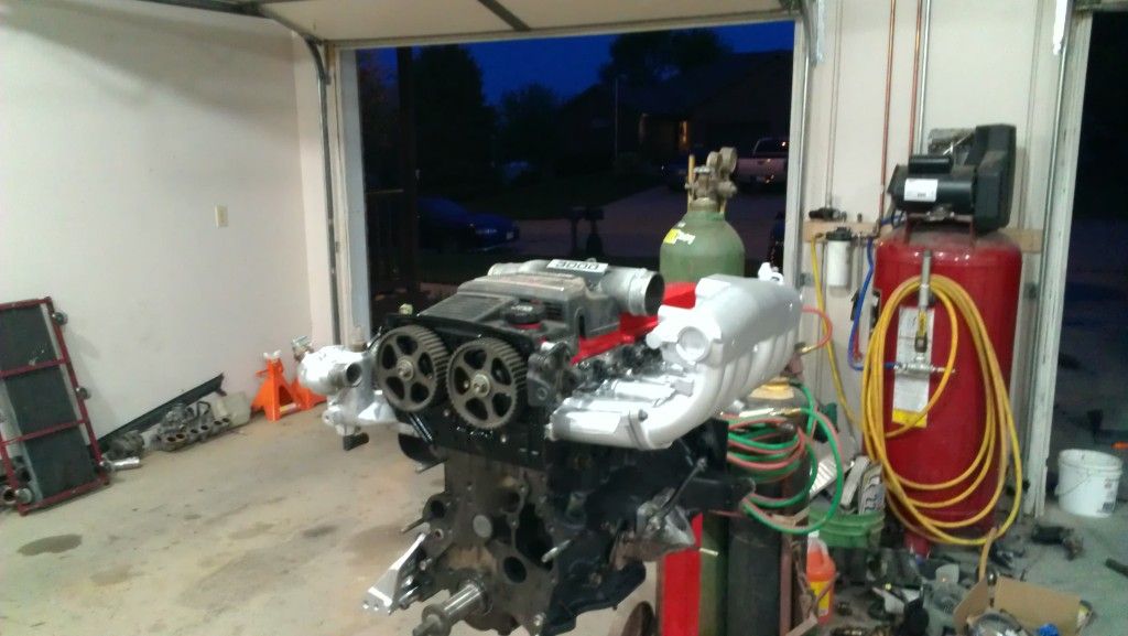

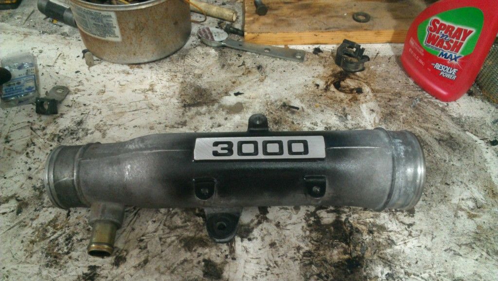

Also painted a couple things. Mostly the intake manifold and lower intake, along with the heat shields and started working on the 3k pipe. I dont have pictures of the intake or lower intake yet, but they will come when it comes time to put the head on.
Obviously not finished yet. Gonna polish the 3000 part to a near mirror shine, then paint the rest either gloss black or matte silver.. I'm leaning towards matte silver so it matches the intake and such.
Now I just need to figure out how to paint the throttle body without jamming up the accelerator..

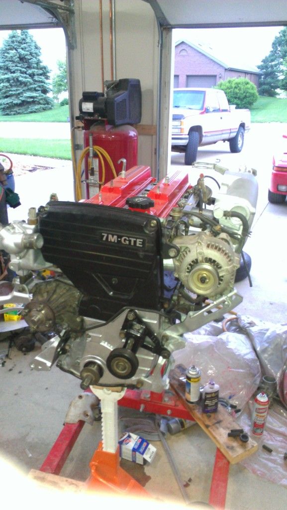

Well I lied. Its gonna be a late night for me. But I did get some work done on the car. Mounted up the intake manifold, and then got the intercooler (much more of a PITA than I originally assumed. And I also figured out im missing one bracket for the intercooler), and piping in, and finally pulled out the driveshaft. We're gettin' there! Also pressure washed the engine bay and the R154.
Note: The head is not bolted to the block. Its just sitting there so I have space to work on it, without having to worry about bending valves. And it also makes me feel further along than I am.. haha

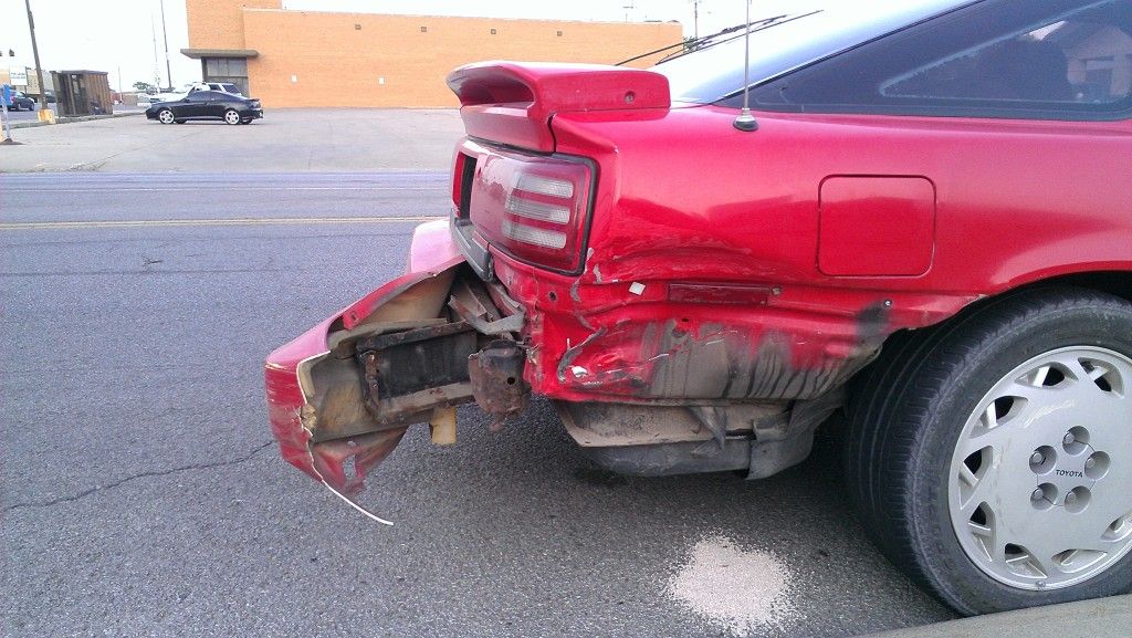

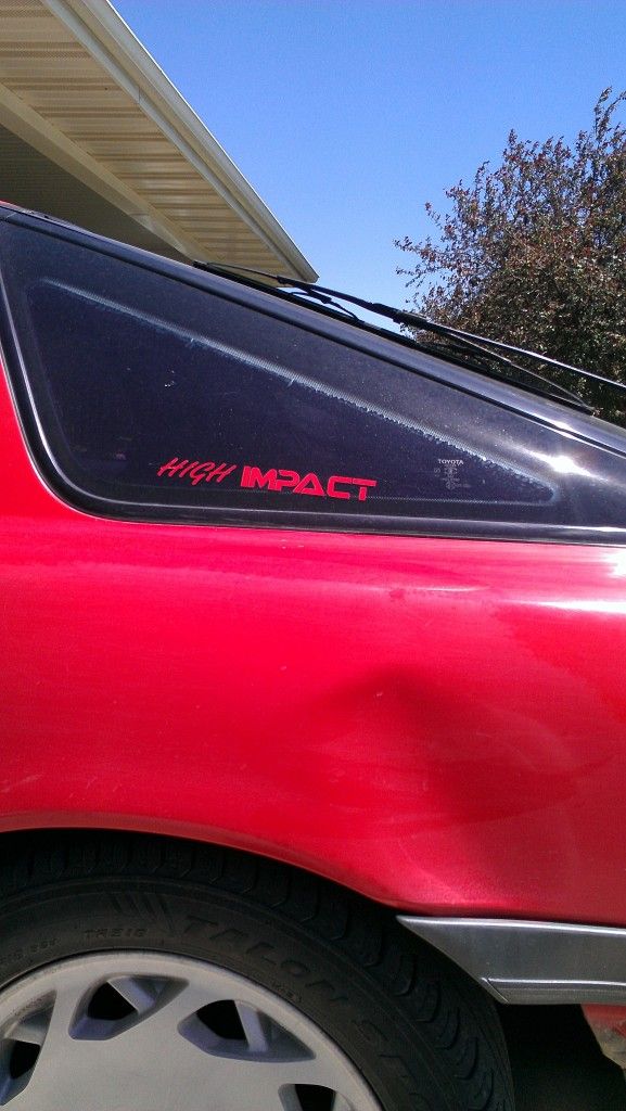

So here's the damage to the supra. Sad day..
And this is kind of ironic.. no idea what that sticker is even for. PO put it on and I left it LOL..

I'm working on getting parts to fix it. The explanation is a couple posts back. Unfortunately there were no cameras so the insurance company will deem it my fault.. even though there was plenty of room.. and plenty of time for the pt cruiser to stop.

I'm Gonna rebuild it. The only thing is the right frame rail is slightly bent. Other than that I can pop the dent out.. hopefully when I have the frame straightened the kink on the other side will pull out too. I'll probably have to do body work on that side though.
