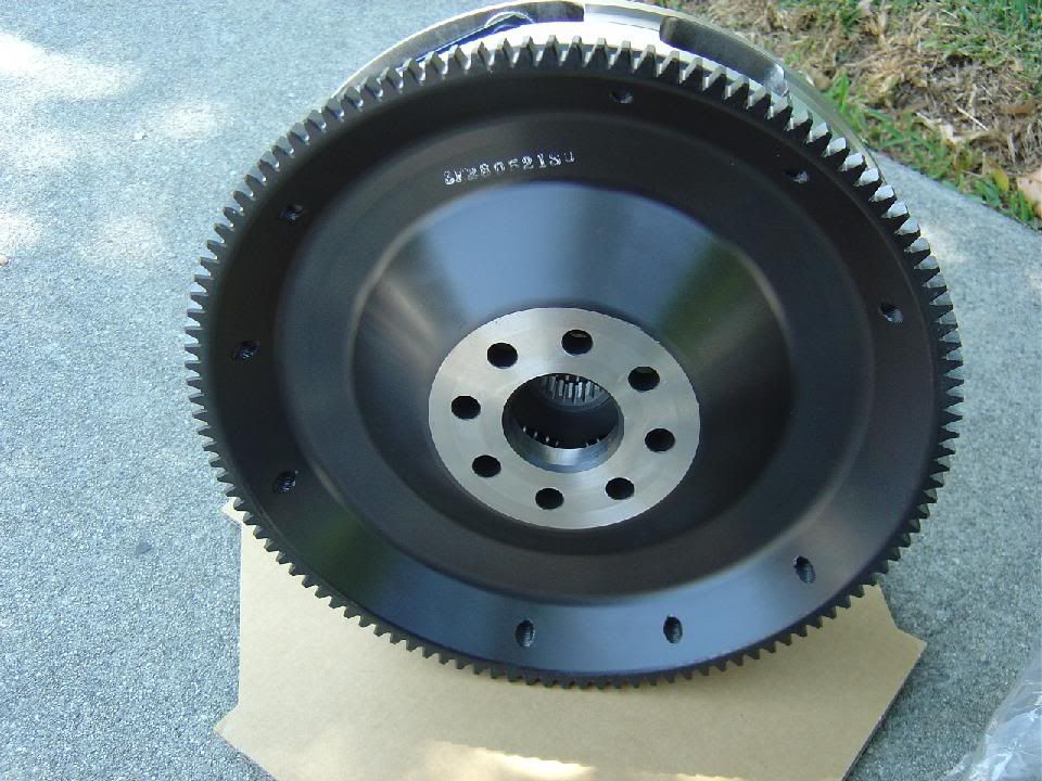

Damn, that's an expensive clutch. Hey Jay, do you think you can have a clutch made for your car like the some of the guys from Louisville did? What did they call that place that made them... KY clutch? Is the pressure plate diferent on a 1JZ with an R154 or not? If not, I'd look at getting an 3200 lb pressure plate with a custom made clutch disk ;).

one thing i have learned from other people is if you put on a higher pressure plate then stock with the 1J is Disconnect your Starter safety switch on the clutch. Problems with a bearing and crank walk down the road if you have the clutch in on a heavy pressure plate and starting the engine.
have heard that from a few people
55
I read that too Josh, but I don't know what they mean. I did my five speed swap so I don't know if that is hooked up or not. Could you elaborate on what it means?

The 1J has a small weak point
With Pressure plates that have high pressures when starting the engine with the clutch it, for some reason there is an issue with the pressure of all this pulling against the crank at start up. So to avoid this people default the safety switch to have it always be connected so that you can start the engine with out have the addition forces pulling on the crank/ To save you from any issue that could happen. It does something to the Bearing at the end of the Crank with all the extra force against it on start up.
The saftey switch is only there so you do not start you car in gear
OneJoeZee
Retired Post Whore
5,721
aboard the Argama
There's was a big 2J crank walk sticky on SF in the MKIV section. Saying basically the same thing Josh is saying. You might want to avoid really heavy single disc clutches with the clutch safety switch. Same concept applies to us.
A twin plate clutch, or triple if you're feelin froggy, might be what you want to look for in the future for your next clutch choice.
http://www.supraforums.com/forum/showthread.php?t=56195&highlight=Crank+walk
Here's a summation of the topic from a knowledgeable member.
http://www.supraforums.com/forum/showpost.php?p=771716&postcount=13
Now if you'll excuse me, today is the first day of school and I need to get outta here. Hope those links help.:)

what would you say is better Jose
and why is the TRD Clutch so bad?
When i needed parts to rebuild it, they would tell me that they dont make it for jza70 anymore but if I asked if they have it for jzx90 they said, Oh yea we have that clutch, but we dont sell replacement parts for it. TRD USA sucks ass and that is why they dont exist here anymore. I give it one thing, It was easy to drive but it was as heavy as stock flywheel and stock preassure plate.
The Exedy is by far the best in customer support and it also uses all stock parts like the TRD. Best bang for the buck and performance from Exedy, but it's a little hard to drive for the person that thinks 6 puck clutches are hard to drive. Lighter then TRD also helps the engine come to life.
The OS Giken is by far the most easy clutch to slip (drag launches) but the pull type to push type conversion does make things harder specially if you break something, it usually means that it's going to cost lots of cash to get it repalced and it's harder to find parts.

Thanks for the info Jose
HPF Claim that they have replacement disks available for the TRD according to there website
Which Exedy did you use? I have never used an after market clutch before so i don't know anything about ease of use. If the Exedy setup is light and requires less modification or none then thats the clutch for me :)

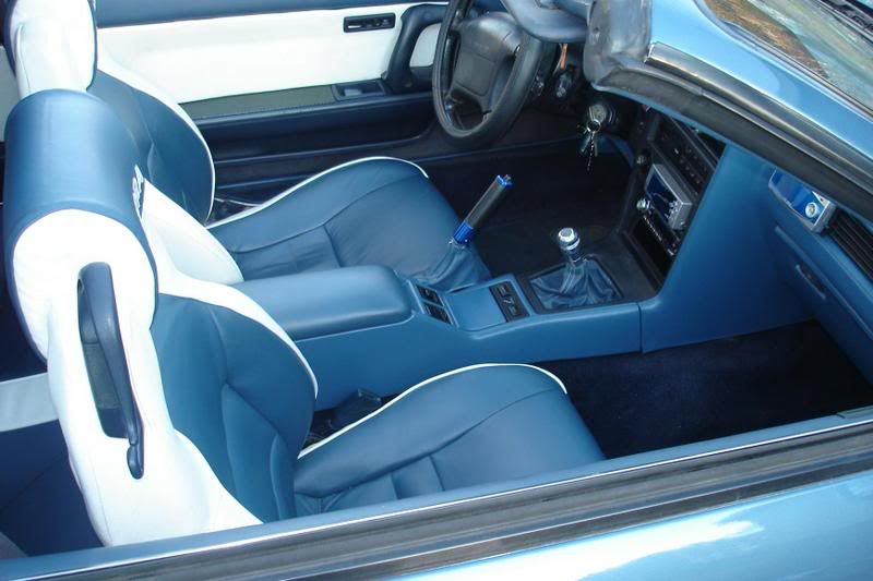

damn post fiends!! I have spent the better part of 3 days trying to catch up on this thread. You guys need to SLOWWWWWWW down. LOL. Really though this is an awesome thread. The pics and vidoes make it majorly!! This is like a good book. You start reading and cant stop. This might help with problems I know I will have with my JZ swap as well. The car looks great but I was wondering about painting interior parts. Is it special paint and is it prone to chipping and scratches and things like normal painted anything? I must saythough,, of both cars, Vixens is the hottest. Im partial to white! Good luck with your current problems. I know you will get them worked out
da89soup
World I Am Gay Blue!!!
Dec 2, 2005
1,978
51
Fargo ND
Um its magic paint!!!! :biglaugh:
It is interior base that we had mixed up. As far as holding up well I guess time will tell??? We did a bunch of prep work to the interior parts we painted. We scuff sanded everything with a scotch pad and then we preped with acetone and a tac cloth to make sure we had a clean surface. We didnt paint anything like door handles ect that would see abuse from touching or rubbing ect. I think it should hold up very well. I painted my leather headliner and leather targa insert with the same suff two years ago and it has held up well in ND extreme heat and cold. The paint is very durable and requires no primer its just a one step. It really goes on nice but I did have to fan my paint gun really wide to get it to come out the way it did. The paint was kinda thick also. We used my HVLP 1.3 Finex finishing gun to put the paint on but the paint was almost to thick for that tip. If you are going to do it I would recomend like a 1.5 or 1.8 tip. So basicly like a priming gun would be best!! I had my 1.8 Finex along but it was conventional and there is no way Jays compressor would have held it so we were stuck with my HVLP.
This is Jays favorite picture it is his screensaver on his computer and my screensaver now as well. The paint really soaked in nice and it really doesnt look painted. Thats what I liked about it when it was finished. I hope I answered your questions if you have anything else you would like to know feel free to shoot me a PM.
