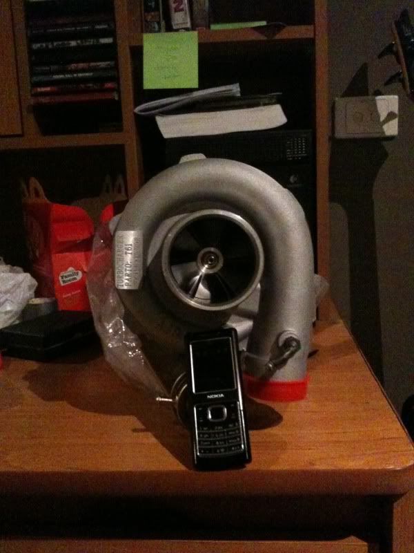

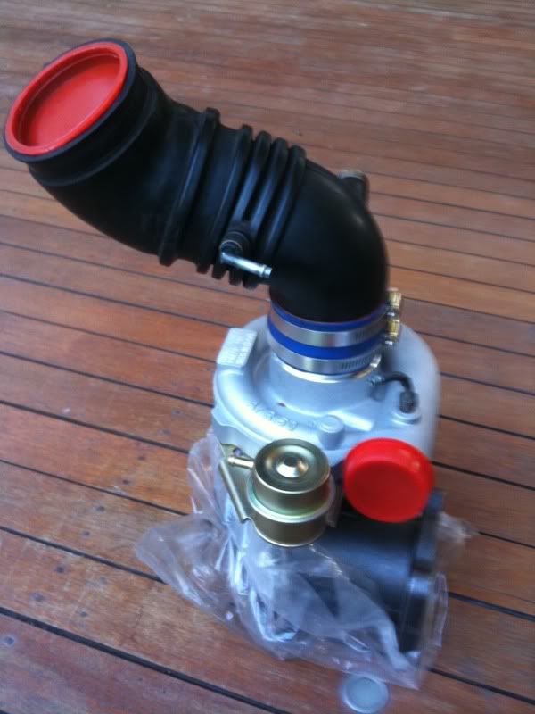

I've decided to run it as is and see how long it lasts...
the accordion hose will not stretch over the inducer.
i used some 3" silicon hose to bridge it and used polyurethane to ensure a seal (its only vacuum anyway)
here is another comparison photo
