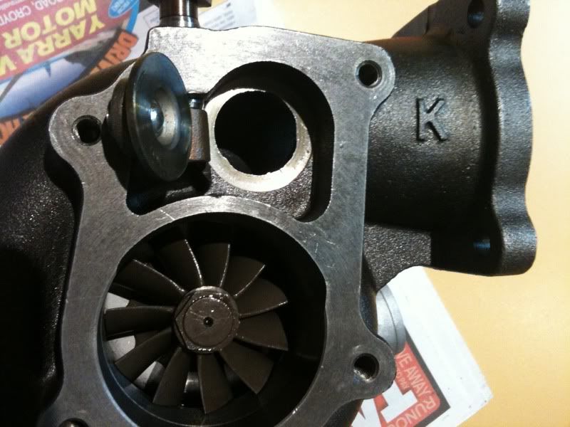

The exhaust wheel looks HUGE compared to the stock CT.

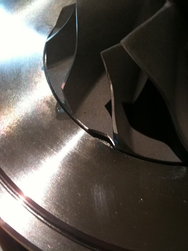

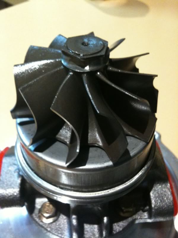

evidence of balancing of the comp wheel strange place for it

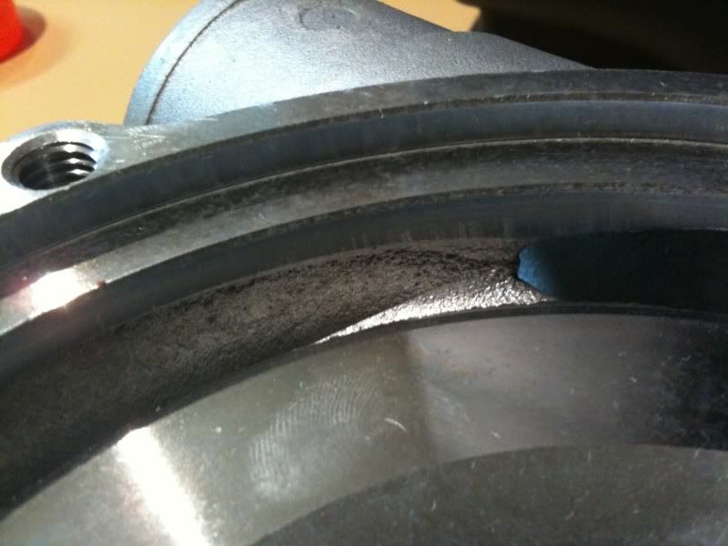

notice the housings are cast not glued exhaust housing weighs a tonne

i compared the casting of the housings to the CT26 looks very similar quallity, however i cannot comment on the materials used. ill see what the balance is like.
