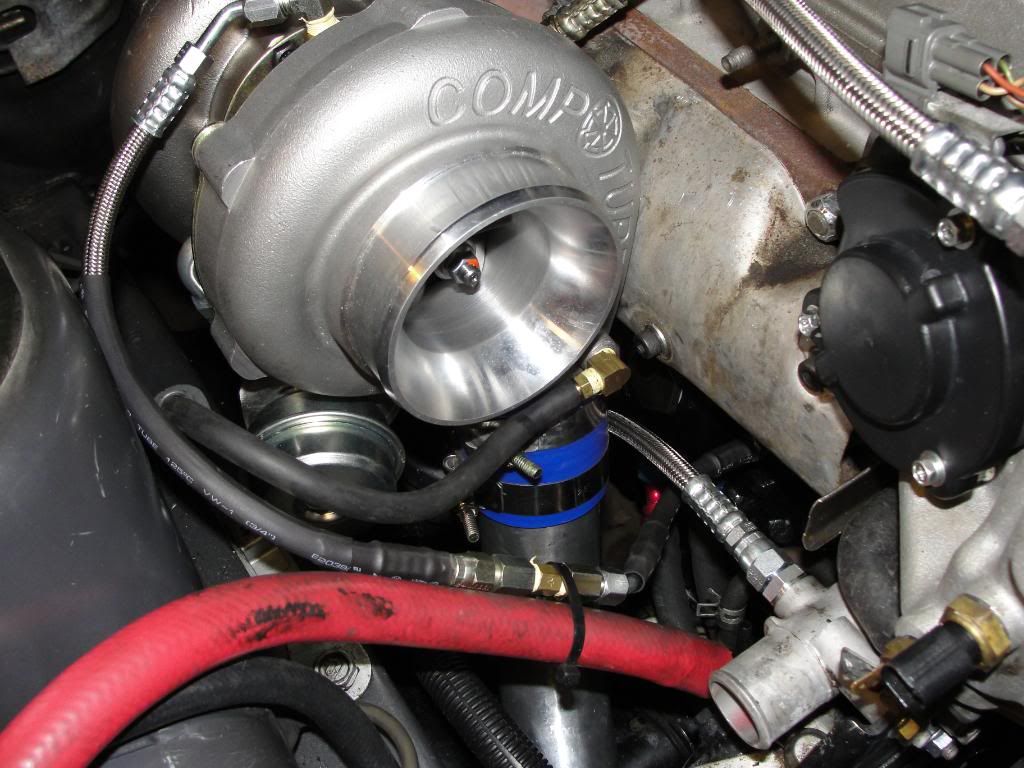

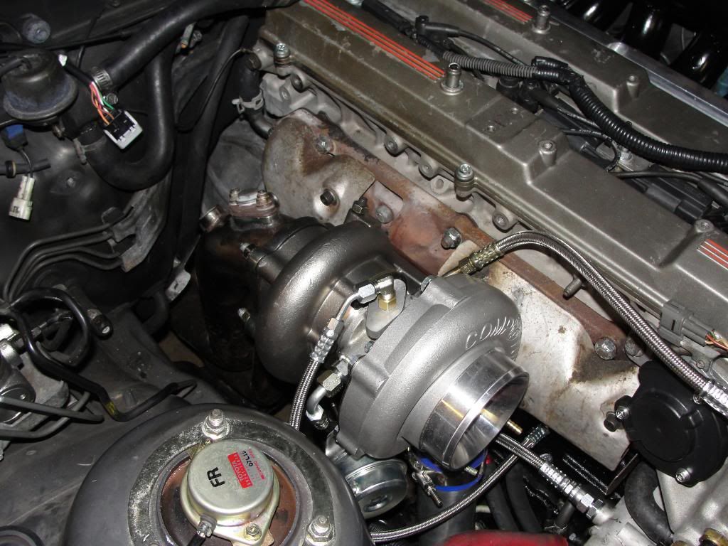

Well I got my order from SupraSport today and this is a very impressive turbo! (It's the same as Rob's [92NSX] only a non-polished housing)
61mm, GTS housing, P-trim exhaust, .83 LIPP exhaust housing, Triple ball bearing, water cooled, this is a turbo to behold. It even spins with a breath of air from me!
Also got an Alternator bracket, a fuel line, and an intake tube for the turbo. Just waiting for the manifold heat shields and I need to get up to St. Cloud to get the spacer/studs from Rob and it will be on! Sean had the intake manifold almost done, and then I can mock up the intercooler piping and get them welded! After all of that, I can finally get the car tuned and drive it!
But enough typing- pictures are much better...

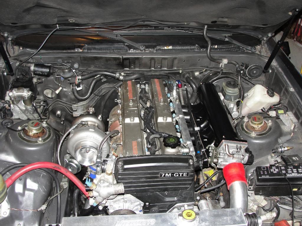

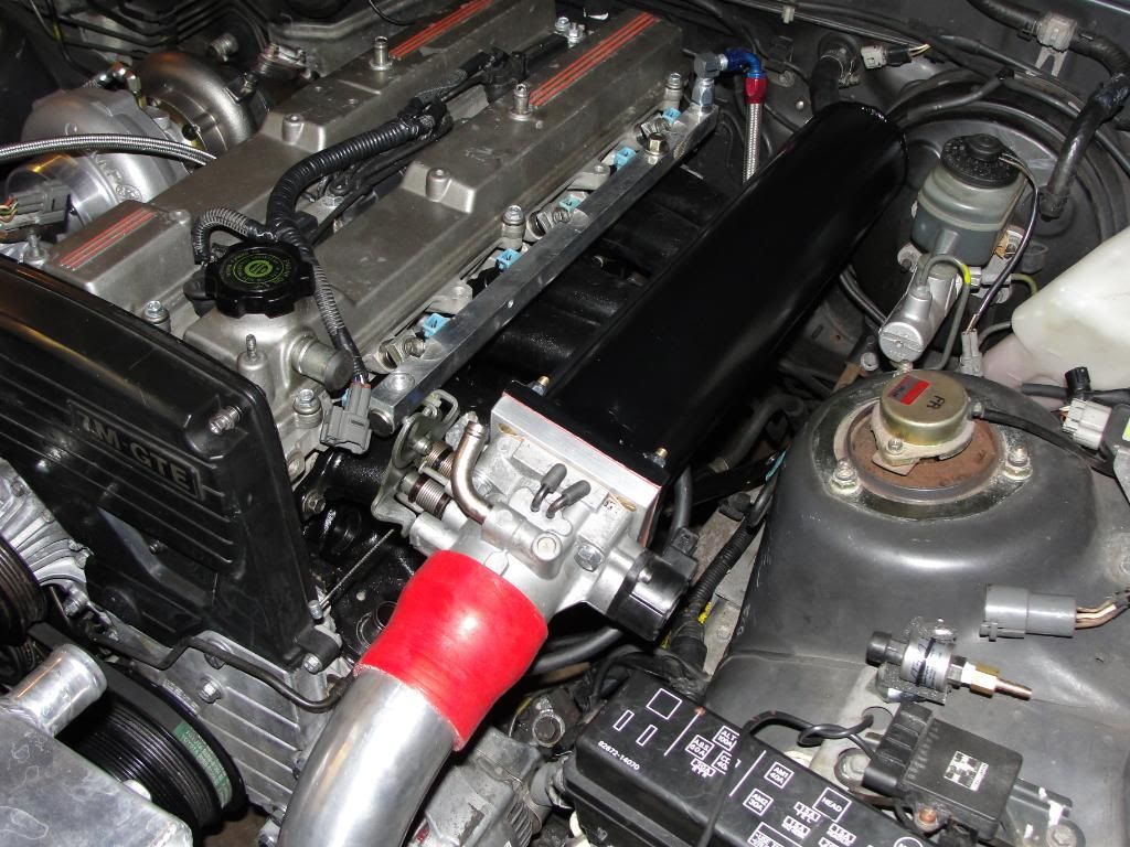

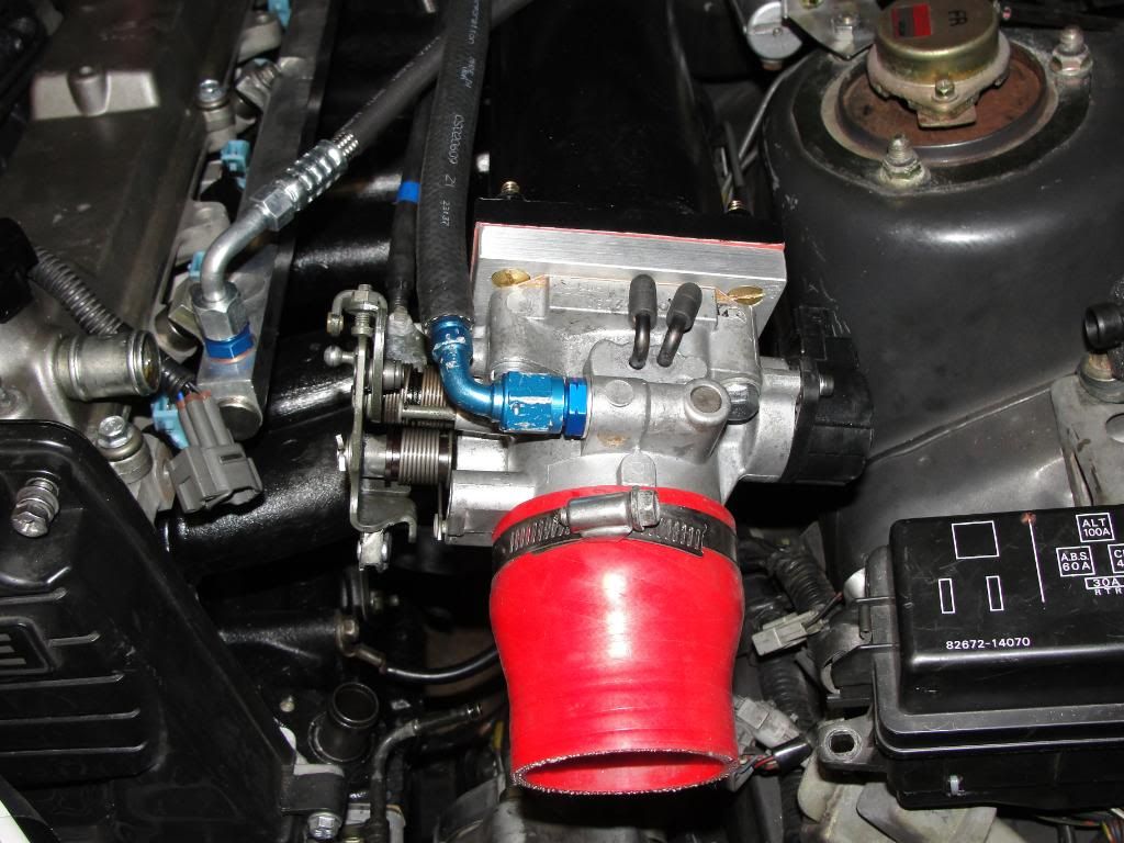

Tired after work, but got stuff done on my car! Intake got done just as I got there, flange looks rear purdy. FLattened up the TB flange myself and painted it to match the lower runner. Bolted the TB adapter up and put the stock TB on for test fitment- I think it looks great!
Also got the exhaust manifold heatshields today so I dusted them off and bolted them up. Turbo is now 98% installed, I just need to get the oil feed sorted and assembled.
Last couple things to do are IC piping, fuel pump supply circuit, AFPR install, hang the tank, fluids, and tune! woot!

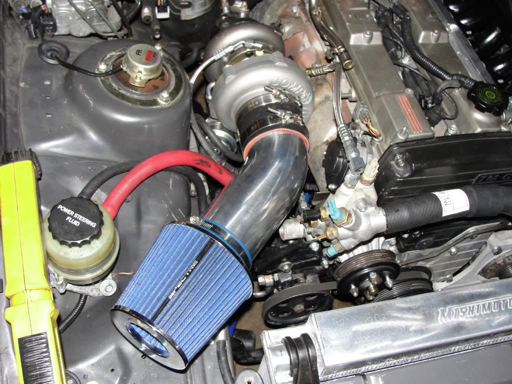

So after the Supra meet I was on fire to get stuff done on my car, seeing as it was the second meet I had no Supra for :(
Things I got done:
Cut 4" intake pipe to fit space and look decent.
Apply thread sealer to all pipe fittingsand install. Assembled turbo oil feed line and installed.

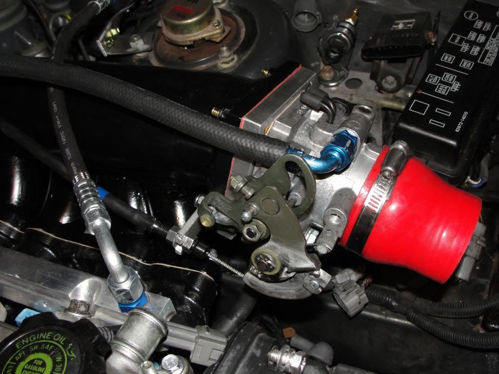

Re-work and weld together the stock throttle linkage to work in FFIM configuration, also made a bracket and hooked up the cable
Run the 12awg fuel pump supply circuit and hook up the control relay for it.
Tap threads in the PCV section of the throttle body for easier/prettier hookup, get PCV hooked up
Ordered a catch can and a boost controller (AEM tru-boost)
Get the Fuel pressure regulator mounted.
Spray penetrating lube on every single suspension adjuster to get them ready for disassembly and lubing up for the new suspension and alignment.
