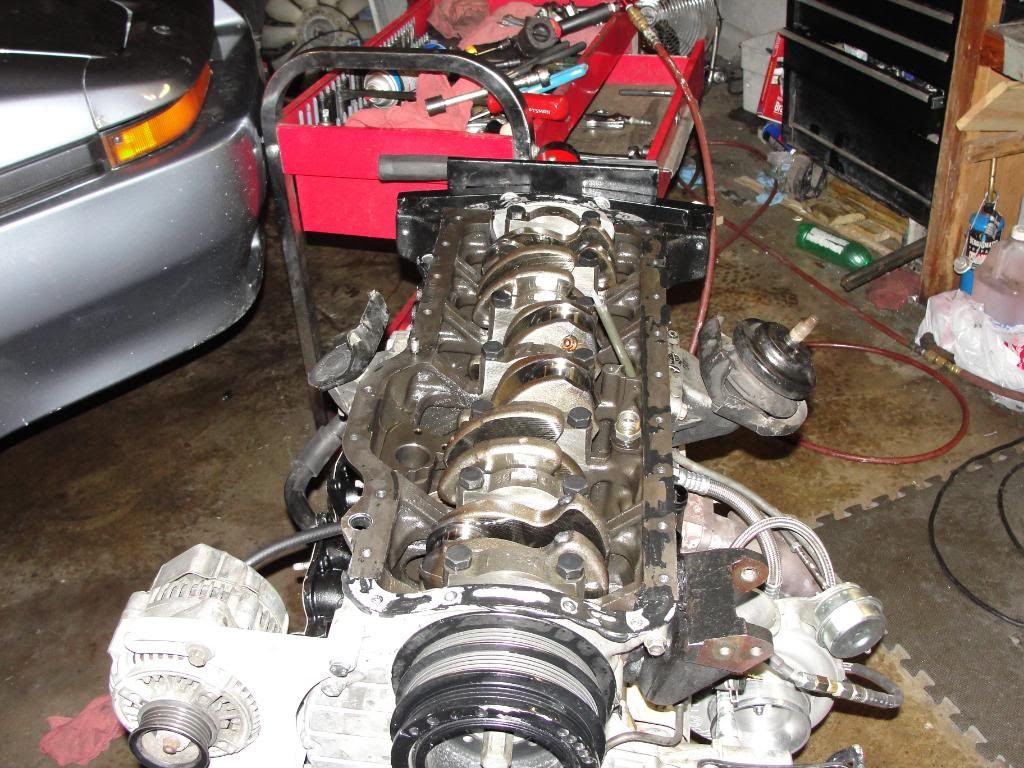

My engine is being pulled out and torn apart tonight
I need to fix an oil leak at the upper oil pump drive bushing and inspect my rod bearings, I fear they may be damaged. :(

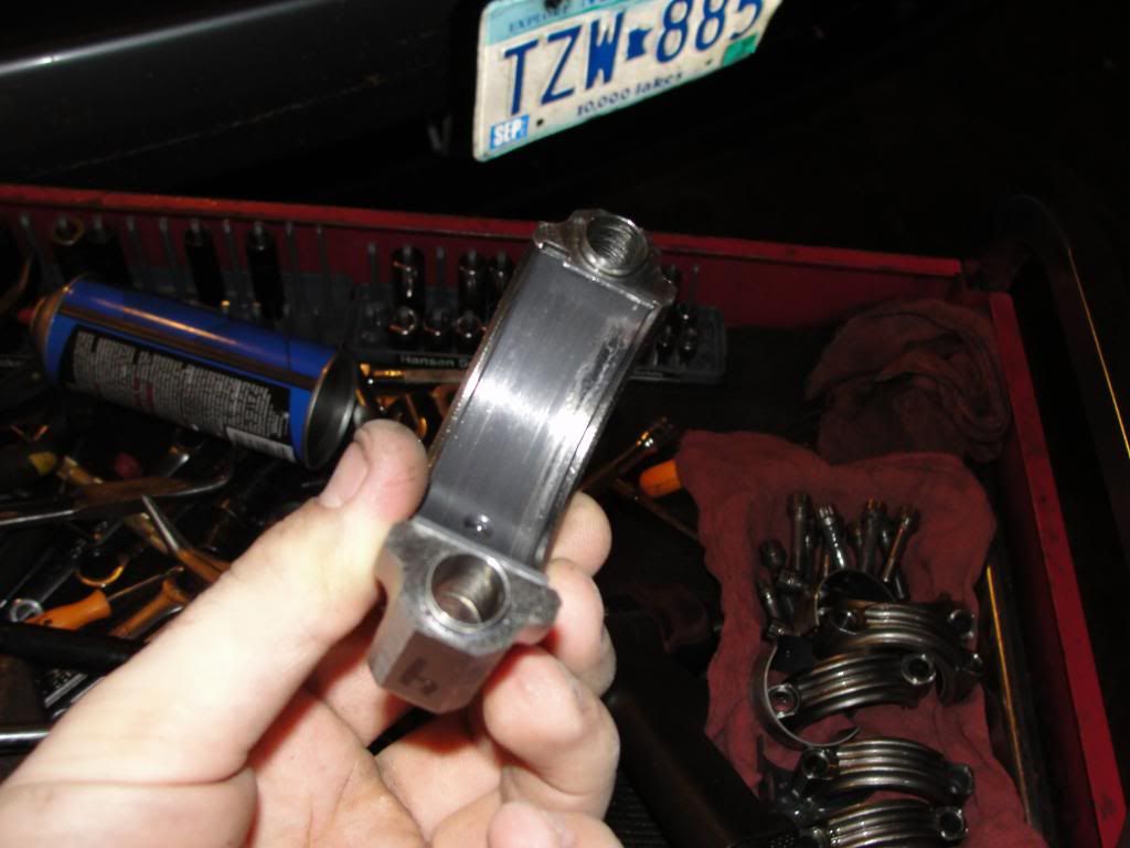

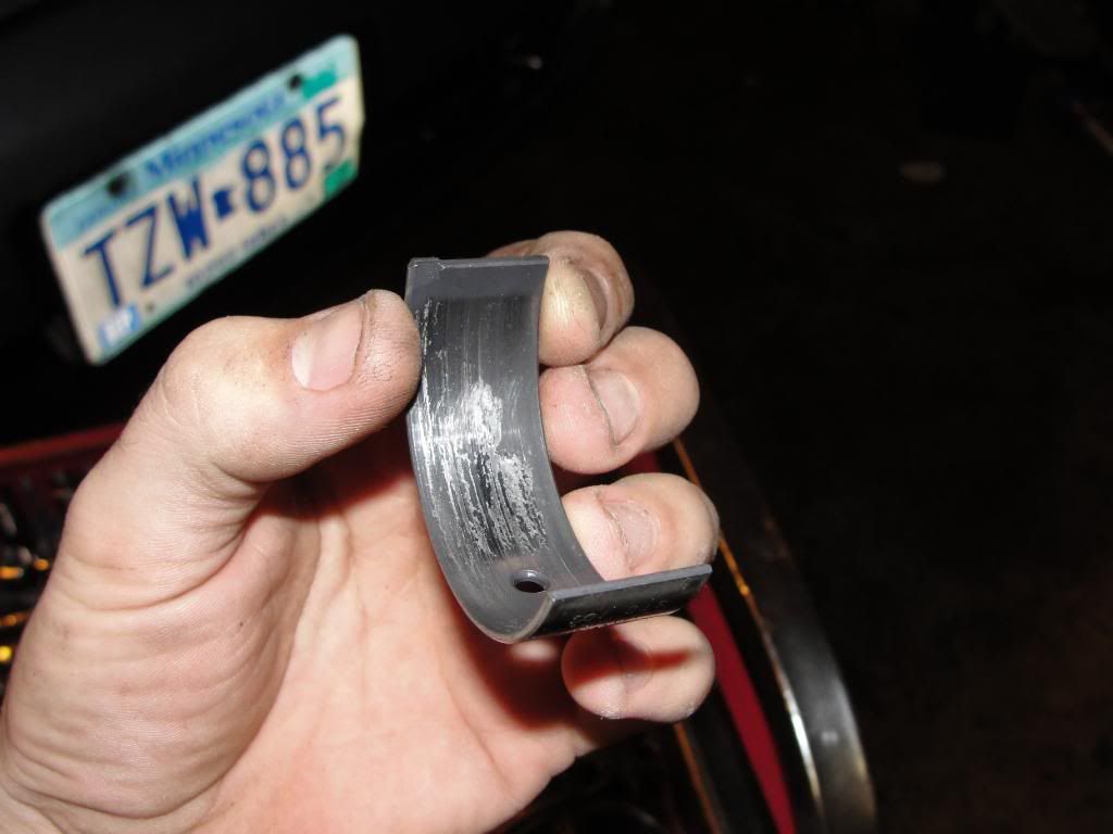

Yup, found the problem. #4 rod bearing seems to have taken a little damage. The crank is untouched thanks to the dry film lubricant, but it's getting a whole new set of rod bearings. Not sure what happened, whether it be oil starvation, knock, or other.
In other news, I added a bit of shim material to the oil pump relief spring, this brings the total to 6mm. Also found the upper bushing for the oil pump drive was very loose- it pushed out of the block with my finger. Going to see if I can get a new one by Friday. Additionally, my drivers side motor mount was broken, so that's yet another part I will try to get here before my Wednesday Dyno tuning appointment!
Pics of above said bearing!
Didn't I just have one of these pictures up here? lol
Bearings will be here Friday, and hopefully the other parts I will need!

Rods:
1- .0017
2- .0019
3- .0019
4- .0020 <--damaged one
5- .0015
6- .0016
Specs from Toyota are .0006-.0021 All the other rods and mains are ok, just #4 took damage. They were all at the upper range of spec, but well below the max acceptable number (forget what that was, no tsrm handy right now, also tired- 2:55am here.)
Oil maintainance so far: I ran 30wt for the first 1/2 hour, then changed to new 30wt for about 1-200 miles. After installing the oil cooling system I filled it up with 10w30 and primed it by running the oil pump drive sprocket so there was no lag in oil delivery because of that. Pressures have been good the whole time- 40psi above 2300 rpm when hot. I just changed the oil for the third time, again with 10w-30 and it came out very dark- too dark for a fresh engine, and I saw fine metallic filings in it. Knowing that my bearings were coated in a black film, I figured I had a problem so no more driving and here I am now. I will be installing a set of ACL race bearings, rather than these regular ACL's with the calico/dry film lube coating. Can't complain about the coating, I think it's what saved my crank from damage.
edit: Is it possible that revving to 6500 may have caused too much stress on the oil film?
I'm also thinking that overboosting may have contributed. My turbo did 19psi out of the box and I only had 91octane in it. I have the boost problem under control now, but it may have left its mark.

See if you can find some NDC's, I found when running my 7M hard I had to go to high 2's on the rod bearings and run a 10/60 Synthetic to get any sort of life out of the engines, having said that yours looks like it's had some gunk or crap hiding in the crank that's escaped and run through it..
Not sure if you pulled the crank plugs and wire brushed the galleries? (ditto on the block)

The machine shop I used did the cleanout. I tend to believe them since they had to weld onto the gallery plug (ball bearing style buried in the head) or the head to clean out the passages. If they did that to clean the head, I would suspect they would do the same for the crank and block.
That's what I thought on the Race style bearings too, but we will see if they are indeed true "race" bearings.
62
Last time I built a 7M I rang ACL here and they didn't do the race series for M's, this may have changed as it was a few years back Steve.
All I can say is it looks like an FoD issue to me. I'd have expected the loose bearing to be pristine compared to the tight ones as long as it had Oil pressure.
