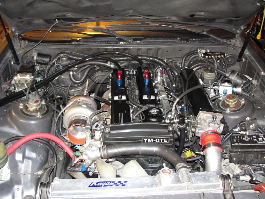

I can now feel my fingers, but more importantly it's all done! FIlled it up with coolant and fired it up- tune needs a LOT of work, but it runs!

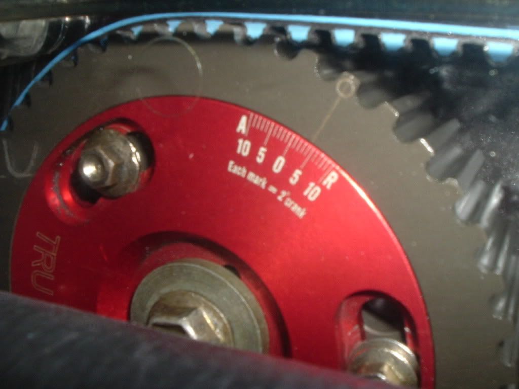

Fiddling ith the tune s going well so far, found out why it starts so hard when its cold- I was giving it less fuel for startup than I did for any single point on the map doh!! Fixed, now just need to get the CPS timing dialed back in! I'm really thinking about making a cam/crank sensor setup to get rid of that thing...you have to figure adjustable cam gears=duble adjustable CPS timing :/

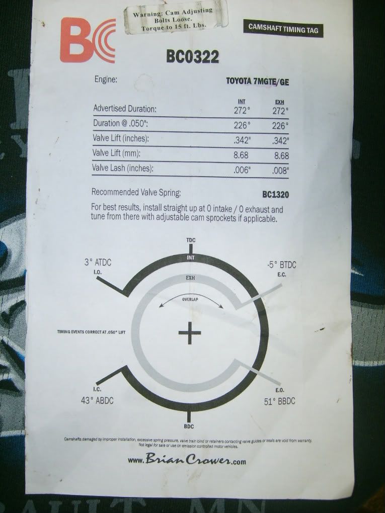

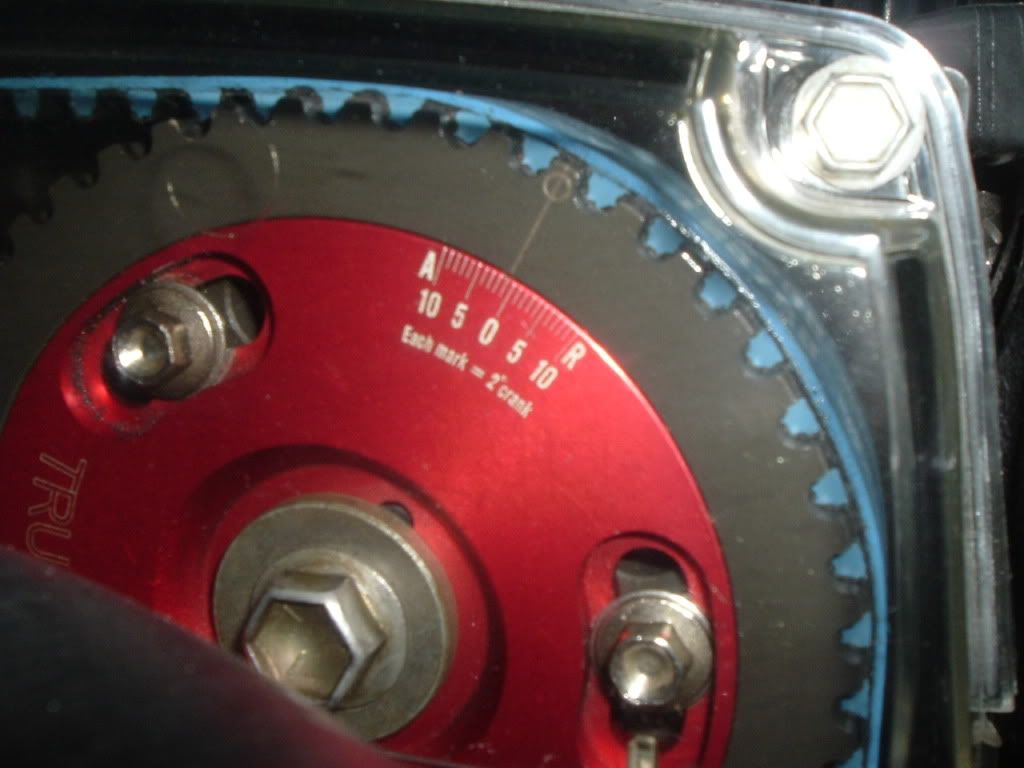

Didnt you get the pic I sent you? Ill find it again and post it here
EDIT:
In the end after timing in the cams here is what Mine came up with. (1 mark on cam gear = 2 degrees) Exhaust:
Intake:

Yep, got that one! I am just whining about changing the exhaust cam. Any time I change it, the CPS synchro is affected. Need to adjust the cps to zero the sytem back out, which I don't wanna do! I've been looking for close-up pictures of the setup Duane has, but have had poor luck as of yet. Might just need to develop my own system :)

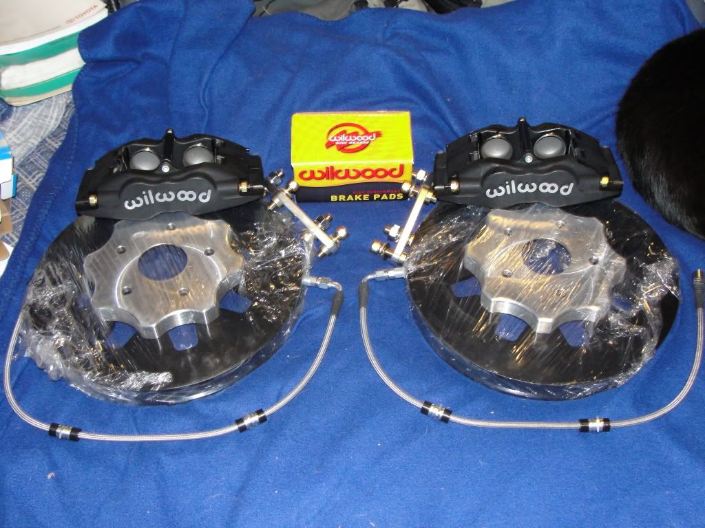

Stuff is happening! My brakes have arrived and they are freakin huge!
My turbo is also being sent out for a billet compressor wheel upgrade, as well an extra 3mm ;) I finally get my 64mm turbo, and it'll be billet nonetheless!

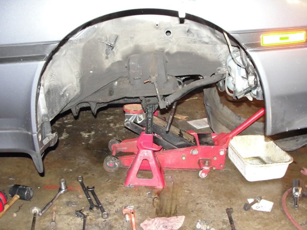

Thanks guys! I'm now working on my suspension since the brakes require lots of work with the knuckles (need to remove the ABS sensors/backing plates/reinstall abs sensors)
Here's how I'm doing!
As it stands now, only the PS is apart, the rest will come out tonight!
There will be poly bushings going in the front suspension now, and more may follow in rear if the adjustments are seized! New alignment bolts are on order just to have new, unrusted hardware :D

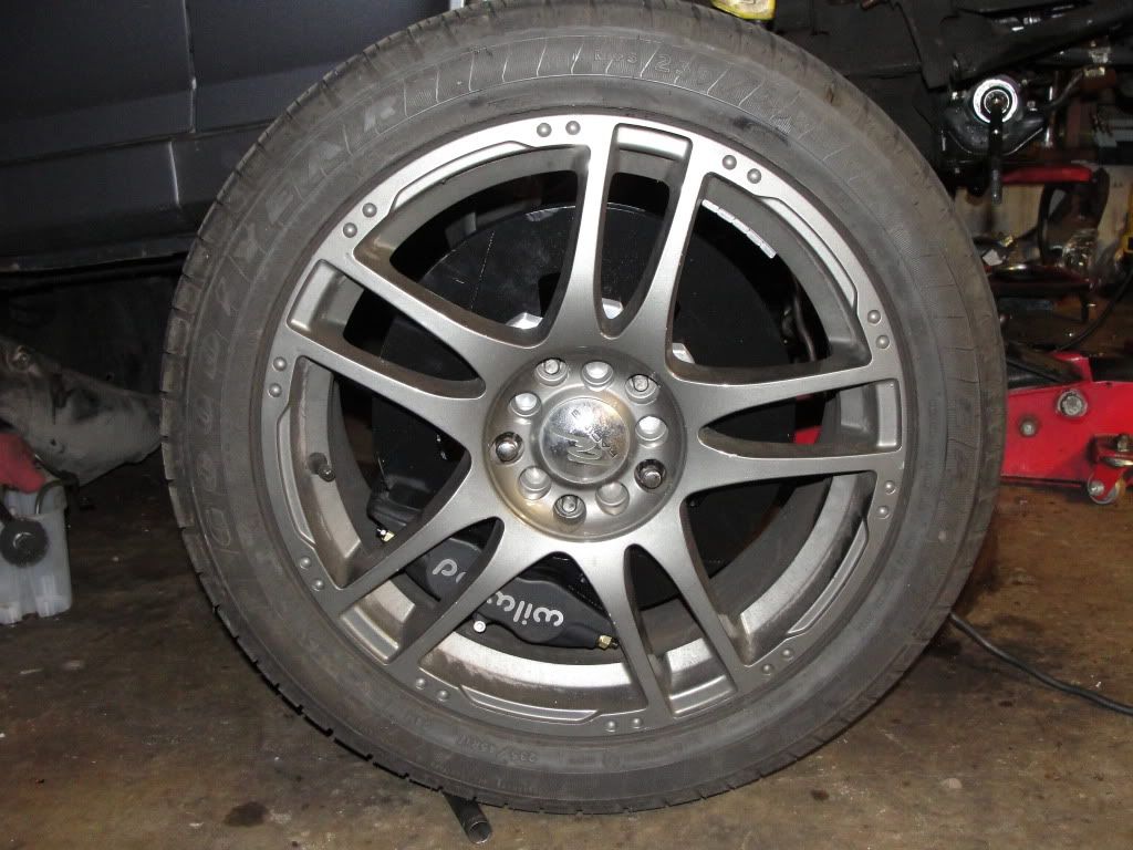

Brakes mocked up in the rim:

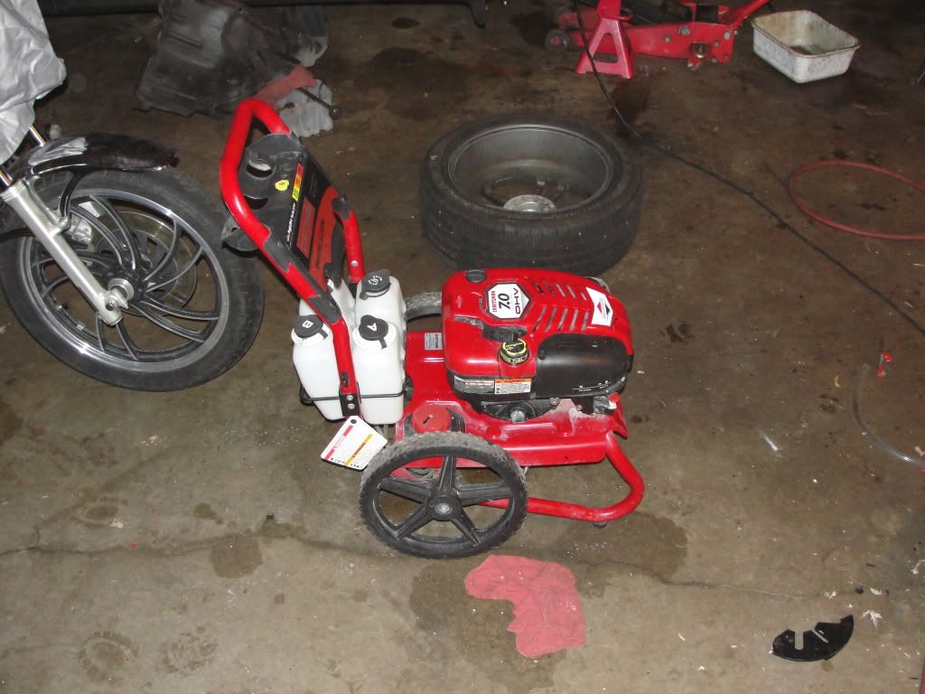

So I got a pressure washer to clean it up! And, in typical Steve-esque fashion, its broke and needs fixing (almost done with that, too!)
