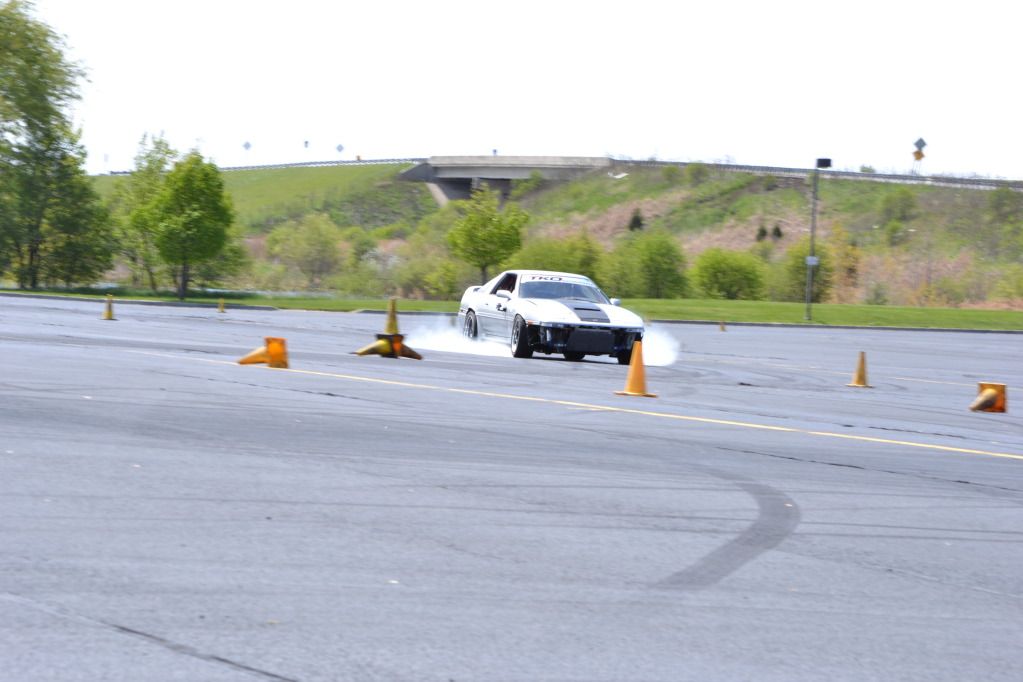

Done with the first event for the year.It was very cold ,and to make it even worse my ABS stopped working early in the morning. Here are a 2 pictures that someone took when I was "breaking" :)
