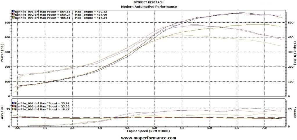

Update time for me!
Built 7M, E-85, T-4 Billet 67, bc 272's, AEM.
564.7hp, 479 tq at 26 psi
http://www.youtube.com/watch?v=i45KxDrfnow&feature=g-upl&context=G273c71aAUAAAAAAACAA
Dyno chart:

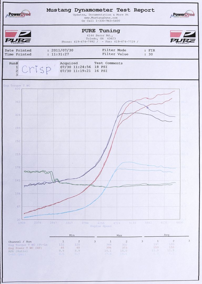

Actually got a couple more hp and tq on one of the pulls... but it's really a mute point. Results that were printed above:
394HP
366TQ
mid 11's afrs (almost flat)
@17.6psi actual on 93 pump gas in 85* (and rising) on humid day.
That's about right for my modestly dialed HKS alphabet soup on 550cc injectors off a single Denso MKIV pump. I believe the curves are actually great for streetability overall, and a testament to how a shade-tree mechanic's "bolt-on" affair running piggy-backs can turn a decent drum... but likely will never be quite enough clout for the elite crowd with out a stand alone and more fuel!:biglaugh:
Stock bottom end and a lot of miles on boost (over 70k @15psi and up) so I'm pretty happy with my results, and was encouraged by Aaron who did the pulls to come up on a cool, crisp day as he's used to these cars and the conditions and expected 10% or greater increases in good cold air off my setup with a point or so leaner tune. My seat of the pants would confirm that, as the car felt flat running 16psi on the drive up compared to cooler evenings... and in the COLD weather season, it REALLY lights up to a notable gain.
At any rate... glad to have a baseline for reference!:biglaugh:

Thanks! Disappointing I didn't at LEAST crack the 400 number today, but the heat-soak made it a mute point after the first pull, so we called it a day. I've done all my own "road tuning". The car is a different animal, but the "feel" is similar to what I've been doing on motorcycles (both carbureted and EFI) for many years. I've had numerous "road tuned" (butt-dyno) bikes show nearly perfect power delivery and tuned ratio curves from road-tuning once they are dyno'd, but it really takes a LOT of patience, and is limited to the resolution of the equipment you work with and time you invest into "feeling" it out.
At any rate, the car is a pretty decent compromise between "retro/old-school" components, power and durability considering the stock and now aging bottom end!:)
...on the street and highway, it runs very strong, and you can see clearly how IJ's head REALLY wants to pull into much higher rpm's.;)

That was the first thing I noticed on your graph. How it makes power to redline... If it's a "secret", I understand; but, what has been done to the head? Typical port and polish? Also, what turbo are you running?

Thanks, Kenny! No "SECRETS", just an Ian J. HEAD, that's all!:) Honestly, the head is WAAAY overbuilt for what I am utilizing now. I KNOW it's good for substantially higher rpm applications, and if I shift my cam pulleys a couple degrees, it gets almost "frantic" through the top until redline... and I just felt I needed to "feel out" my limits and consider building up the bottom end or maybe an ATI SuperDamper before I let it "slam" the top so hard! Afraid to "rattle" it when I first set in the cam gears... and it STILL pulls so hard up there to the limit, I decided to leave it because it spools about 200rpm sooner this way and doesn't load up so much on transition in taller gears.
I'm actually thrilled with the dyno curves on all variables except the slight drop-off I'm seeing in boost. The fact that it is consistent after hitting initial setting for BOTH values (16psi and 18psi pulls) and that I STOPPED gaining dialed-in boost at 18psi peak, I'm suspecting a boost leak at around that level and above... so I might actually be losing some power, which is consistent with the "strong" but slightly "duller" than usual sense I got driving it around after the pulls. May just be the 90+ humid days we're having, too... and that my driving habits favor cooler-to-COLD days to play with the car!:biglaugh:
I'll go back and check my IC plumbing for "show" at the joints. It may also just be part of my loose bottom end ring blow-by calling the shots beyond this point. Either way, I'm pleased with how the car runs overall regardless the numbers alone, and if I could, I'd be VERY happy to maintain my current tune-curves through higher absolute power levels down the road. Not sure the F-con and company will support too much further. It'll be interesting what I can gain with a MUCH larger IC up front and larger plumbing including FFIM on this setup... eventually. At some point I'll also add the meth/water. I'd bet between all that I MIGHT get into mid-upper 400's on this bottom end yet. We'll see...
