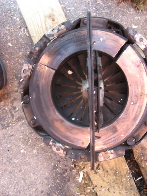

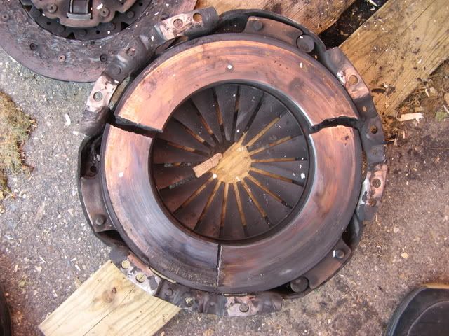

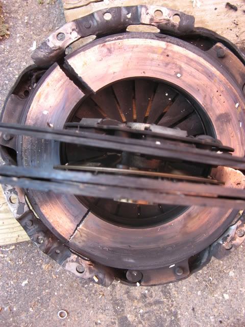

I found the problume lol anyone every brake the cluch plate before lol
pic in a few

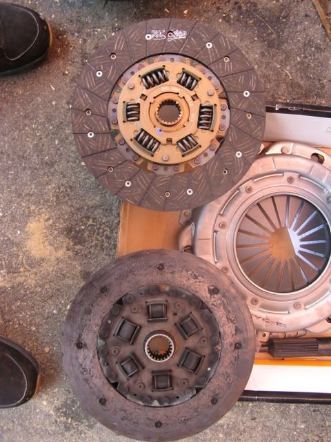

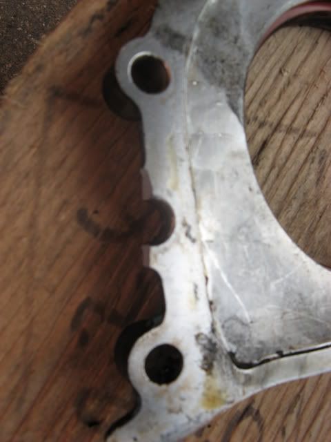

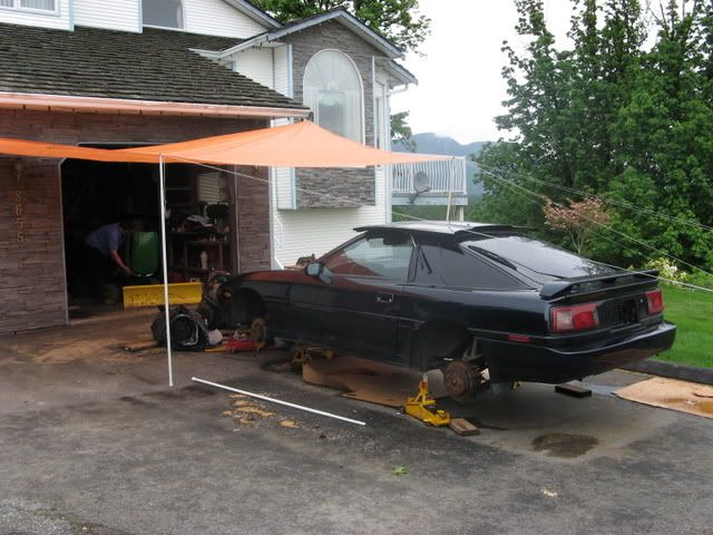

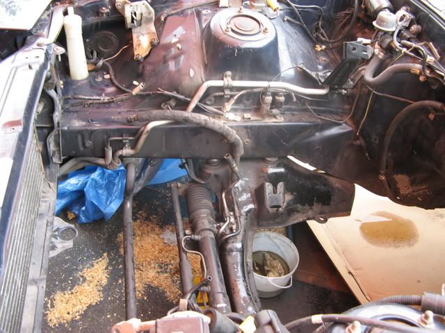

ok here the pic's
its kinda broken :p
heres a comparison

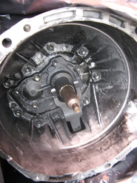

heres the tranny

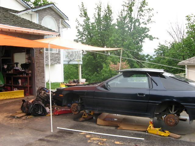

my make shift shelter
and my new problum

well I priced that line from Champion Toyota. It was like $225or $275. Either way is was totally rediculous! You can either get a braided line from Driftmotion for $100 or if you have a hydraulic shop near you, you can get the a new rubber line put on yours. Good luck

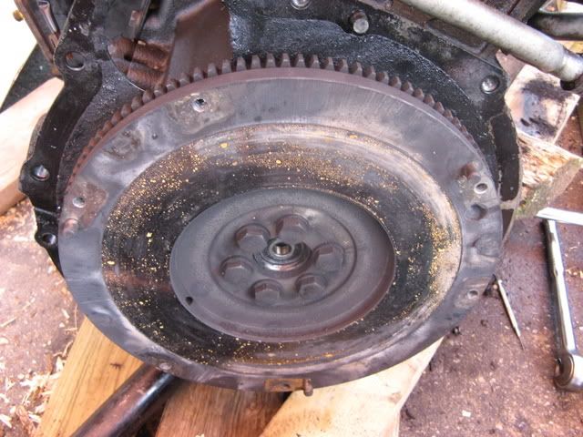

toby should i get the fly wheel reserfaced?
No im not kidding! I was kinda suprised at first to. But when you think about it, it is a toyota part and it is high pressure. That why I would have to go through complete hell trying to remove something before I cut it. Try finding a hydraulic shop and get both hose ends replaced since you have to take it off anyway. But I bet it will cost you more to do that then to get a new braided line made up like driftmotion sells. Or just buy theres. Its $100 cheaper

Getting a FW resurfaced is only like 40 bucks, so it's worth it IMO. But, if you don't have any burn marks (like a deep blue/black metallic look) or cracking on the surface (you shouldn't be able to catch your thumb nail on anything) then it'll be OK.
But then again, if you want that clutch to last like it's supposed to and to break in evenly then just get it done :)
