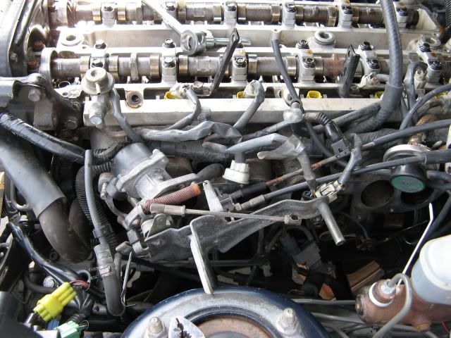

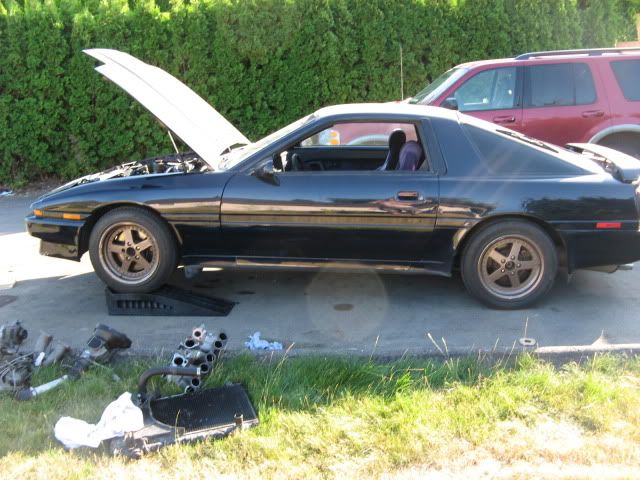

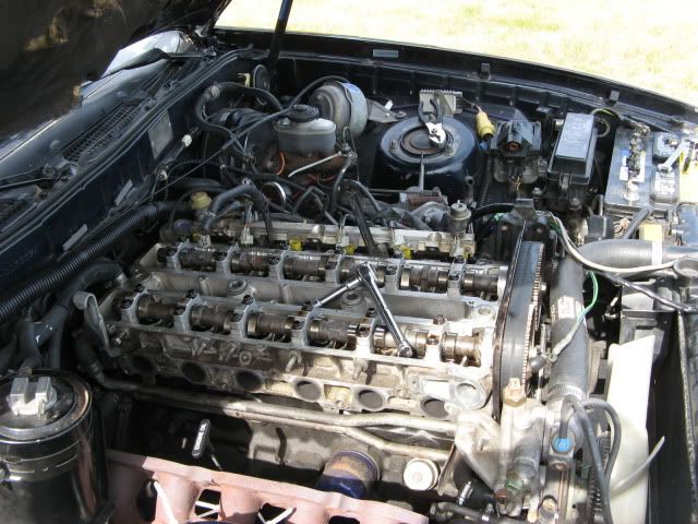

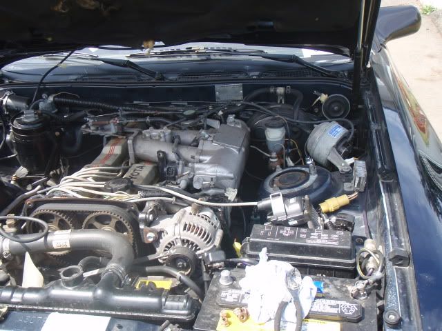

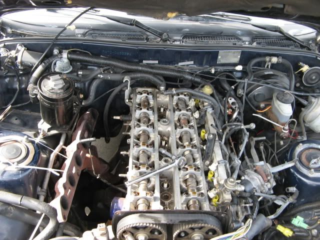

started taking intake and what not off taking here slow gonna start to crack down and get stuff done tommorow
just a pic of what it looking like as of yesterday (took off y pipe and alternator today)

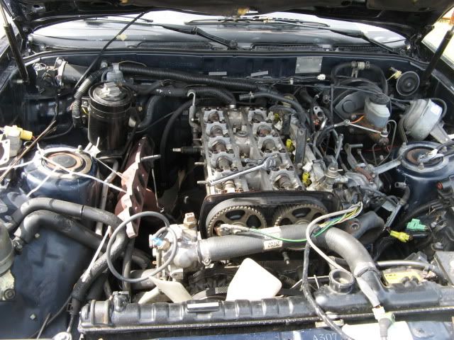

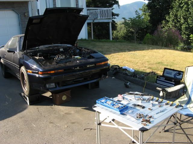

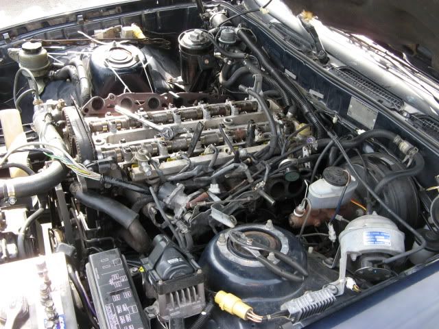

got every thing off down to the vale covers ill grab pis as soon as my camras charged. just came inside to update and grab a beer.

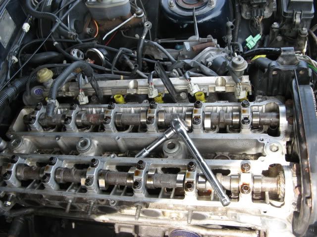

so hears the deal got 11 outta the 12 head bolts crack and read to take out exept one that is stipeded behond repair does anyone have any suggestions?

so I got an idea last night when I was drinking. Could i not take and 11mm tap and tap out the center of the 10mm now round hex key hole then thread a bolt in to the hole and get it out that way?

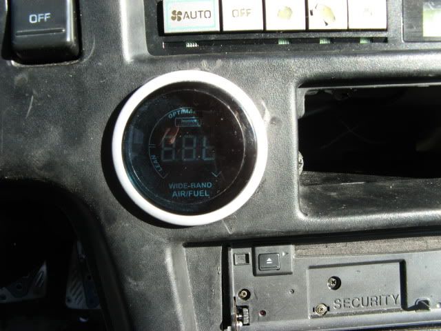

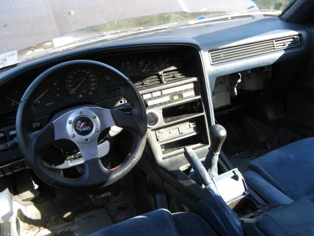

got my prosport wide band gauge installed looks good. Other add ons incluse the TRD shift nob i got for 30 bucks from toyota about a months ago and the wheels i got from my buddie Justingota1j about a year ago. hopefully will have some more things to add in the next 2 weeks may or may not need a new motor depending if i can get that last head bolt off
