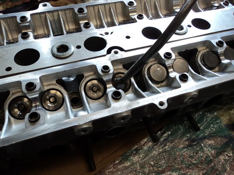

on a side note

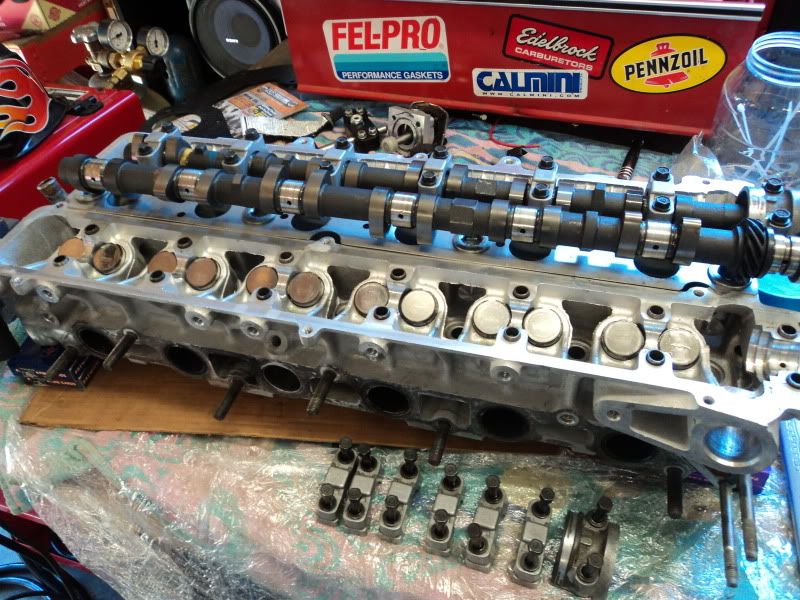

was installing my buckets and shims today and found out i had very sticky bucket so i made this tool and spun it with a little bit of assembly lube
might have got tiny bit tweek when she got welded
good to go now thou ( warning to other people never hone these with a stone or file since there anodized) what i did was tad different

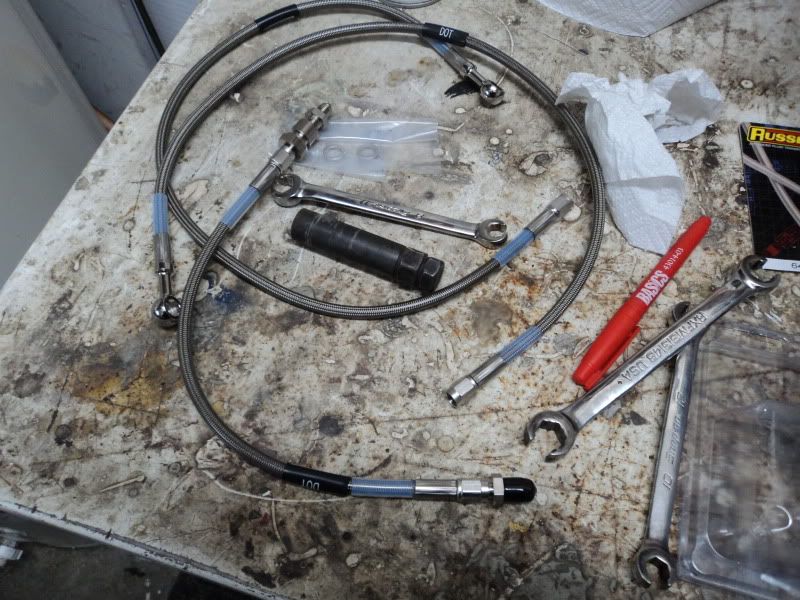

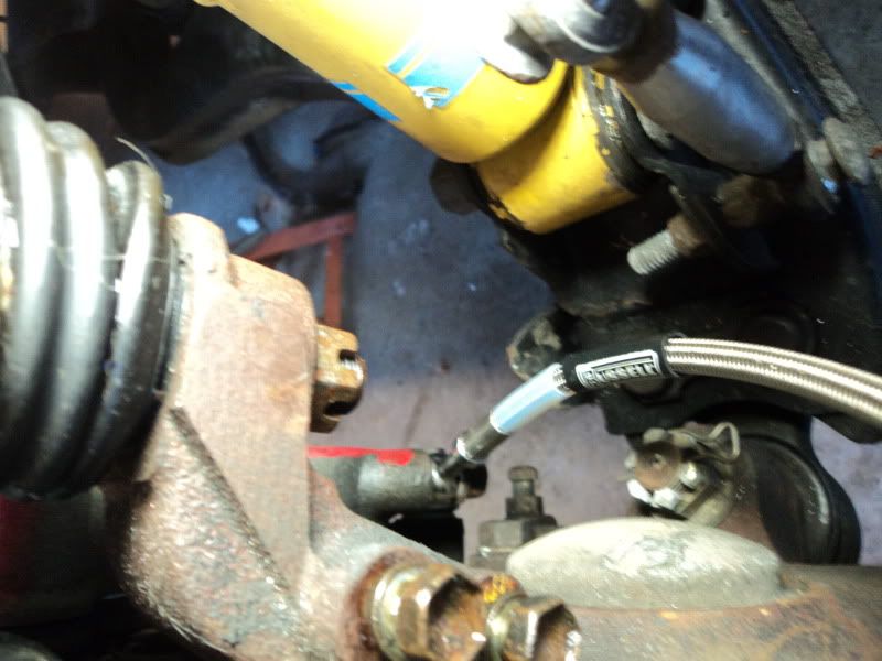

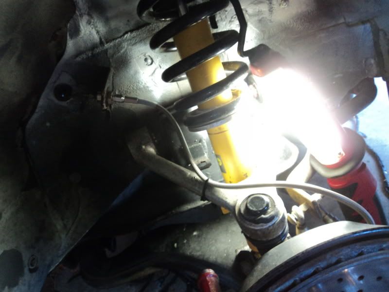

well whent back and worked on the head and shorted out my brake lines just uni set with adptors cost alot less then buying a set made for the car

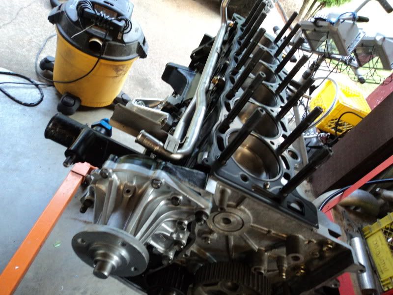

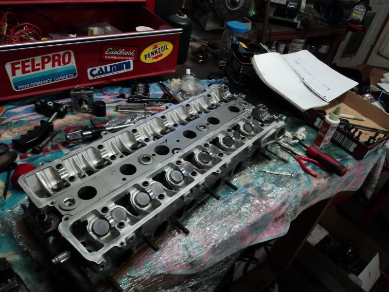

well head is done i all ways find it faster to do it as a team makes shit allot faster

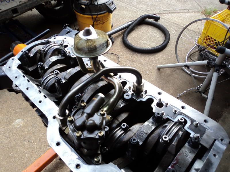

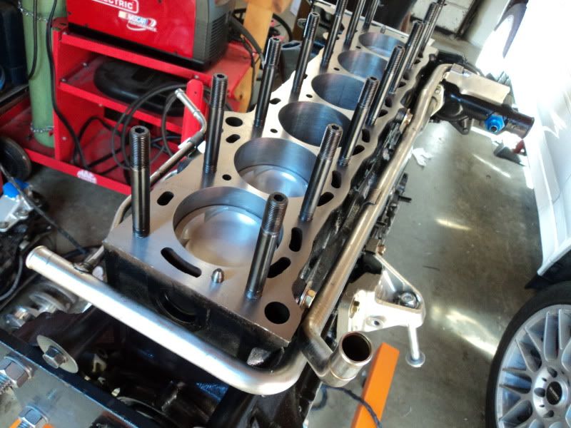

painted my block
clarence my oil pump pickup some as well it about 1/2 to 3/4 from tube to floor

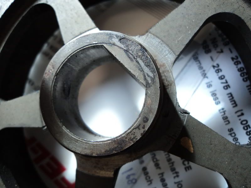

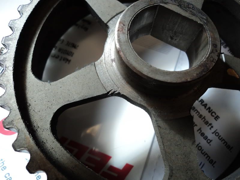

oh and i went to put my oil pump gear on and found this this is factory as well so i de bured it with a die grinder and then sanded it away to prevent it from cracking

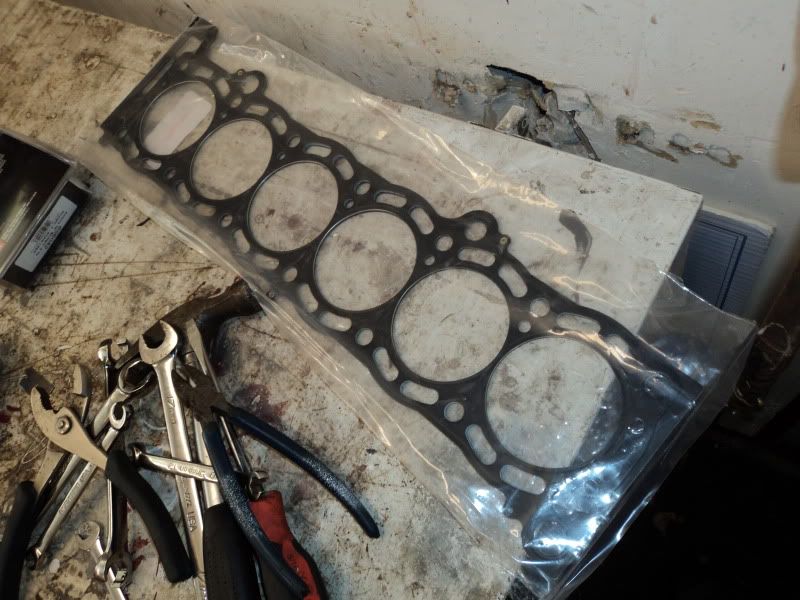

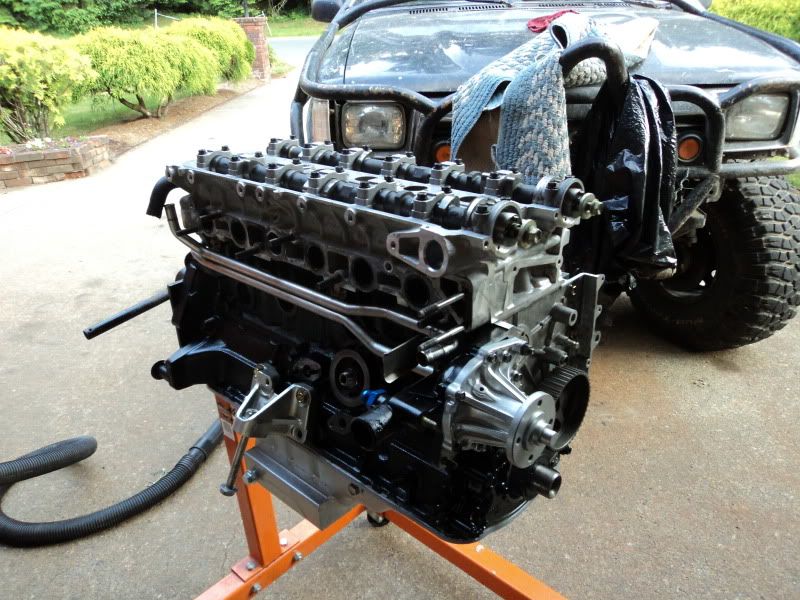

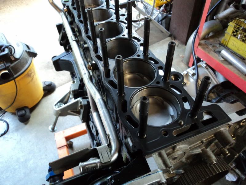

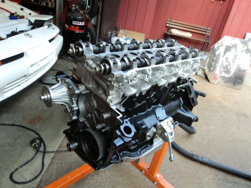

well some time has past my heag gasket came in and it was not bent this time woot woot
stuff
done brake lines fuly install

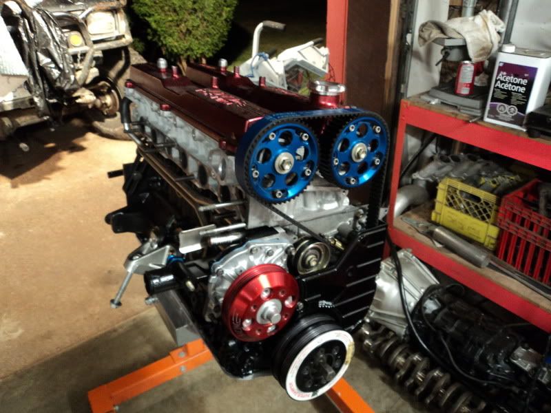

long block complete
msd window switch fully installed
replaced my acsumspe vavle the old one was leaking
what to do today install more make a crank stop jigg so i can torq down my blacer then install trans and then build a new down pipe busy week end for me

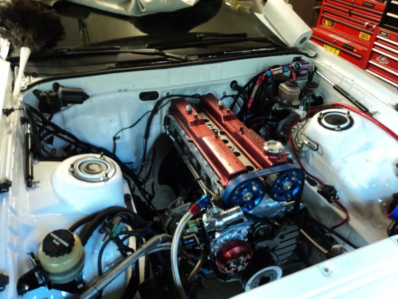

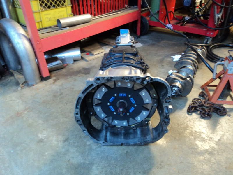

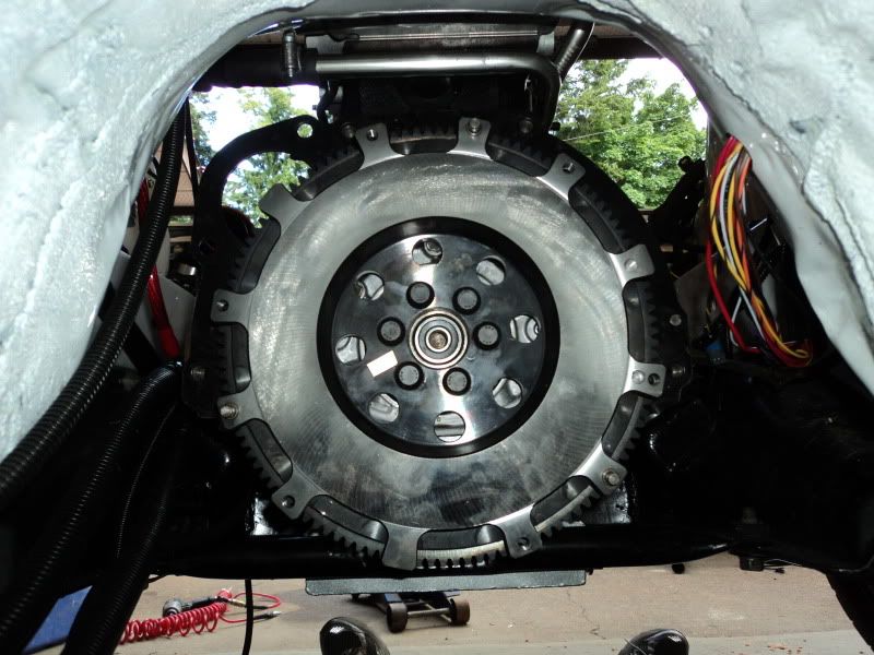

well fair amonte got done yesterday engine/trannie/rad is in and lots of miss stuff bolted up
pic's

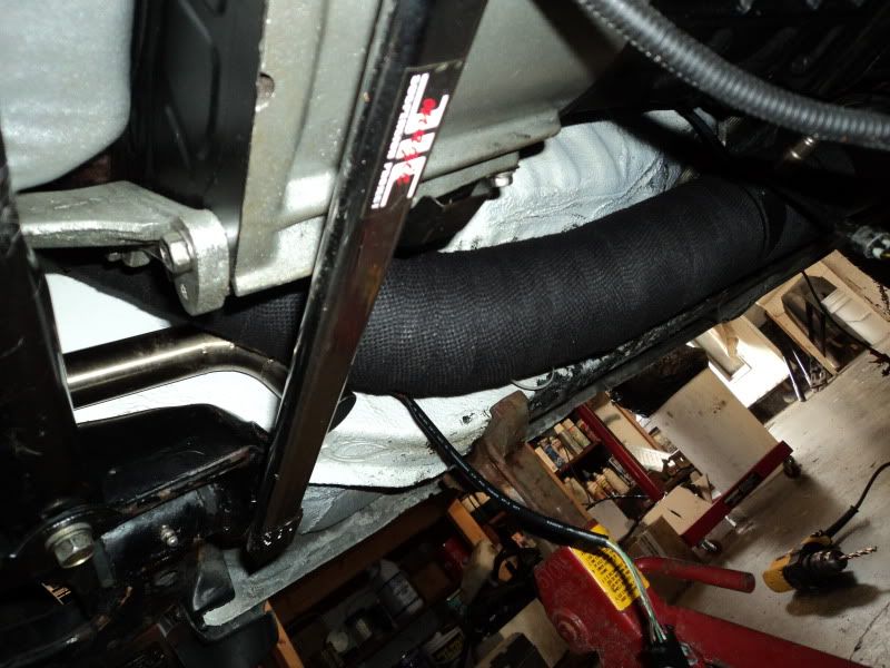

now all I have to do now is build down pipe and send it off to be coated since i rushed my last one and did not fit all to well

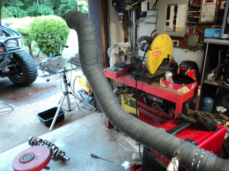

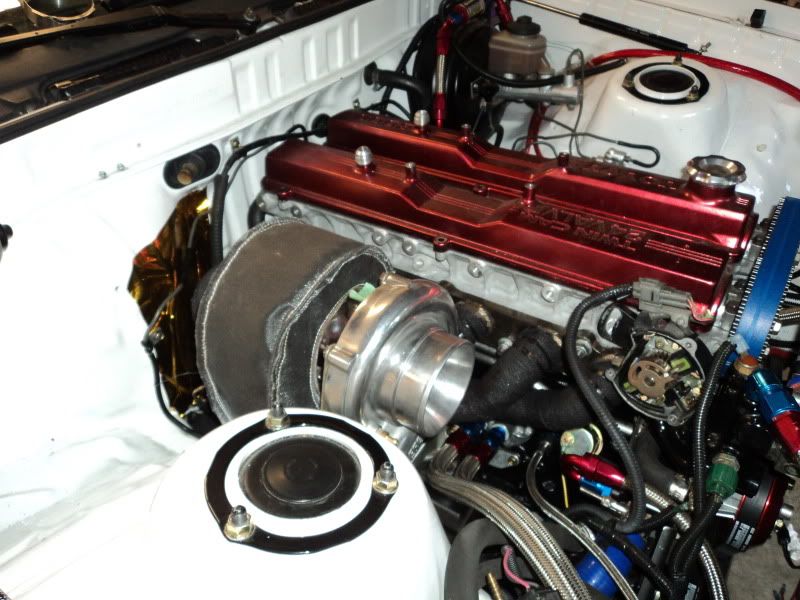

well got more stuff done

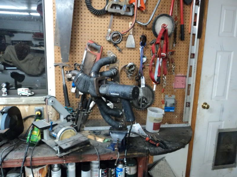

but skipped on the thermo coating since knowing my luck all never get it back in time so I just re wrapped it
I made a new down pipe this time around witch fit's and flows a tone better then the last pile of rushed shit I made
here is my old down pipe
