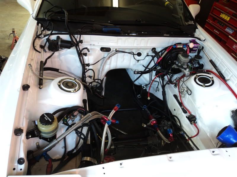

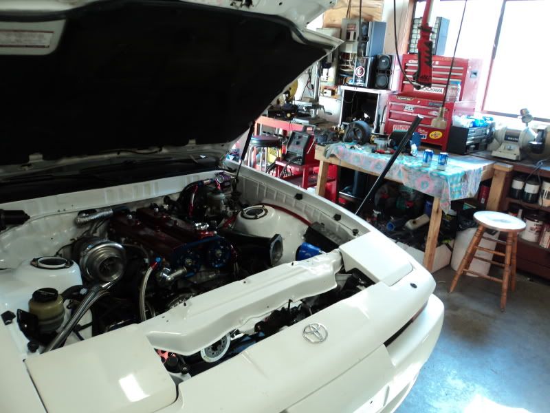

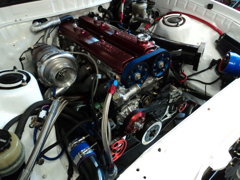

Well I got shit cleaned up and started to tear it down
I wounder what lies under that head ?

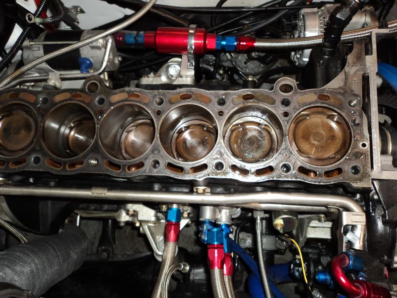

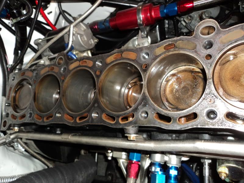

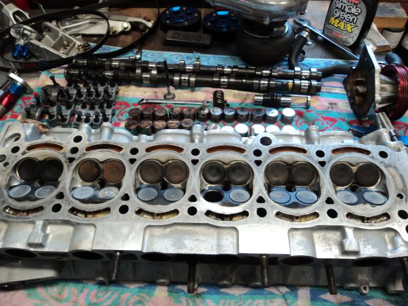

well turns out 585 is just tad to much for the stock rings with over 180 plus k on them
they simply just deseated them self's since there is no abnormale ware on the cyc bores
from crush ring land or cracked ring
I did notice I going to have to send off my header and down pipe toi be coated to cut down on the heat since the header wrap is not cutting it (shit glows cherry)
Stay tuned I got some pretty neat stuff that is going to make this beast into a monster

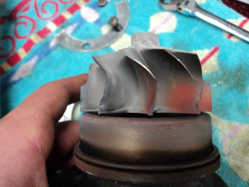

SON OF A BITCH
well turns out my turbine wheel has sean some crap it not to bad but still fuck .............
gonna call PTE tomorrow
pic's

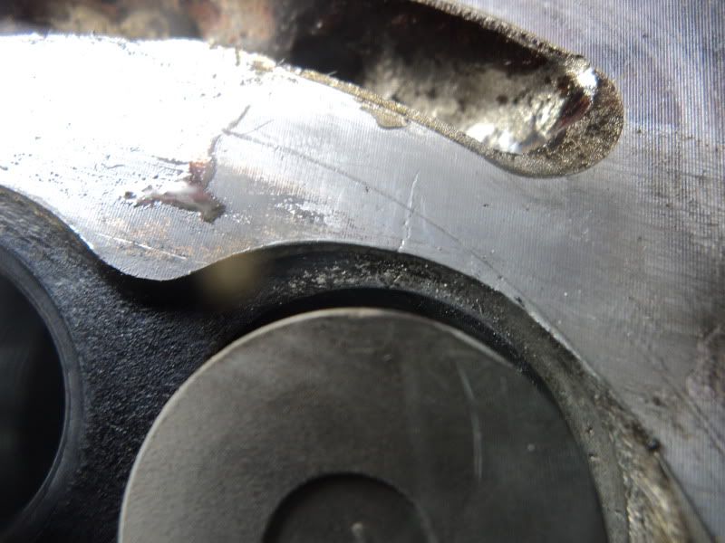

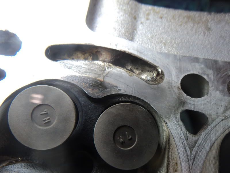

well I found another thing I did not like the other day
I foud crack in my head oh well so now that has to be fixed
grrrrrrrr

well got some stuff done and got some nice close up's of the crack as well so on tues day off to the muchine shop she goes
now the crack grrrrr

well head ready just dropped it off at buddies place to be welded and to pull the seat out so it can be fixed
i might be porting it some more and ccing the head as well even thou it has been done all ready

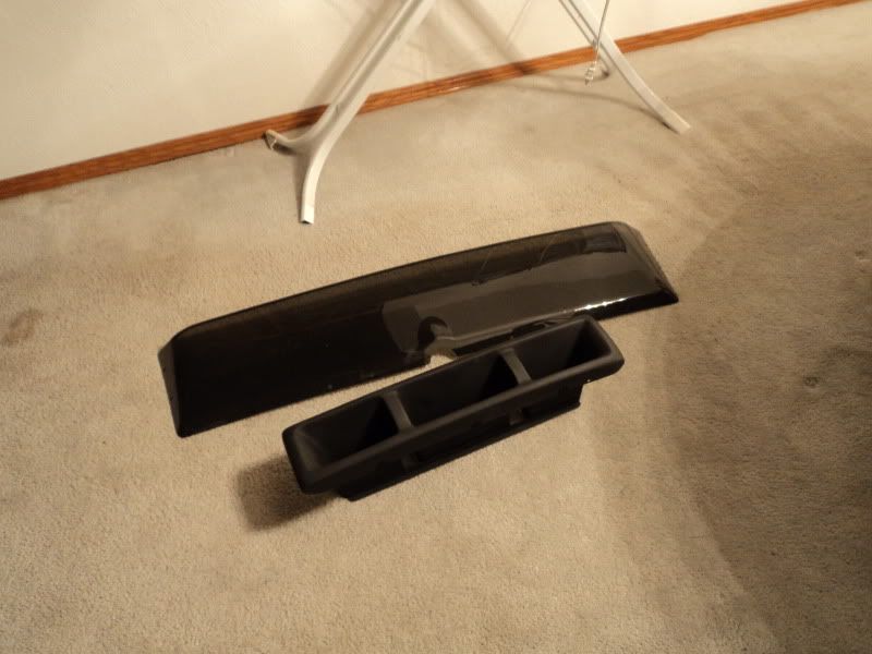

this stuff I just got in the mail, the sun shad I had for ait but still both of them are rad and are well made
NashMan
WTF did he just wright ?
Aug 5, 2005
4,940
17
Victoria BC
reason being is i just do have the money right now (brokestudent) fixing is cheaper then re cutting a hole new head
if i have issue i can all ways swap the head off later on
plus the place that is fixing it will tell me if it is pile of shit before they work on it
