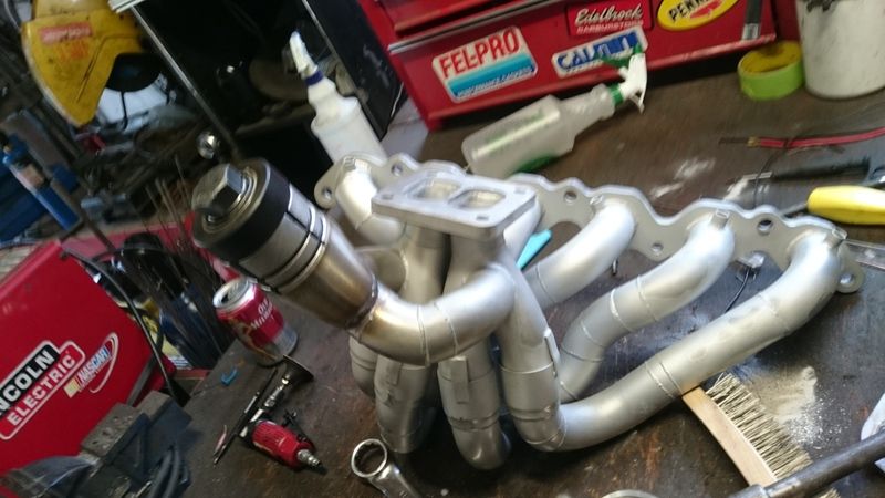

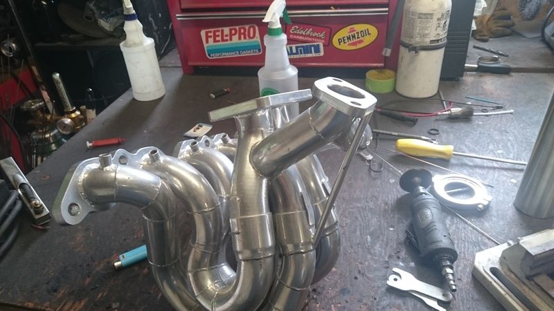

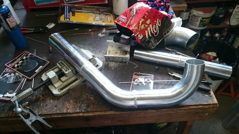

Well I have order a bunch of junk and did some work oh the fun
aww looks it so cute

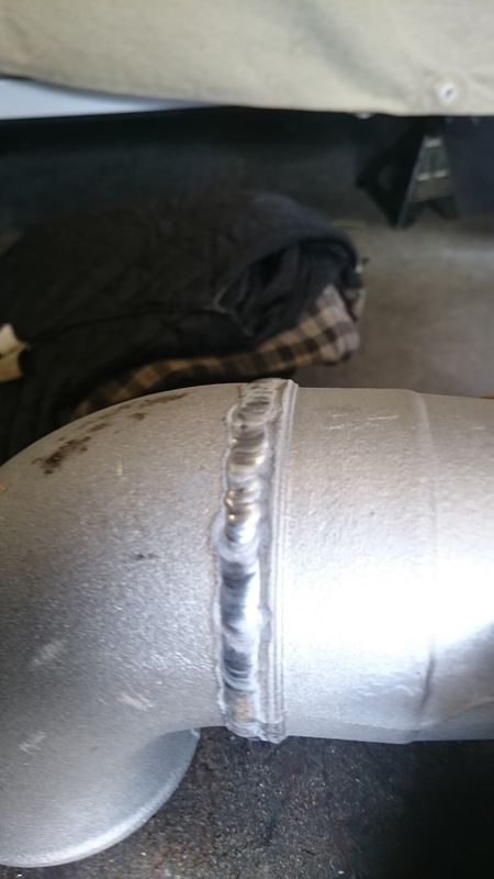

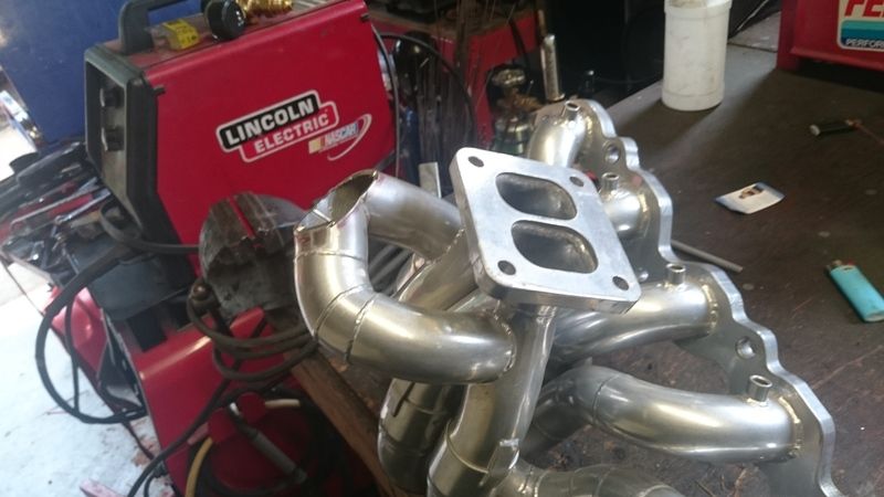

then I chopped it's bloody head off
2.5 inch pipe oveld then re rounded again
it's been a wail
and that's it for now

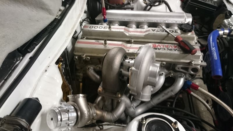

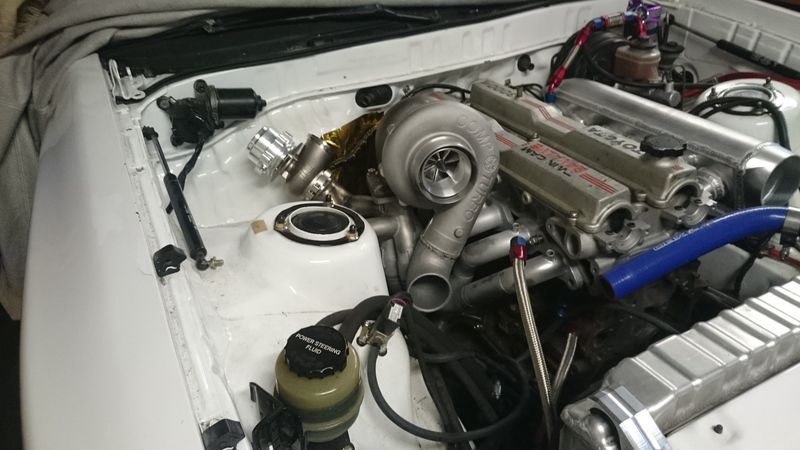

Hey Ryan, good to see you coming back to your build.
Very nice work on the head!
Nice cam, but to much duration to my taste.. I prefer mine:
I see shimless buckets. Have you installed ARP inserts in the head bolt holes?

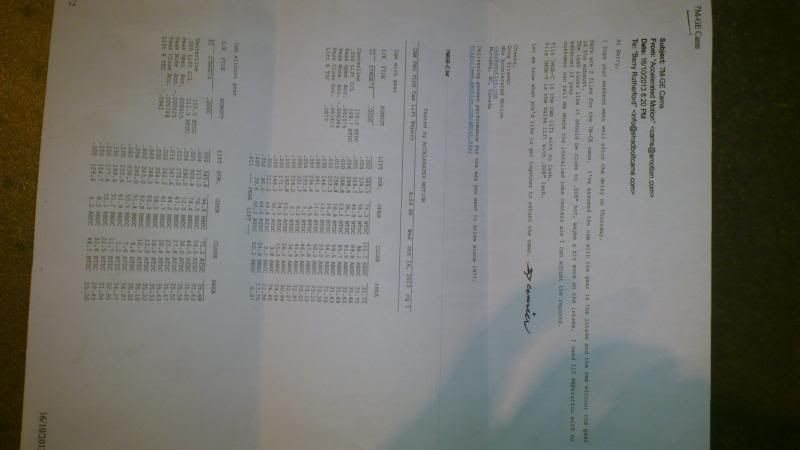

Yes but I have more lift
I posted the spec's see if can get them again
@50 we have a nice number of 236.7 dur and peek lift is 411 (10.4mm) (stock is 201 @50 and 7.54 of lift)
this is with cam gear what ever that means cause there are 2 spec's
so really these are really high rpm cam shaft and will be perfect for the 9000 rpm motor I am building
now there so much over lap that i wounder if i might need to use a vacume pump
for fun here is he biggest cam for the 7mgte by brain cower
http://www.briancrower.com/makes/toyota/cam_card/bc_0322.pdf
dur @ 50 is 226 and peak lift is 8.6
brain cowers full blow race cam for the 2jz
http://www.briancrower.com/makes/toyota/cam_card/bc_0303.pdf
@50 232 and a lift of 11.48
so ya these cams are pretty big

Yep I remember your spec, we have discussed about it on FB, pics are also on your SF thread.
Here are my specs:
Close lift, shorter duration

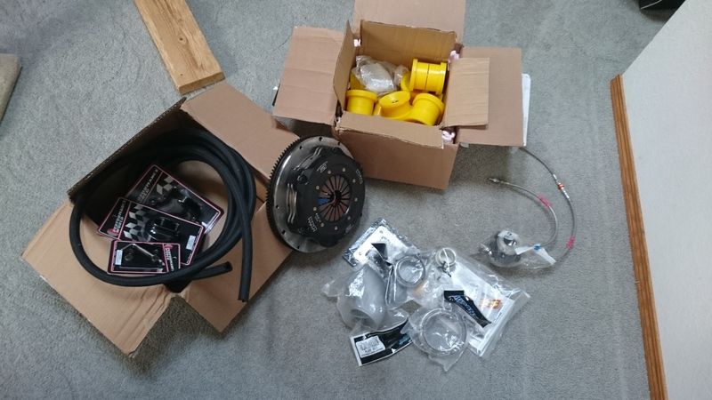

My Ronni K yellow bushing are here for my sub frames
time to get rid of the temp solid spacers i have

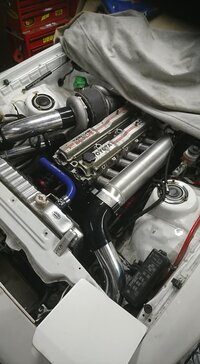

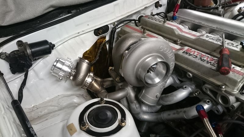

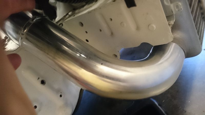

Well turns out I will be building 2 cars at the same time
doing a foreword facing intake manifold, inter cooler, piping install and map ecu
wail doing mine
but some shit came in and now i can start working on my car and this is what I have gotten done so far
took apart my oil oil system and have these gems to play with

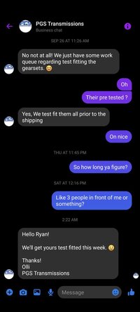

Got a reply back from PGS so excited they test fit each gear set before shipping them out and I have custom gear set for my 3.91 rear end as well
1st is 2.60 2nd 1.84 3rd 1.26 4th 1.0 5th 0.78 stock is
  • First Gear: 3.251:1
  • Second Gear: 1.955:1
  • Third Gear: 1.310:1
  • Fourth Gear: 1.00:1
  • Fifth Gear: 0.753:1
so I loose a little bit of top speed but meh I revving to 8500 possibly 9000 but my pauter rods are kinda heavy so we will see
