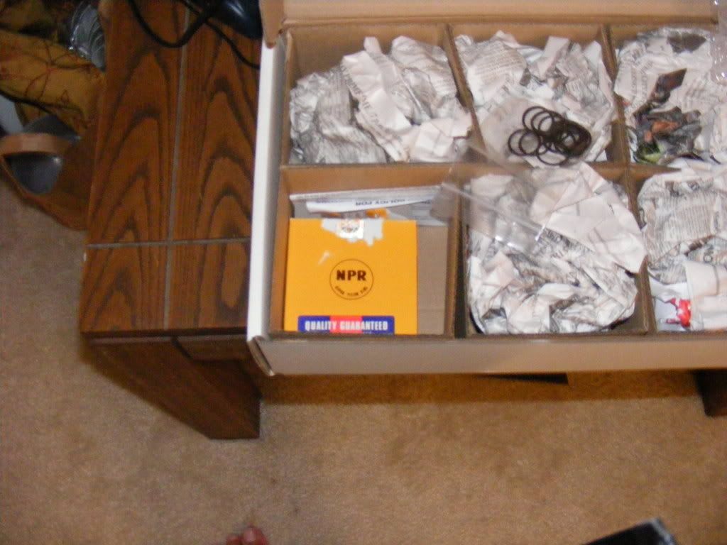

Rennat;1032677 said:

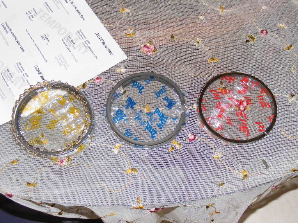

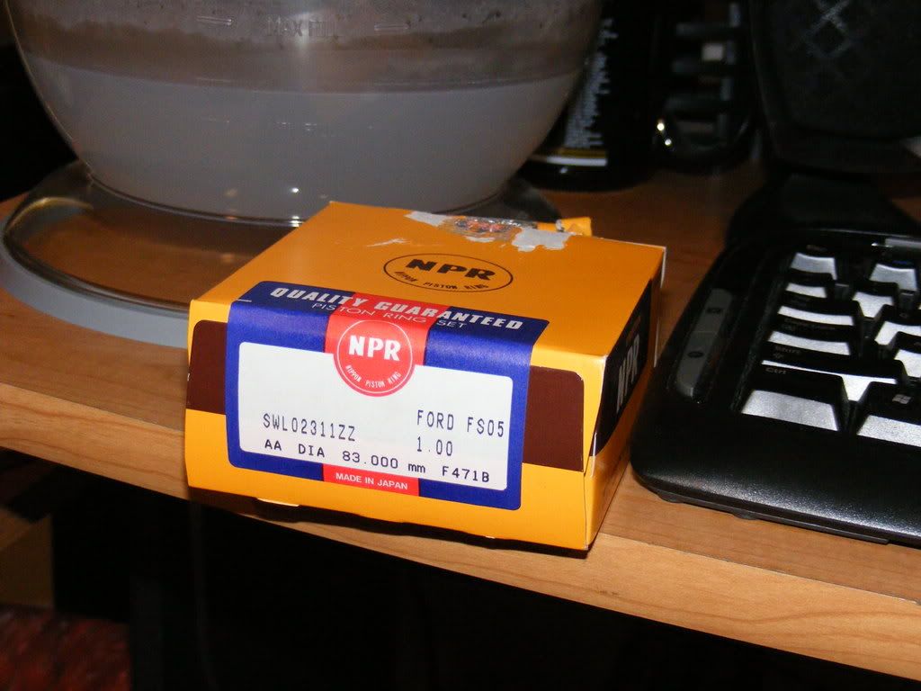

zum, could you take pics of your rings? because i have a picture of mine in the clear plastic wrap stuff, and i wouldnt mind comparing... i might even have the little bags too..
I'll do it Tomorrow after work. :)

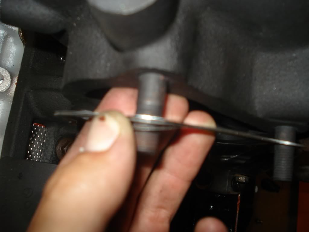

got my 3mm HKS head gasket in... not sure if i like it or not. but it got put on. haha
oil pump in. oil hose in. oil pick up in.
rear main seal in.
front case in
thermostat housing in with thermostat neck
head torqued down
egr cooler plate on
valve covers on with new bolts and crush washers.

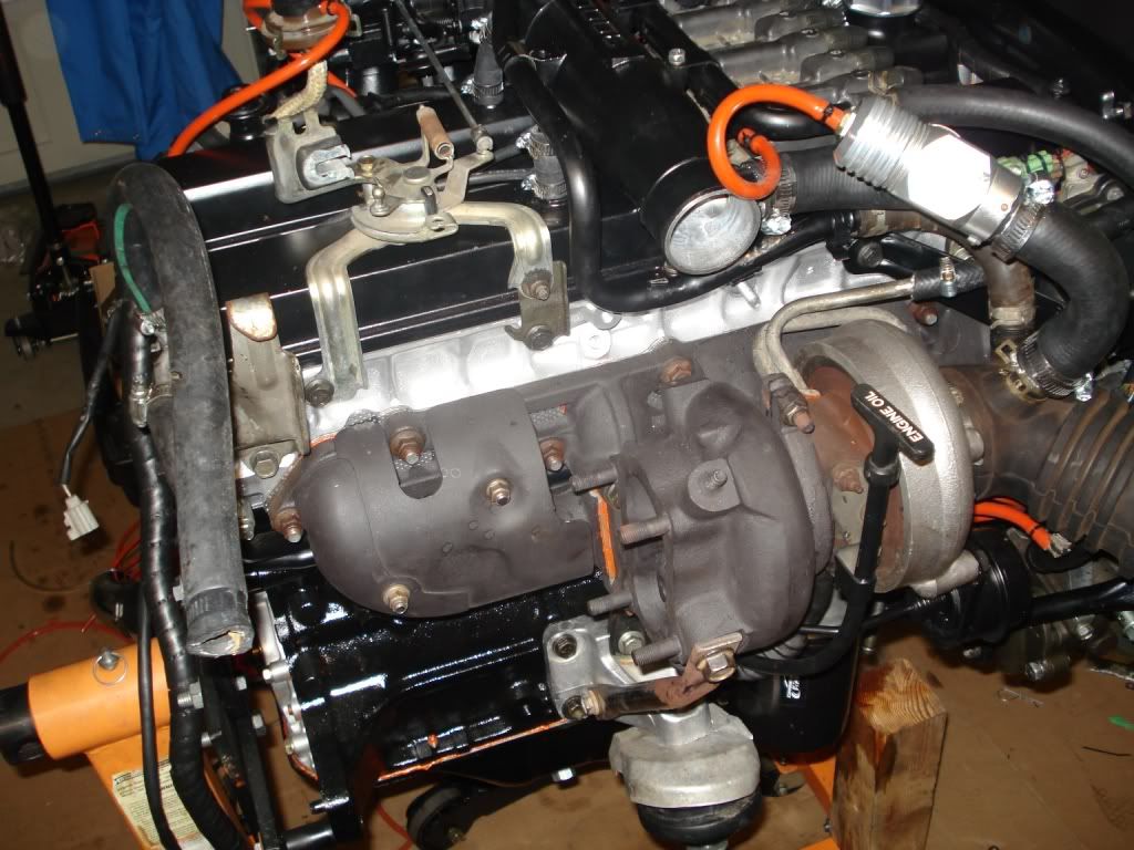

vavle covers on. new shiny flange head bolts with loctite and copper washers under neath. put all of the timing stuff on, just need to go buy a new timing belt tensioner. my dad ordered my 100 new bolts that were flange head for the oil pan, and another 100 bolts for the oil pan that were hex head... so i now have 200 bolts that are m8 by 16... lol
exhaust manifold is on. none of my studs neeeded to be replaced, i first tested all of them to 38 ft lbs. and they all held fine... so there was no need to do any work in that aspect. intake manifold goes on today. just have to go buy new bolts and what not.

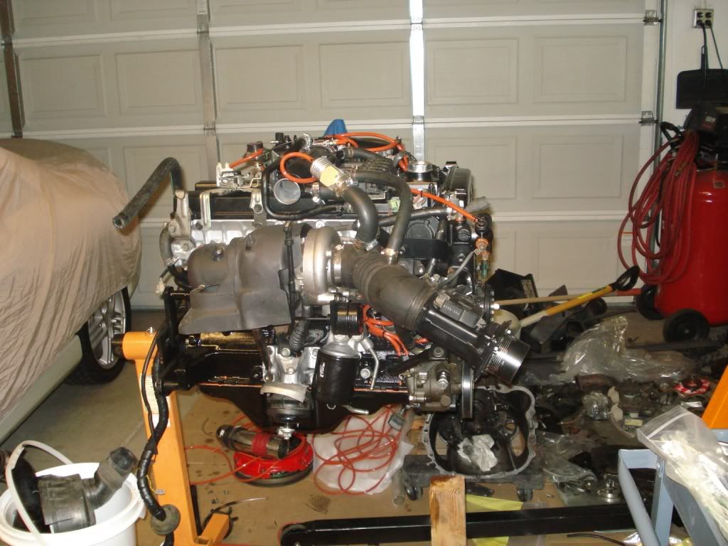

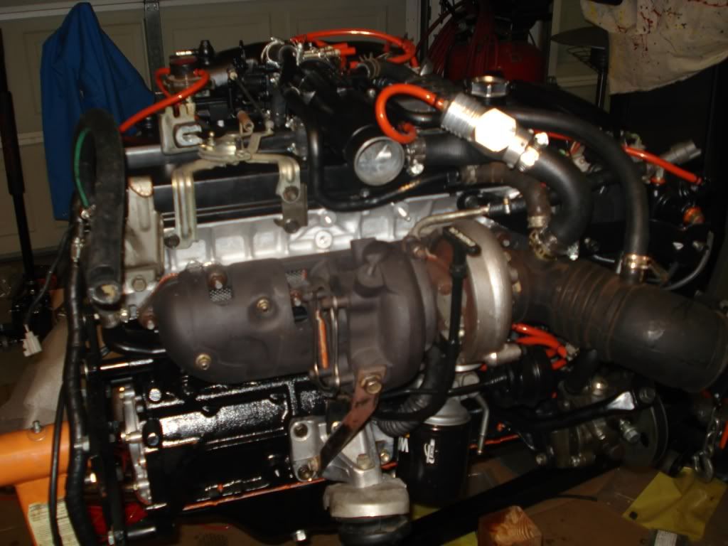

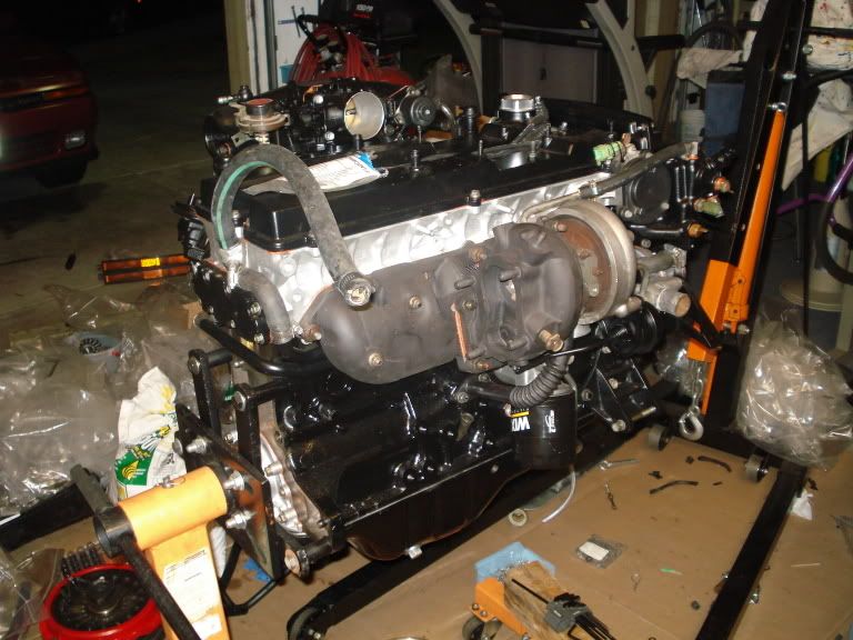

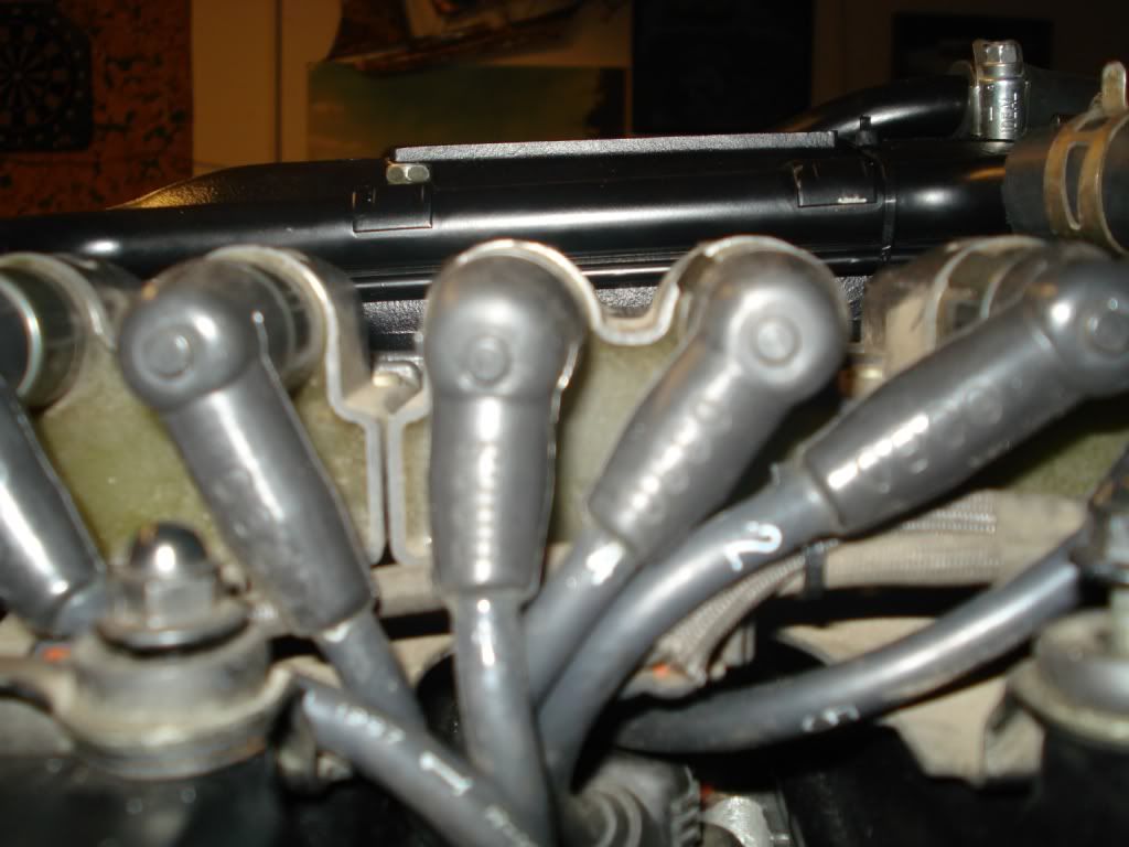

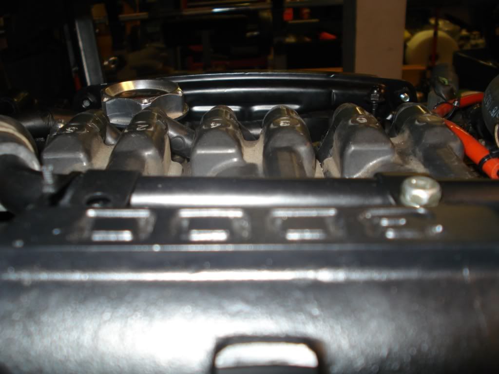

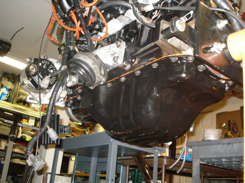

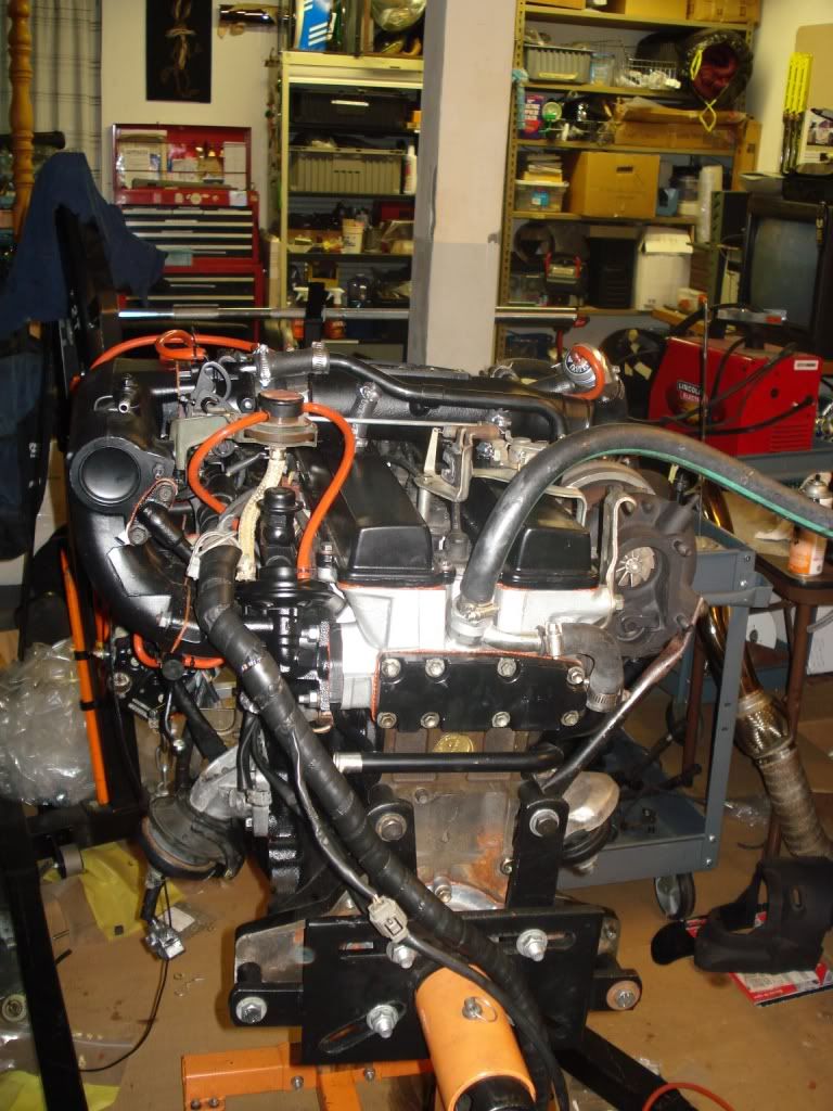

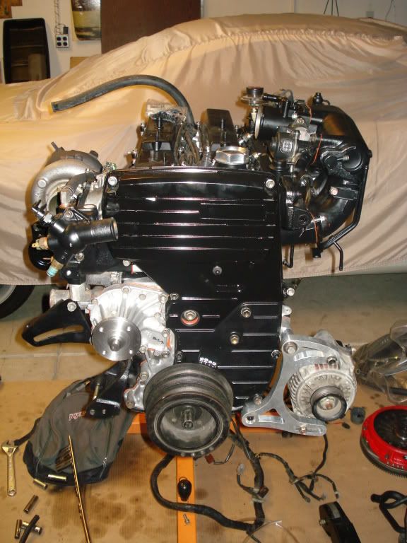

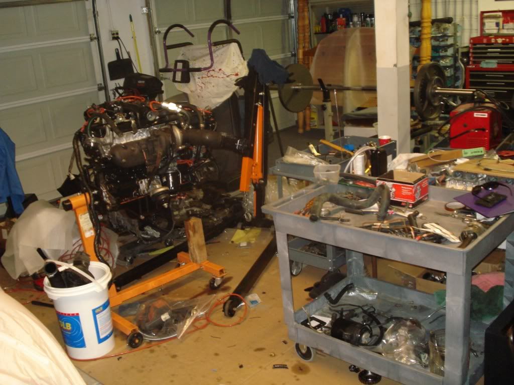

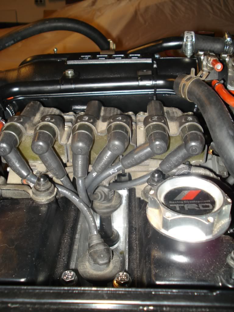

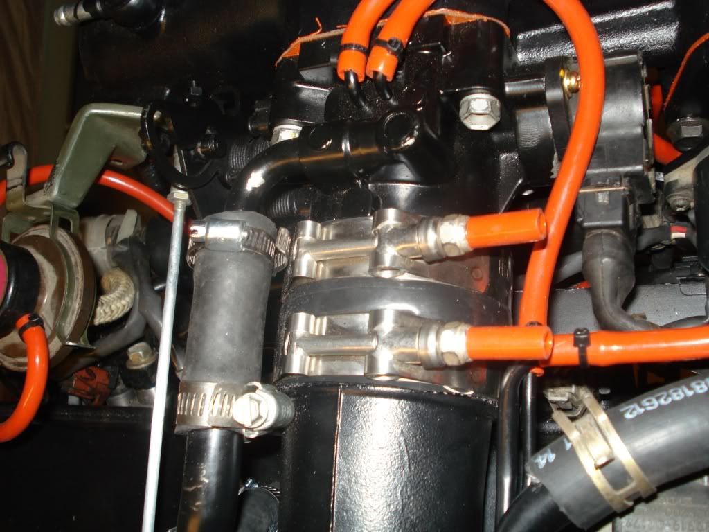

jesus... im horrible at updates. BUT. got tons of work done in the past week or two, lifes been busy, and this project car gets thrown to the back burner quite often.

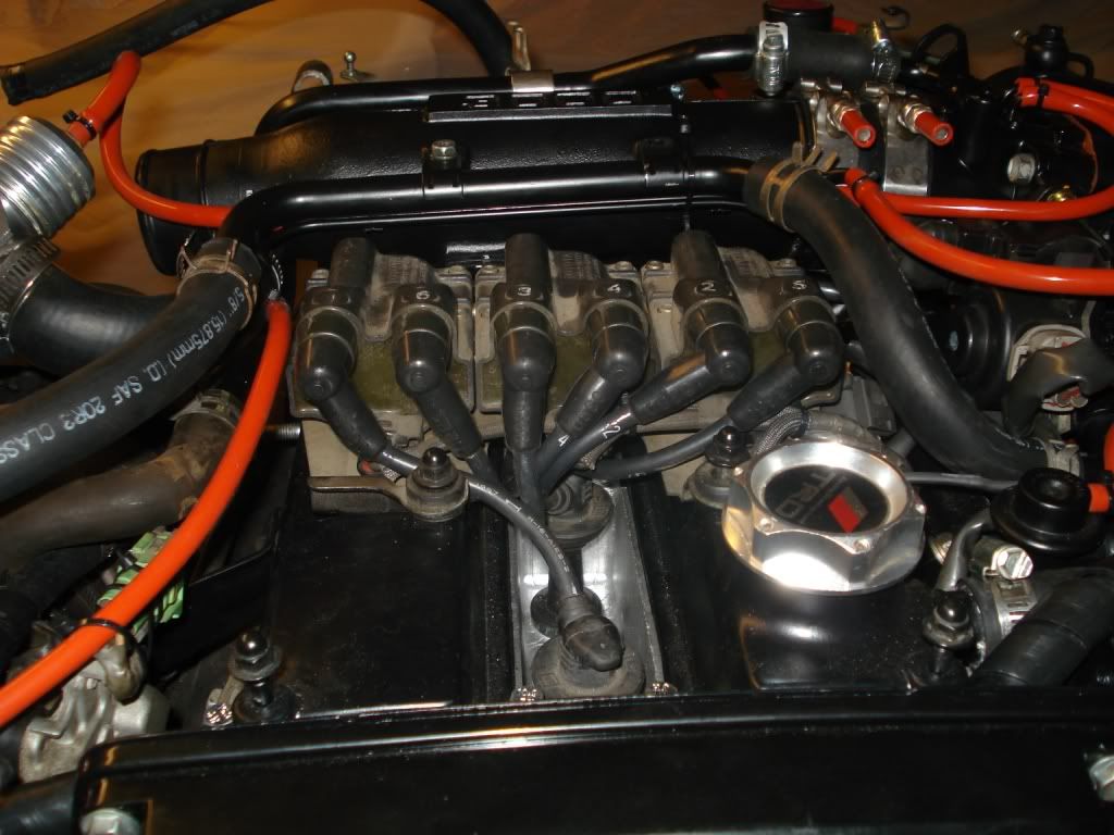

I had my dad order me some vacuum lines through his work at an industrial supply type place, well, my RED vacuum lines turned out to be ORANGE. so thats kinda gay, but i have enough vacuum lines to do 3 or 4 cars... lol

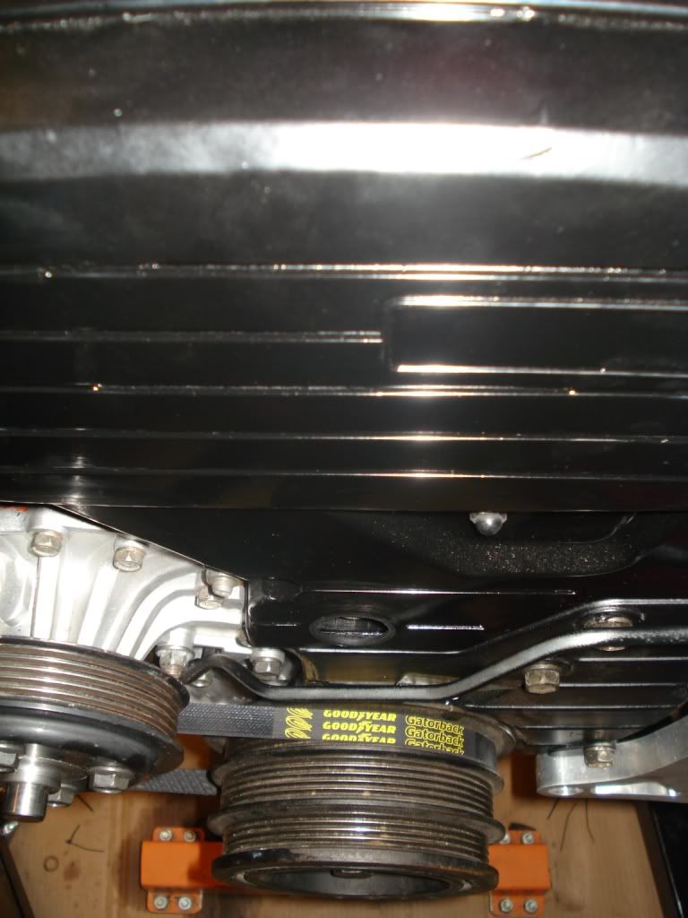

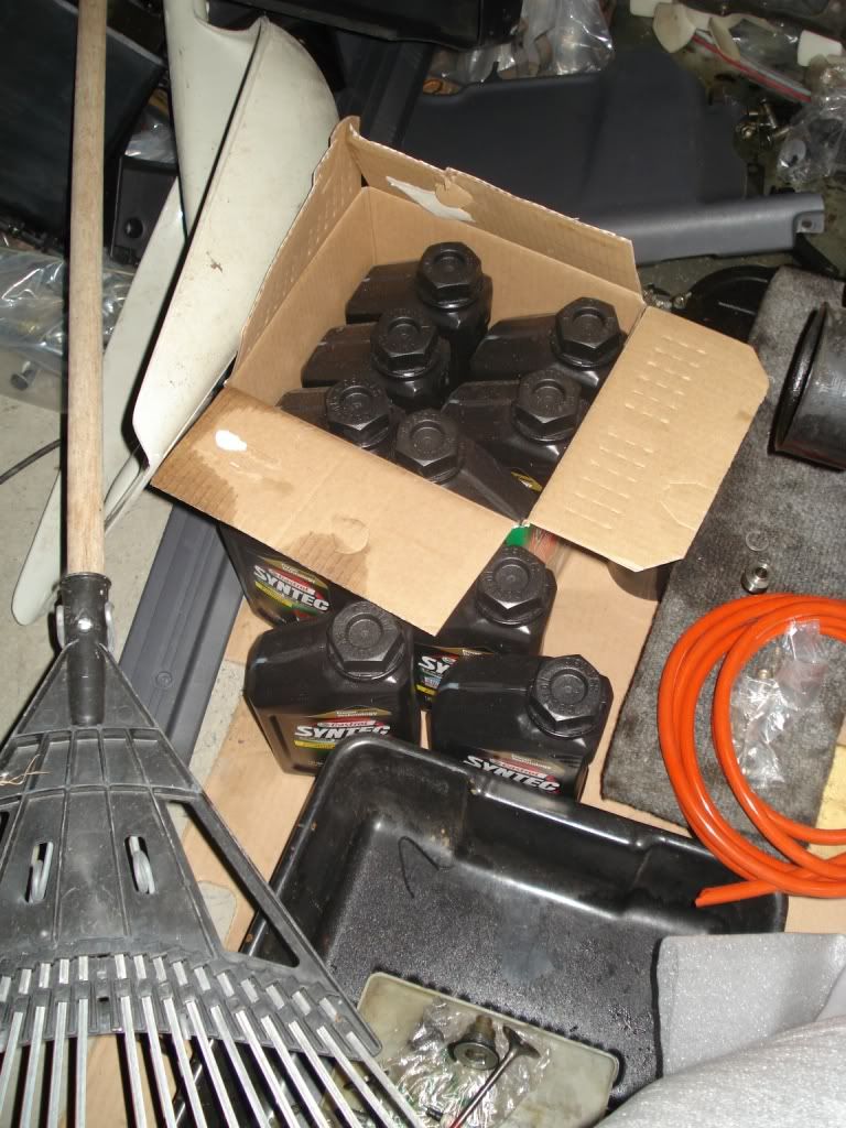

Oil pan was put on today, i also had my dad order me these serrated flange head bolts, so that way they DIG into the oil pan and wont back off, i've been using them all over the engine, and they work GOOD. Went to autozone like 400 times in the past two weeks i swear. got some belts, slave cylinder, hoses, more hoses, hose clamps, hoses, some more clamps, stocked up on GC 0w-30! none of the green though, but whatever.
although the pics dont show it, i reorganized the garage so my engine hoist is in the front (towards my house/bench) ready to hook up to the engine, with the engine right behind it, and then the tranny inline with it also, it looks pretty neat. i'll take a pic or two tomorrow when i get up to clean my transmission some more.

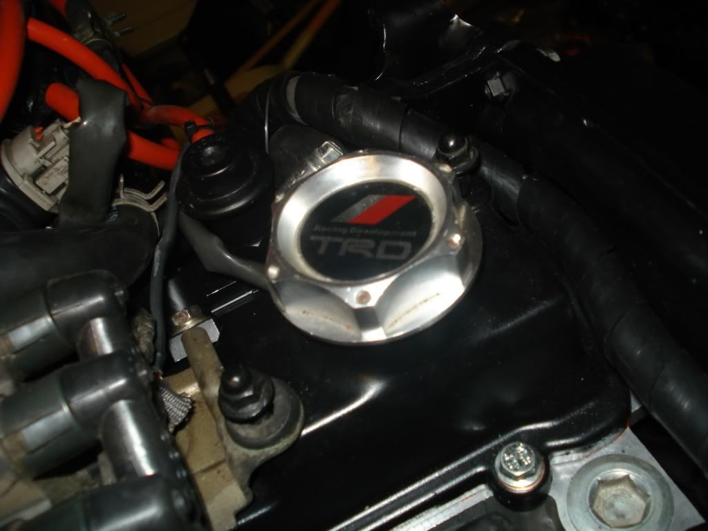

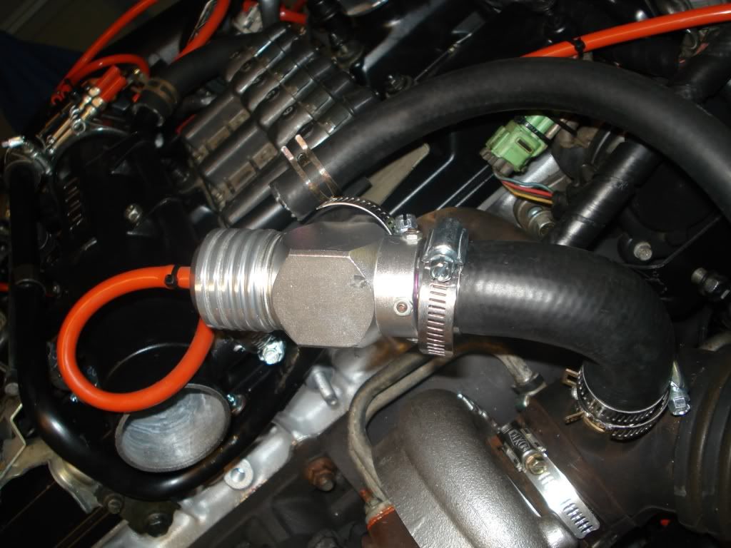

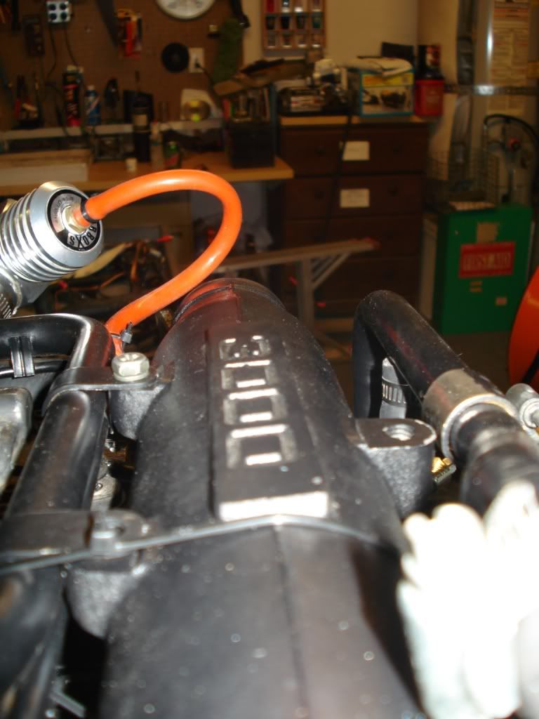

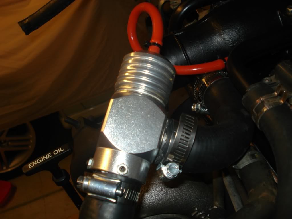

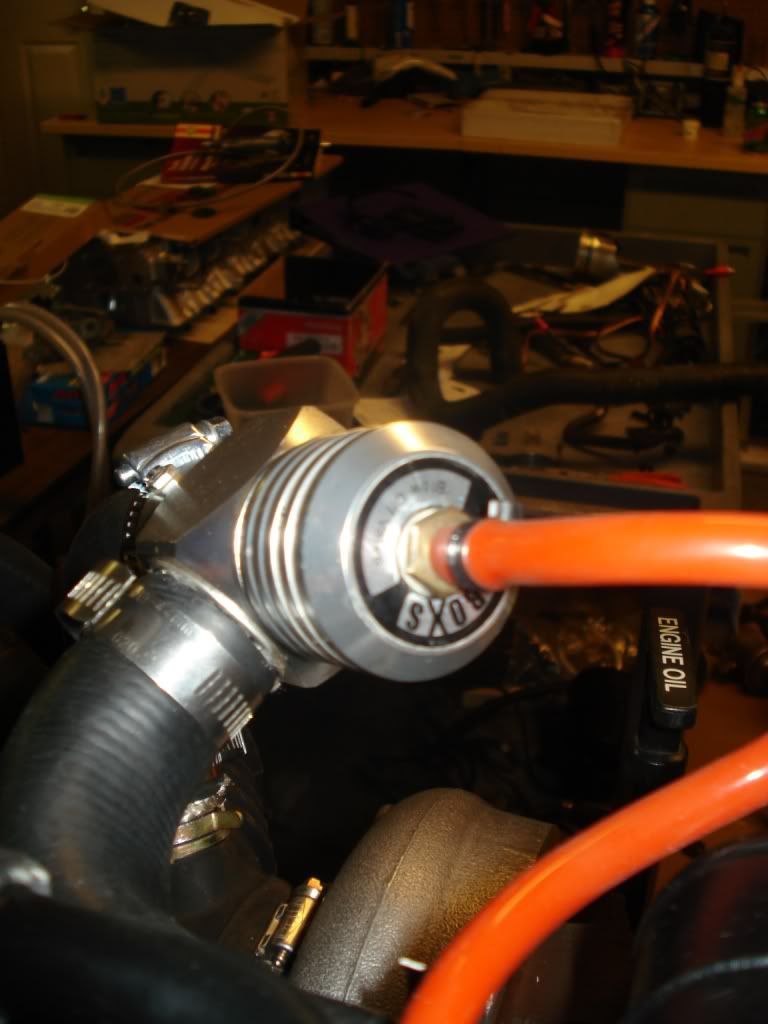

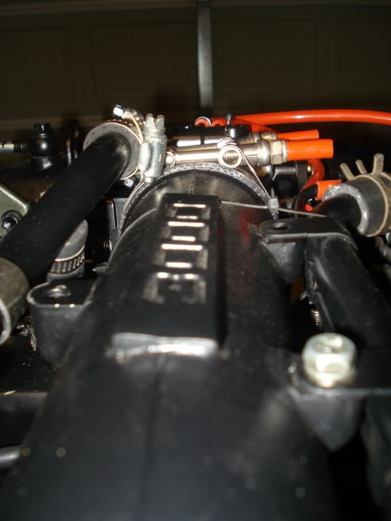

hooking up my turboxs BOV wasnt too bad, but doing those god damn valve cover hoses and the one on the TB were beyond gay.... took me quite a few tries to get it how i like. but it all got on, and everything is good. i made my own BIG vavle cover breather hose out of a 90 degree bend and some straight 3/4'' hose we had... and i used a brass 3/4'' piece to 'splice' them together, i think it looks a TON better than the big ass loop-de-loop that the OEM was (and it was harder than a ROCK) so all of my lines are new, not OEM, but i like how they all turned out.
also forgot to mention, i made up some 'custom' mounts for my 14'' fan i got from here, only had to drill two holes! and it holds the fan slightly off of the radiator (it has button top screw anyways) so it wont trash my radiator! i just hope it clears the water pump pulley, because the fan is a bit on the 'chunky' size... lol i'll probably get a different one later on. and im going to purchse a derale adjustable fan relay for it from summit, but thats after i get the car up and running...

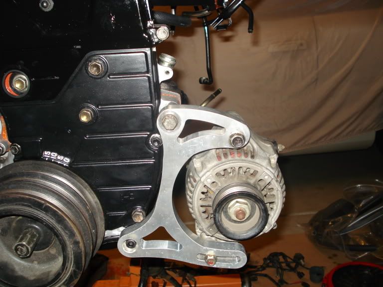

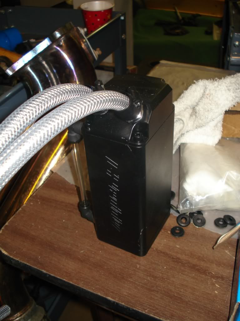

Well here are the pics, so enjoy!

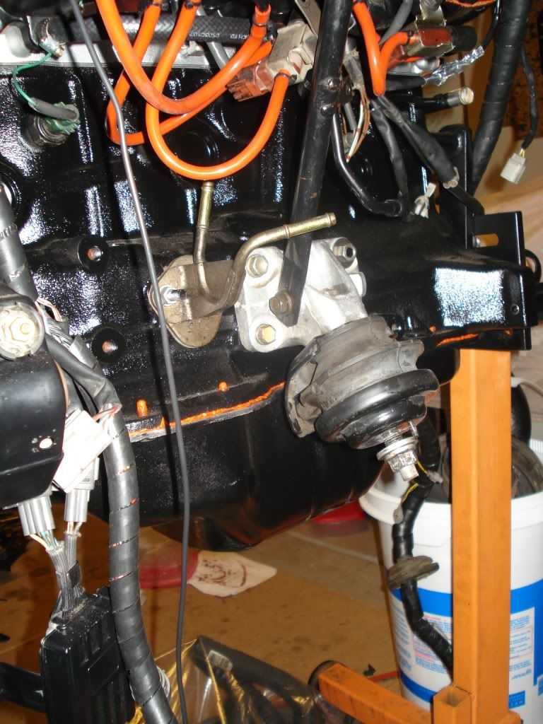

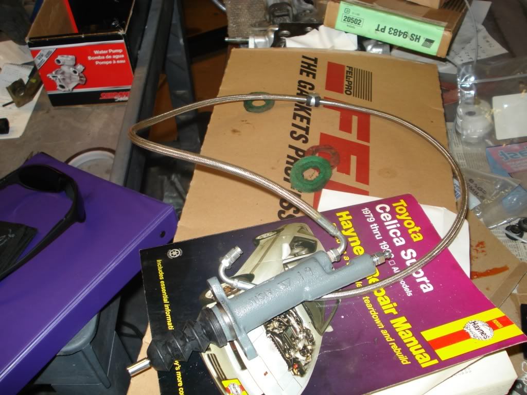

Engine is in.... trans mount took me forever, i felt retarded doing it becasuse i had to take it off like 4 times... so far i've only connected up the fuel return line....
dropping the engin ewas fairly easy, i put the transmission on by myself, along with most of the dropping in, but i had my dad help half way through just because i couldnt watch all of the angles and make sure it went into the mount holes. and i also put on the speedo cable, and SS clutch line from DM.

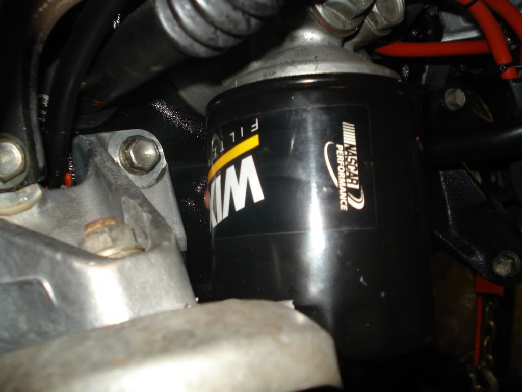

Replace the spring for pressure relief in the Oil Filter housing?

replace the spring? no... when i put it together there was plenty of force there.
