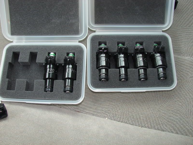

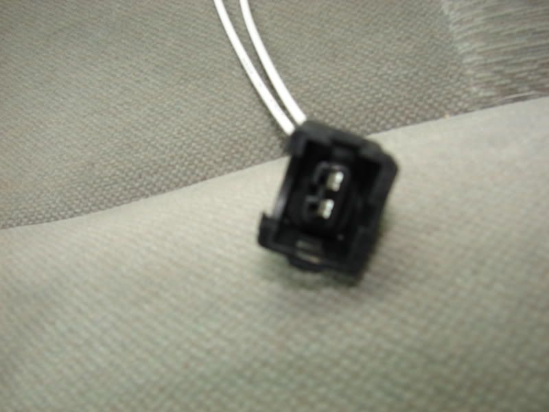

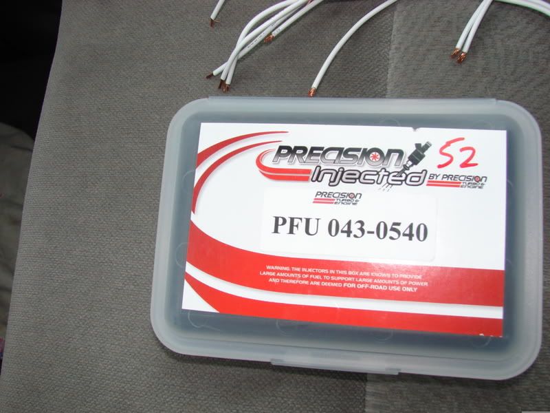

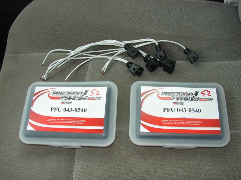

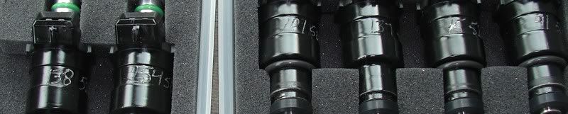

Well as promised..................I'm here with pics of my "PTE 550 Injectors" as purchased from Import Blowout Sales on Ebay. They were just delivered today. I opened them only for thee pictures, and will be sending them out to cleaninjectors.com as soon as I contact them (hopefully tomorrow). As was suggested earlier in this thread, the flow sheet is mysteriously missing. They came in nice PTE looking boxes, and are scribed, not stickered. The numbers scribed on them are all different, but all end in 457 (if that means anything). I have no reason to doubt that they are legit, other than what I have read in this thread. This thread has been very eye opening to me, and I hope that my pictures can give a little back to the community (good or bad). I will also be posting my flow sheets as soon as they come back.
http://i126.photobucket.com/albums/p87/forcedtorque/DSC00777.jpg
http://i126.photobucket.com/albums/p87/forcedtorque/DSC00777-1.jpg
http://i126.photobucket.com/albums/p87/forcedtorque/DSC00774.jpg
http://i126.photobucket.com/albums/p87/forcedtorque/DSC00775.jpg
http://i126.photobucket.com/albums/p87/forcedtorque/DSC00776.jpg
http://i126.photobucket.com/albums/p87/forcedtorque/DSC00778.jpg
Did they come with the flow chart as stated?
Edit* Nvm just read the description, well hopefully all goes well with flow test because im thinking of getting some myself but am unsure due what has been said, GL.
