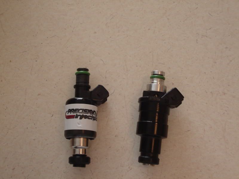

left is "PTE" 780cc injector from ebay.....right is "PTE" 550cc injector from ebay.
looks like the one on the left matches yours drj no?
these SAID they came with a flow sheet...however they did not...so billyM thanks for the cheap testing place....i want to just make sure

Idealsupra said:
...looks like the one on the left matches yours drj no?...
yups. that's a delphi or siemens injector. the 680 i posted is a delphi (IIRC?)....
as already stated, if it really is from PTE, they scribe in the flow rate and date ON the injector (see my above posted pic).
That is 100% the truth. PTE injectors from Precision Turbo never put stickers on their products.
Precision Turbo scribes all their products. Injectors, Turbos, Intercoolers, everything.

Ric said:
And the problem is, they are not. They might be from the same factory, but they are not the flow tested, garenteed, warrentee'd ones from Precision Turbo.
we will find out.
PTE ALWAYS 100% of the time enscribes the injectors. ALWAYS. If they do not have it then they are Delphi and NOT PTE.
what is the diff?
PTE buys delphi injectors then does thier testing and scribes them. Delphi on the other hand does not flow test or any of that. They just sell em and being mass producers, like any other statistics, they are bound to have crappy injectors out in the wild.
So
scribe = PTE
no Scribe = Delphi.
