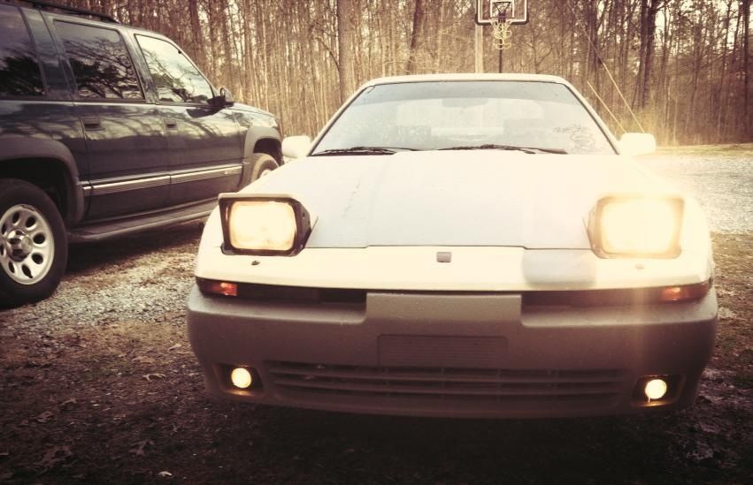

Es300 projector fog lights
Got these put back in
Pulled off two of these
And replaced them with these

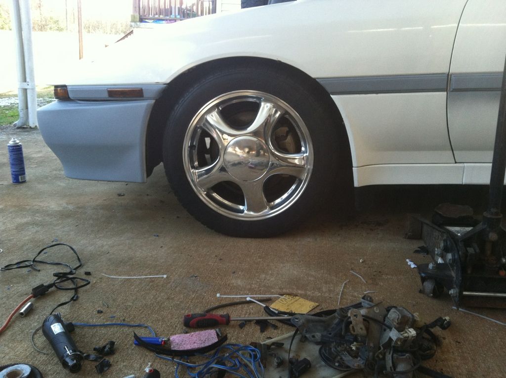

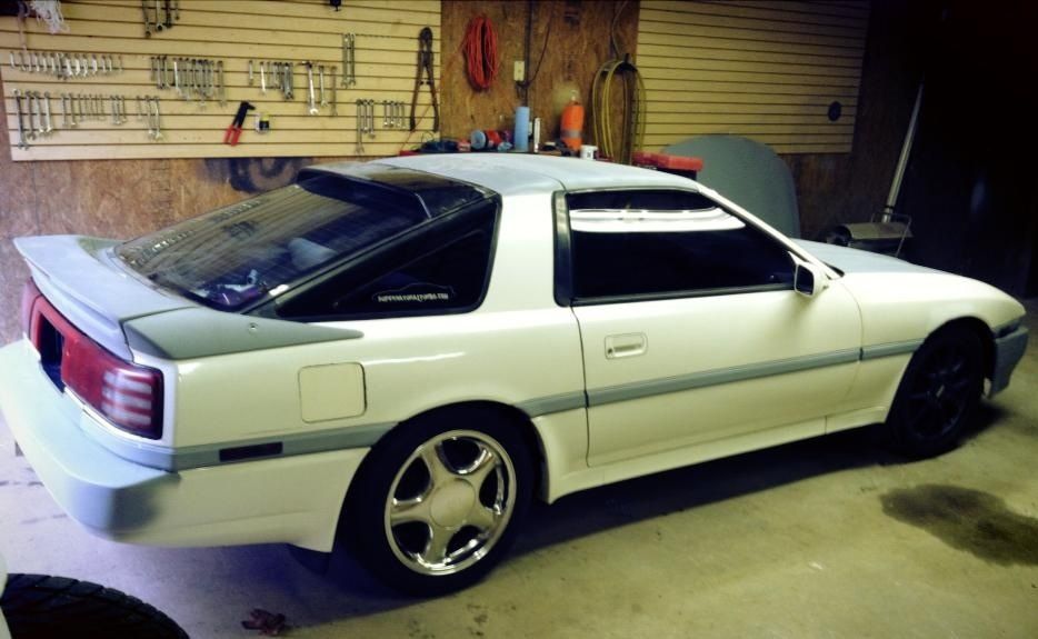

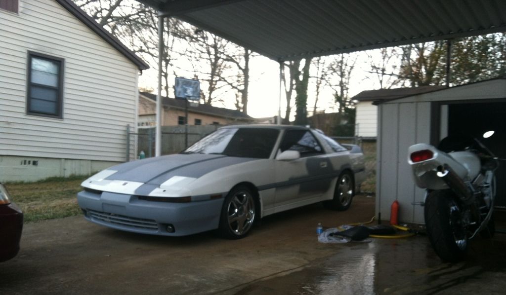

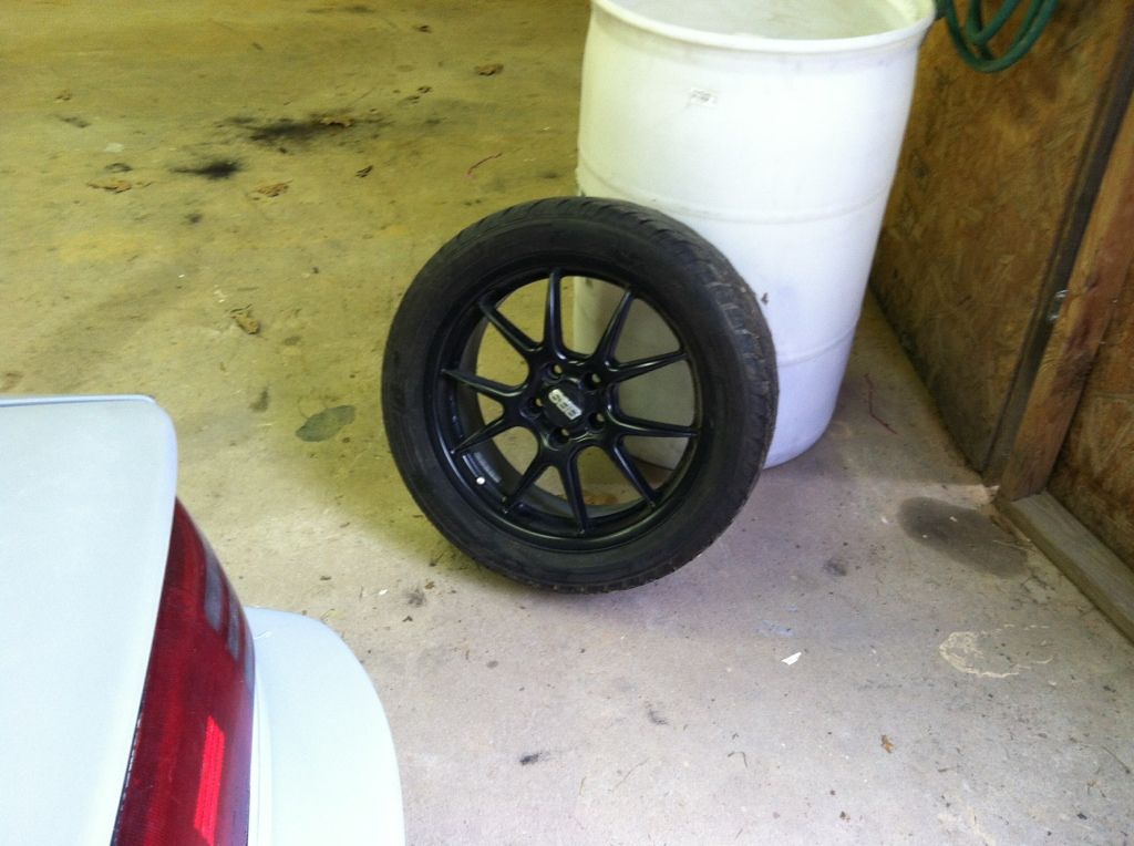

Finally caught a small break in the weather, so i decided to spend the day working on the Supra.
The TT wheels had some imperfections so i spent part of the day wet sanding and polishing, upon test fitting I realized bigger front tires is a must.
Im thinking a 225/45r17 should be about right.

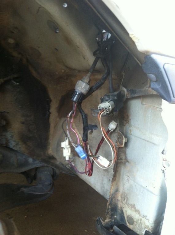

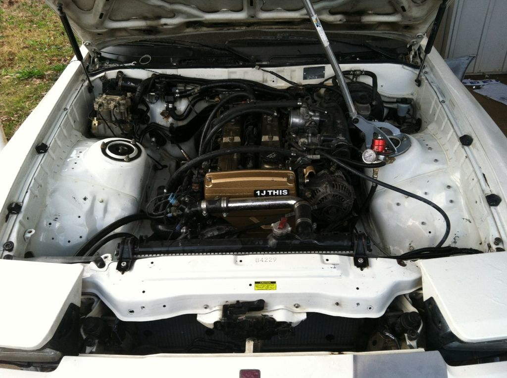

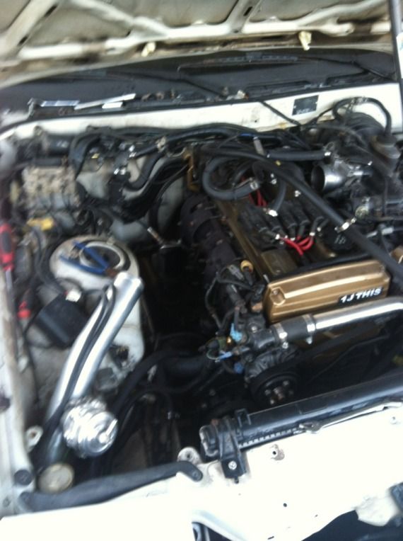

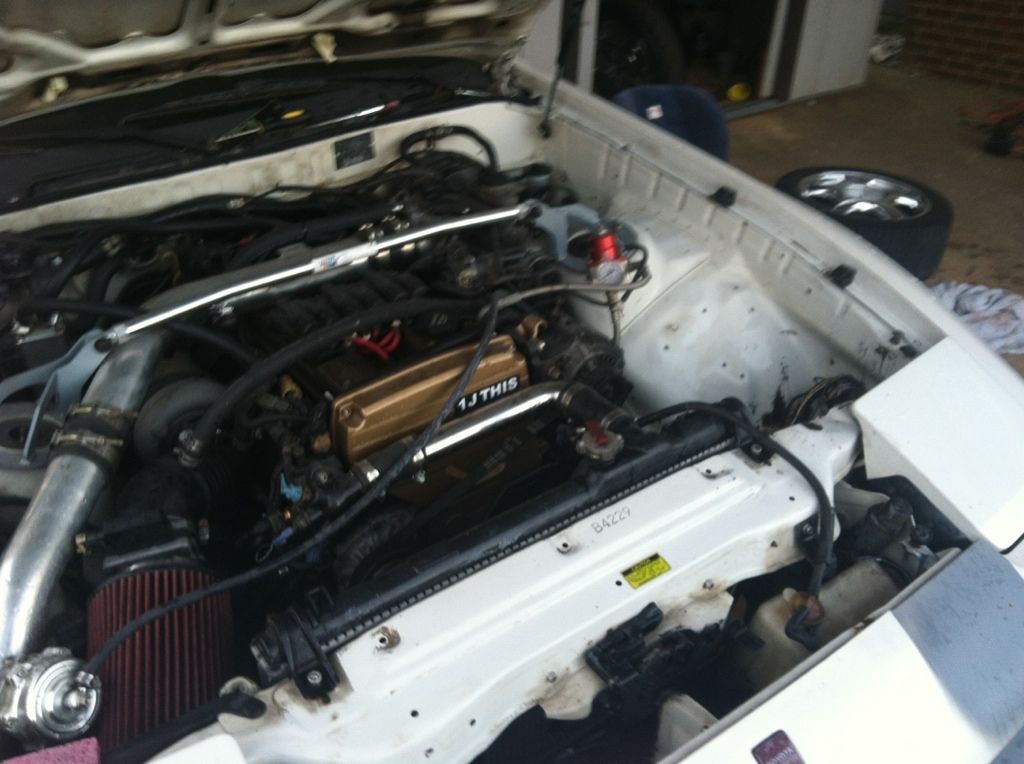

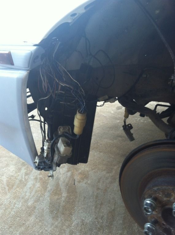

Well I got Bored and bad things happen when I get bored.
I started the wire tuck process and ordered everything to convert to coil on plug.
This is what the drivers side of my bay looked like before I started
My bay definatly needs to be painted there's a lot of stains and not all of it will wash off
A good bleach bath with a lot of scrubbing later
I still have a couple sections to extend but the topside is looking decent so far
Should be able to make some brackets to relocate the fuse box in the fender well, just have to go pick up some supplies tomorrow after work. It won't look this bad when I'm finished lol.

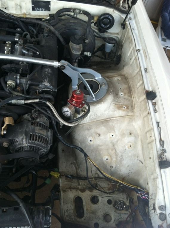

jessemkiiis
Sep 28, 2009
490
Childersburg AL,
Drivers side is finished.

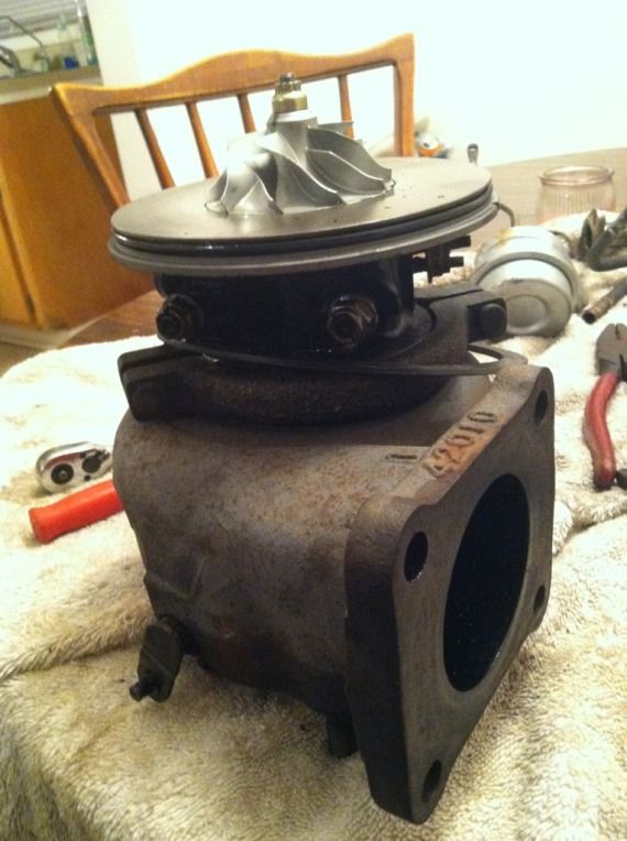

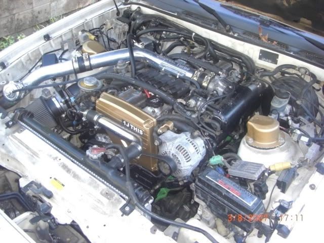

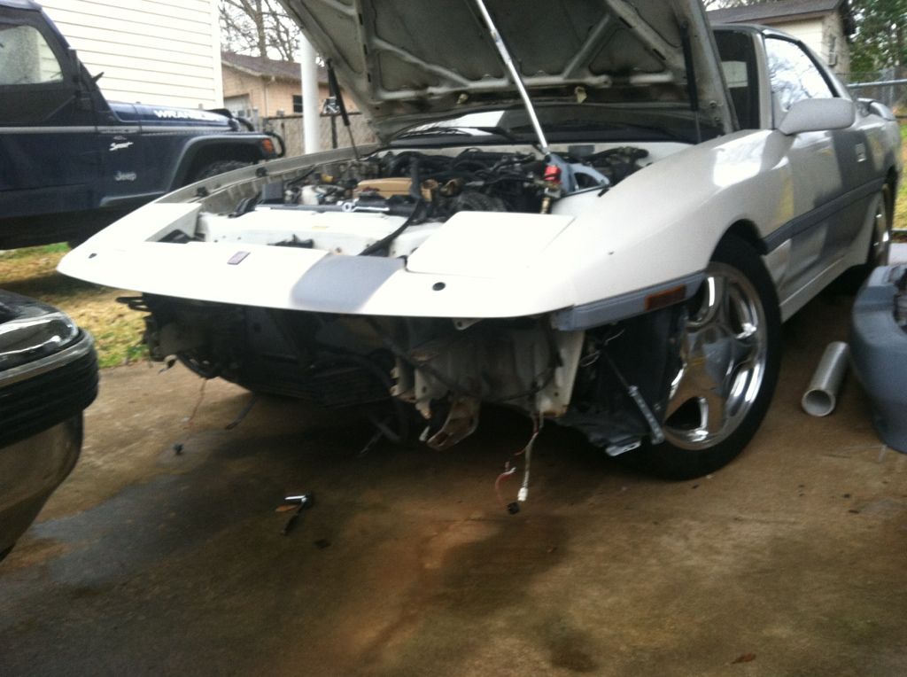

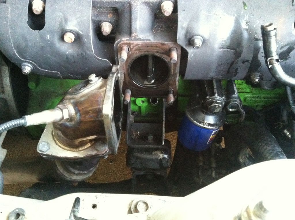

So I started pulling my turbo so I can either send it off for new seals or an upgrade
And what do I find?
Oil! And lots of it
Now on top of cleaning and tucking the passenger side of the bay,I have to pull the intercooler and piping in hopes of removing all the oil before the turbo comes back.
Any body have any ideas how to clean this stuff out?

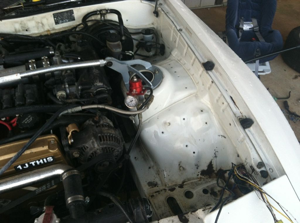

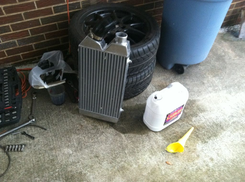

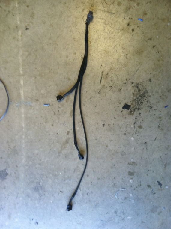

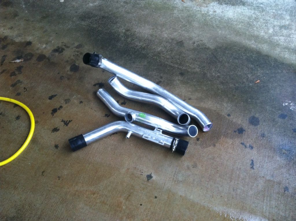

went back at it pretty hard yesterday
pulled my intercooler and all the piping and gave them a good bath in degreaser

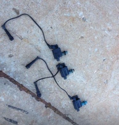

recieved my JZ coils yesterday as well
and today I built the extended harness to accommodate the new set up.
This turbo is really startin to piss me off, im going to replace the oil seal myself and have a shop balance it,
if that does not work out im not sure where ill go from there.
Right now im dead in the water until I get my money caught back up. so until then im going to try and get as much done as i can on a minimum budget. Plans include finishing the wire tuck and doing the 12v fuel pump mod. maybe redo my battery relocation with 0 gauge wire, and wrap my intercooler piping with header wrap.

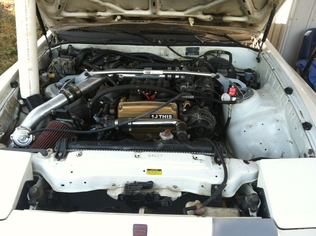

Finished the passengers side wire tuck, I think I'm going to attempt re routing the engine harness through the fire wall on the drivers side to clean it up some more.
