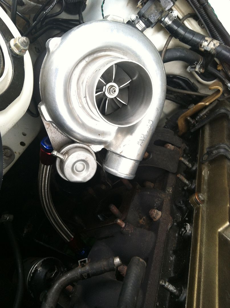

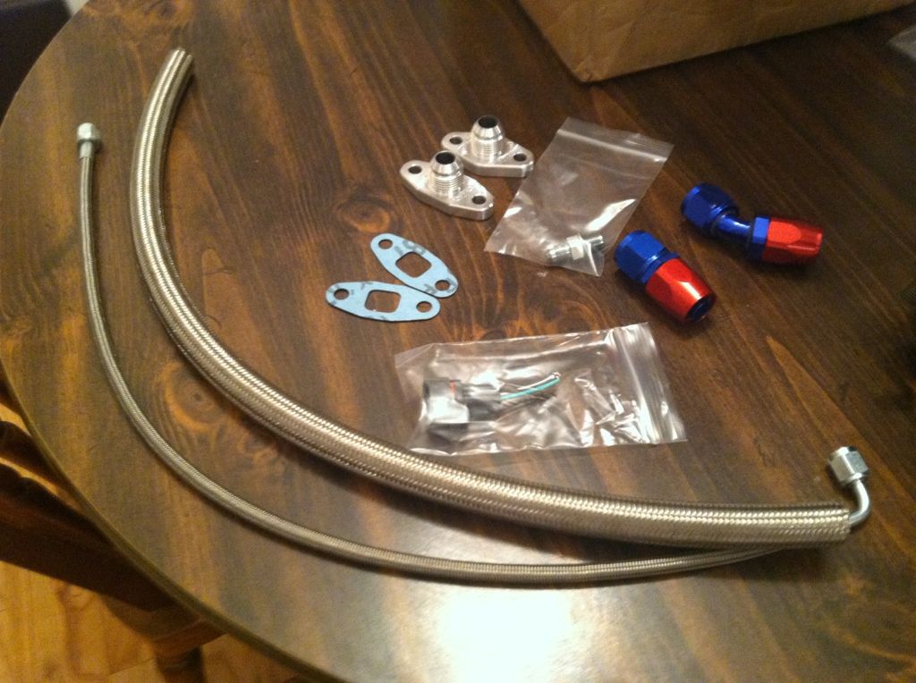

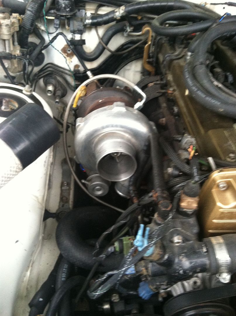

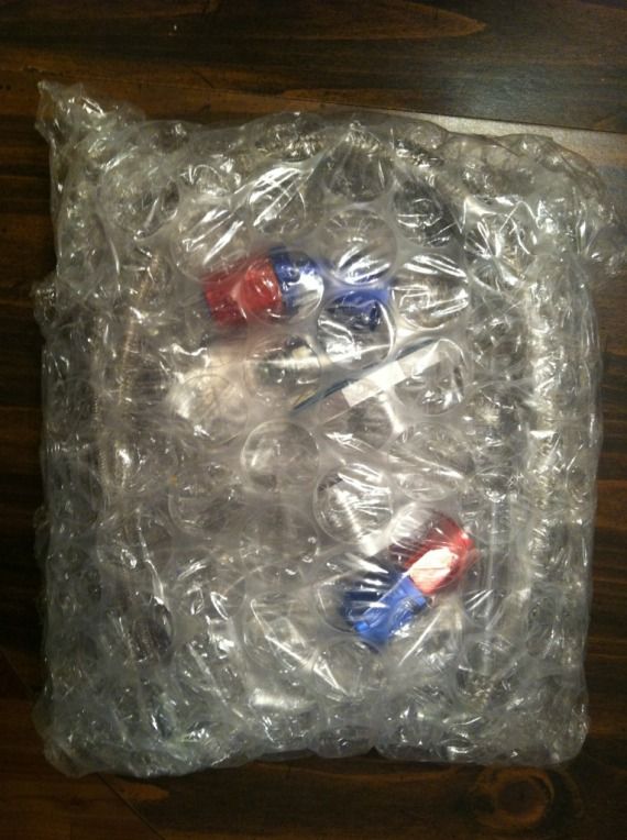

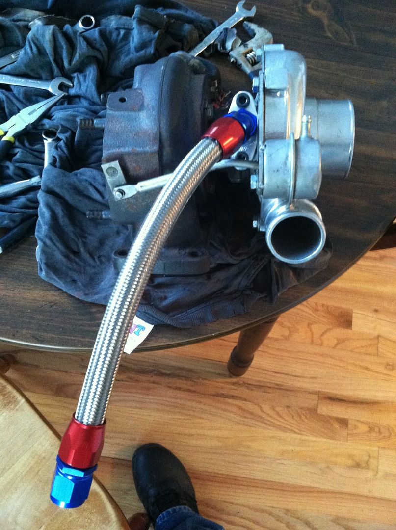

quick update, got some stuff in from driftmotion so I can make my oil lines. hopefully I can find time to get started on it this weekend, if not maybe Monday.
-4 feed, -10 drain hose with AN fittings and Arizona Performance flanges and the block adaptor for the feed line. needed a new CPS plug while I was at it.
I mocked the drain flange to the turbo and ran into this little problem.hopefully I can just clock the center cartridge and make it work.
jessemkiiis
Sep 28, 2009
490
Childersburg AL,

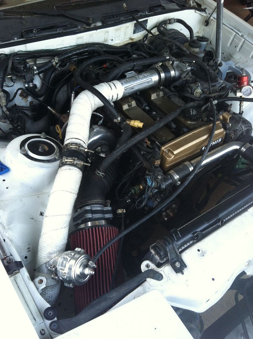

clocked my center cartridge to fix my clearance issues. cant believe I didn't think about that to begin with.
had to mock the turbo several times in order to get the drain hose the correct length
put it all back together and heat wrapped the intercooler piping.
I've driven the car twice now but she hits fuel cut with the quickness. I think before I take it out again im going to go ahead and buy 550's and make a trip to the dyno for a tune. after converting to cop and doing the 12v fuel pump mod the car starts a lot easier even runs smoother.
I cant wait to hit the rolling road and see what kind of numbers I can put down.

AbsoluteSpeed
Aug 8, 2007
735
Edmonton AB
Badass chivelle!
I can't say I understand heat wrapping the intercooler pipes.
Maybe the cold side (especially with the 7m's ic pipe going over the turbo) but is wrapping the hot side beneficial? Wouldn't that hold heat in? Maybe I'm looking at this the wrong way.
jessemkiiis
Sep 28, 2009
490
Childersburg AL,
It keeps the heat out more than in, my setup gets heat soaked in a heartbeat, plus I had a lot of it Layin around so no harm no foul. I figure every little bit helps.

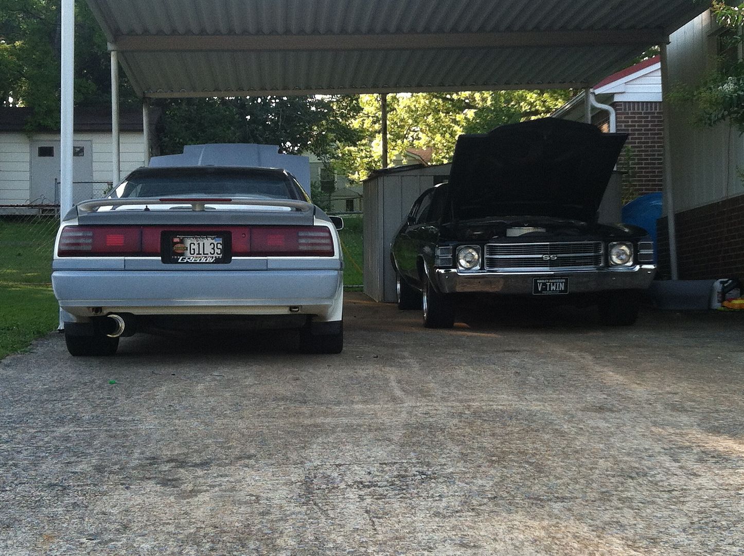

I bought the Chevelle to have as a project for me and my son, good thing he's only 5 months old lol. Maybe I can have the supra done in the next year or so and concentrate on it.

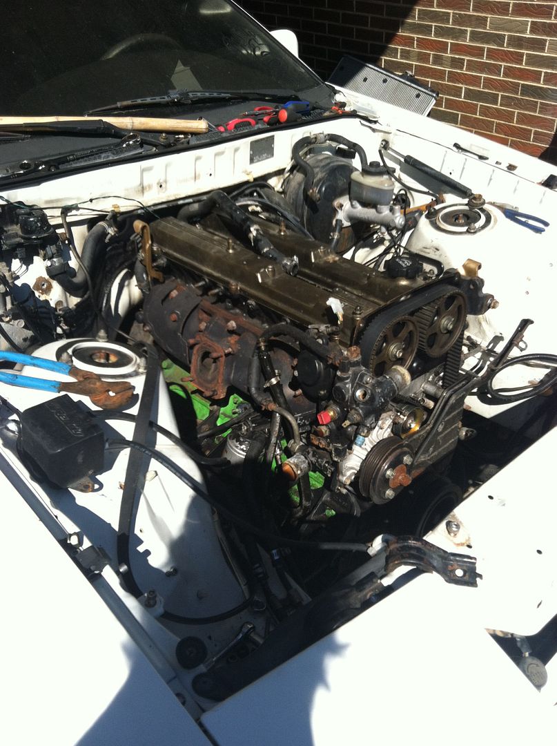

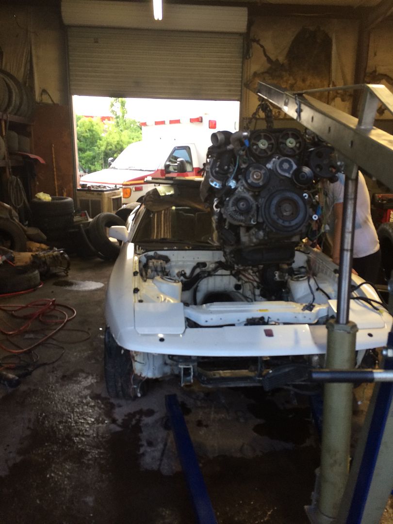

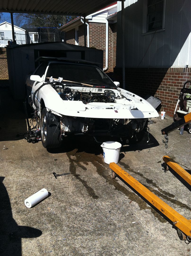

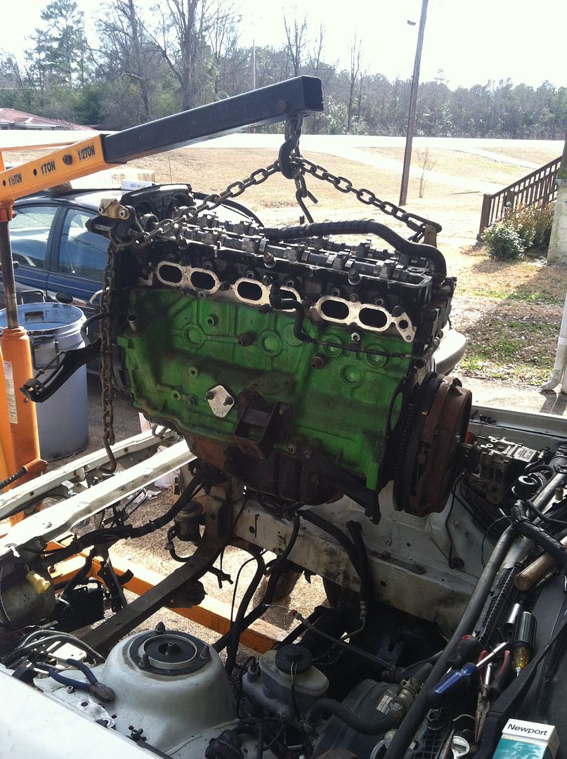

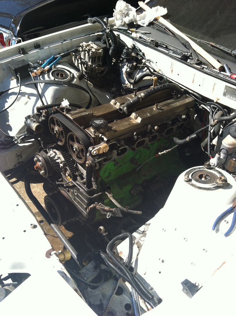

well guys Ive had my fill of 7M problems, car ran good for a little while but I blew my last headgasket.

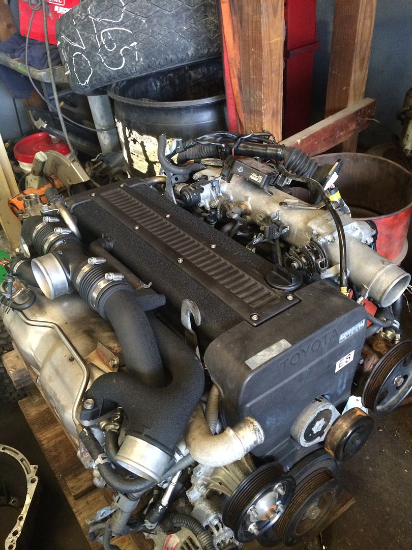

started pulling the engine, parted out almost every 7M specific part on the car and Im going 1JZ.
I was a little sad at first but the more I think about it im sure that motor hated me with everything It had.
wish I had the money to go big single right out of the gate but more than likely that money will be spent else where.
Damn it Im going to dailey drive this car weather it likes it or not.

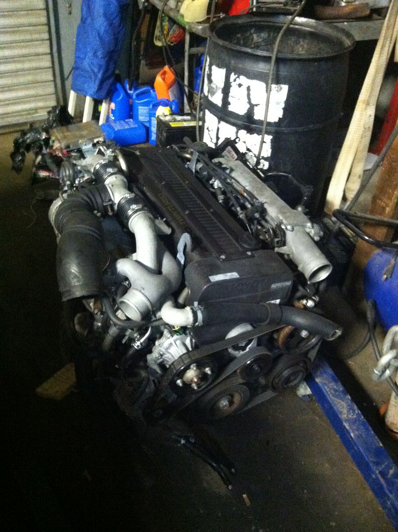

Honestly when it ran taking pics or videos never crossed my mind. my first Supra did exactly what I told it to when I told it to. this one seems to have an attitude problem.
The new engine will be ordered next week and I don't plan on dragging the swap out.

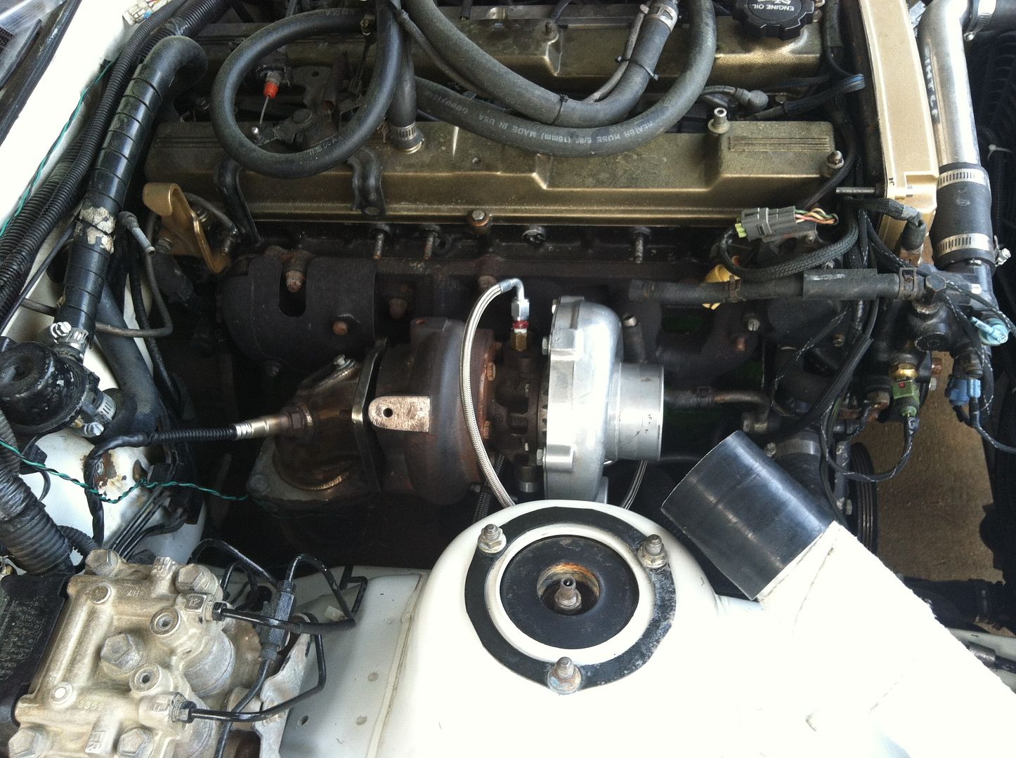

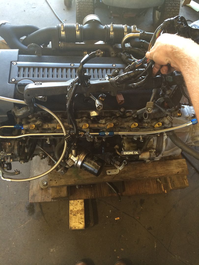

Here's some updates

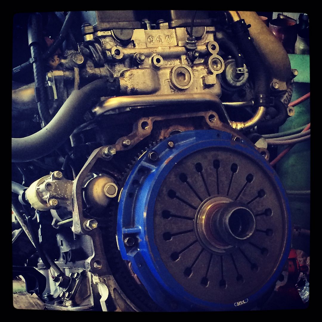

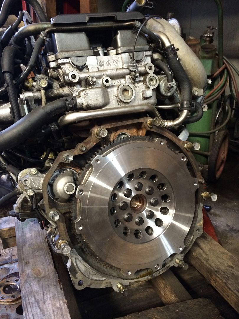

Light weight flywheel with arp bolts
Spec stage 2+ clutch kit
New oem bell housing to mate up to my old R154
Some cosmetics
Driftmotion AFPR Kit and PS hose
More cosmetics

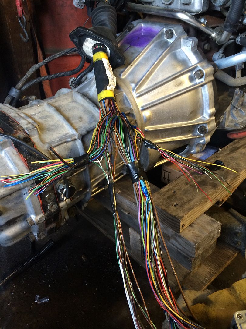

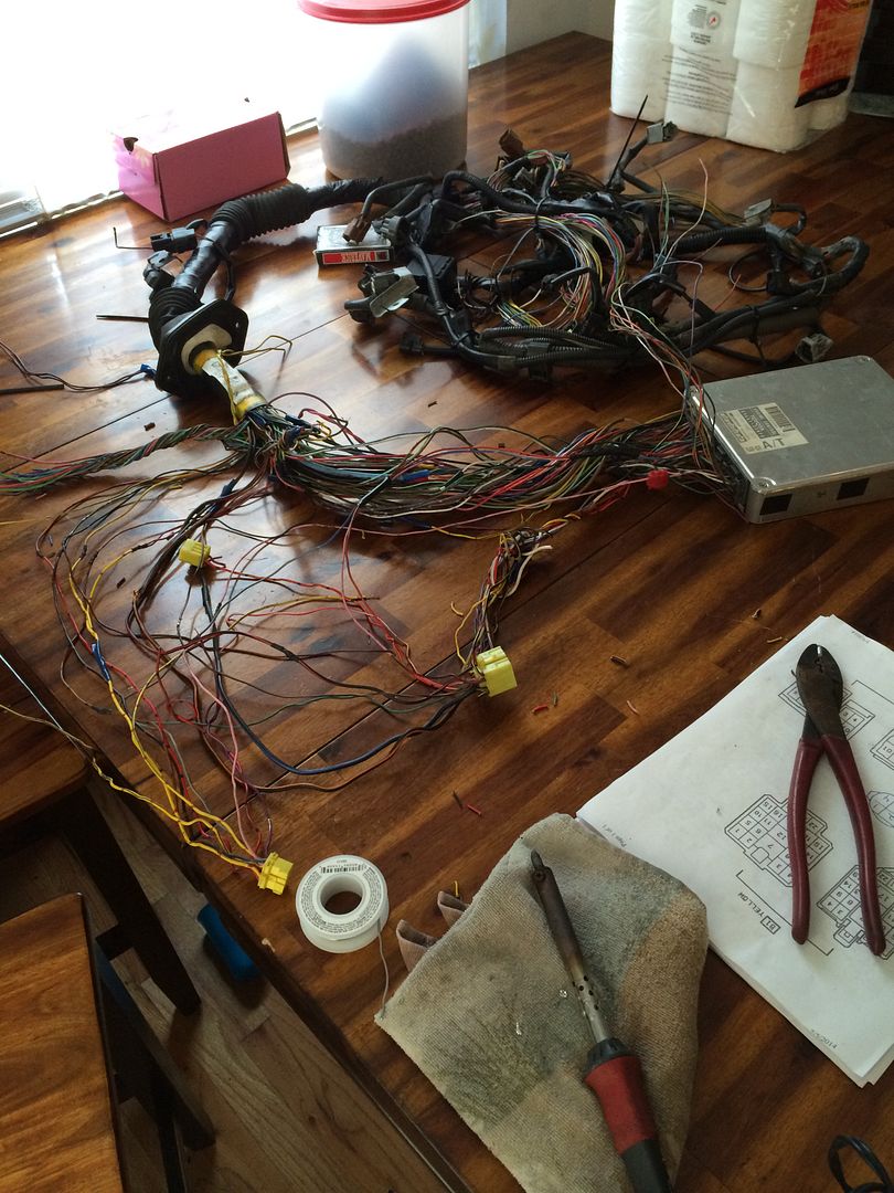

Wiring
On her way home

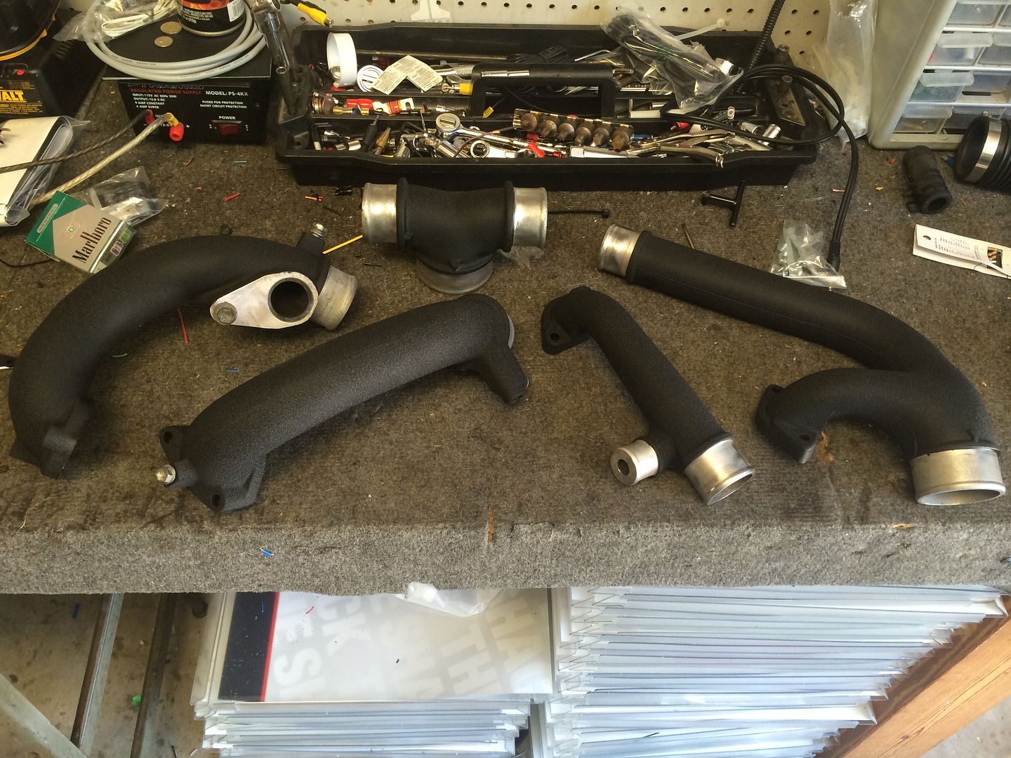

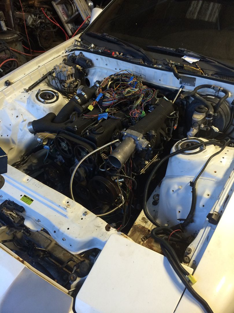

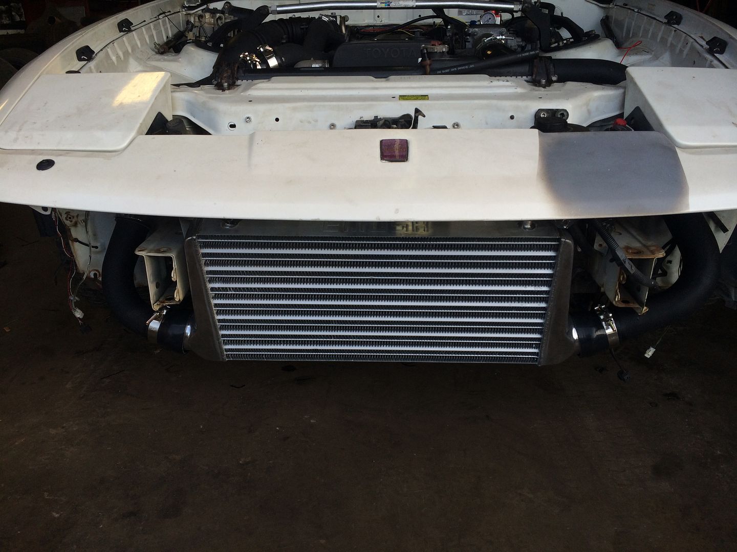

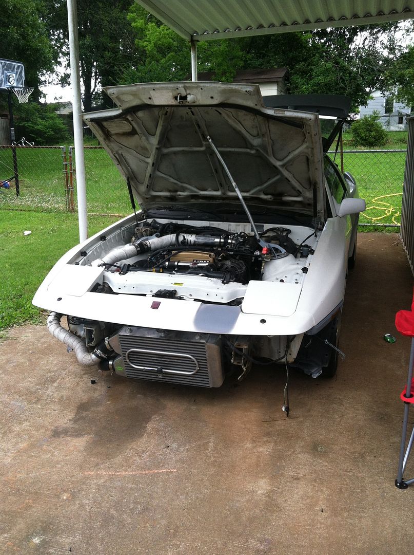

Mocking up all the ic piping and ic

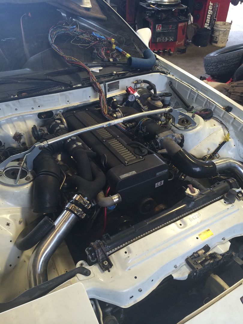

More cosmetics and starting to button things up.
Going today to hook up the throttle cable and start looming the harness change oil stuff like that.
As soon as my radiator hoses get her I should be able to take her down the road.
