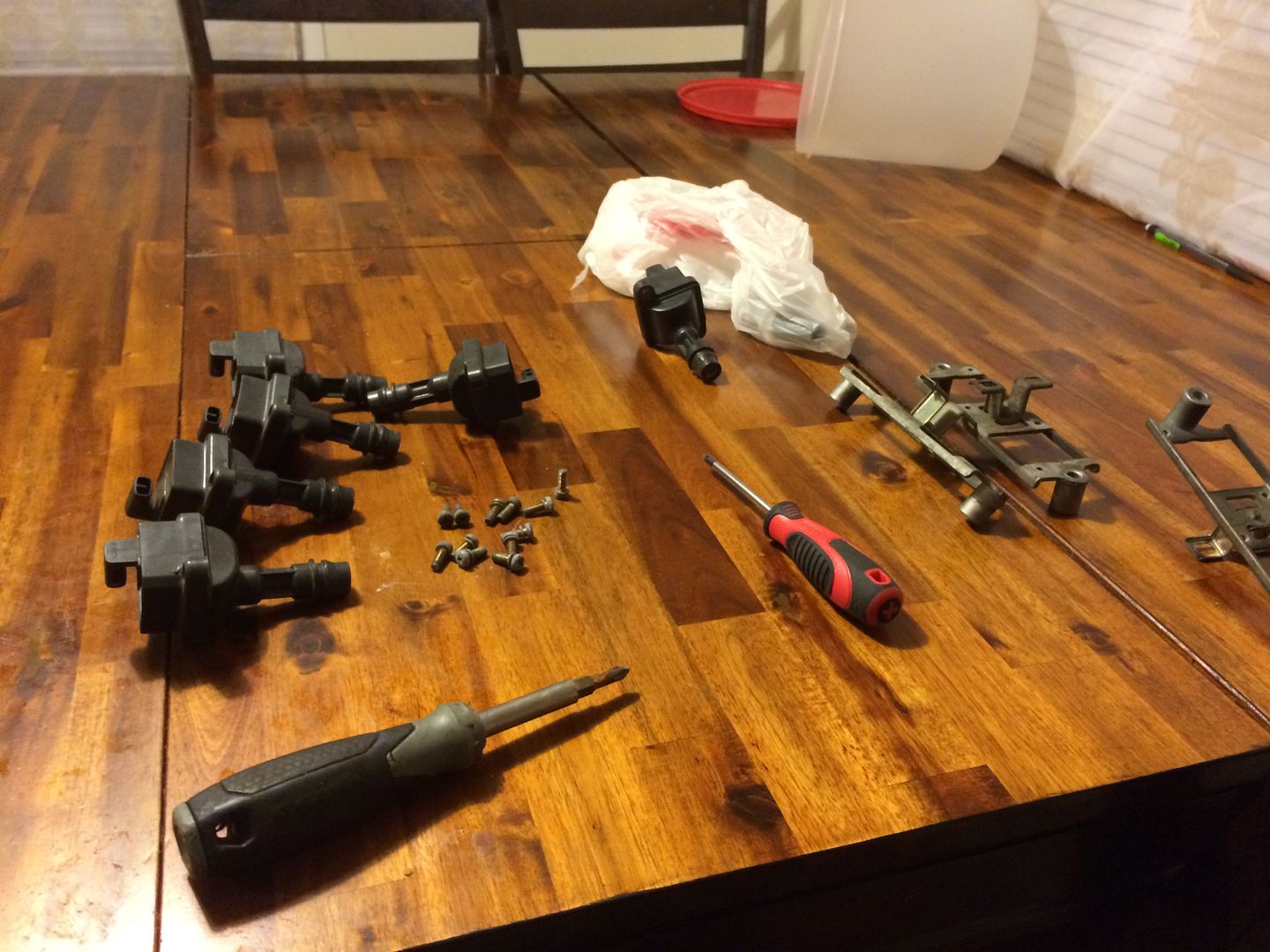

So it drives... Running into hellacious ignition break up. I'm gonna pull the coils and epoxy/shrink wrap them. Maybe regap my plugs and see where that leaves me Layin. Crazy thing is the breakup is in the lower rpms.

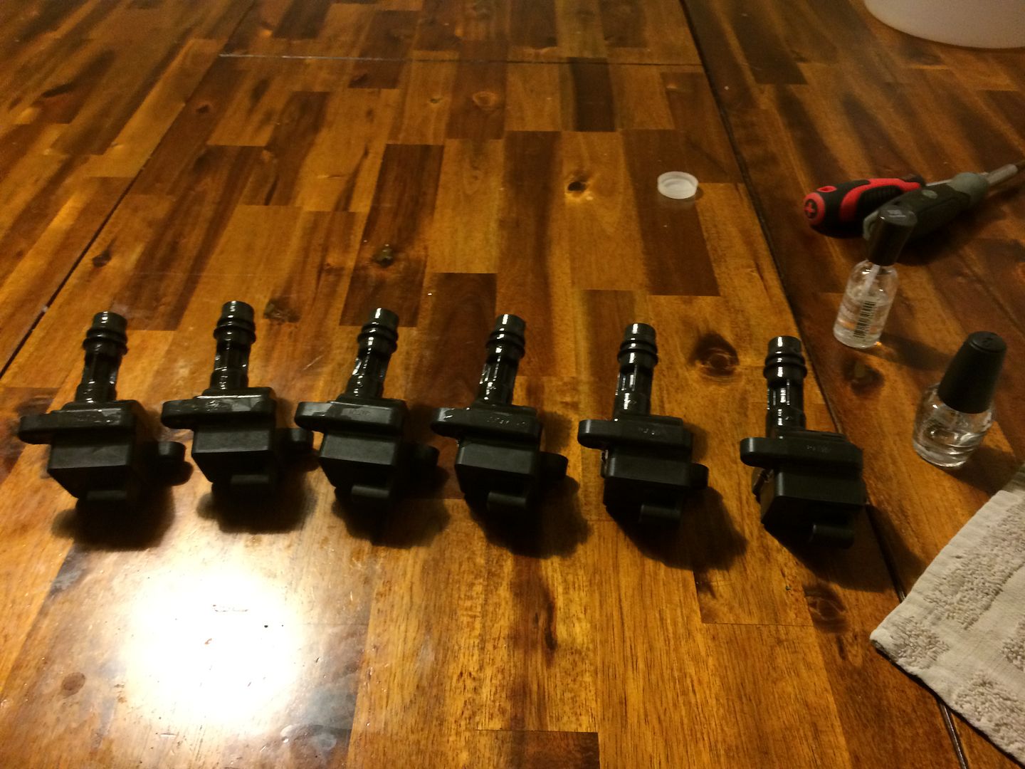

Pulled em off and found some serious cracks under the little boots.
Put about 4 good thick coats on the entire coil let em dry overnight. Dropped em back in this morning and started her up, idle greatly improved but I didn't have time to drive it. Also noticed that my clips are all junk and need to be replaced soon.

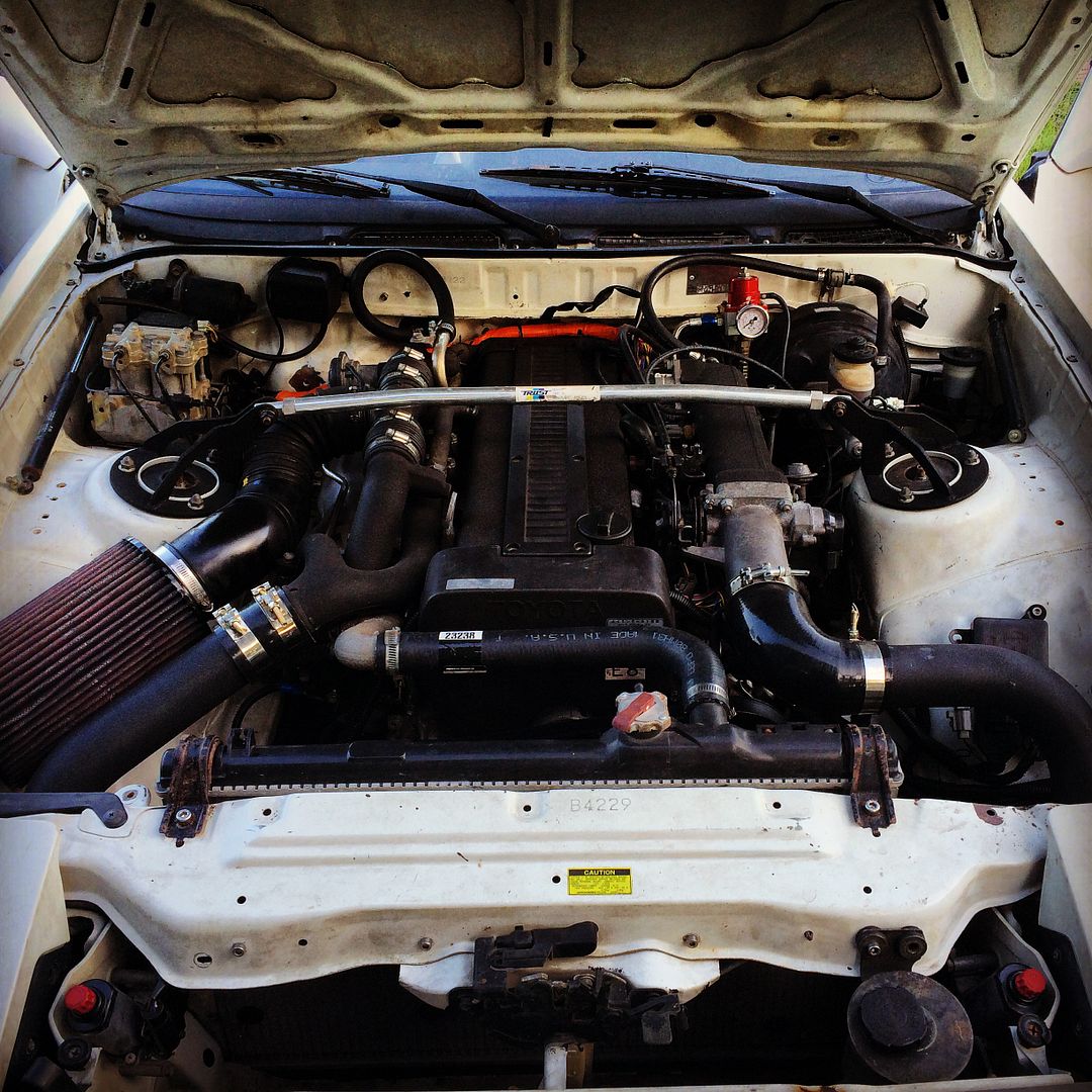

Recapped my plugs at .028 and dropped my fuel pressure to 42psi, definatly cleared up a lot. There is still a window from 2200-3200 that it seems to want to stumble. I did some good top end pulls and there is zero break up @10-12 psi. Boost controller will not be connected until I figure this out. Debating closing the gap a little more maybe .025ish I've read a lot of people going as low as .022 but I'm sure they were single turbo with a lot more boost.

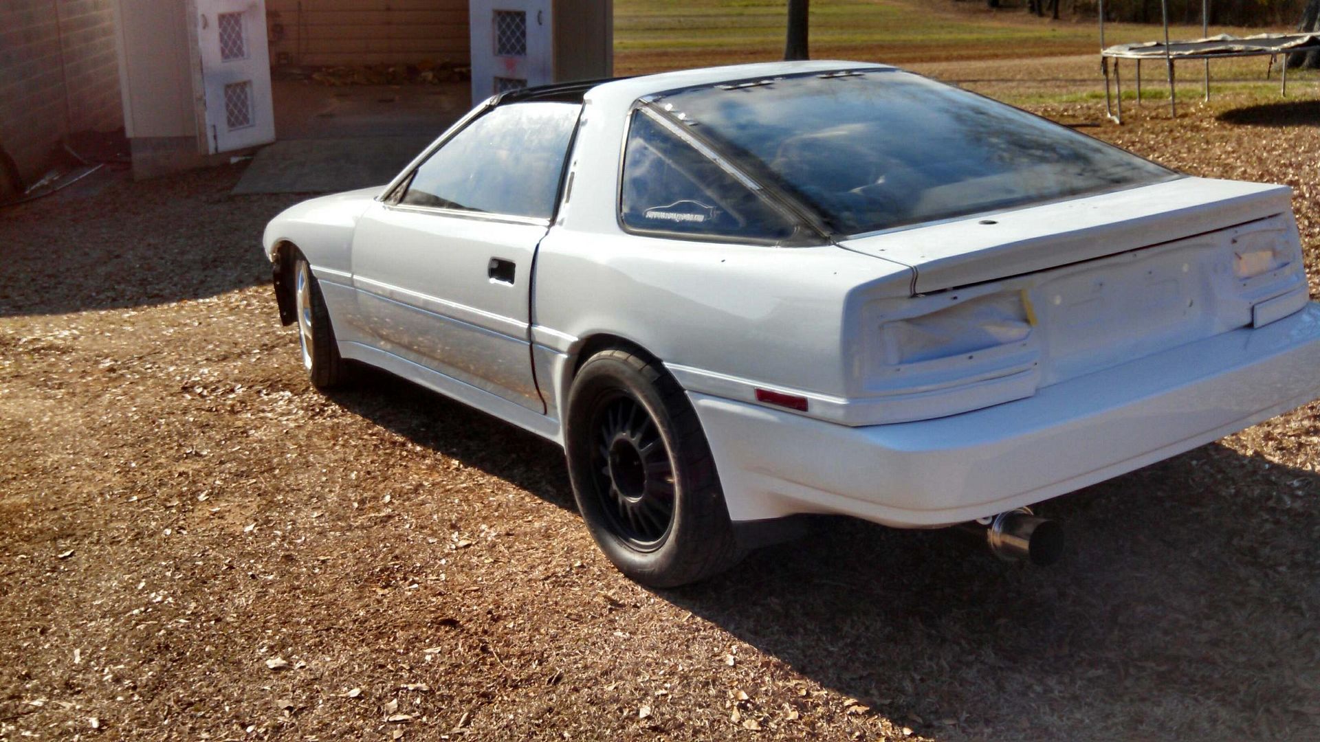

Couple pics I took over the weekend

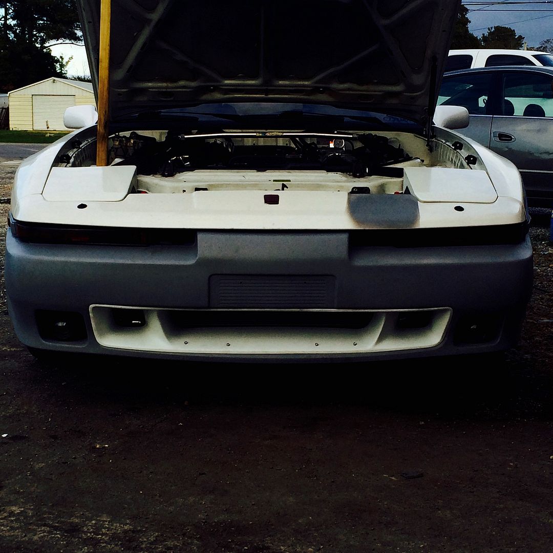

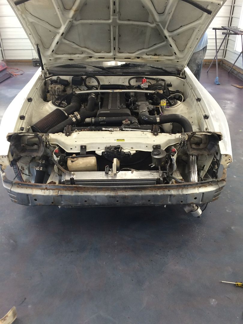

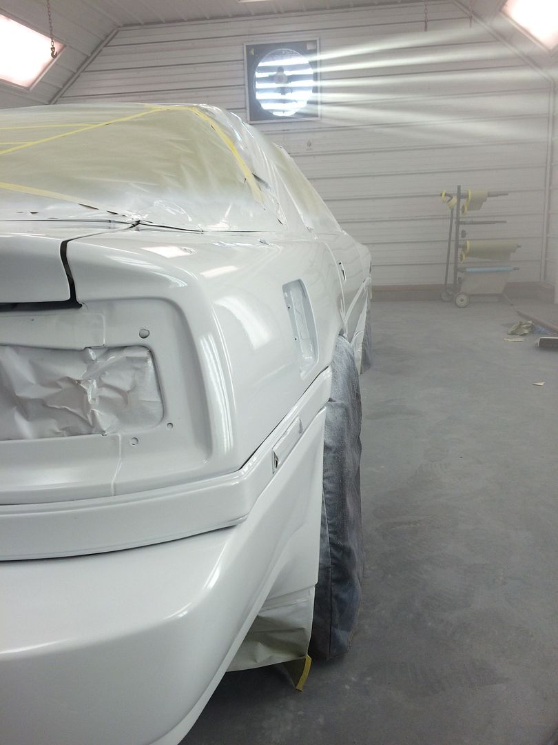

Shine S2 Air Guide install

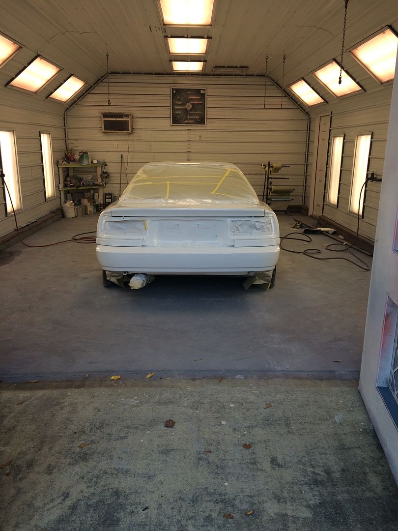

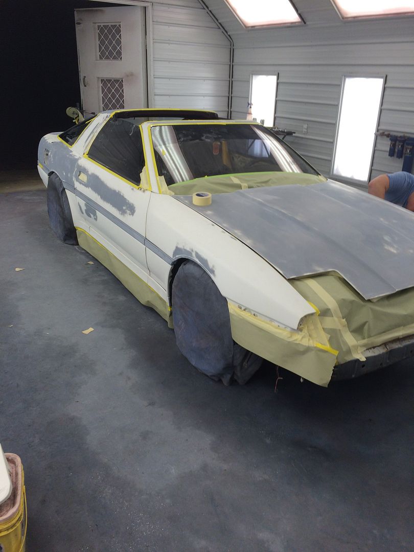

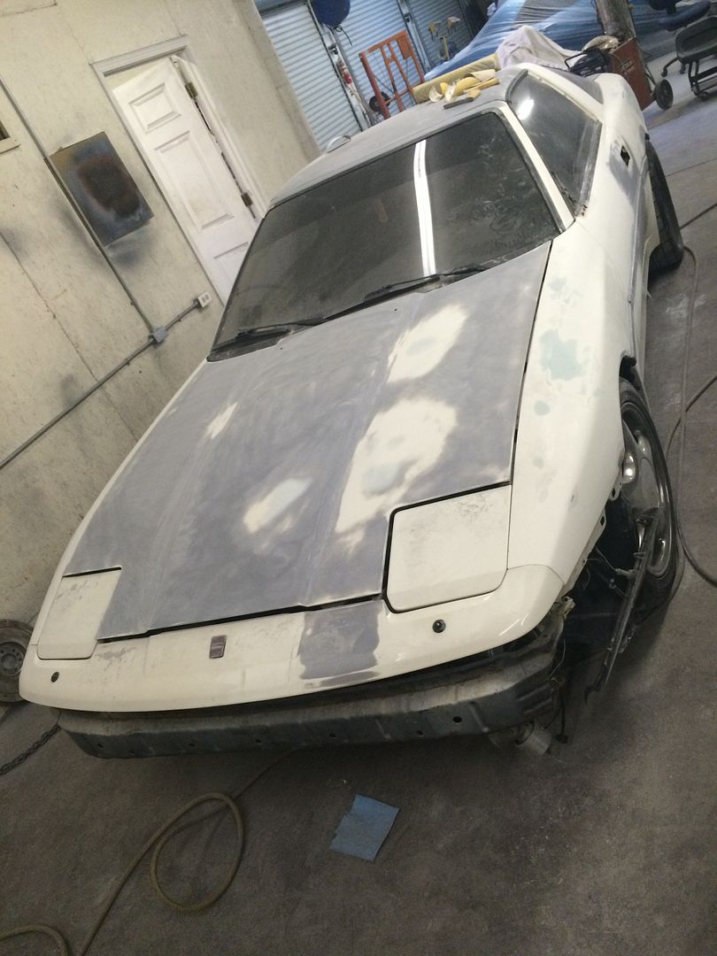

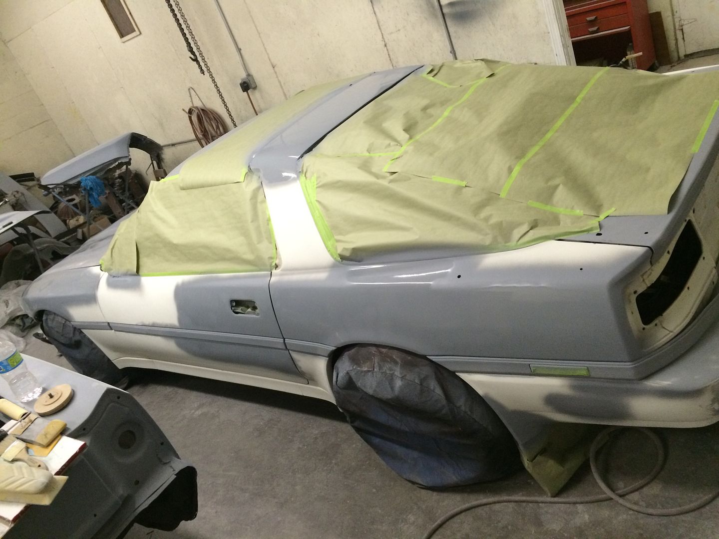

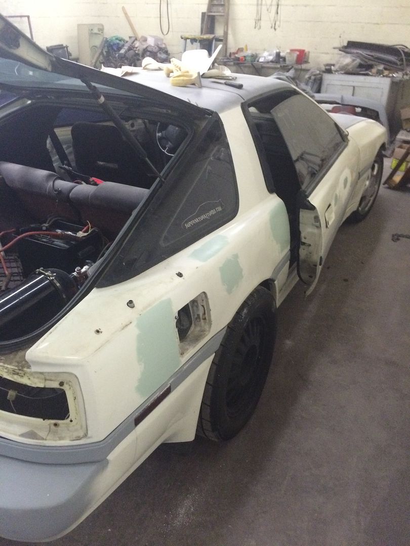

Drove it around untill it got cold then off to the body shop she went

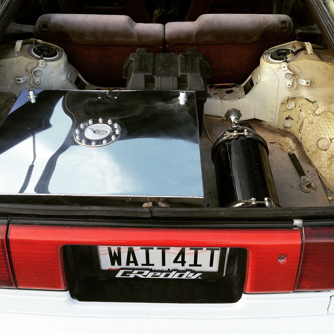

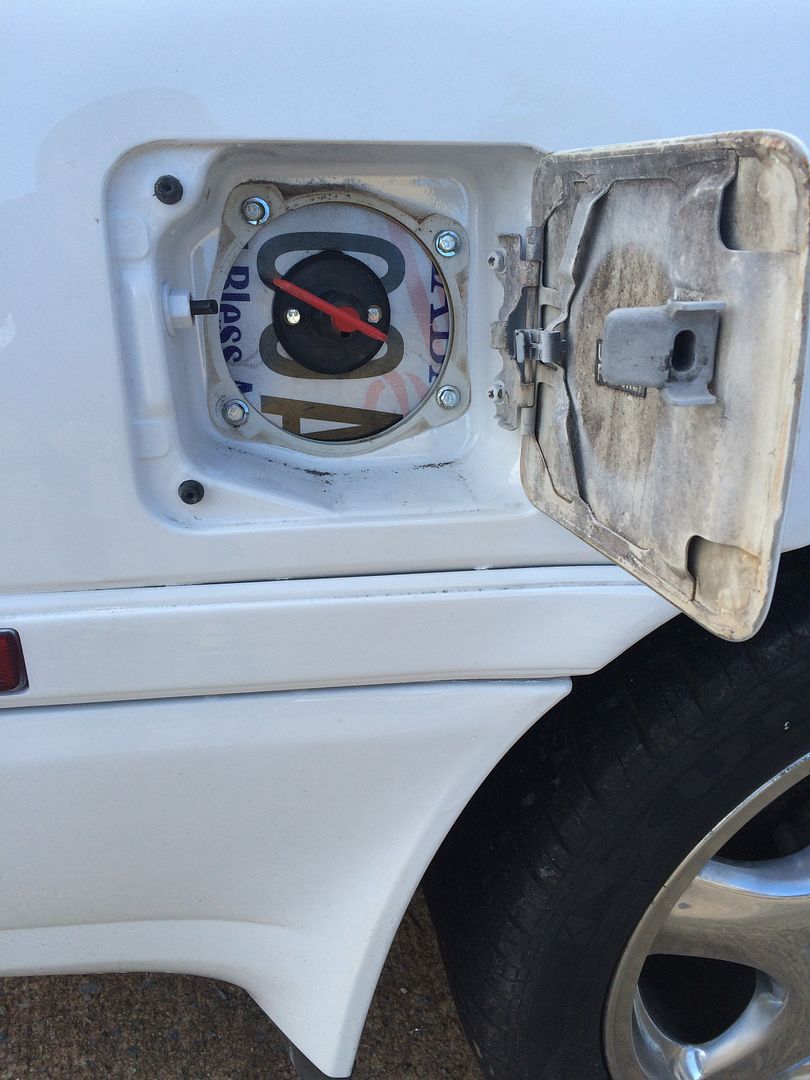

Pulled the factory tank, installed 20 gal fuel cell with single bosche 044 for now will go twins down the road.
Also Installed battery cutoff switch behind fuel door

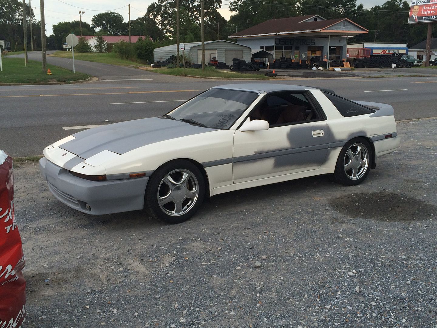

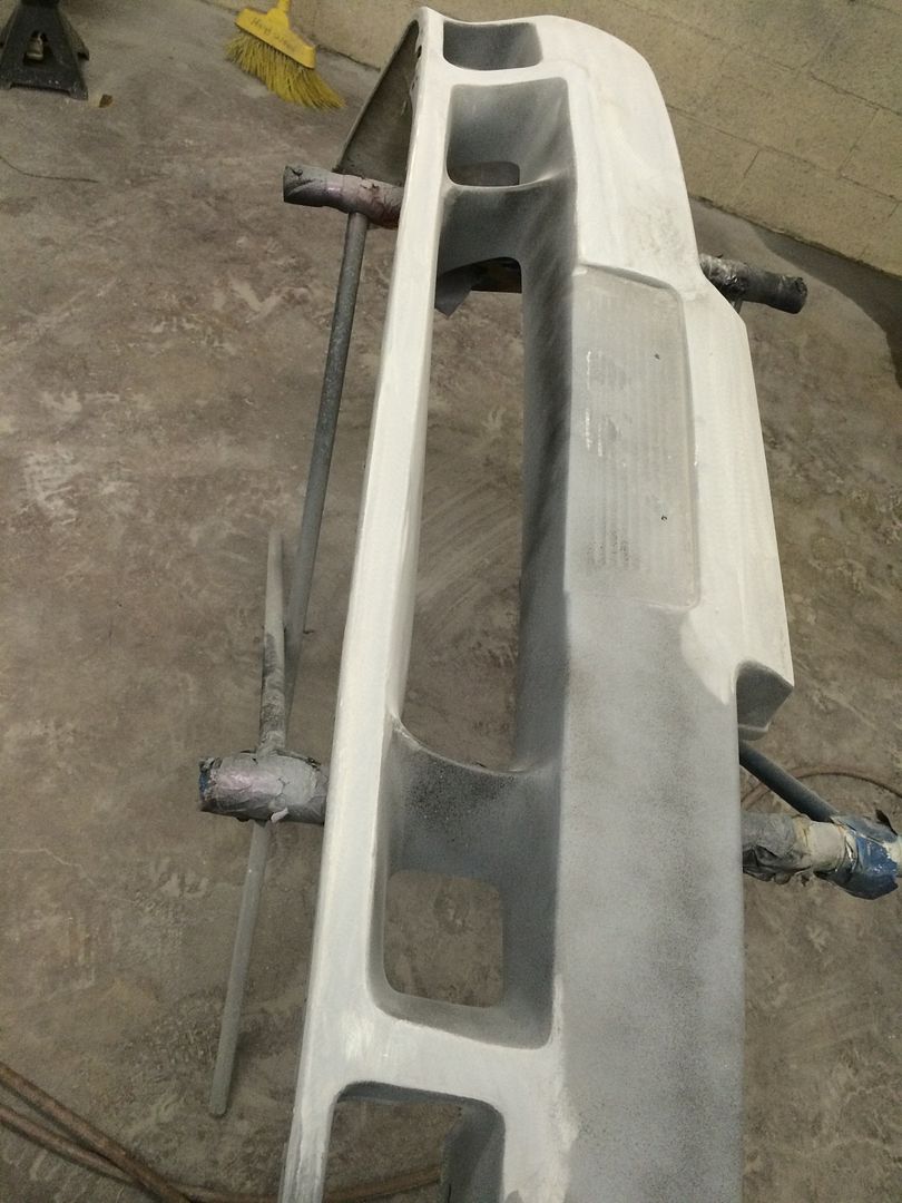

I want to run a bomex 3 hole rep from shine, but I'm so afraid ill drag it off and bust all the fiberglass in the bumper.
Right now I'm running the good old Home Depot lip. If it drags I spend $14 and replace it lol.
