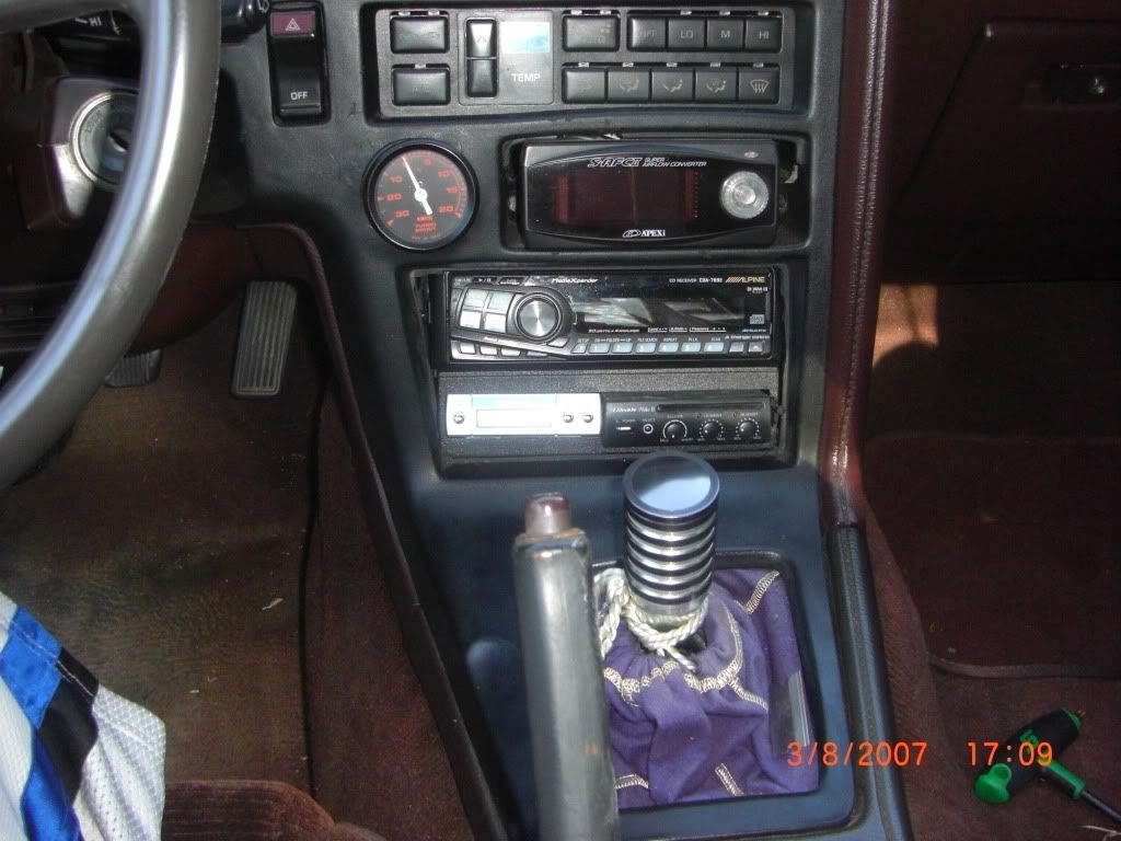

since I cant afford a good short throw, and the chopped stocker wasnt working out. I decided that was next on the list.
I opted for a taller knob and just the lower section of the shifter, now it feels solid during shifts and gives the low profile look I was after

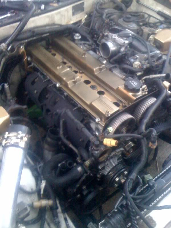

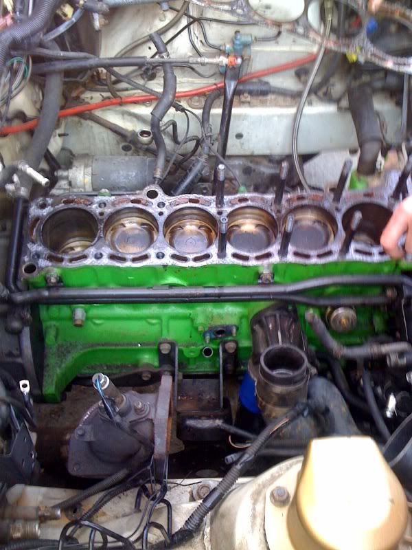

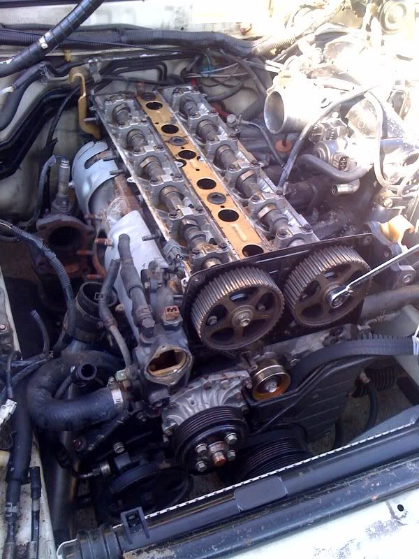

So summers gettin close and i couldnt take it any more.

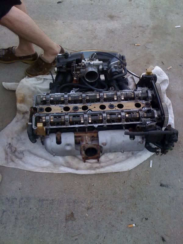

Pulled the head today with the help of a buddy and got a couple suprises.
i thought the head gasket was blown due to the milk shake in my oil pan but it never over heated. turns out the person i purchased the car from told the truth when he said it was freshly rebuilt with arp head studs. but apparently he's a dumbass.
the studs were finger tight in the block and he torqued the nuts unevenly.
so no bhg but the head was lifting and the gasket might as well not even been there.
Im takin the head tommarow to the machine shop to be checked and resurfaced if needed but i doubt it. while its apart im having my valve covers powder coated and relocating my power steering reservoir.
jessemkiiis
Sep 28, 2009
490
Childersburg AL,
well monday i took my head to the machine shop in Anniston, tuesday around 12 oclock
I got the Good news.
Head wasnt warped at all, not even a little. Had it surfaced just for insurance.
I started reassembling everything on the head, cams are in intakes back on.
Need to pick up some hi temp paint for my exhaust manifold then itll be ready to go back in the car.
if everything goes smoothly it should be running Sunday.
Ill post some pics of the head and new valve covers asap
