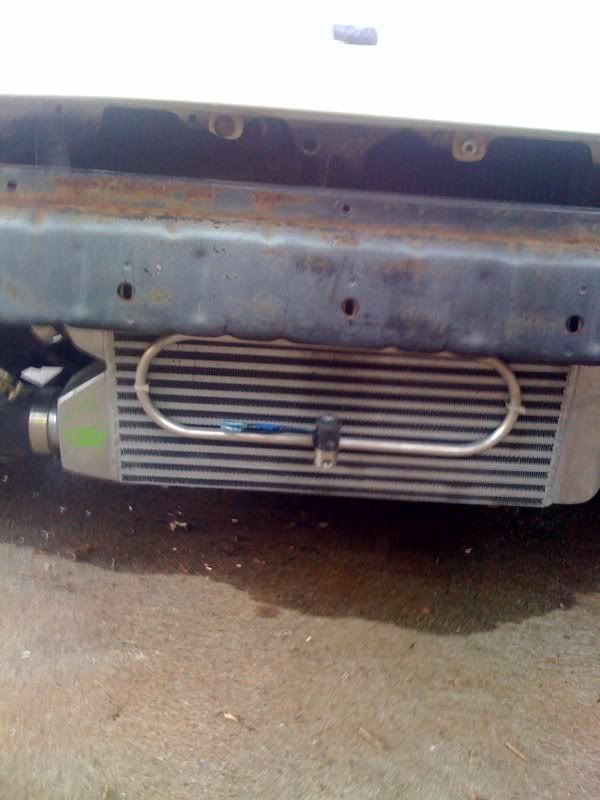

love it, in my opinion its probly the best kit you can buy for the money.
I really like the fact that you can get black couplers instead of the usual red or blue. the tbolts are high quality too.
The only thing i had to do was relocate the oil cooler but i think thats standard for any aftermarket intercooler.
I bought mine from zankoku performance, there listed under misc. vendors.

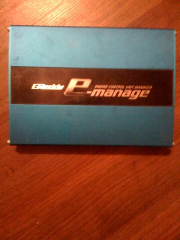

alright guys heres a small up date, I got the car running and started driving it to find all the bugs before import face off.
under boost the battery light would flicker as well as the brake light and tail light warning light. the voltage was very inconsistant it would range from 10.8v to 14.1V
I went throught 3 alternators and two batterys with no luck.
checked every ground on the car still nothing.
eventually i really sat down and thought about it, the lights usually came on as under acceleration. so i pulled the plug off the alternator and closed the gap on the connectors, hooked everything back up and boom 13.8v to 14.1 all the time.

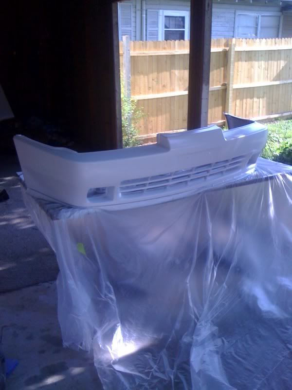

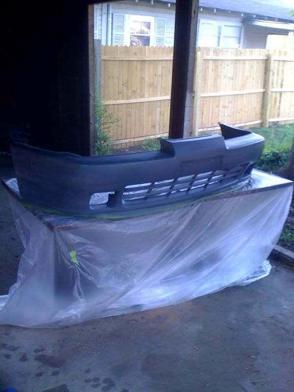

My front bumper had fell victom to the front of my trailor during the move so I decided that was next.
bumper sanded and primed
and a fresh coat of white
while the bumper was off I mounted the sprayer and solenoid for my cryo2 kit
really my only big issue now is im having trouble keeping out of boost cut,
Im running a Greddy ebc with the low boost setting all the way to min.
first second and third gear boost spikes around 13, 14psi and everytime i hit boost cut.
I dont really care about running that much boost right now. I would be happy with 10-12 psi. all day.
Can I upgrade the actuator on the wastegate or does this just come as a result of all my upgrades?
the car is still running a base tune with a little extra fuel at mid and wot.
Maybe some one can help with with this little problem too my safcII reads 0% throttle at idle and as soon as your foot hits the pedal, it shoots strait to 98-100%.
can this be an issue? ive looked in the manual but i dont know what it could be.
maybe its a good thing I bought this?
I plan on running the ignition harness and buying the tuning software.
Im also waiting on my Greddy electronic boost gague, and Greddy wideband.

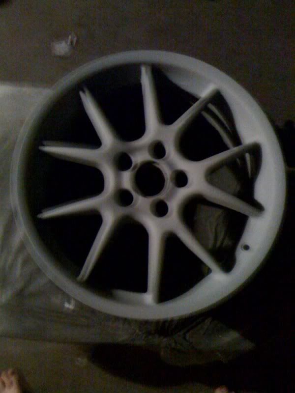

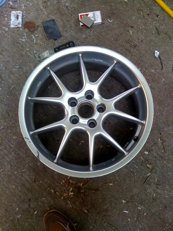

traded my old rims and 150 bucks for these
factory bbs 18's off the newer Camry's
they have some paint chipping in places so they will need to be powder coated or painted havent decided on a color yet ill just have to stare at the car for a couple day something will come to me.

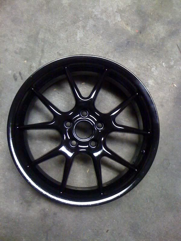

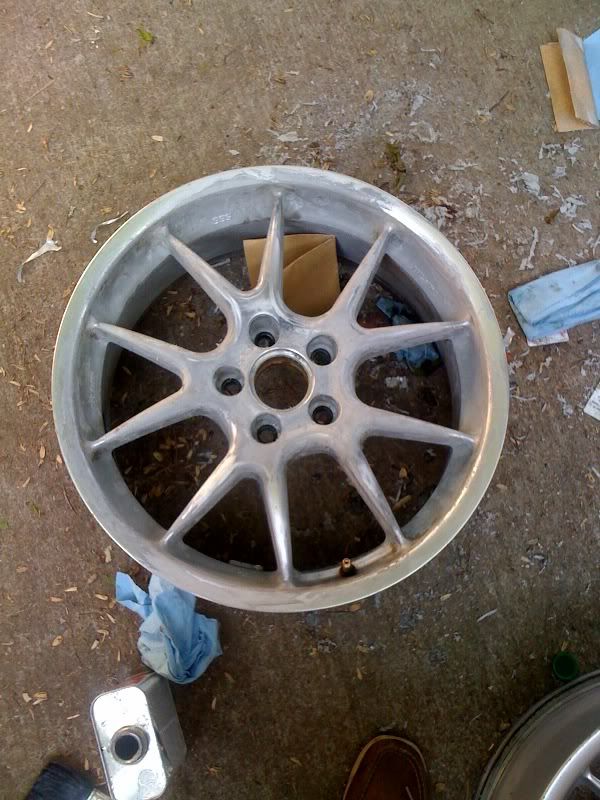

Ther rears are now finished, got my tires mounted today.
Should have pics this evening.
Tommarow I'll be pulling the fronts and start sanding lol.

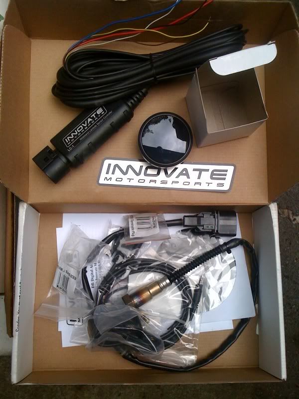

Small update, the fed-ex man was good to me this week
brand new Kevin M. Sunshade
innovate lc-1 with gauge and software

Front wheels are mounted on the car and look great but the rears are off and almost ready for paint.
poor supra is sittin on 15" lexus es300 wheels so no pics lol
