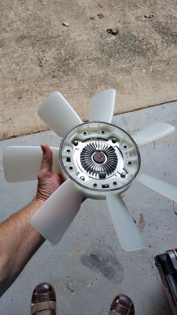

Well, I'm trying to wean myself off buying stuff for the 89 Supra(new oem shift knob, custom fit floor mats and sunshade this week).
Today, a package finally came in for the project car:

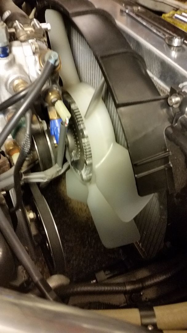

Yay! New fan blade for the '88. The car DID have a new fan, but the '89 stole it. So here's the new, NEW one, mounted on a new clutch.
And installed with a new shroud(the '89 stole that, too):
That's all I could do today. It started raining outside, and I have to get under the car to reconnect the exhaust.

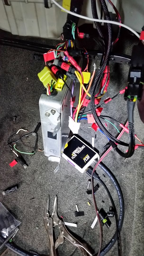

No pics of it yet, but I have pulled the maft pro out, and begun wiring in the DET3.
I had purchased this piggyback used, so I was a little scared that it might be faulty.
I plugged the det3 into my laptop and gave it 12 volts, and thankfully, it seems to work.
Since it has an internal map sensor, I was able to blow into it, and see changes on the laptop readings.
On my next set of days off, I fully expect to have the car running on the DET. Then it's time to begin bodywork. Finally.

So, I'm slowly chipping away at the DET3 wiring.
The manual is a bit less than informative, but I'm slowly getting everything connected.
All that's left at this point, is wiring in launch control, map switching control, and running the reference line for the built in map sensor.

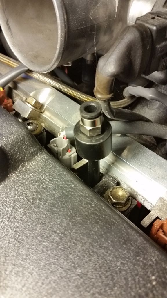

This last one required me to rearrange where the sources were for the BOV, and map reading, as I don't want them from the same source.

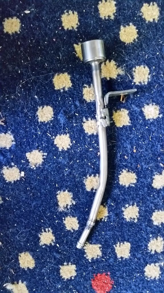

My Synapse valve uses the push-to-connect type fittings, so I pulled out the oem BPV hard pipe, and will be welding onto it a 1/8npt female fitting.
Then I can go push-to-connect from there, rather than at the back of the intake manifold.

Yup. I have measured the 'thickness' of both the NA and turbo fans. The na is a shallower blade, and does not extend as far forward into the radiator.
I had a turbo fan hit the shroud and break apart, due to the increased thickness of the Fluidyne radiator.

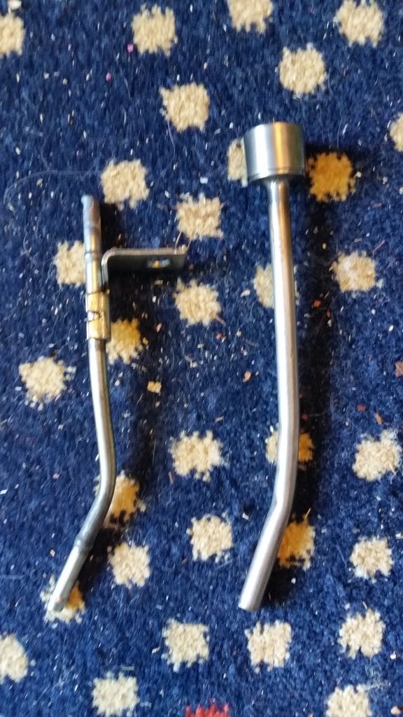

Got the fitting tig'd on today.
Well, that's not exactly true. The factory tube was too fragile, and the guy couldn't tig the fat fitting on without melting it.
So instead, he welded it onto a tube section with thicker walls. Then I chiseled off the bracket and mig'd it on at home. I was even able to
mig the bottom barb section on without burning through.
Old and new:
New, with bracket and barb:

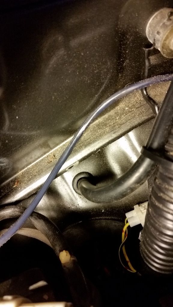

Also, I finally got around to installing the reference line for the DET3.
You can see it here, just above the harness grommet:
