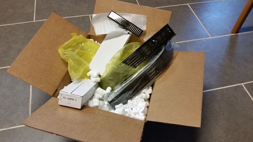

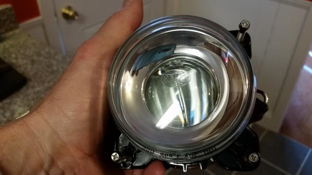

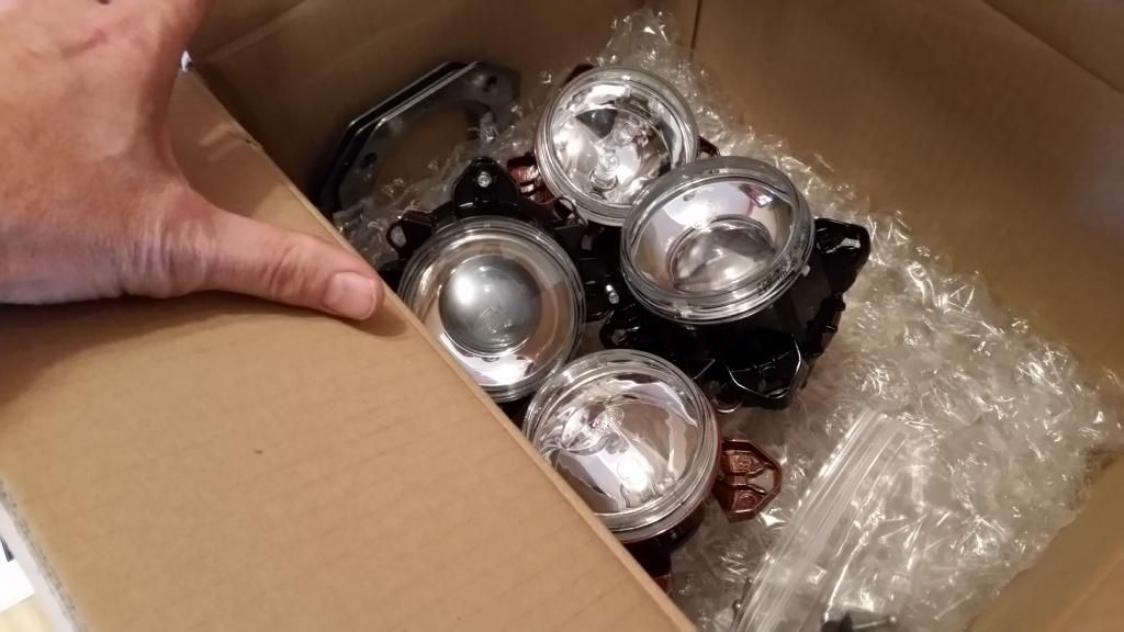

The very best price that I could find on the lights themselves(both high AND low beams), was a place right here in GA called Parts hub Direct.
They all came with the adjuster screws, and H9 bulbs installed.
68136/ 68137
http://www.partshubdirect.com/products?category=90mm/120mm
They didn't have the 4 necessary mounting plates in stock, so I bought those from jegs, and they ended up being cheaper anyway.
# 157659007
http://www.jegs.com/i/Hella/288/157659007/10002/-1

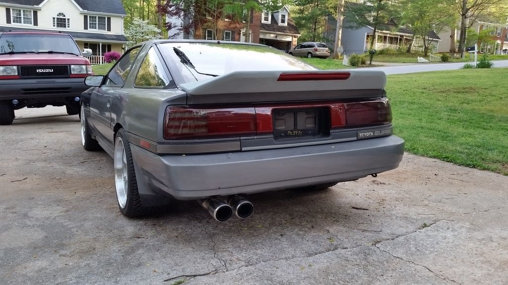

So my progress has been very slow, but I do try to work on it a little bit every few days.
The rear wing is done now. I finally integrated the 3rd brake light how I wanted it.
It will remain off the car to be painted separately, just like the bumpers will. Next up is the front bumper's modification, to include the S2 airguide.
I've cut out the center grill, and begun fitting it. It will NOT be molded into the urethane, as I am afraid that it will separate if the bumper is ever tapped.
So instead it will be screwed in with semi-flush mount screws, and I am toying with the idea of putting a thin rubber lip around it as well. I will post up the mock-up pics soon.
Also just received the turn signals and markers from Ebay. They will have to share space on the shelf with all the other 'final stage' stuff.
