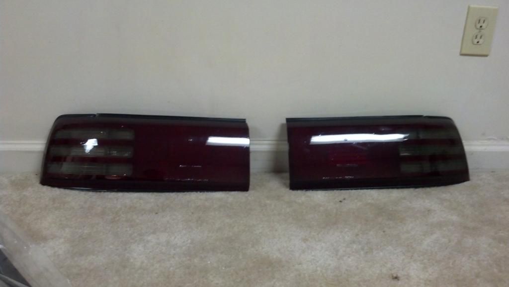

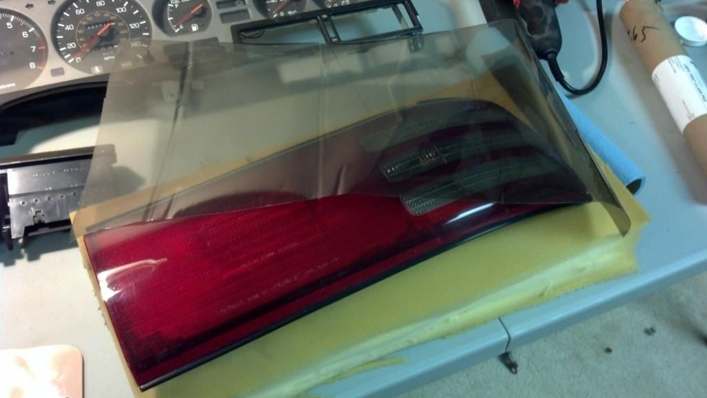

Tinted my tails.

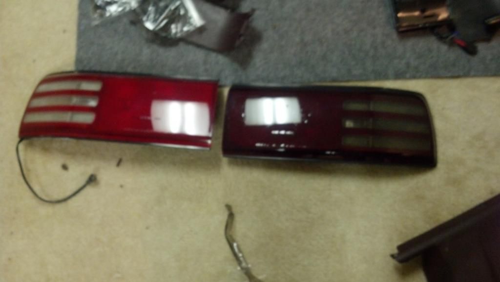

Hey Drogon- I used a vinyl film, rather than painting them. I want to be able to "untint" them later, if I changed my mind.
The vinyl I a bit hard to work with, simply because you can get bubbles underneath it, and it's a hassle to work them out. But they came out ok.
All you need to do it, is a spray bottle for water, and a hairdryer or heat gun.

Very nice that helped a lot! Thanks! I'm debating spraying them with VHT nite shade or shadow w/e but spraying them from the inside. What tint % did you use?

It's referred to as "light smoke" tint, 90% light transmission.
It was only like a $12 total investment, so no harm done, if it didn't work.
People say that if you use nightshade, you have to spray clearcoat over it. I didn't want to deal with that.
The professional method is to have someone spray real clearcoat, mixed with a touch of black paint.

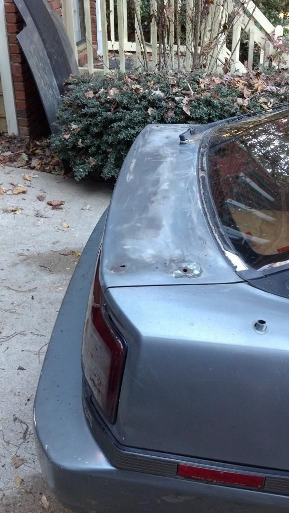

Repair/ mod the Kaminari whale tail
Strip/ mod 92 bumper with S2 airguide insert
Weld shut antenna hole

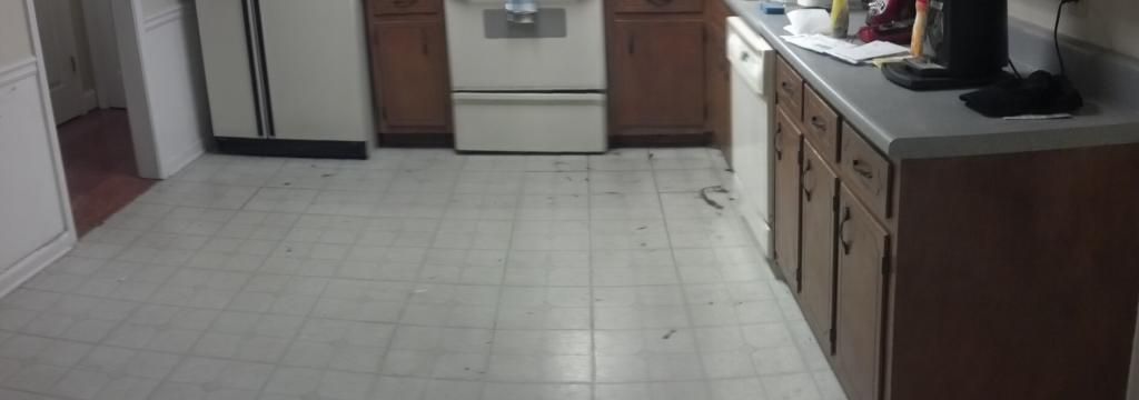

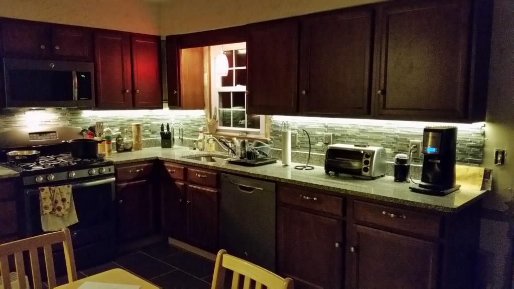

I got sidetracked in redoing my kitchen for the past 6 months(DAMN...it's been that long?), and it's nearing completion.
From this:
To this:

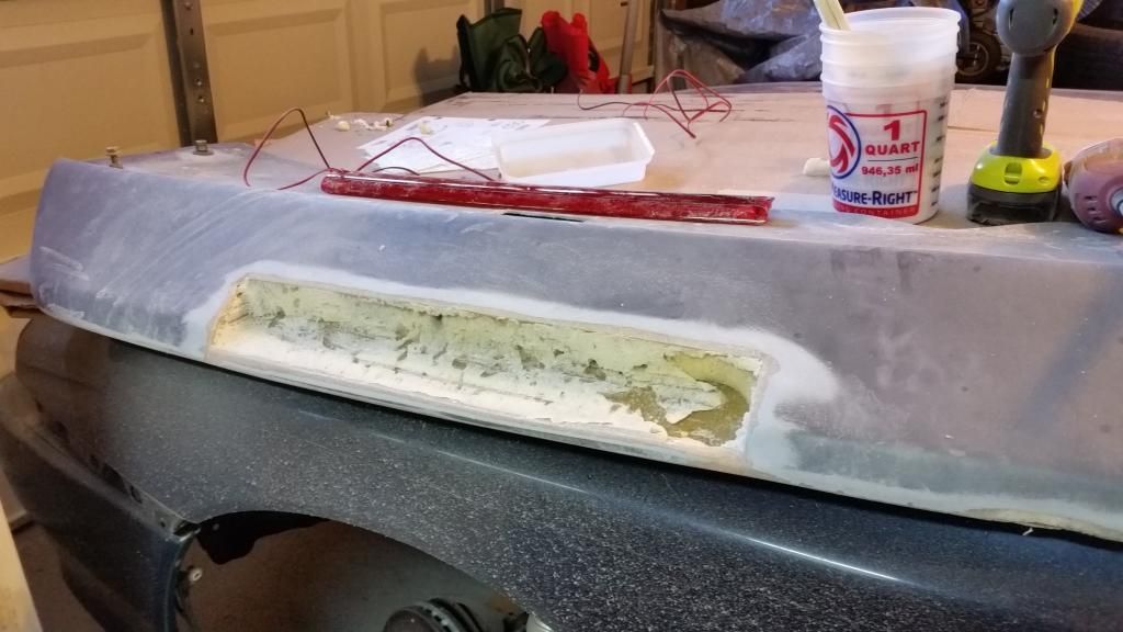

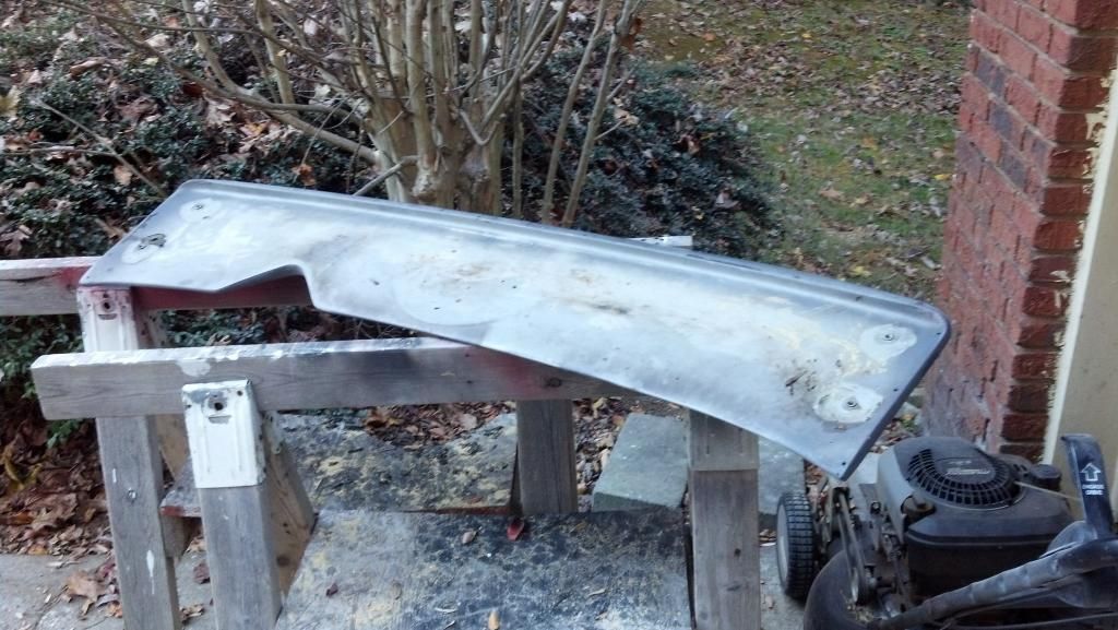

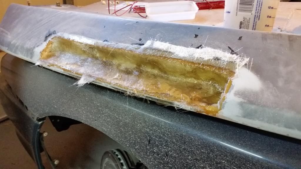

But soon, there should be some visible progress. Still working on the Kaminari tail, and trying to glass in a spot for a third brake light:

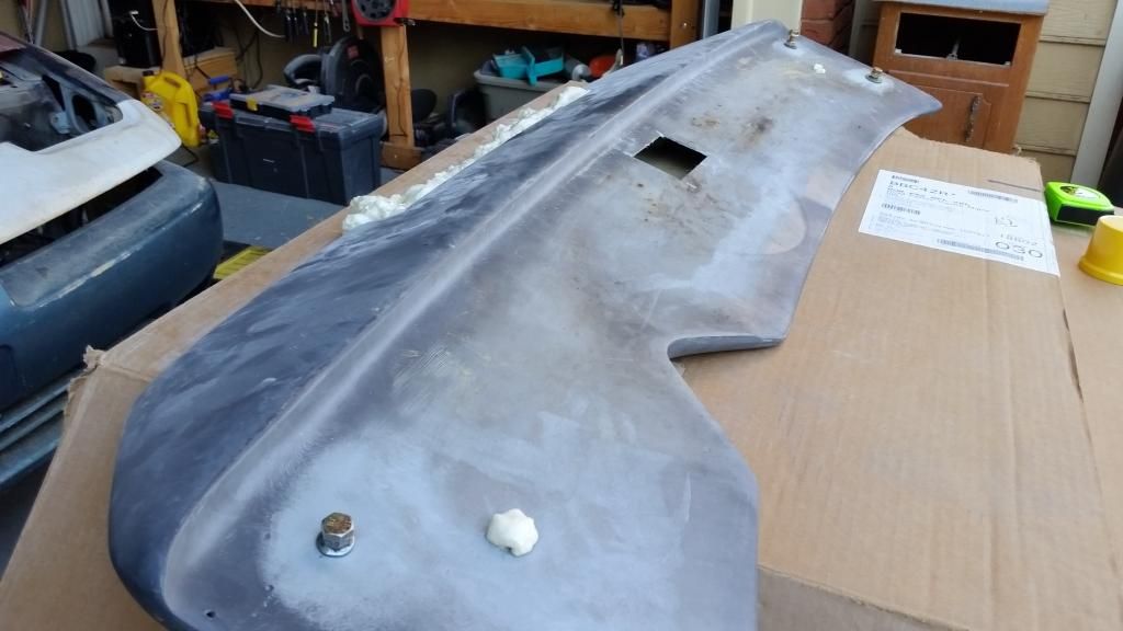

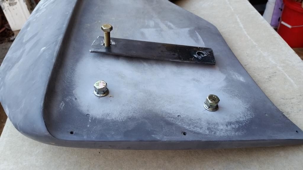

Made some internal brackets, with welded-in 8mm nuts. This shows one bracket exposed, and one installed inside:
I did this, because if I just had 4 bolts going straight into the fiberglass, anyone could come along and literally rip it off. Plus it had too much flex at highway speeds.
This way, it's held down from the inside. Next, I cut the back edge out where I wanted to place the brake light, and slid the brackets in, then threaded bolts into them, so that
I could pull them up snug against the underside(as you can see above). But for installation on the car, I need those brackets to stay right where they are, so...
Spray in low expansion foam, to 'lock them' in place.
Along with that, I also sprayed some as a backing material for the brake light area. Next, is to trim it, and glass it in:
This is as far as I've gotten. Next, I will put in some fiberglass filler, cover with foil, and press the brakelight into position, to mold it to shape a bit. Then more sanding,
shaping and filling, till it's ready for primer.
