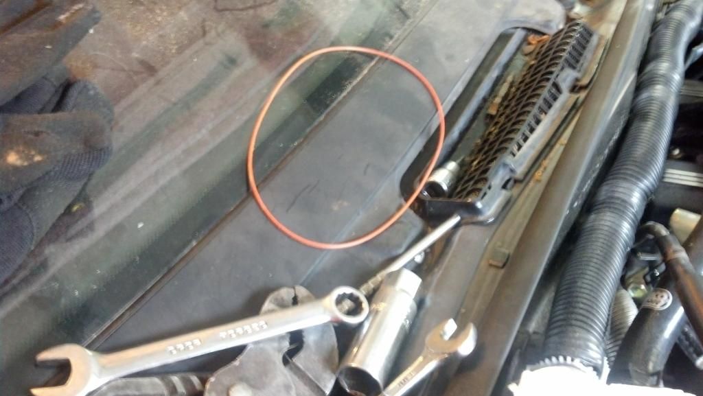

The bad news: I started cleaning up and re-organizing my tools, and came across an O-ring I didn't recognize...then it hit me-
Yup, the compressor cover seal. LOL. okay, so that's not terrible news, but now I have to tear a half dozen things apart to install it.

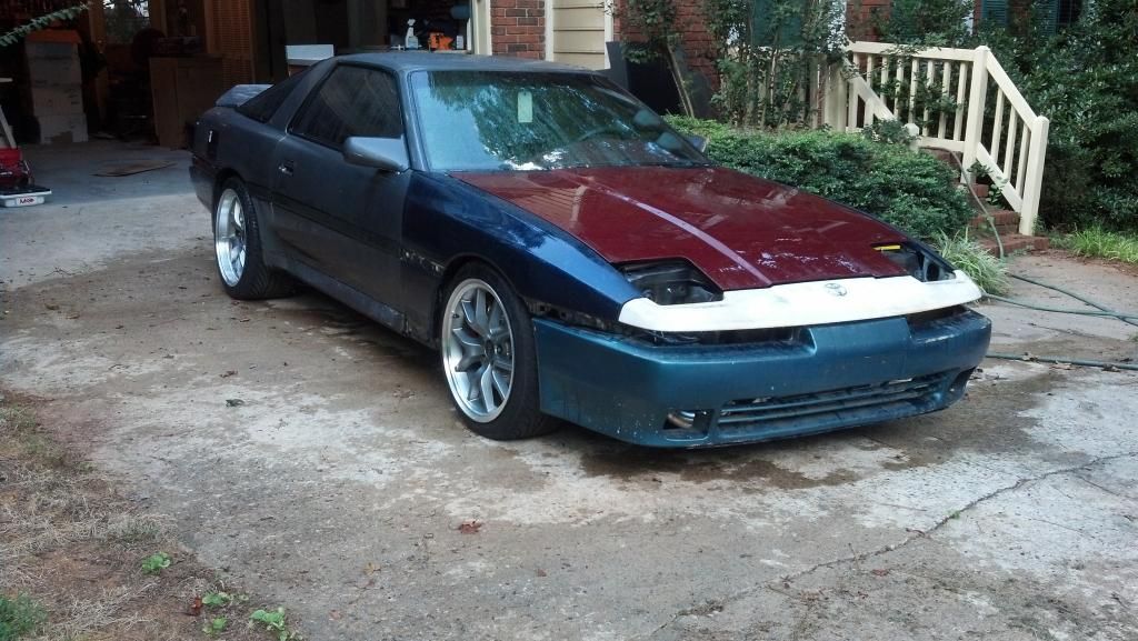

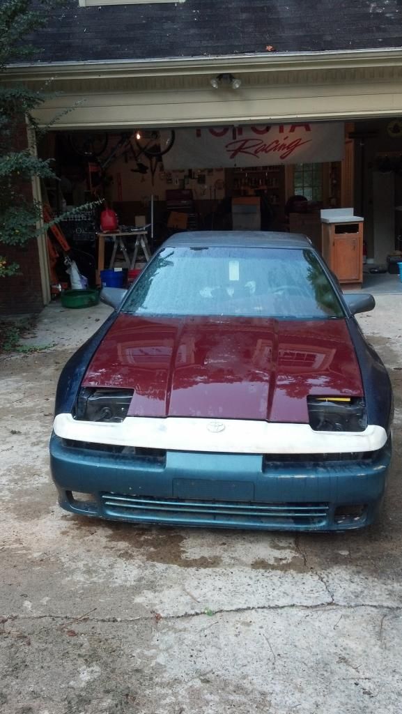

Here's my car in 5 different colors. I rolled it out of the garage to clean all the dust off, and fill the cooling system.
