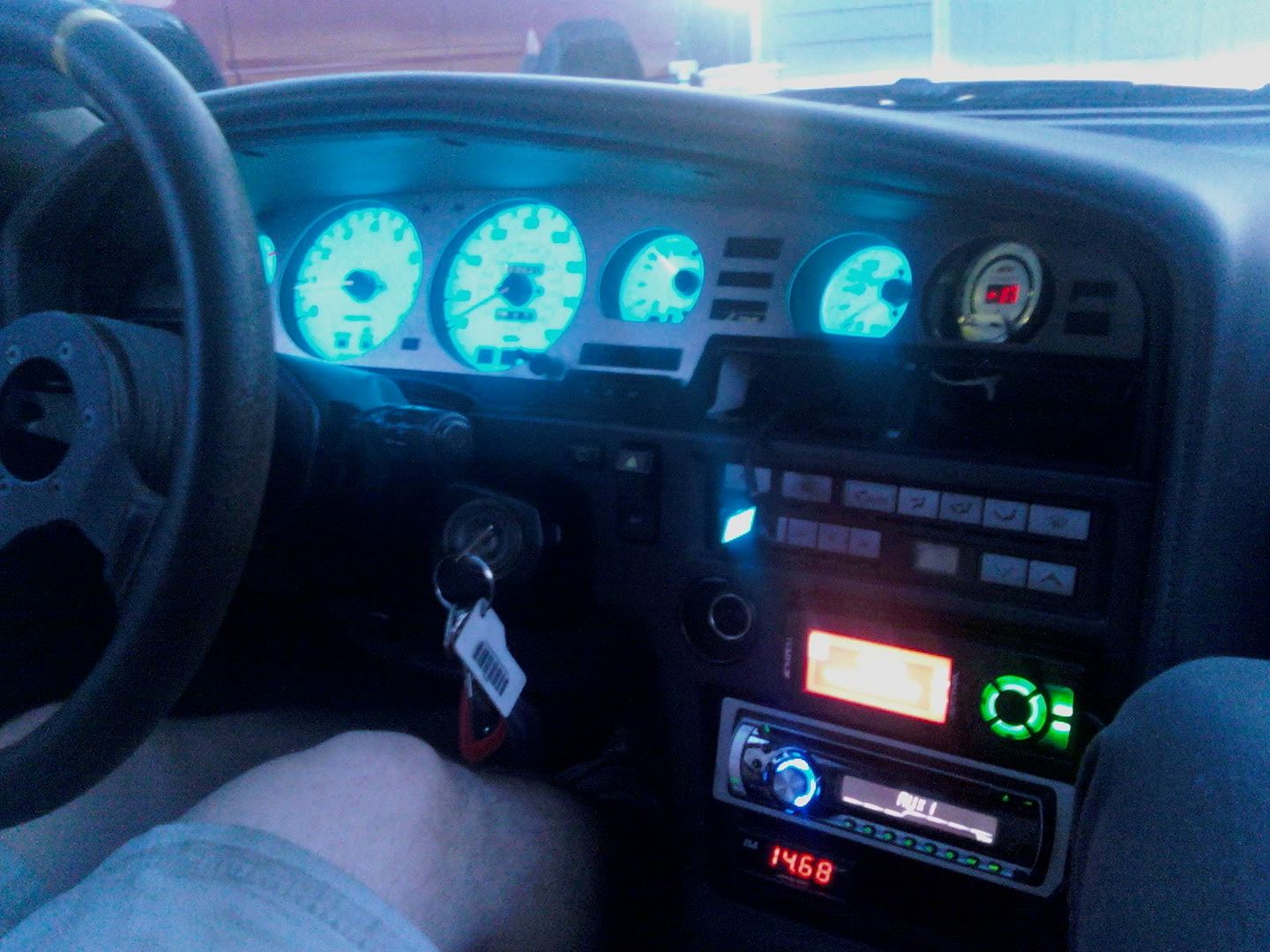

Good news, the wiring issues got fixed yesterday. Big thanks to Trevor (Northwestsupra) for all his hard work and tackling of the wiring issues. We (mostly Trevor) fixed everything that was wrong, including my gauge faces (they glow again now), and he even showed me how to do the auto-up mod (took all of 5 seconds). The problem with most of the electrical stuff was a blown fuse that tested good with a fuse tester but not with a volt meter. We took the Supra for a test drive yesterday. I hit 9.5 PSI running really rich (10:1 AFR's), and discovered my BOV wasn't opening. I fixed that last night, it was stuck. I promise I'll put up pictures when I get my internet back (hopefully tomorrow). They've been building up, waiting to be posted.
northwestsupra
Sep 19, 2006
1,166
Washington, Marysville
its because im baller, i still so pissed, what happened was when i looked at the fuse, and did a ohm test for conductivity it was fine, but when i did a volt test after ripping half the dash apart lol we looked at all the manual to find out what they all had in common, 1 ground point and 1 fuse, regrounded the ground point, didnt fix, went to fuse this time checking it for voltage on both sides this time, 12v on one side, and shit for none on the other, pulled it out to find that it was still connected in the middle but barley. so let this be a lesson, when checking fuses do all 3 tests lol, dont skimp on them.
