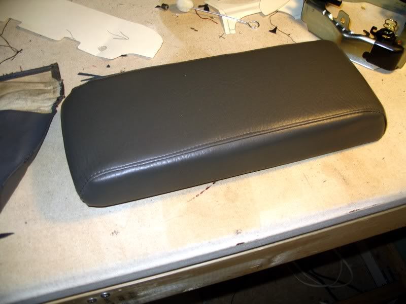

did you tell the dude to color match it or did you tell him what color you wanted it to be? idk but mine seems to be closer match to oem color than yours...

I sent a sample of cloth from my old arm rest where the material looked pretty good and told him to match it. I'm going to send him an e-mail and find out what's up. I'm probably going to mail it back to him at his expense to have him re-do it. Mine should look exactly like yours.
