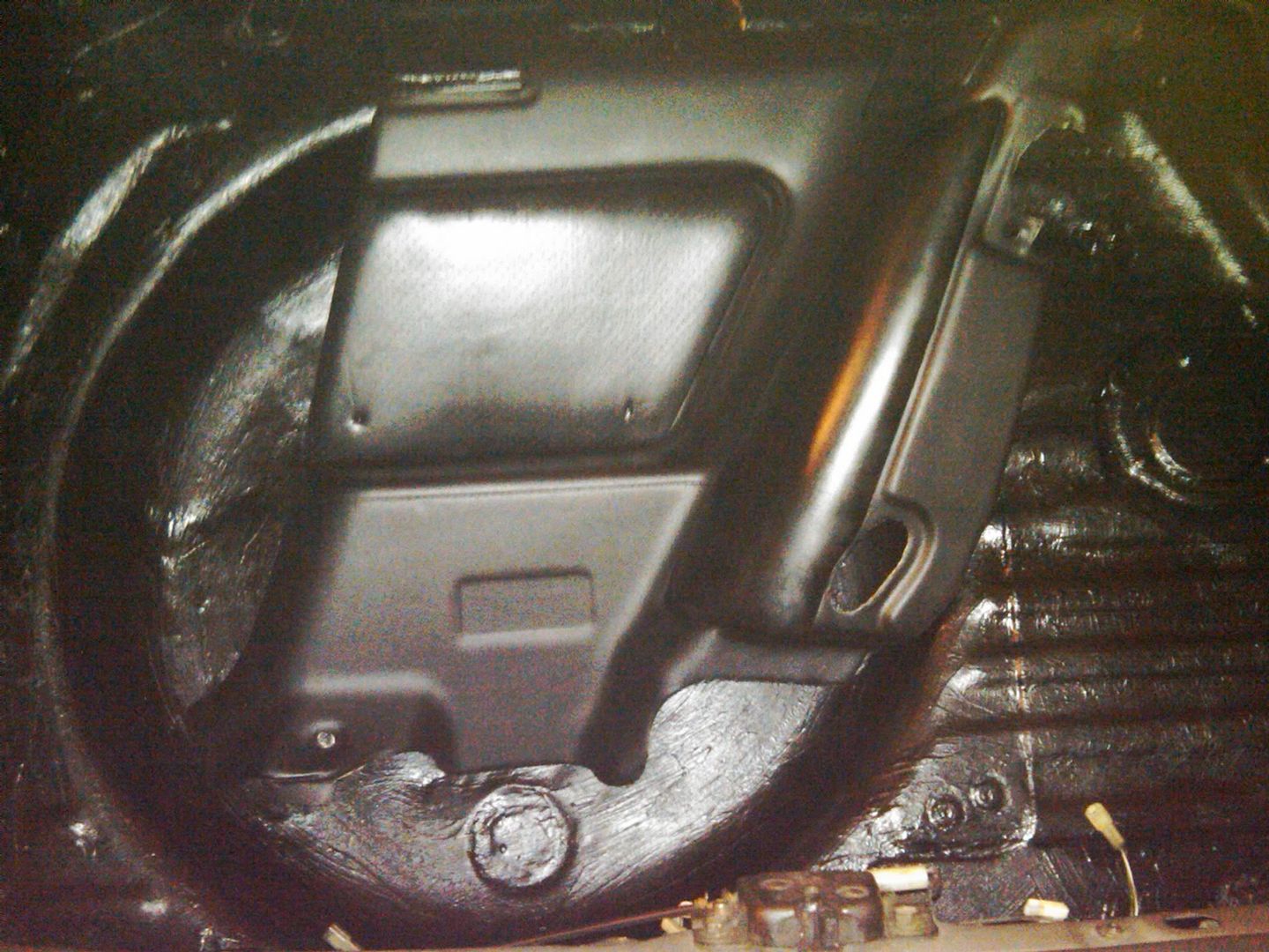

sorry i didnt read the whole thread.. dont have time right now... but thought this was worth mentioning..
i also cant stand the noise inside.. and determined that on the highway most of the sound was from the wheel wells...
i had gone to home depot.. and picked up some tar/foil based whether flashing... if thats what its called..
its pretty much the EXACT same thing as dynomat but 1/4 the cost..
i lined the exterior of the wells with it after washing of course and used a roller for good adhesion... after i had finished that i sprayed it over with rubber undercoating...
it has made my car so much quieter... and a dream on the highway... all while i didnt spend more than $50
looks factory too, best part!

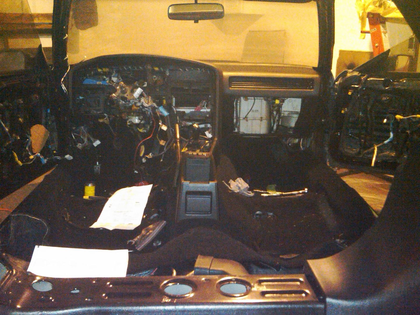

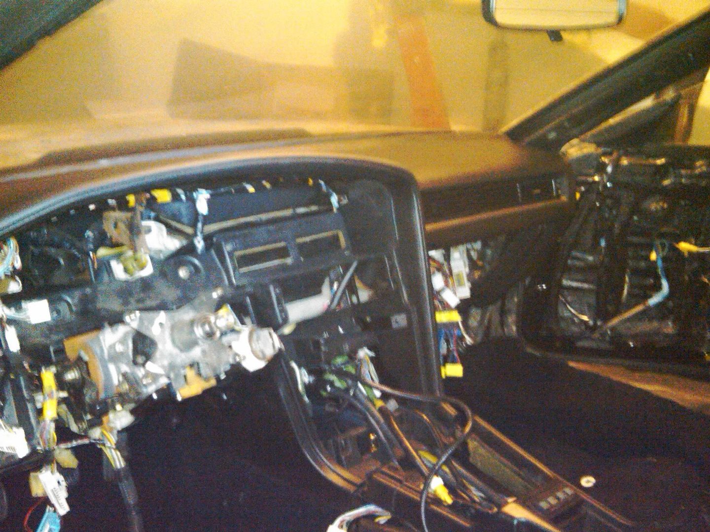

Whew! Finally!
Dashboard is back in :icon_bigg

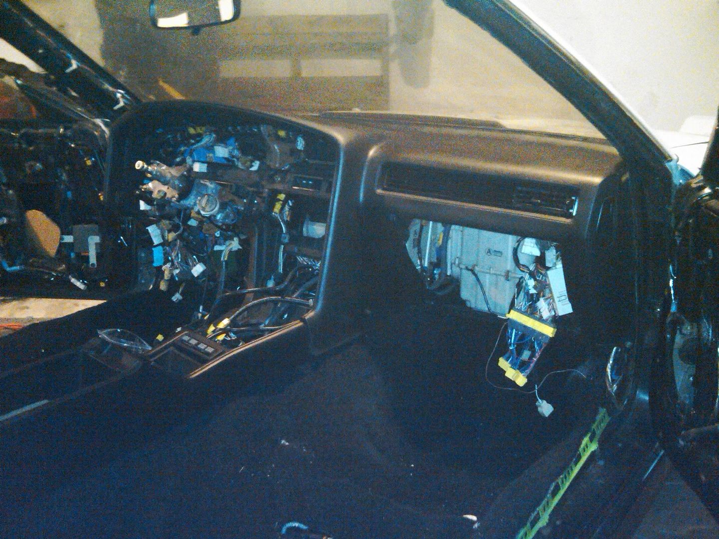

Interior is going back in. Snapped some quick pics to show off some panels. Notice the shadow gray leather inserts were dyed a darker black. This was done with everything except the seats.

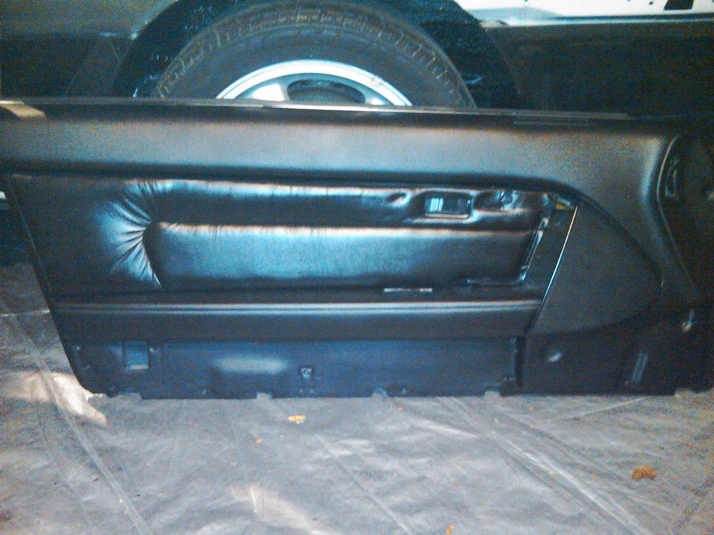

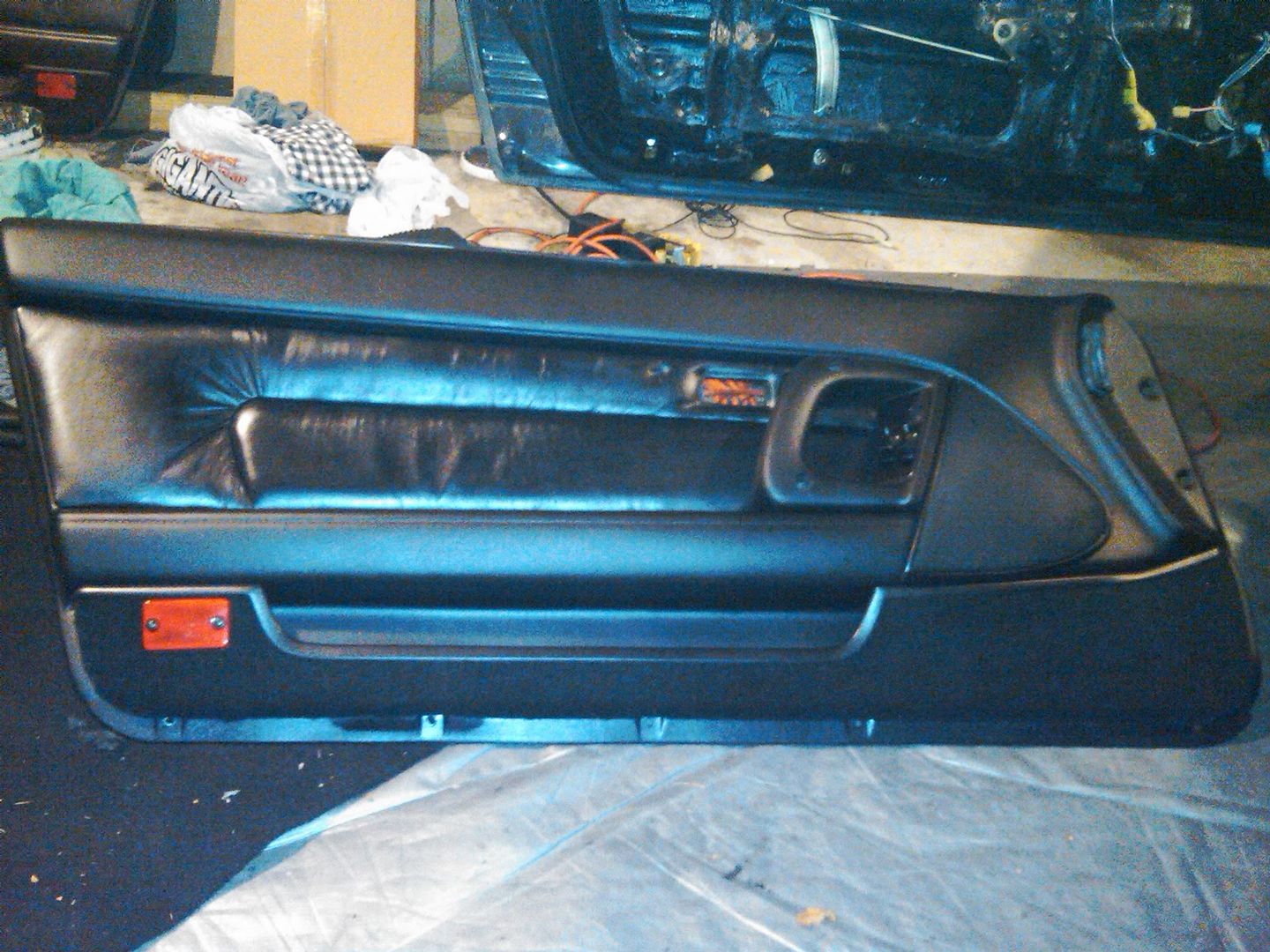

Doors are donedizzle.
They look freakin awesome! Vinyl painted with AutoMagic flat black. Plastic painted with Krylon Fusion. Shadow grey leather panel dyed dark black and rubbed down in Lexol conditioner. Lower door recovered with black carpet.
You'd think the panel was available like this from factory.:naughty:
