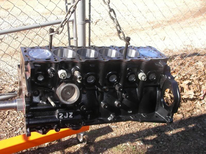

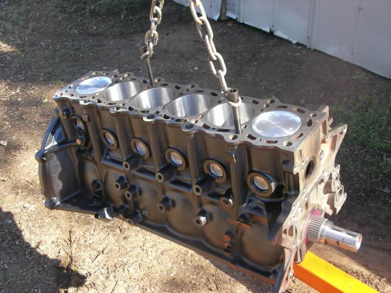

Here is a picture of my block. I hope to get the head on it sometime today, but I've still got things to do so I can pay for all of this. The block had to be bored and then honed, the crank was polished, the head was rebuilt wiith new valve guides, I also had new main and rod bearings installed and the total bill was $536.00 with them suppling the bearings. I had to buy the new pistons and rings.
You can see the red / pink redline assembly lube that they used. I supplied that.

J: I'm NOT a big fan of lifting motors like that :(
It would be a really good idea to put a straight edge across the deck at the holes used to make sure it hasn't distorted the surface....
Thanks IJ. It was only like that long enough to take the pictures and to bolt my engine stand up to it. It is on the engine stand now so hopefully all is well. I can't help but think you are trying to put some kind of IJAusie7m curse on my jz motor............;)
suprahero;913618 said:
IJ, I've already got the head on it and torqued down. I hope I didn't mess anything up. If I did, I'll be the first to know. If I had read this sooner, I would have checked it, but I'm sure I didn't mess anything up...........(really, really, really crosses fingers and toes)
Jay, if damage were to happen, I would think it would happen during the lifting, not just while hanging. That's where the actual transfer of weight happens.
IJ.;913810 said:
J: Please check it before the head goes on :(
Maybe he's saying to check it in between this test fit, and the final installation???

J: My major concern is that the bolts are providing a lever and while I know Jack about Jz's I do know Toyota don't make really thick decks so I'm worried that lifting it that way will deform the deck.
It would suck to put it all together and get a BHG shortly after.
Short bolts and aluminium spacers bolted directly to the Deck would be fine.
