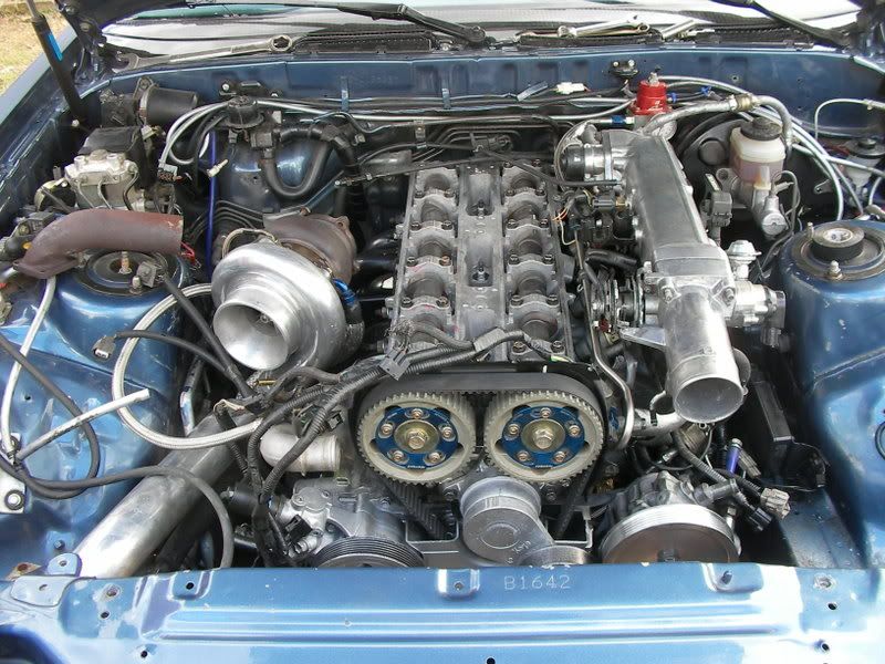

I didn't take any pictures of the engine sitting in the bay because I had to go to work. I'll get one tomorrow and I'll try to take one of where the wastegate and downpipe are going to run.

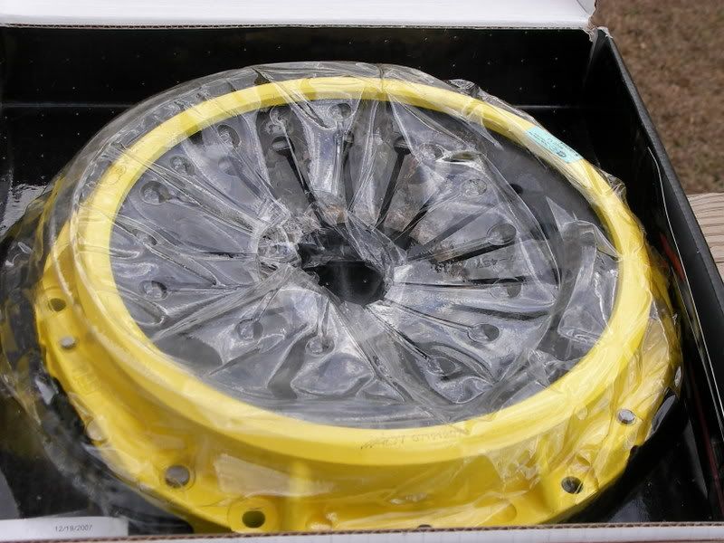

Here are a couple of pictures. I just got the pressure plate today, so now I have everything I need to install the transmission. I have a brand new 1jz lightened flywheel, slave cylinder, clutch master cylinder, braided clutch line, clutch disk, pressure plate, Red line MT90, so my clutch problems are a thing of the past. When I took my old flywheel off, I noticed it was warped. You can see where the pp was only catching in certain spots. I hope to have all of this installed tonight before the rain comes. It's going be colder here tomorrow, so I want to get it all done today.
Gotta go get greasy. See ya later alligator.
So ends the clutch mystery. I won't say I told you so....:sarcasm:
Good stuff Jay
rakkasan;919623 said:
Sound ends the clutch mystery. I won't say I told you so....:sarcasm:
I told you so Jay
I thought you weren't going to tell me so............:nono:
