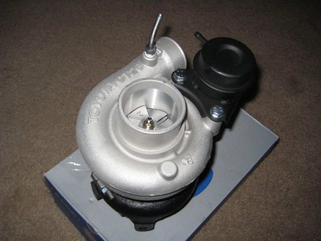

I have a 57 trim and CX Racing intercooler kit on the way. Will be doing fuel/tuning mods soon as well. Looks like Maft-Pro is the way to go when it comes to piggybacks, that is probably what I will use. Any input as far as piggybacks go would be welcome, I'm a total noob when it comes to tuning.

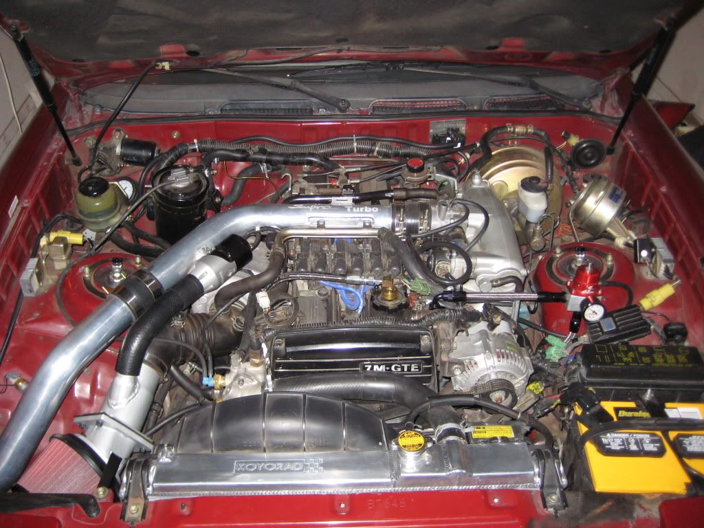

more pics

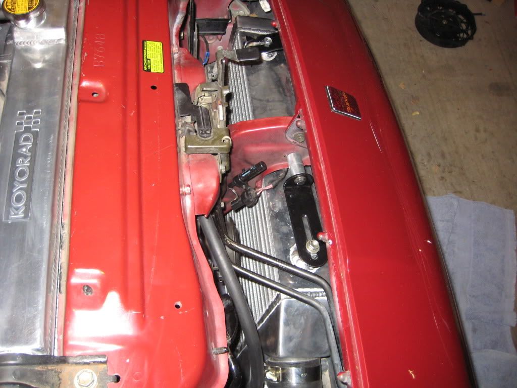

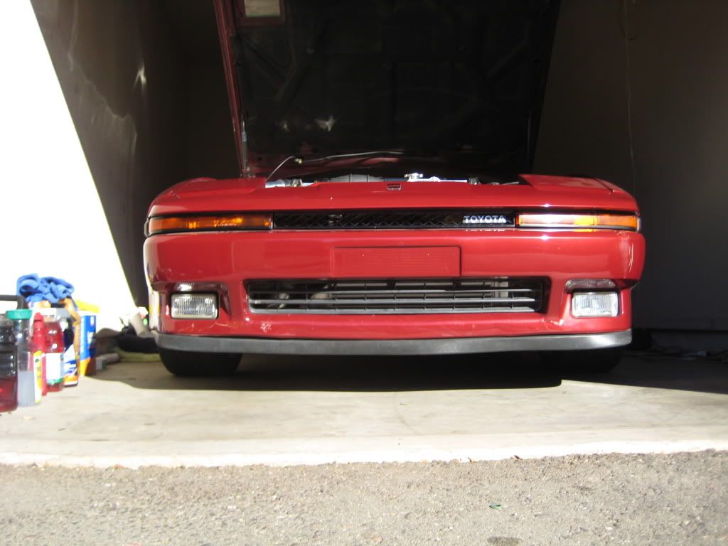

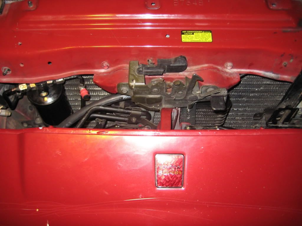

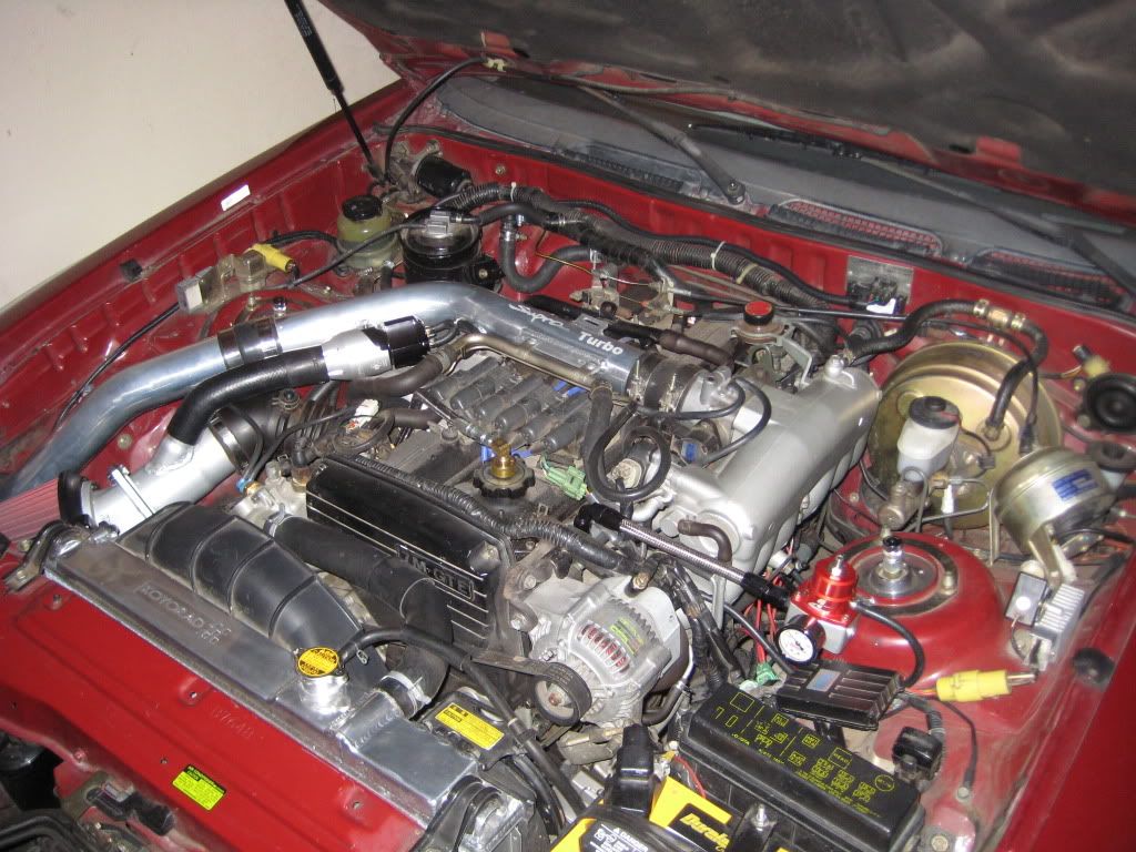

CX Racing intercooler kit, bought it from Zankoku performance for a fraction of the price, fast delivery and all! Kit was pretty good. Intercooler is big and fit relatively well, the supplied brackets are quite a joke and the fitting of the piping is not the best where it all meets the intercooler, it is a very cramped fit. All around good kit for the price though i must say! I didn't have to remove the stock hood latch support which i was happy about, and i didn't have to relocate the overflow bottle which was great too, all i had to move was the stock oil cooler. I haven't put the under tray back on yet but its looking like it will need to be modified to clear everything.
Relocated oil cooler

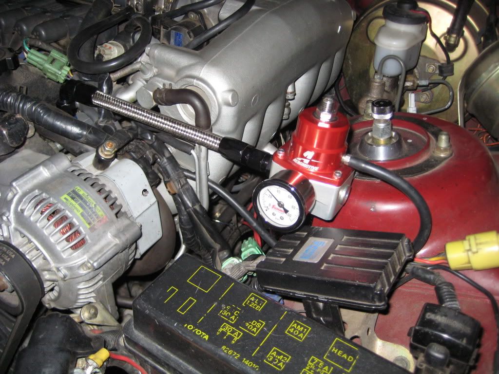

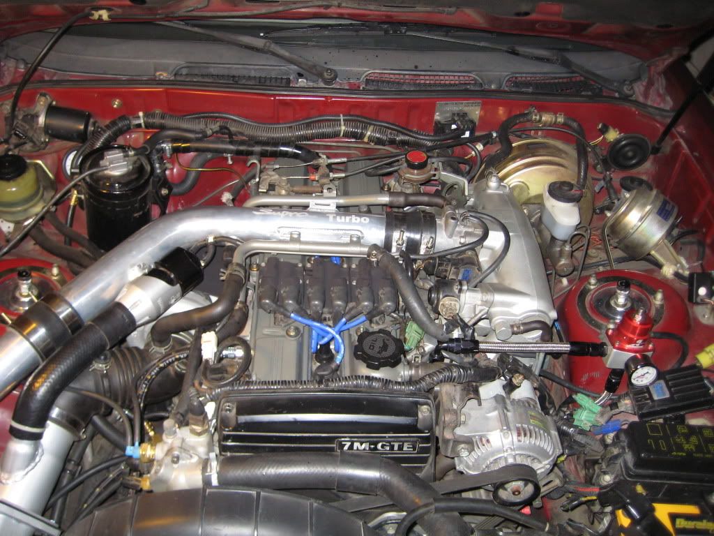

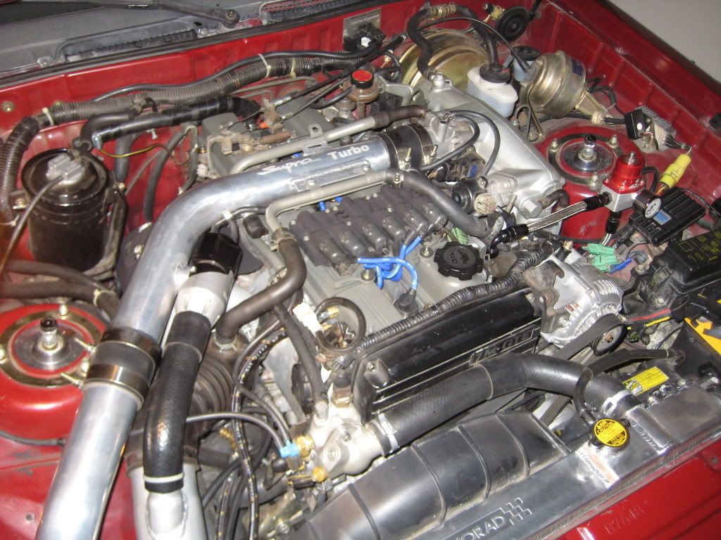

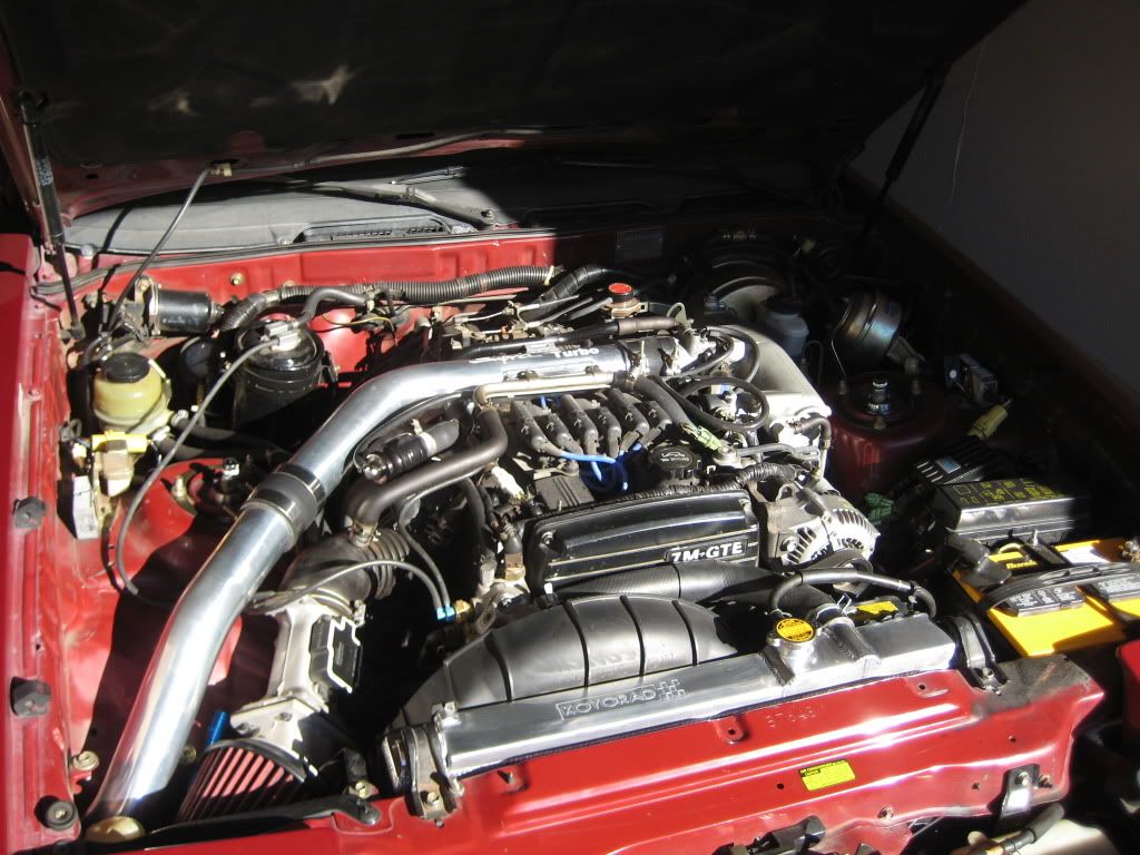

New parts added
-Walbro 255lph
-RX7 Denso 550's
-Aeromotive FPR
-Synapse Synchronic BOV recirculated
-MaftPro+spd density+boost control
Pics:

Looking good, I can't wait to get my car running on the MAFT Pro speed density (installing it now)!
The line from the rail to your AFPR looks a little tight. I'd be afraid any engine movement would stress that too much.
Ya still getting used to the MAFT pro myself, working out pretty well so far though! The line looks pretty tight but it isn't in actuality. It actually ended up a little longer than i wanted, but that's ok. The stainless line is fairly stiff so its not easy to leave much slack.

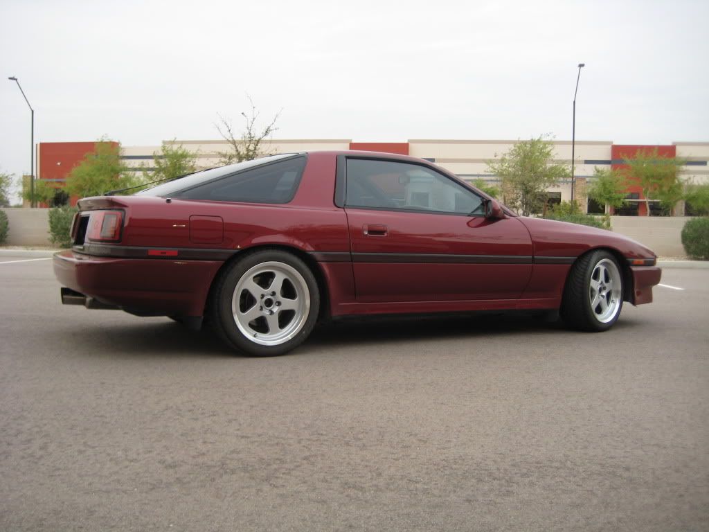

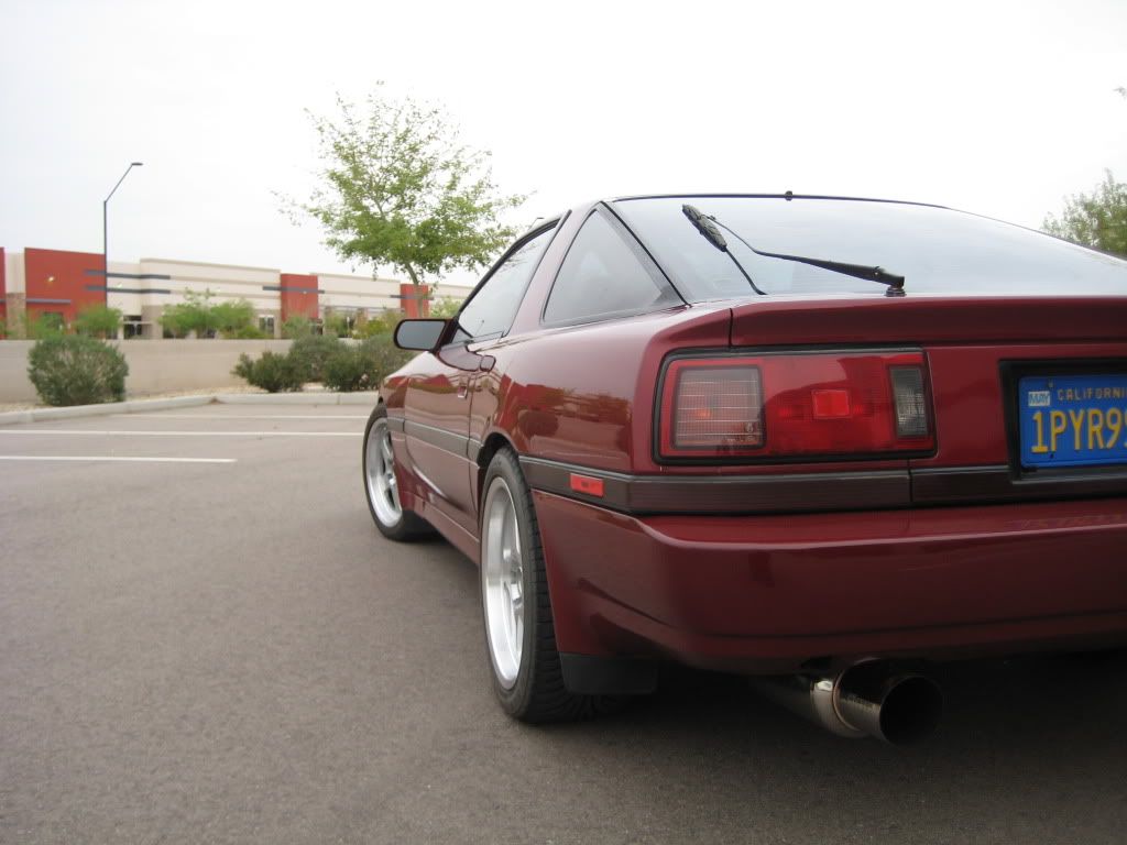

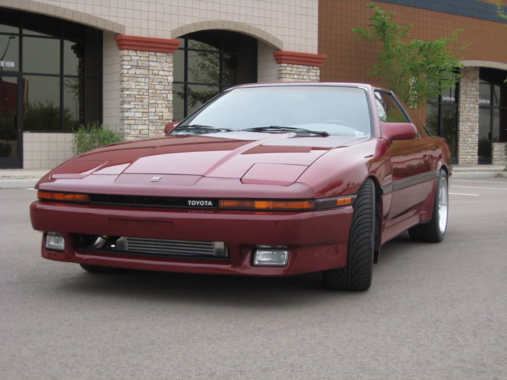

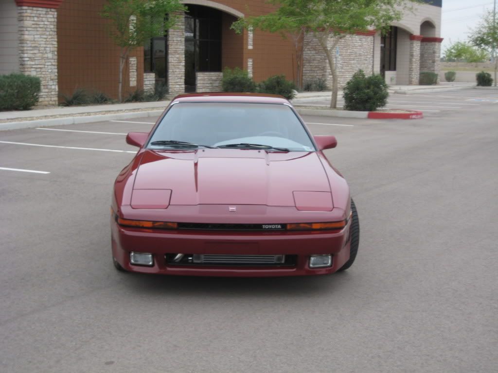

Purchased a new front bumper and I am going to have the front/rear bumpers repainted (front is damaged and rear paint is faded). After I get all that stuff done the car should be picture worthy:D
CyFi6
Aliens.
Oct 11, 2007
2,972
Phoenix
www.google.com

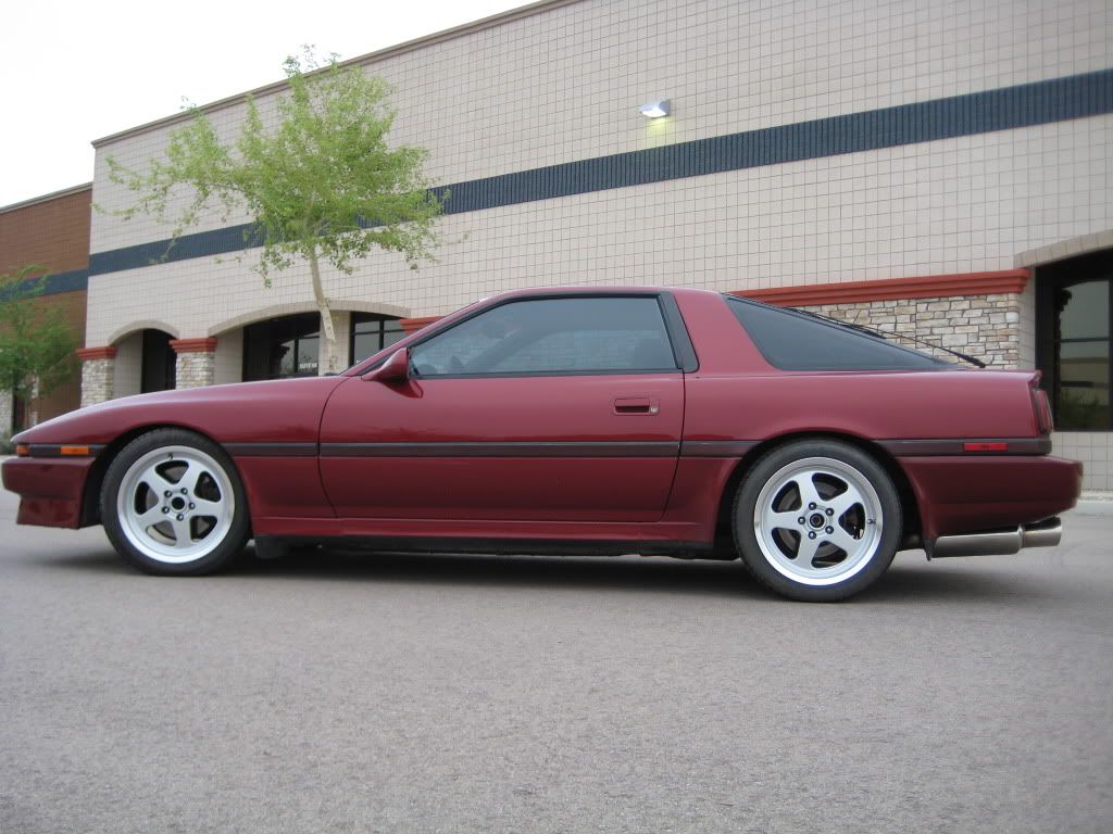

Cleaned up my Supra and thought id throw some pics up. Just got the bumpers repainted but unfortunately they didn't do the best job matching the color :cry: ... Hopefully that will be fixed soon. The video quality is pretty bad but it gives you an idea.. It was running about 13-14 psi and needs to be tuned very badly, but still decently quick.
For anyone that does'nt know..
Rebuilt 7MGTE
Probe pistons
Cometic HG
57 Trim CT26
MaftPro
2.5" intercooler piping
3" downpipe/Blitz Nur Spec exhaust
Walbro/550's/AFPR
other misc mods
Mustang SC wheels with 255/40/r17 tires
http://www.youtube.com/watch?v=0dlBEcVYO74

hey man, i was looking at getting a set of those sc replicas, 9" all around. is your fitment direct bolt on? any issues? thx
