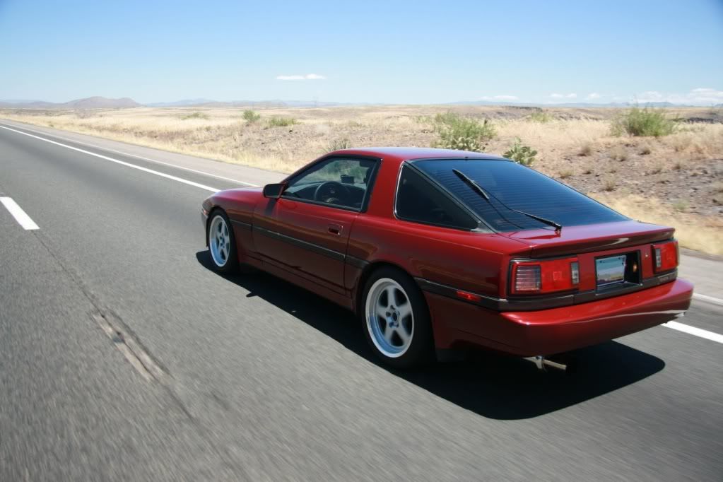

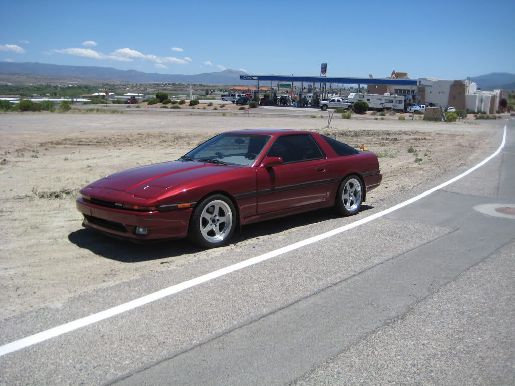

yoanthonyyyy;1706442 said:
i love build threads with a bunch of pics.
car is real clean, very nice setup too.
Thanks! Heres some more pics from a recent cruise

jackmk2mk3;1717408 said:
Beautiful car dude. How do you like the sound on the Blitz Nur Spec? It's the exhaust I want to get when I eventually get another supra, but there aren't any good videos of it on youtube.
Thanks, I really like the Nur Spec besides how it looks, Im not really a fan of the can style mufflers, but I got a good deal on it and it sounds nice, if you look back to post 96 theres a short video of my car.

SupaMan;1717416 said:
Amazing pictures! I always loved that color when its clean!
Enraged;1717486 said:
replace your sig picture, it doesn't do your car justice :)
Thanks! :)
