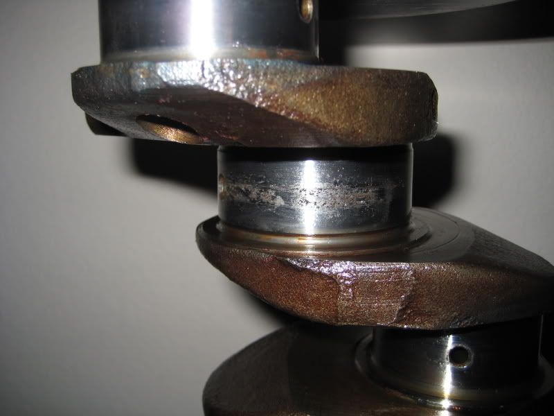

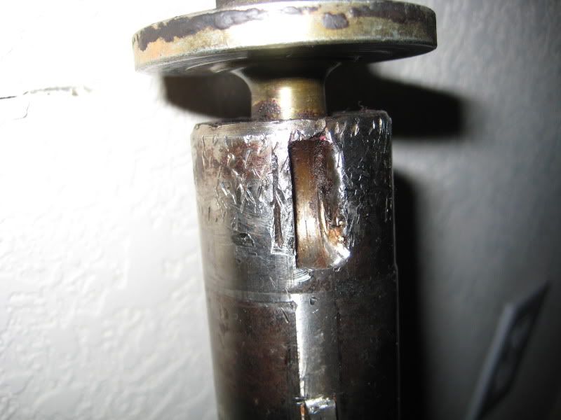

Nice work on the head :) If you haven't ordered bearings for the bottom end yet I'd highly, highly advise you to measure the actual crank journal and rod/main hole diameters instead of going by the numbers stamped on the parts. Mine were nowhere close to the stamped numbers at all.

^Already been measured... Ya it was just out for a rebuild less than 10k miles ago so who knows what the previous person "polished" off the crank etc. Most of the numbers matched but some did not.

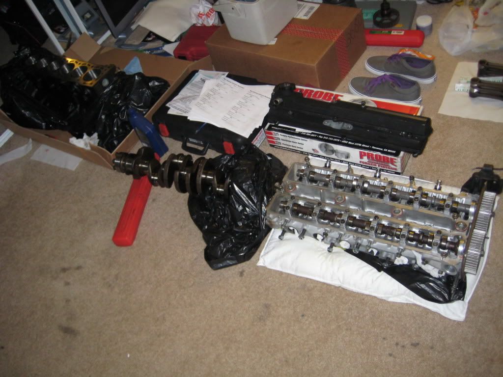

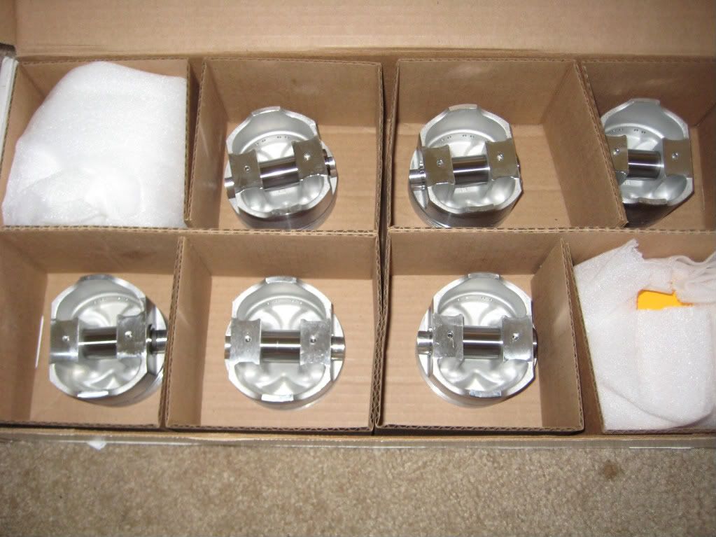

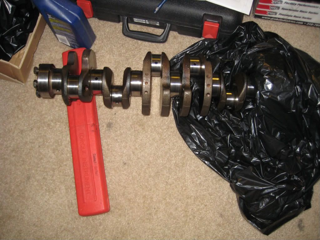

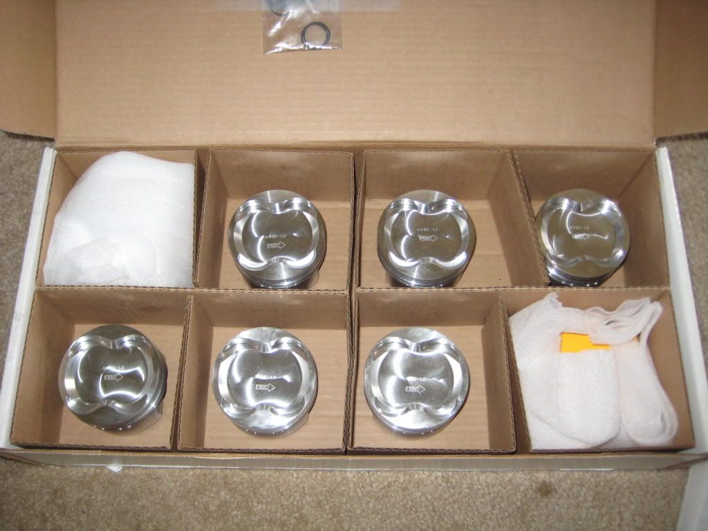

Well its been a long time since i have updated. I have since gotten a job and now have an income, so this is going to be a full rebuild with forged pistons, stock lower end, and MHG. The engine is at the shop right now ready to be machined, but i have gone from wanting cast pistons to forged, so as soon as i send him my pistons the work will all start. This is a day i have been waiting for for a long time! (Thank you DriftMotion for your great service and fast shipping!):

Added to the list...

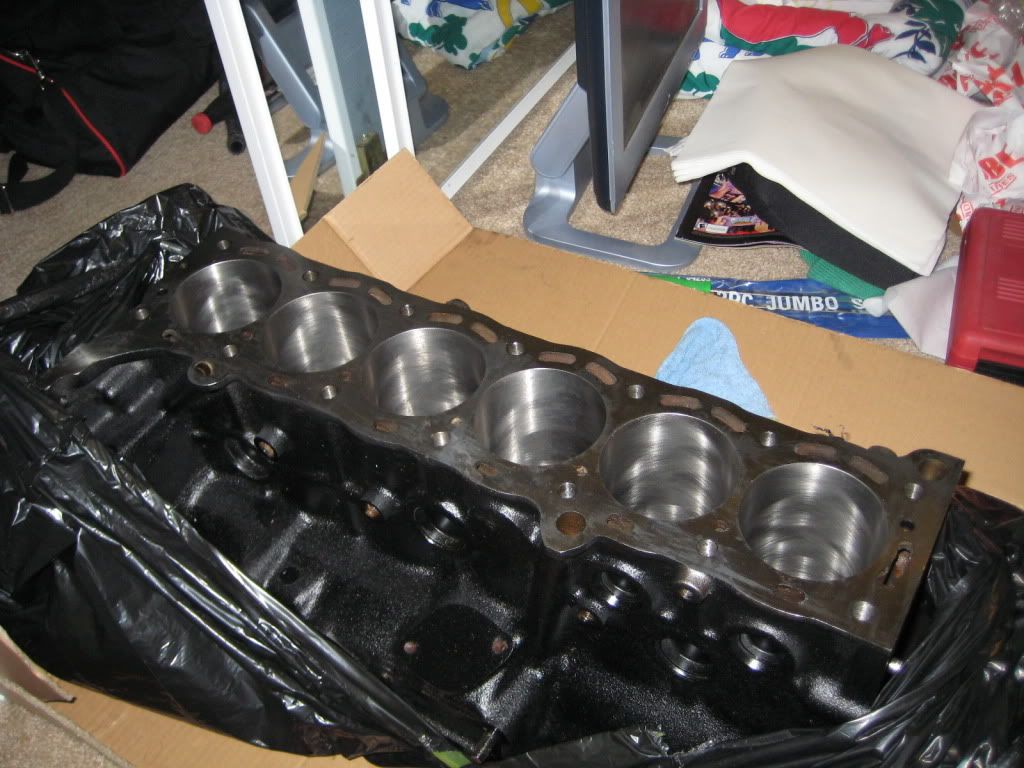

-Block bored/honed .040" over
-Block(yes, with the timing cover ;)) and head decked under 30RA
-.040" over Probes
-Balanced/polished crank
-Re-sized/balanced rods

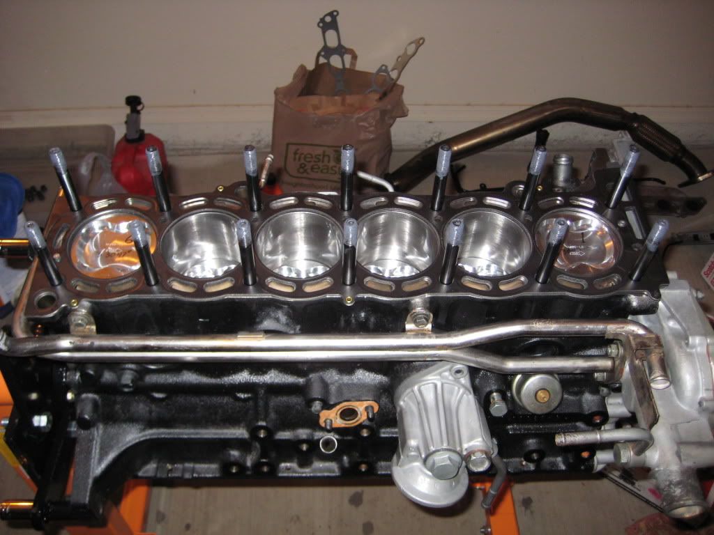

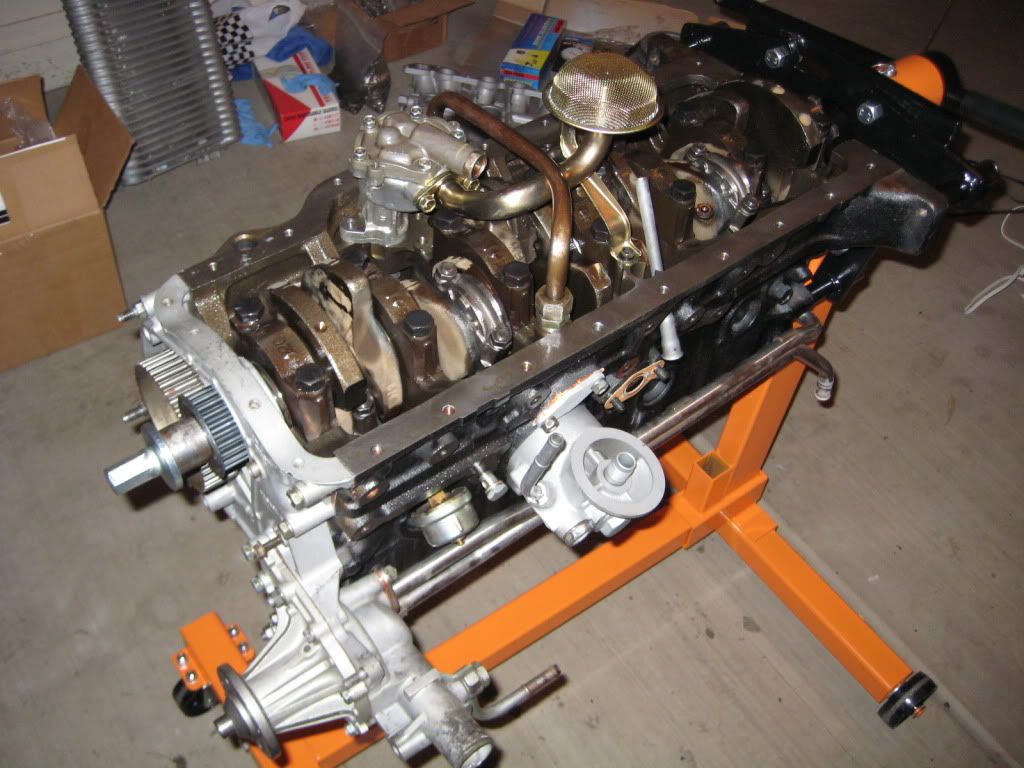

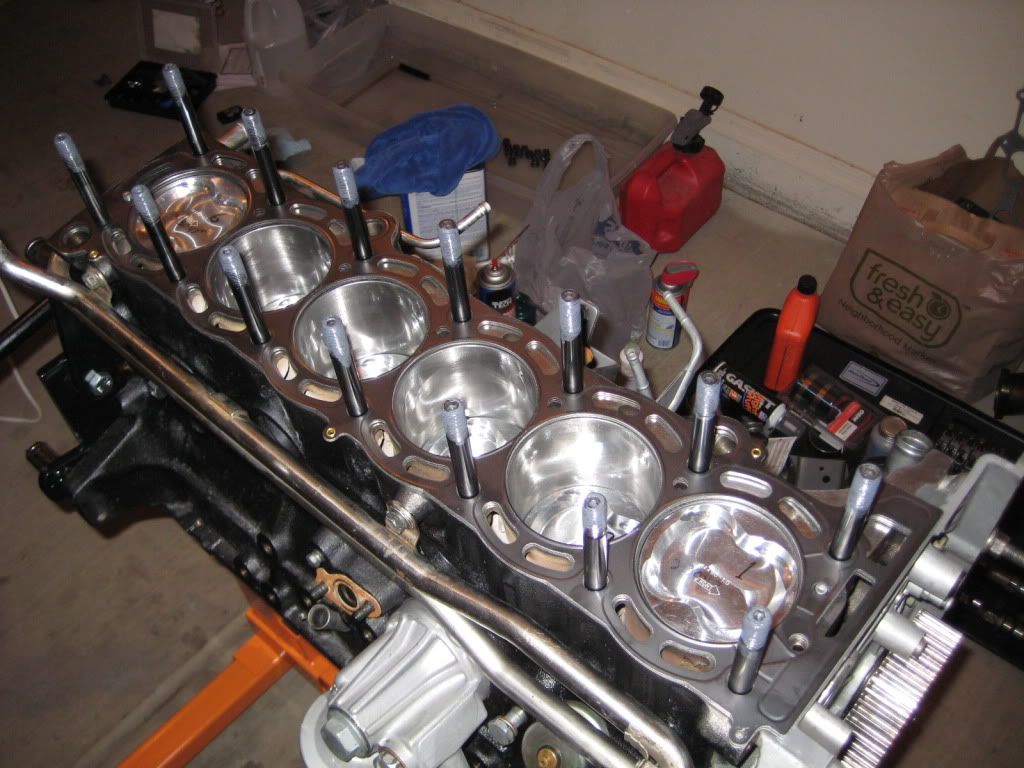

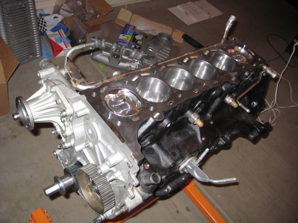

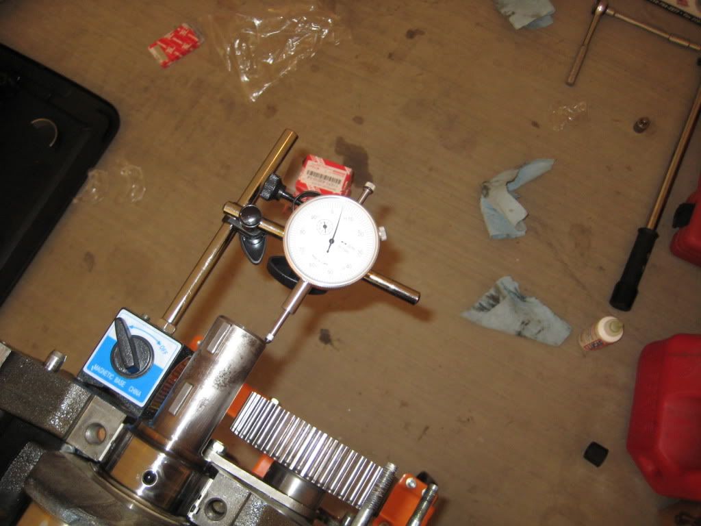

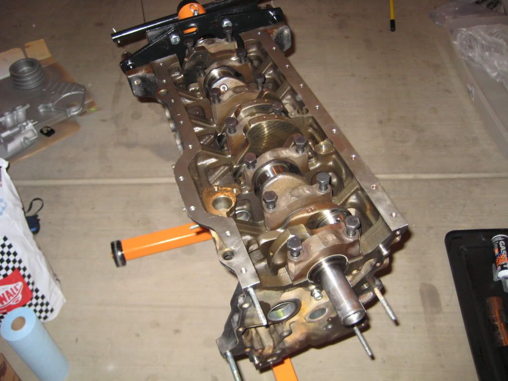

some updates:) Finally.

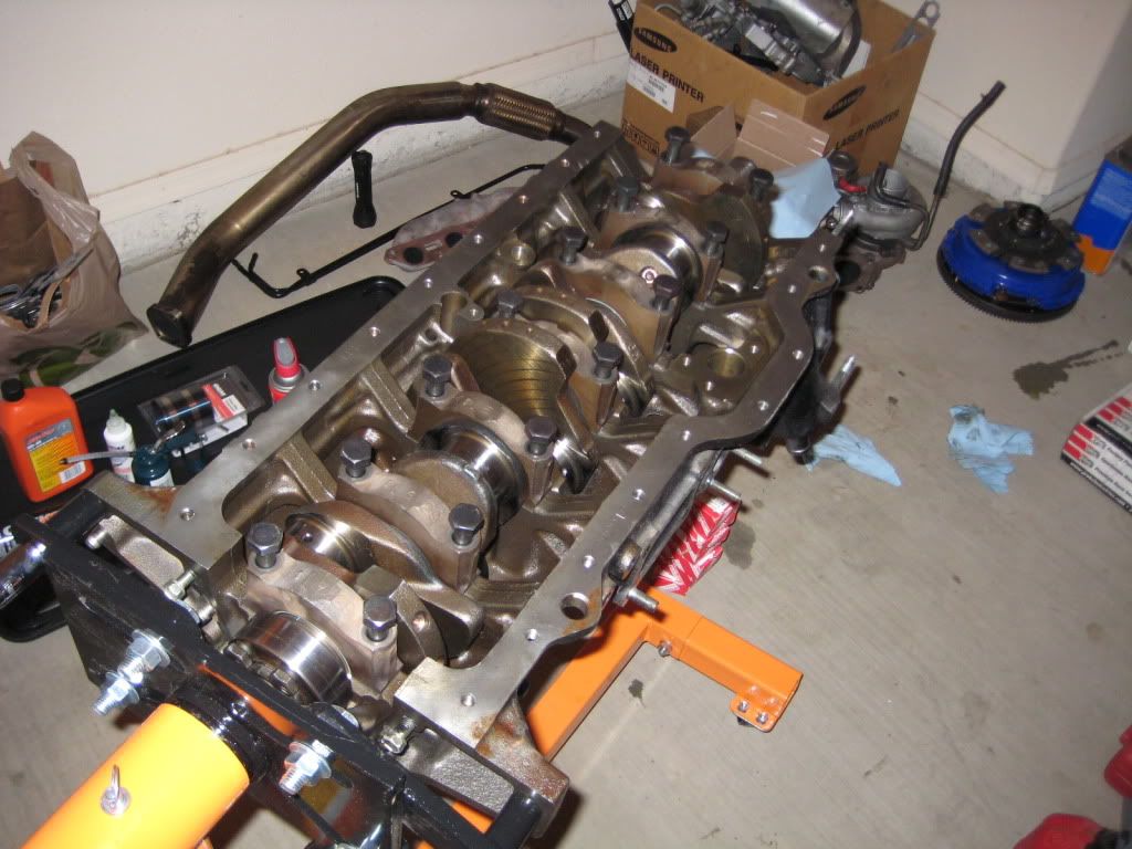

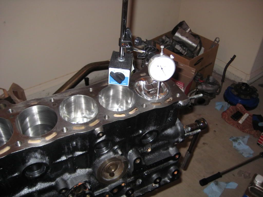

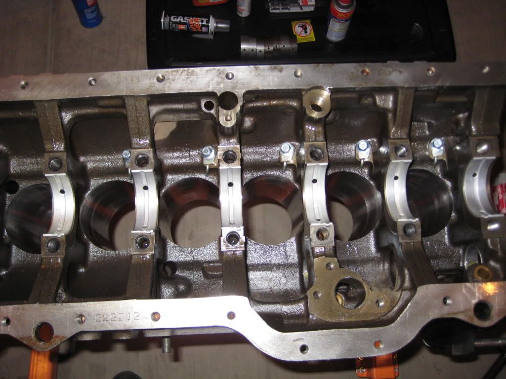

Operations completed
-Installed crank, rods, pistons
-Check crank end play
-Check rod side clearance
-Install and shim oil pump
-Shim cooler relief
-install ARP studs/ Cometic MLS/ Cylinder head

92nsx;1464644 said:
All that and no -8an oil pump hose. :(
Build looks to be going pretty good so far.
After some research i found that the upgraded oil pump lines including the arz line is overkill and i dont really need it. If there was proof anywhere that the oiling system flows more than the stock pipe can handle i might be convinced.

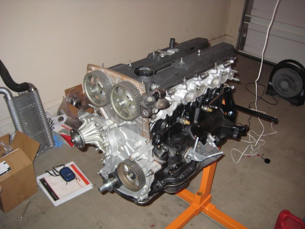

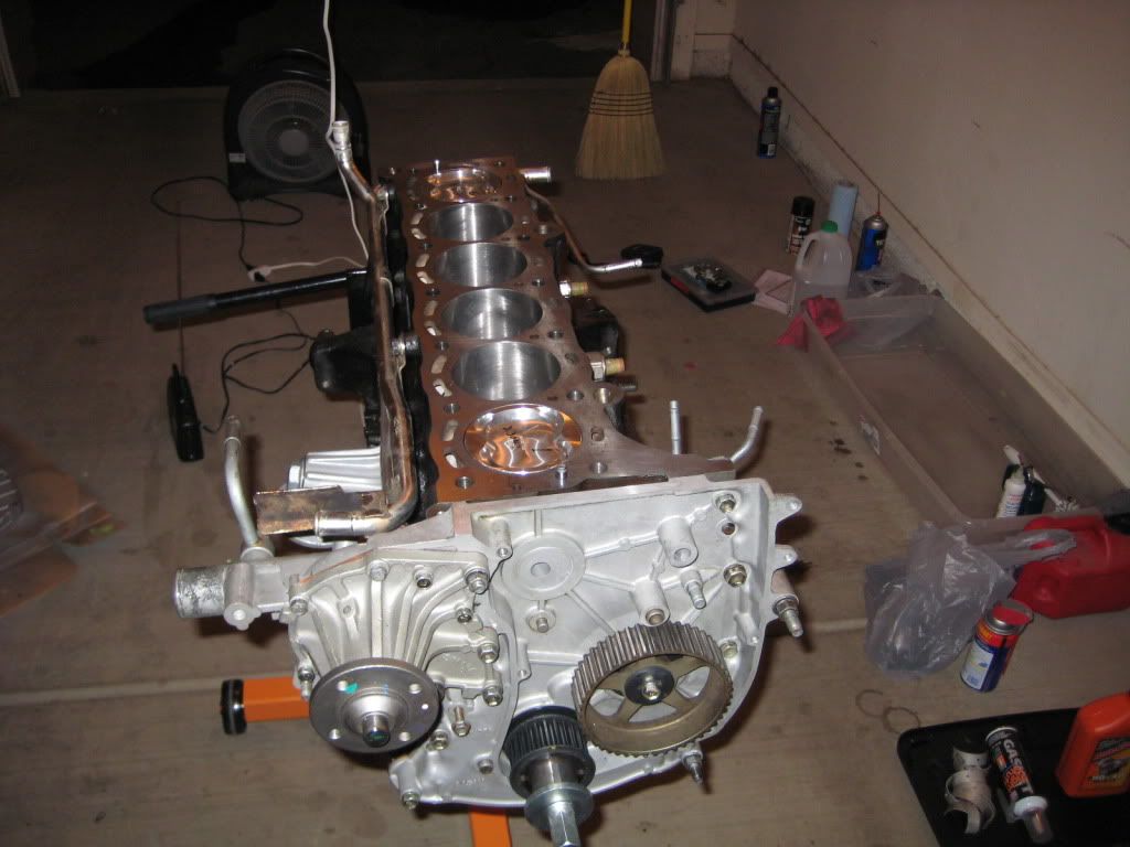

Anyway thanks for the comments, heres some more pics.

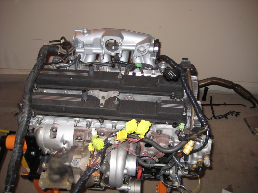

Cy....I have a spare heat shield for the manifold if you want to use both....I also have the turbo heat shield...you have to remove the turbo to install the other shield. If you want them let me know.

engine looks like it came together nicely, my build should be getting about that far within the next week or so
