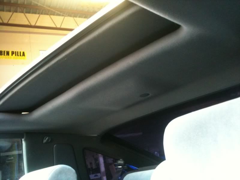

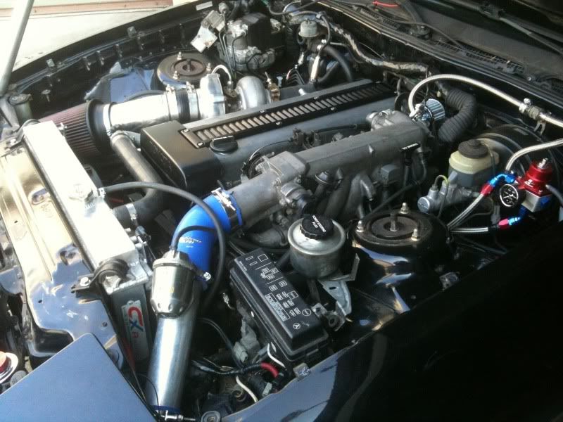

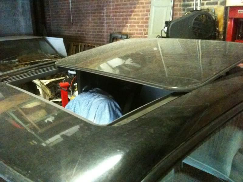

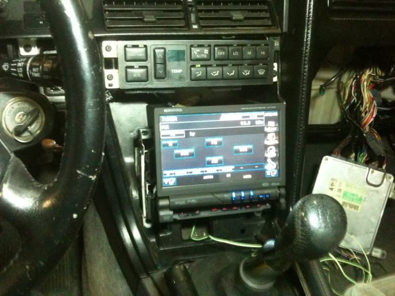

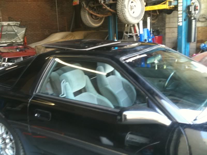

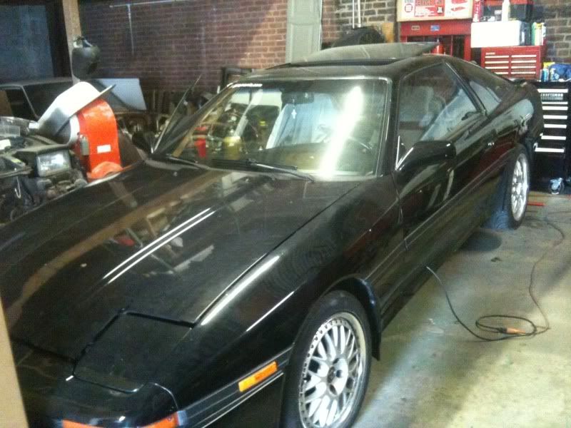

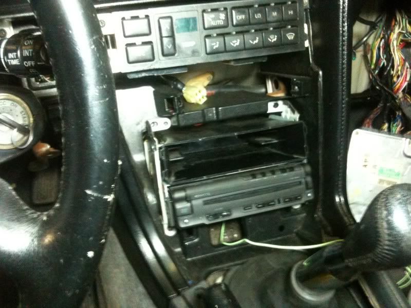

Finally relocated battery. Was also able to hook up the head unit and listen to some tunes. Opened up the moon roof tonket some light in.
now u see it
now u don't. Hehe...

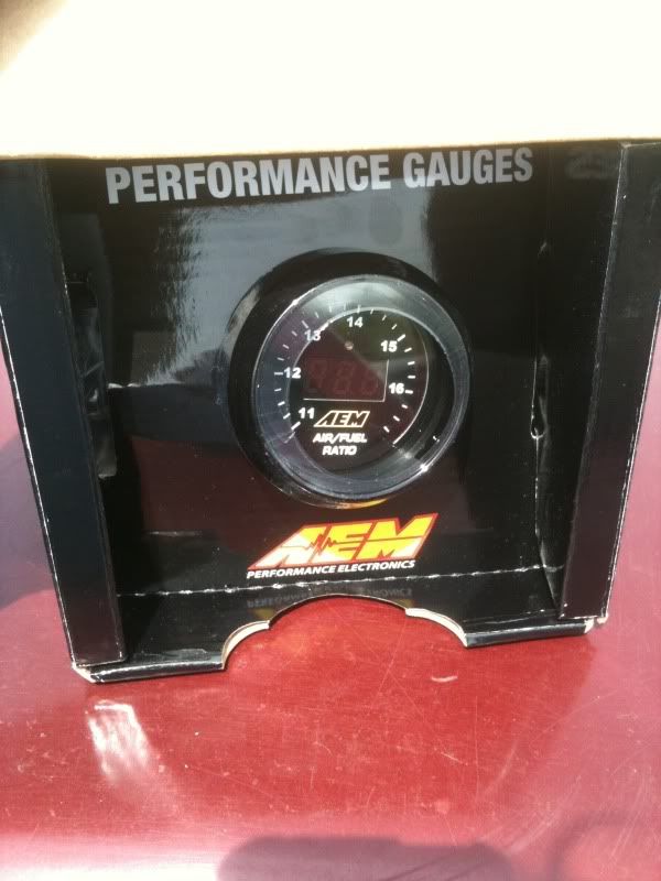

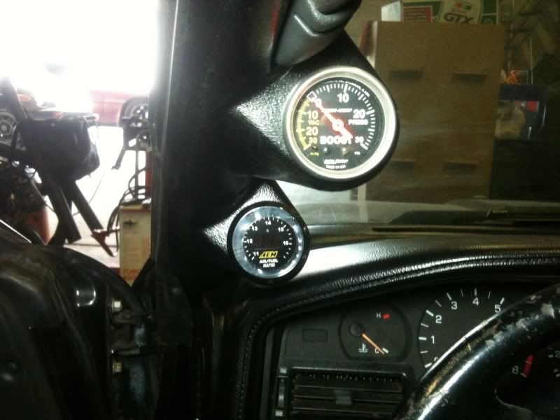

started to hook up the wideband.

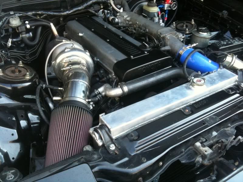

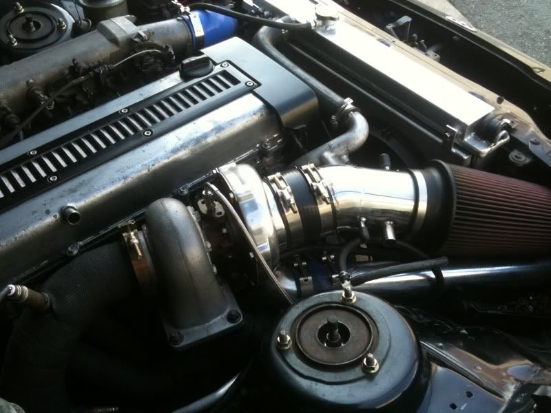

To do the whole engine/trans swap. All I bought were solid monts. I didn't change anything. Mounts lined up near perfectly. It was just kind of a bitch to do the whole swap by myself cause no one was around.

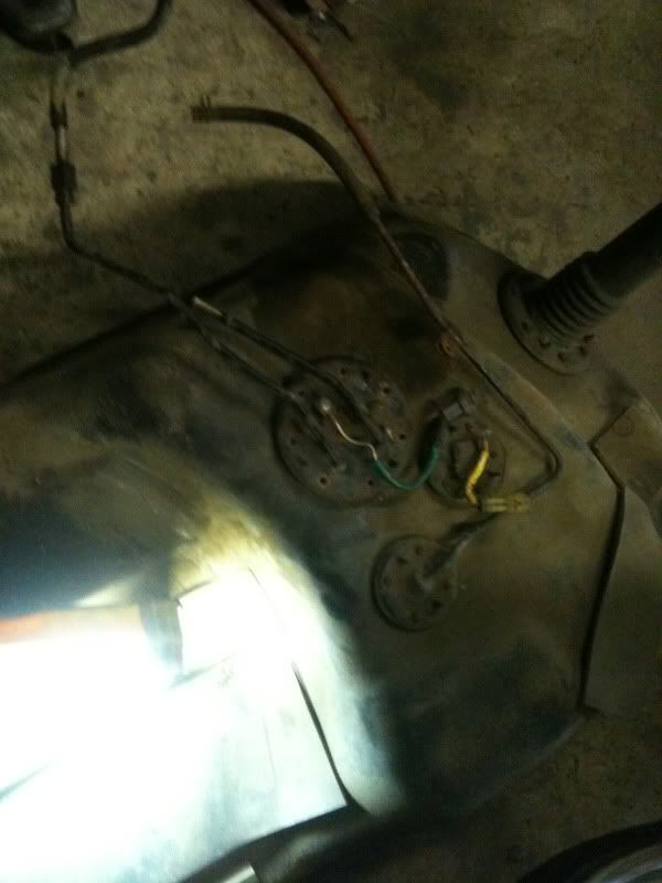

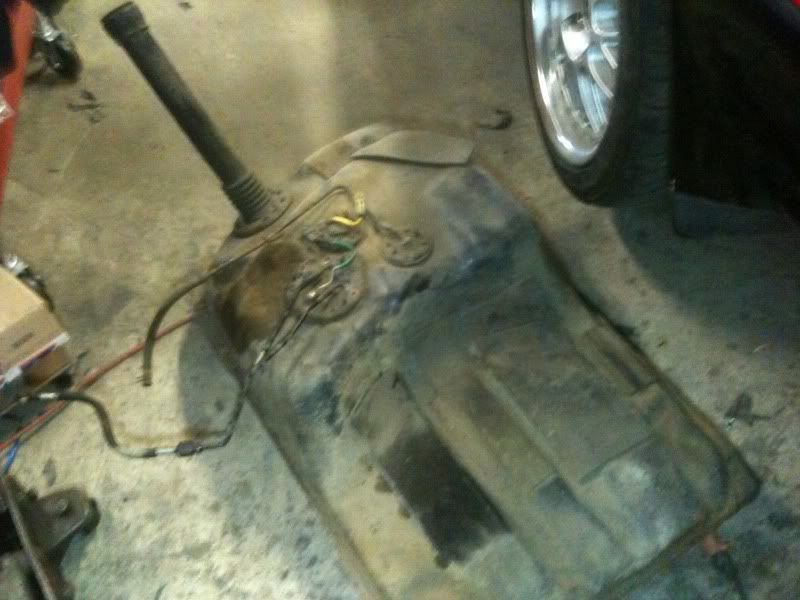

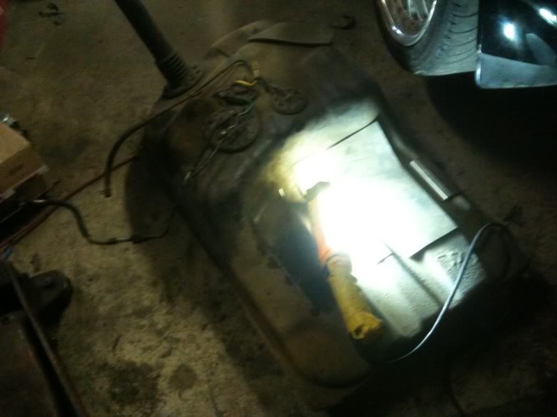

Yesteray I finished up all the wiring, hooked up the wideband, finished installing the fuel pump and primed the system. Checked for leaks in the fuel system. All I need to do now to crank it is to finish oil lines and add oil. I still need to buy a slave cylinder to drive it. Pics will be up soon.

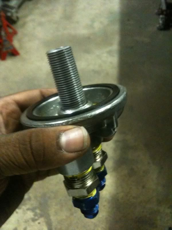

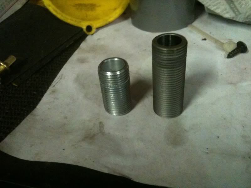

Cause summit sucks when you really need them to follow through. I need a adapter for the oil filter relocation. The thread has to be 3/4-16. The longest one they have is 1 1/4". It needs to be atleast 2".

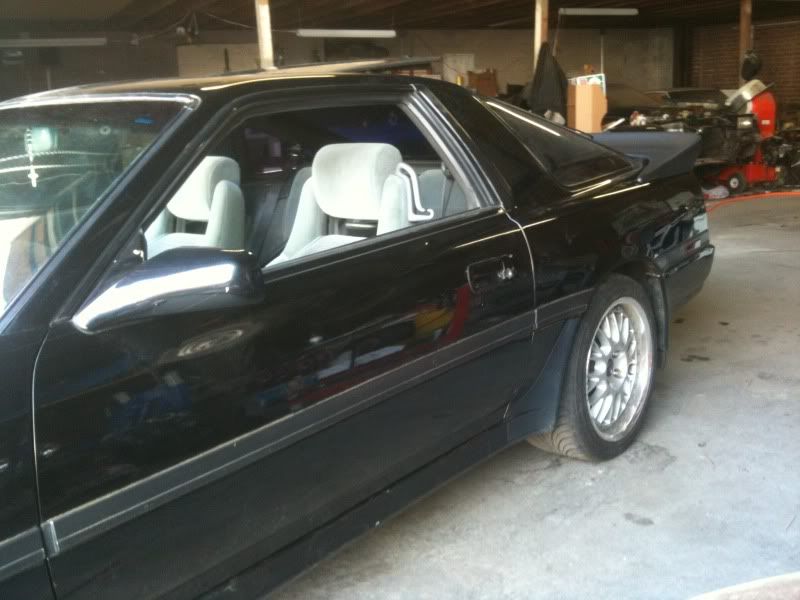

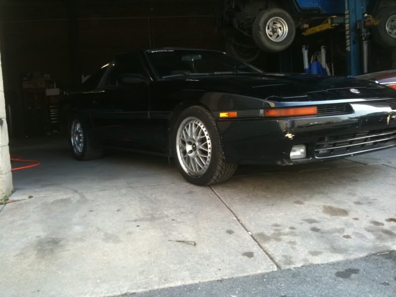

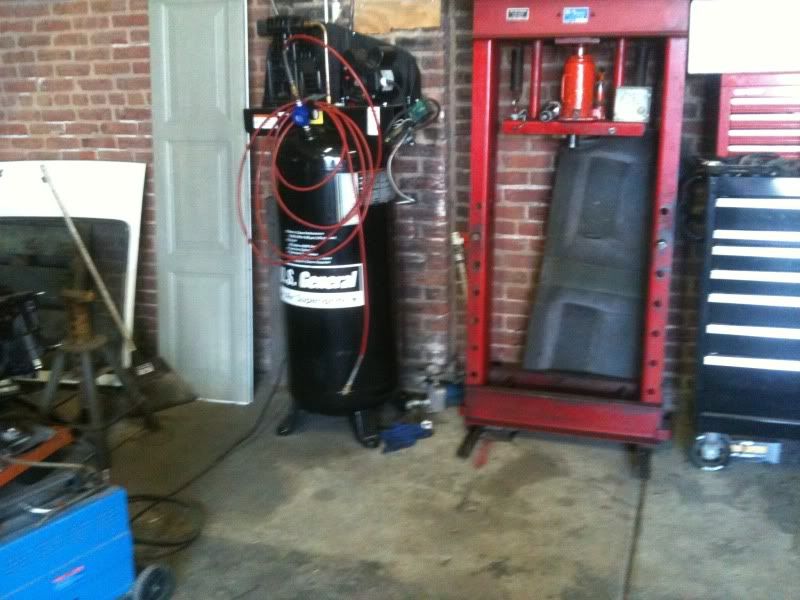

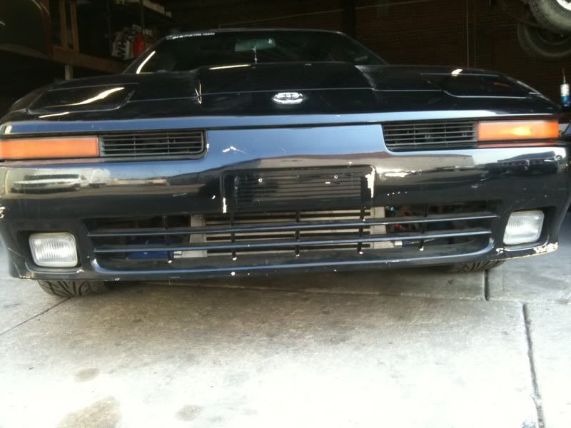

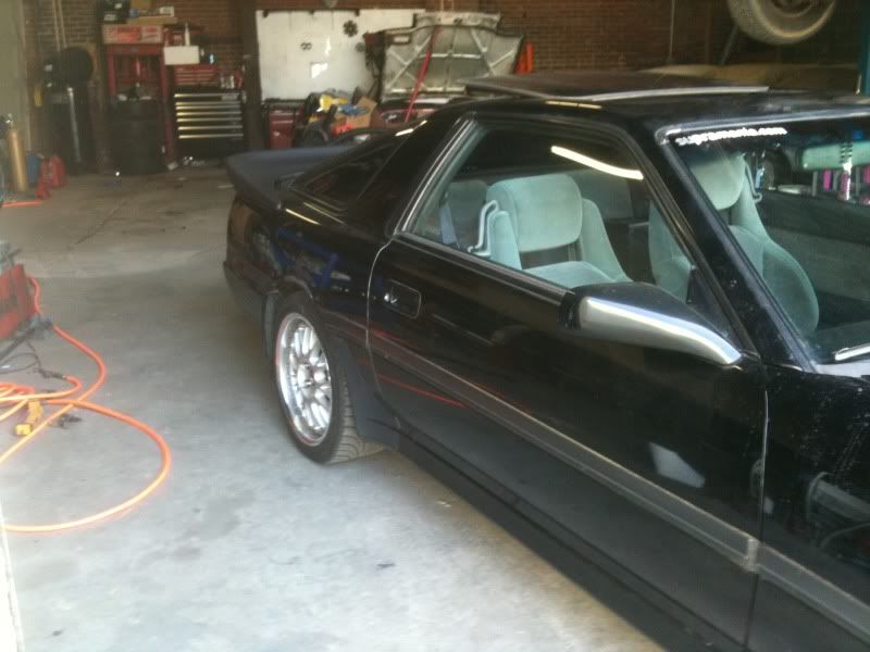

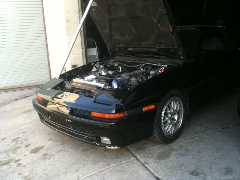

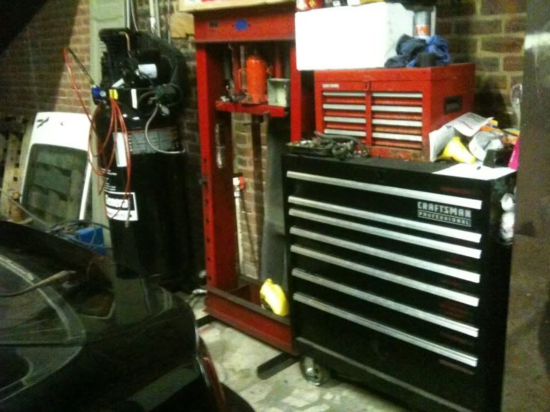

But here are some pics that I've been saying I'd post up.

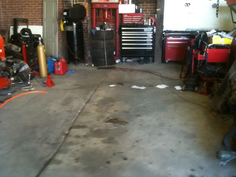

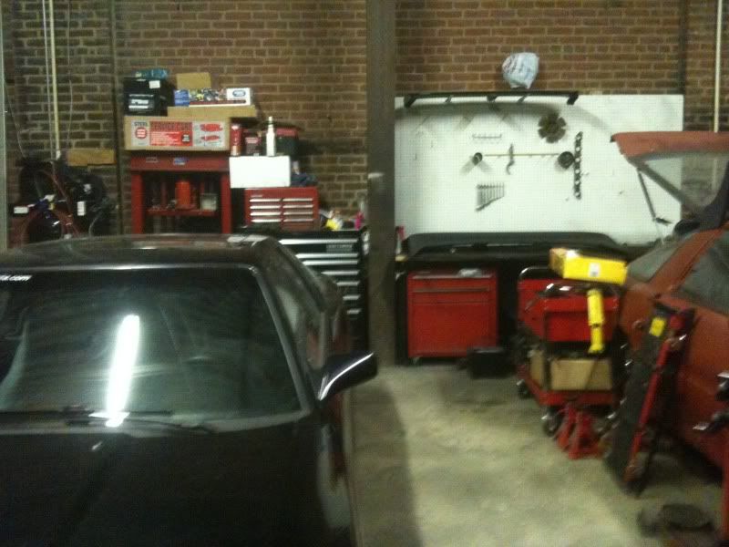

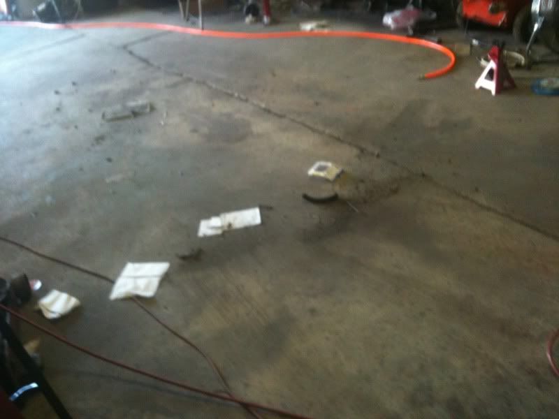

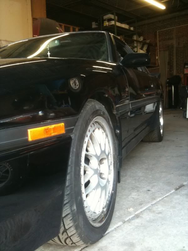

It was nice out so I thought I'd push the car out and get some pictures in some better lighting and also clean my work bay.
I was painting emps whaletail...just thought i'd see how it would look in blk on my car hehehe.

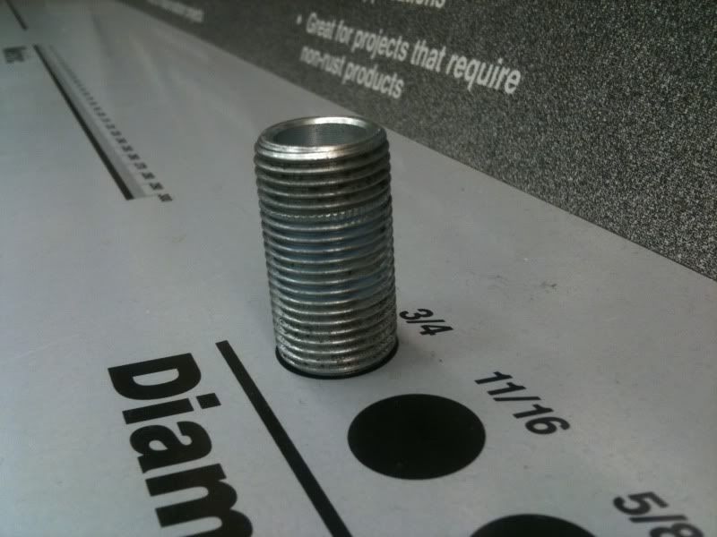

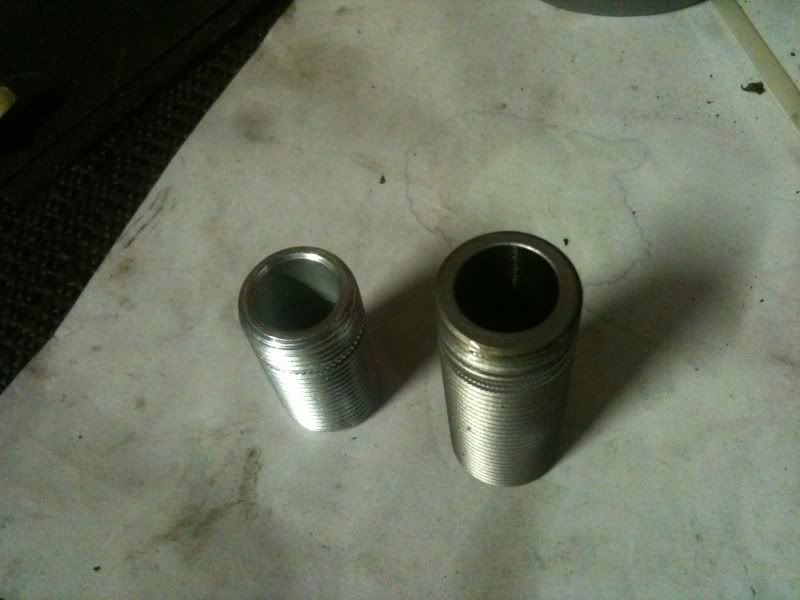

So I've been kinda stuck on this fitting lately. No one has it. Finally I found a place that has a bolt with that thread. I'm going to have the bolt head chopped off and the bolt bored out. We'll see if this works. Crossing fingers!! I Traded headunit I have for a new slave cylinder. Thanks emp! Hopefully I'll be putting that in soon.

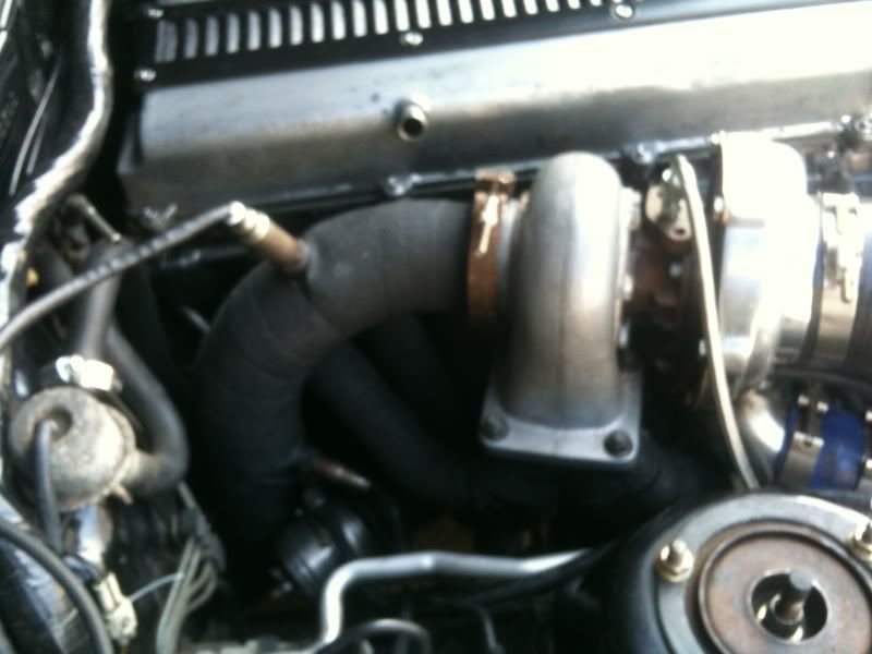

This is what I've been having problems with...
it goes from the block to the oil filter adapter. It was too short. It's the longest one summit had. After looking and calling around I finally found a place where they had a bolt with the size and thread I needed. Had it the head cut off and the center bored out. Looks good. Thanks Tyler (gaboon)!!!
