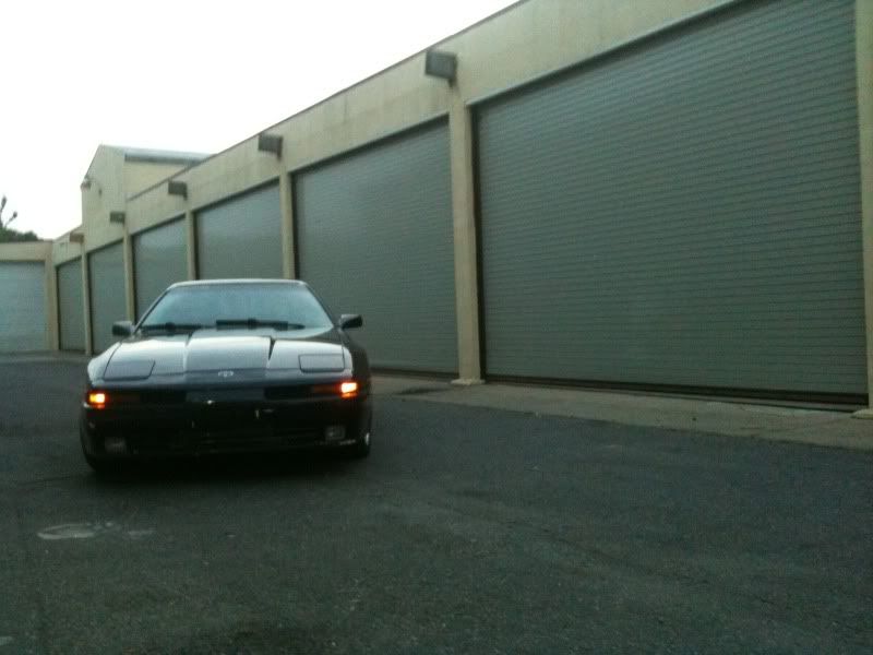

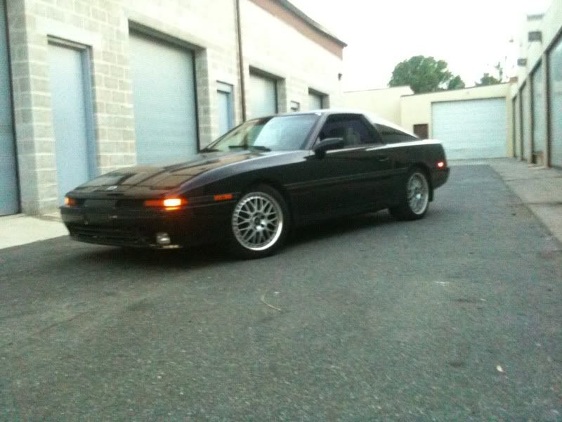

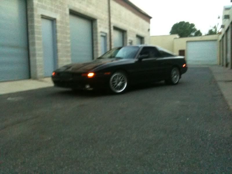

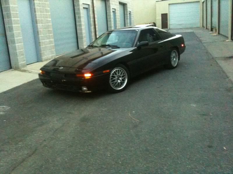

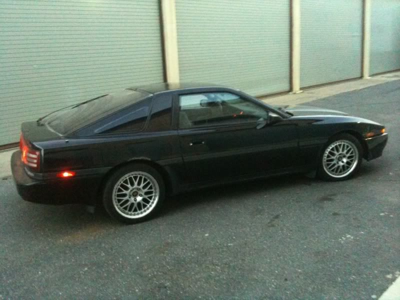

Was finally able to get away from the family for an hour and went to the garage to finally take some pictures outside and wash the car...
