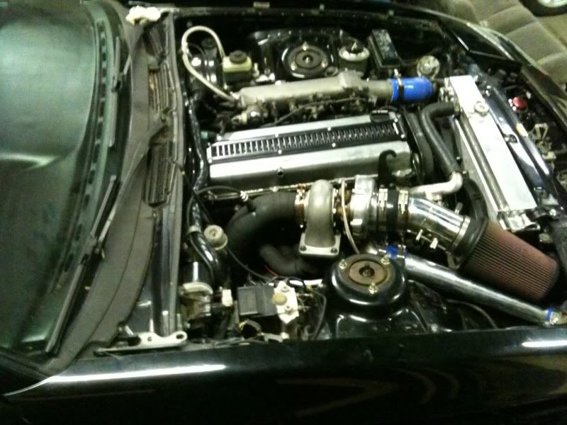

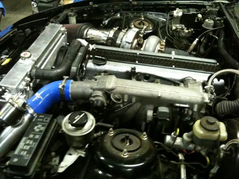

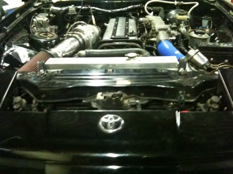

This weekend I installed the driveshaft, wrapped the downpipe and installed it. I started to run the intercooler piping and intake. I test fitted the 3core CX Racing Radiator with the dual electric fans. I fixed up the engine harness a bit and ran it into the cabin an hooked up the ecu. Filled up the trans with some fluid and installed my C's short throw shifter. I still need to finish the body harness which i need the igniter connector. This is how she sits now.
Still need to hook up fuel, afpr, time motor, mount the oil cooler and run oil lines, fill up all the fluids, install the exhaust, finish up the clutch and bleed, order fuel pump and install, run cable for battery relocation, hook up starter, and wire up the fan controller.

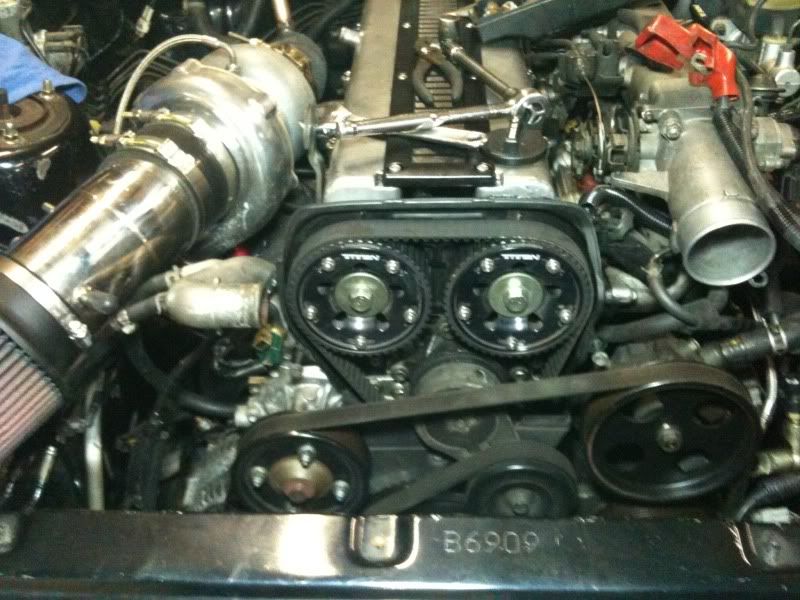

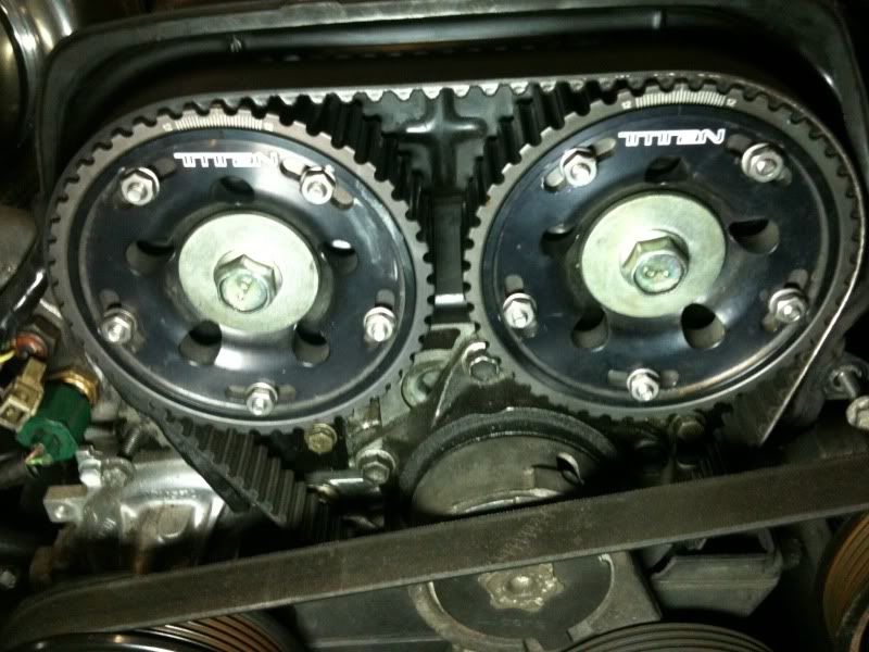

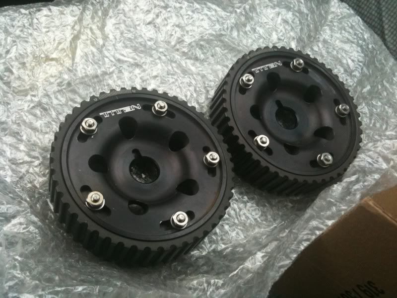

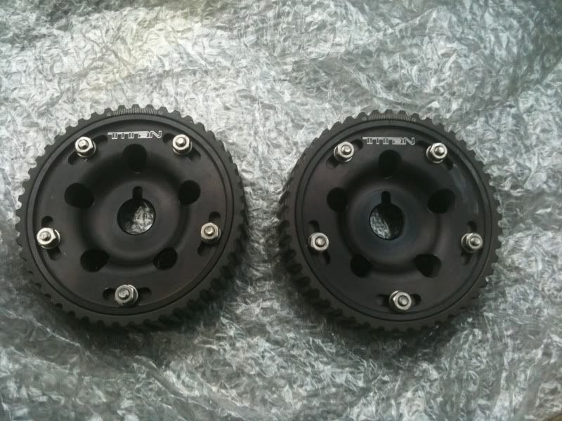

It finally stopped raining!!! Supposed to be nice out for the rest of the week!!! woot woot!! Today I installed the new cam gears, timed the motor, installed the radiator and hooked up the heater core so its ready to be filled up with coolant. I also hooked up the fuel return lines but haven't mounted the AFPR yet cause I'm waiting on someone to make me a mount. Also mounted the midpipe...just have to bolt on the rest of the exhaust.

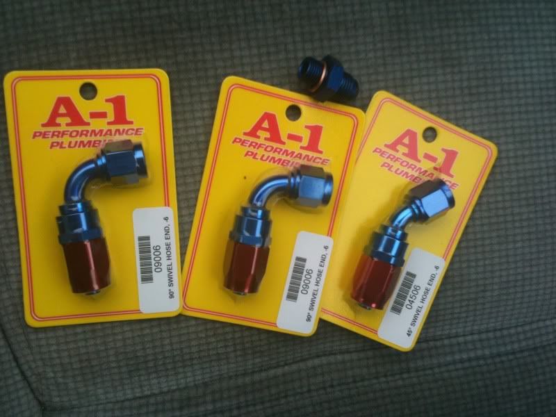

btw julio the tread for the 1j return was 12mmx1.25...thanks
pics...i forgot to take more before I left.
