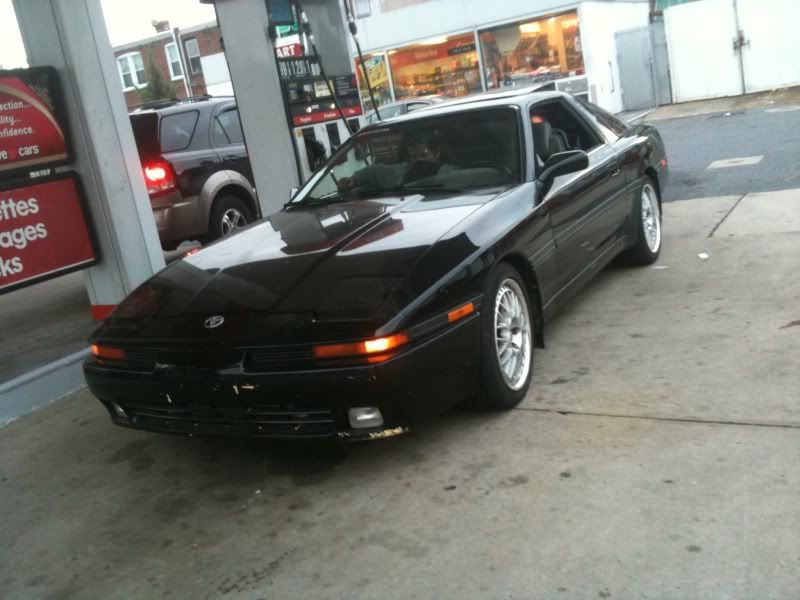

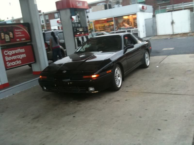

See... she runs. not running right though just yet... still having this problem of running rich at idle and running lean under load. I checked all the wires. I'm gonna go with the bigger cams. I'm thinking I might try to put the stockers back in just to see if thats the problem before I go buying a safc until I can save up for a standalone. I took her out on the road today for the first time since i bought it. Went to fill gas...was definitely needed!! Sorry forgot to take video. I took a few pics... i'll try to post that up later.
supra1008
May 2, 2007
1,179
Philadelphia
Filling up gas for the first time.
