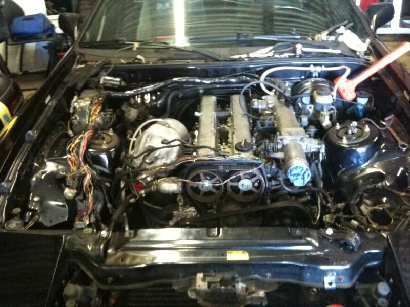

Lately been working on the car just to get away from life and get my mind off things. I sanded and cleared the center spoiler. I need to figure out how to mount it properly. Any ideas?

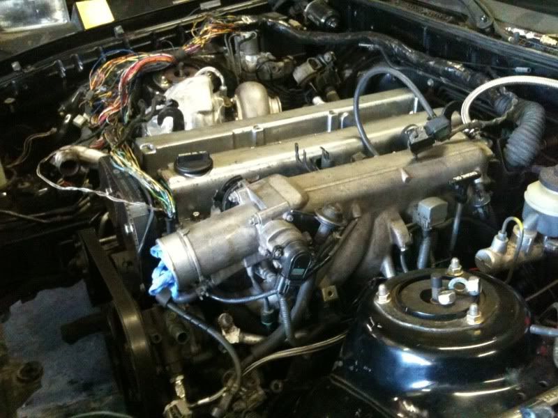

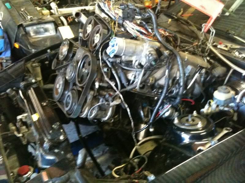

got some solid motor mounts

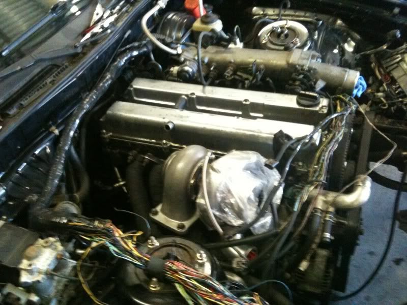

wrapped the exhaust manifold. Should hopefully solve the heat soaking

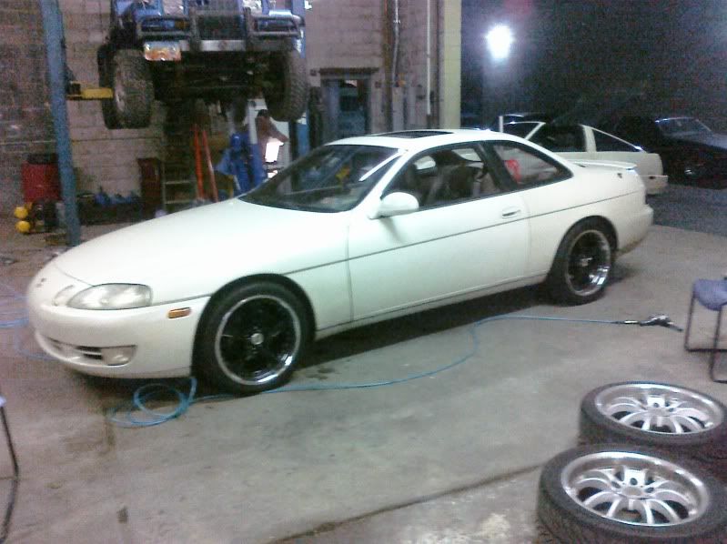

one of my buddies with a 300zx had a set of ADR wheels that he was considering to sell if they didn't fithis car so I wanted to see what they would look like on m car...
can't wait to get some nicer wheels!!

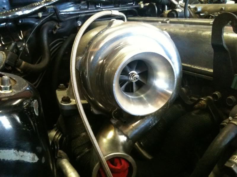

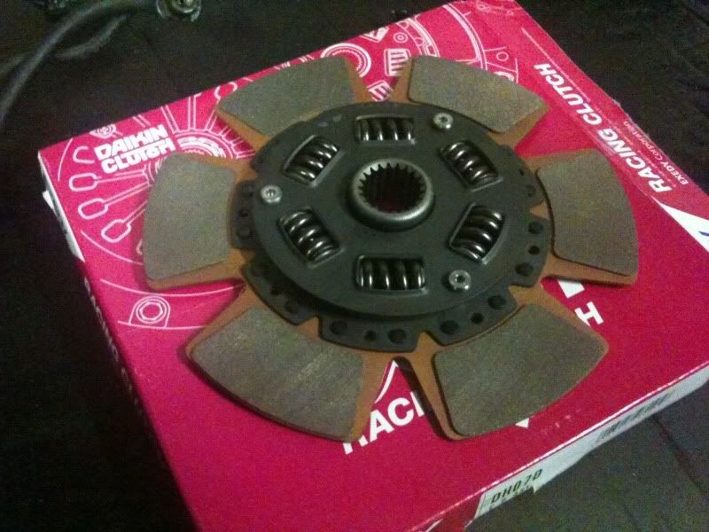

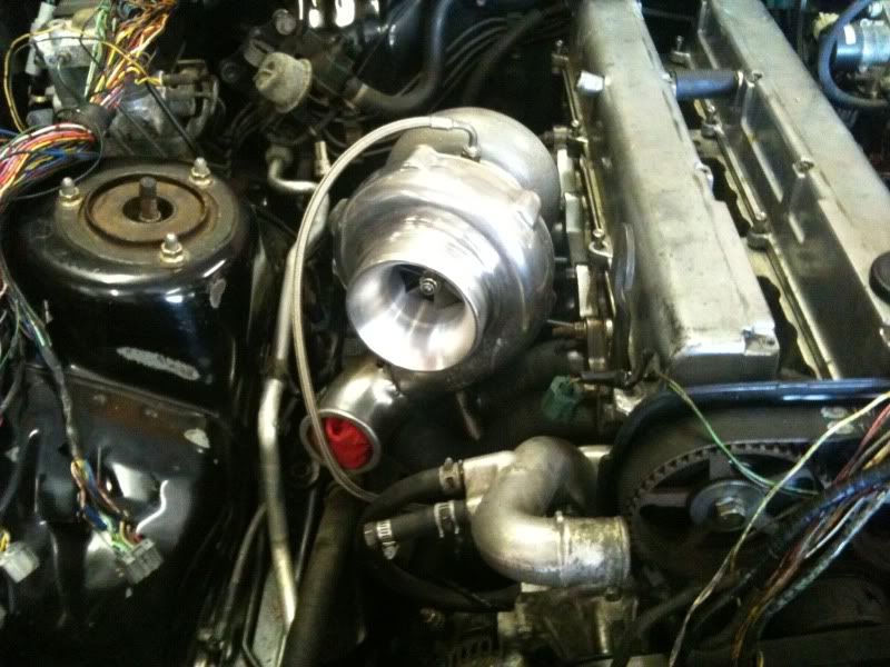

I also checked the valve clearances after putting cams in. The clutch disk also came in today. I picked up some fittings and some exhaust wrap for downpipe.

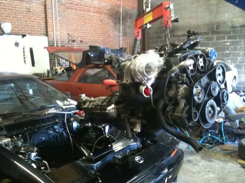

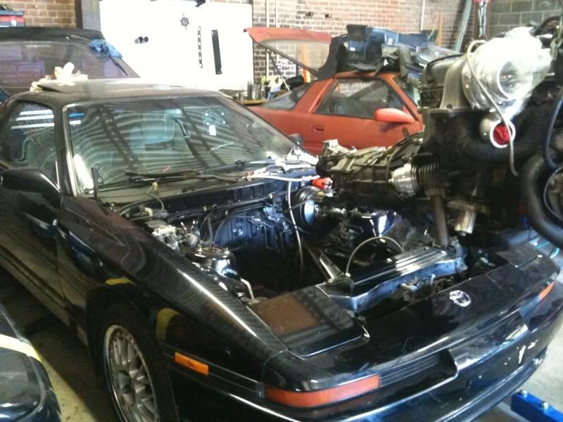

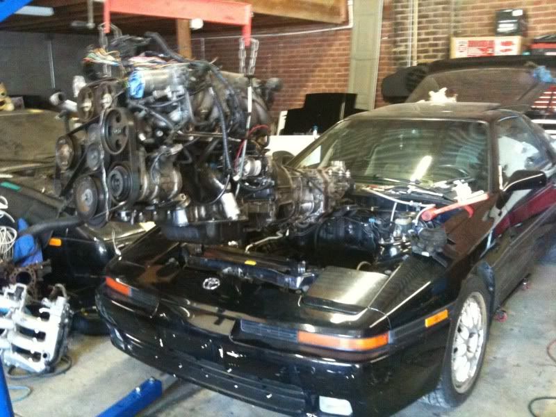

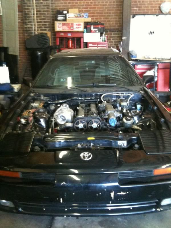

Should be able to drop the motor in real soon. Just need to swap clutch line from our parts car. Then bolt up the trans to the block and it will be ready to drop in.
supra1008
May 2, 2007
1,179
Philadelphia

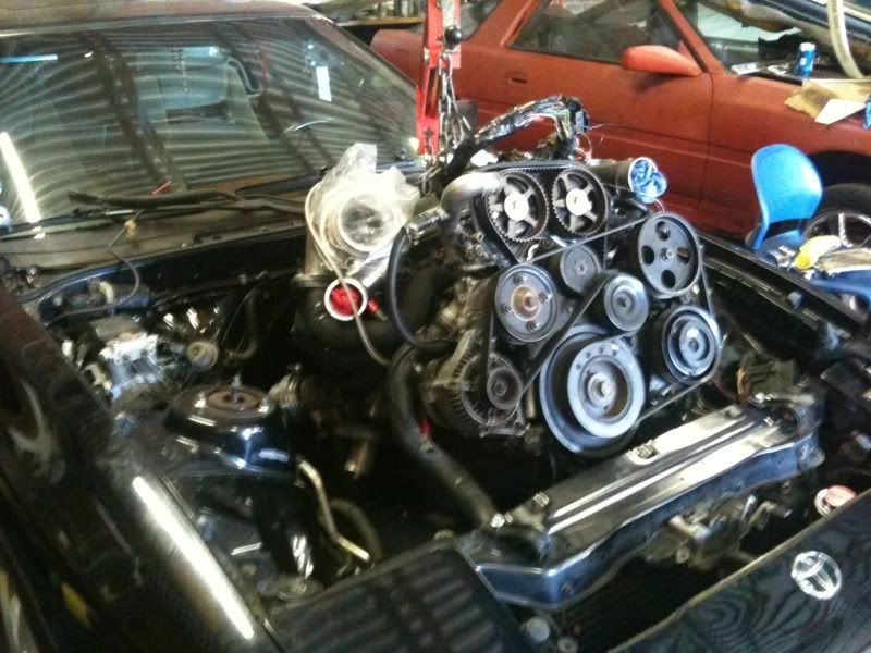

Slowly coming together! Changed the rear main seal. Installed the clutch, trans, starter. Got the ss ps hose from Driftmotion. Also finally dropped the motor/trans in.
it's getting there...

what else do you need to do? looks like maybe some wiring, and a few odds and ends, looks like you will be finishing up soon
supra1008
May 2, 2007
1,179
Philadelphia
There is still a good amount to get done.
Finish wiring, Relocate battery, Install driveshaft, Wrap downpipe, Install exhaust, Time engine
Install oil cooler, Install oil lines, Install ic piping, install slave cyl and Bleed clutch, Change brake fluid
Fix stock ecu, Install fuel pump, Install fuel filter, Install afpr/lines.
I'm positive that there are things I'm forgetting. Got some more space in the garage now though that the motor/trans is in. Lol
