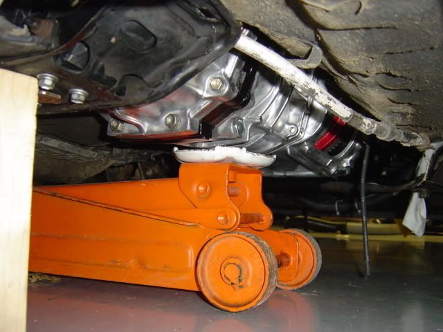

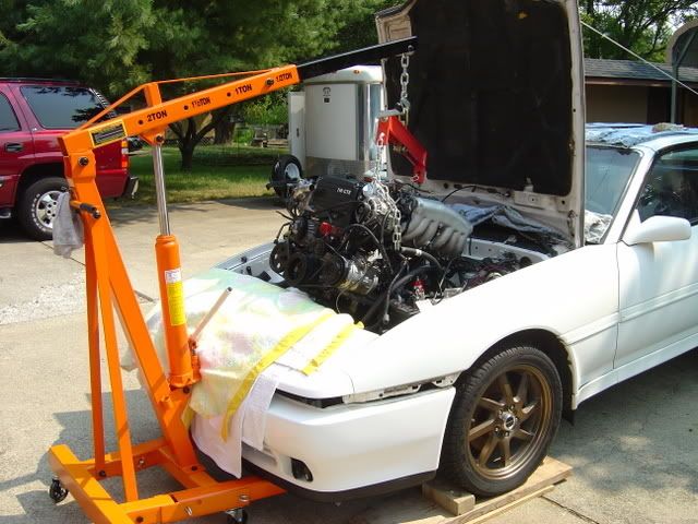

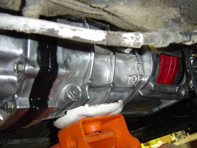

Well the motor is in! I dont understand why they dont make these engine hoist with a longer reach. Me and my help were really having to finagle to get that thing back far enough to set down on the mounts. We were so into that part of it that we didnt notice the firewall eating up the back edge of my nicely powder coated valve covers!:icon_evil Oh well lessons learned and its done now. Now comes the chore of hooking everything up. Had the driveshaft and tranny all bolted up and went in the car to put it in gear so I could tighten the crank bolt. Should I even tell? I forgot to put the gear shift housing back on the tranny before we put it in. The fix wasnt near as bad as I thought it would be. I unbolted the tranny support and dropped it down and it slid in from the top. I thought it was going to take alot more than that.
I also realized that I was missing a connection on the tranny., So I had to go look at my other R154 to figure out what was missing. The speed sensor. This tranny im using has a plug there. The car it came from must not have had ABS and mine does. So I removed it from my other tranny. QUESTION. How do I remove the plug? It looks like a small freeze plug. How are freeze plugs removed? Im tired. IM going to bed. Will try to post pics soon!

I got it out. IJ told me how. Just took a sharp screwdriver and punched through it and then pryed it out. Then stuck my sensor in. Not hard at all.

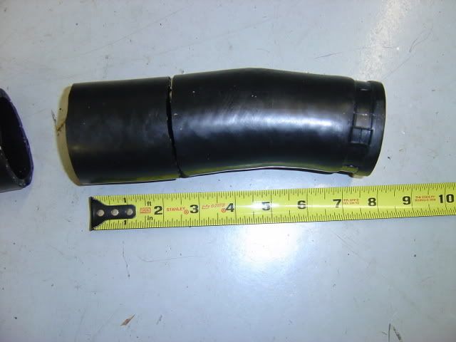

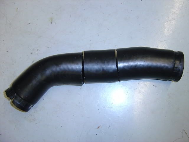

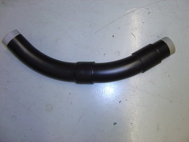

heres some of my homemade lower intercooler pipe
stock hose cut
finished product

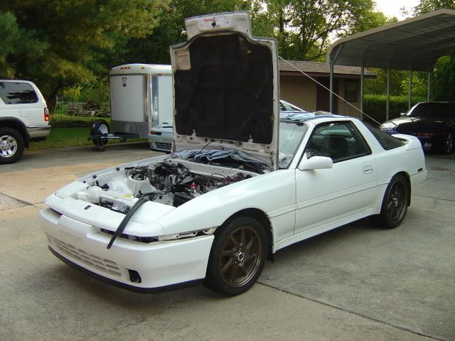

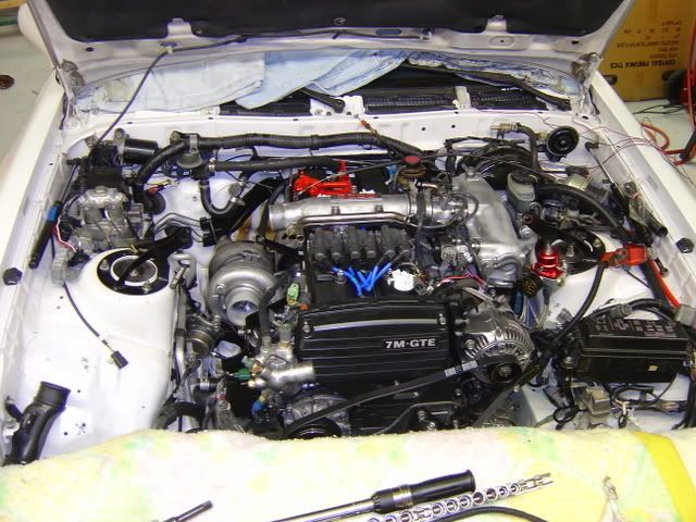

motor in

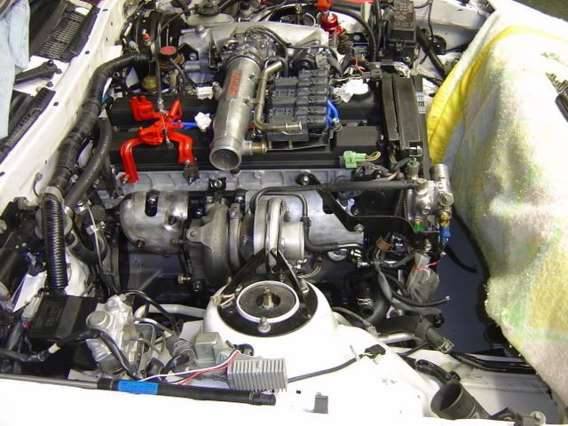

I got my exhaust wrapped up today. I hope I can finish for Sunday!

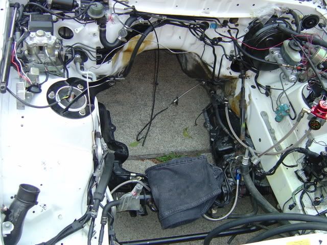

I don't want to know what you were doing that would cause you to take your pants off in the empty engine bay. I guess you and your wife are still pretty frisky........even after three boys........:biglaugh:

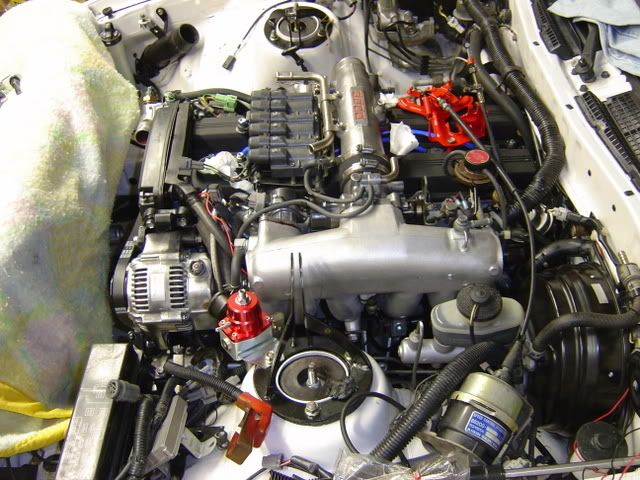

My oldest spotted a fuel leak early out of my AFPR. My fault, the line wasnt tight. The only other leak I have found so far is my new Driftmotion PS line. I'll look into that tomorrow. Fuel pressure is around 35 and seems to idle fine. Oil pressure is between 60 and 80 psi at cold idle.
