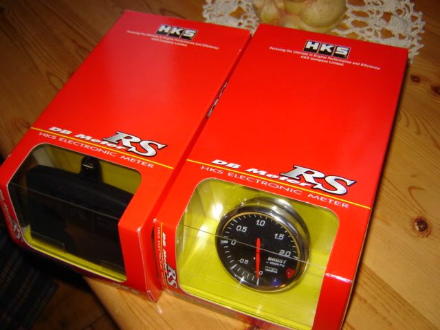

I just got the HKS DB Meter RS Gauge with the I/F unit
They want you to have one line going to a constant 12V and one to the Ignition? and another to Ilumination.
They don't really say what they mean by the last one. Does nayone have an idea?
Also i am curious where people hook in for there constant 12V.
And the Ignition. I am not that great at figuring out wiring. Are they talking about the Wire from the Key where you also hook up your turbo timer?
Any help with this would be great.
I am not the most proficent with wiring

heres a shot for now.

you can find 12 volt constant and ignition at the ignition harness itself. (in the steering column)
constant 12v- white or white w/red stripe (or just run a completely new line straight to the battery with a fuse)
ignition - black w/yellow stripe
illumination would probably have to be wired into your parking lights, it may be what illuminates your gauge when you turn your lights on. i have no experience with wiring up gauges but i have experience in mobile electronics and its all pretty much the same. there should be a green wire in your dr. side kick panel, that would be your + switch and pink would be - switch.
