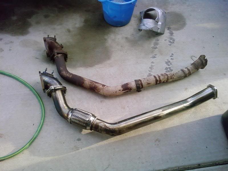

My 87 turbo had only one cat. Here's a pic of the stock downpipe next to the one I put on the 86.5
5
Not stock ;)
All Turbo MKIII's came with 2 cats here.

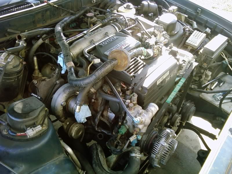

5
What's that sticker on the front timing cover? And don't forget to unbolt the A/C compressor from the block if you want to keep the system closed and still working. It should stay in the bay, power steering pump is easier to unbolt the lines and have it stay on the engine.
